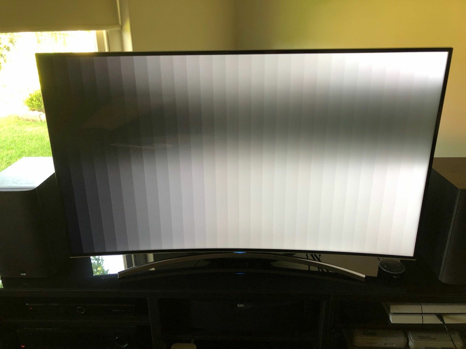

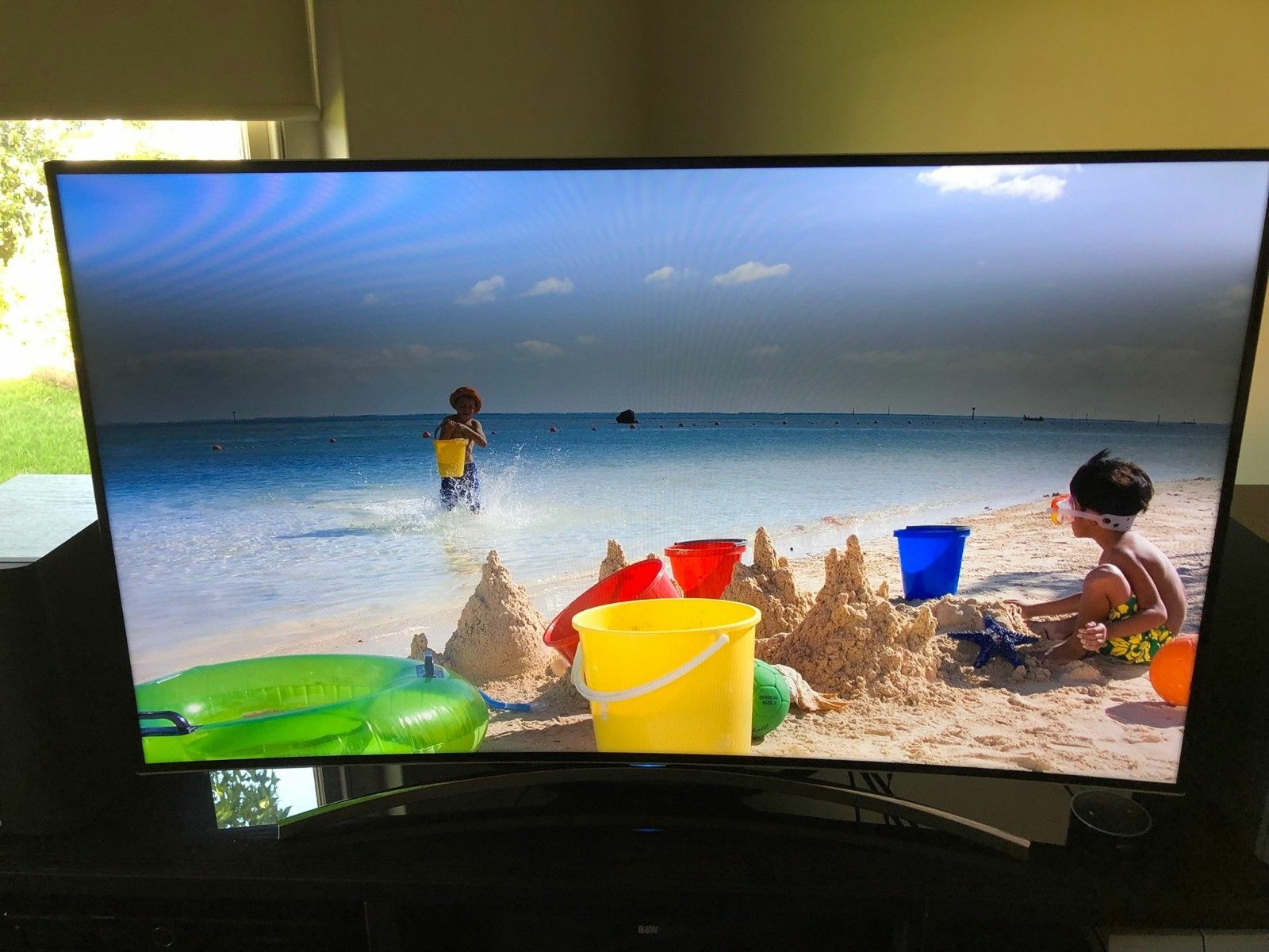

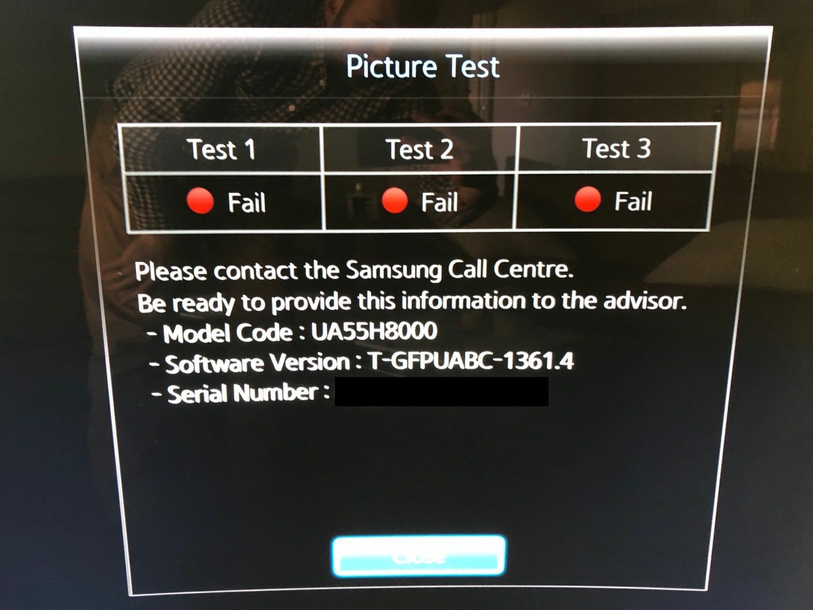

    Can I get some advice please on this TV, it's an edge lit model.
    Does this look like a Backlight failure? or some Panel fault?
    Thanks in advance.

        Yes this does appear to be a Backlight issue.
