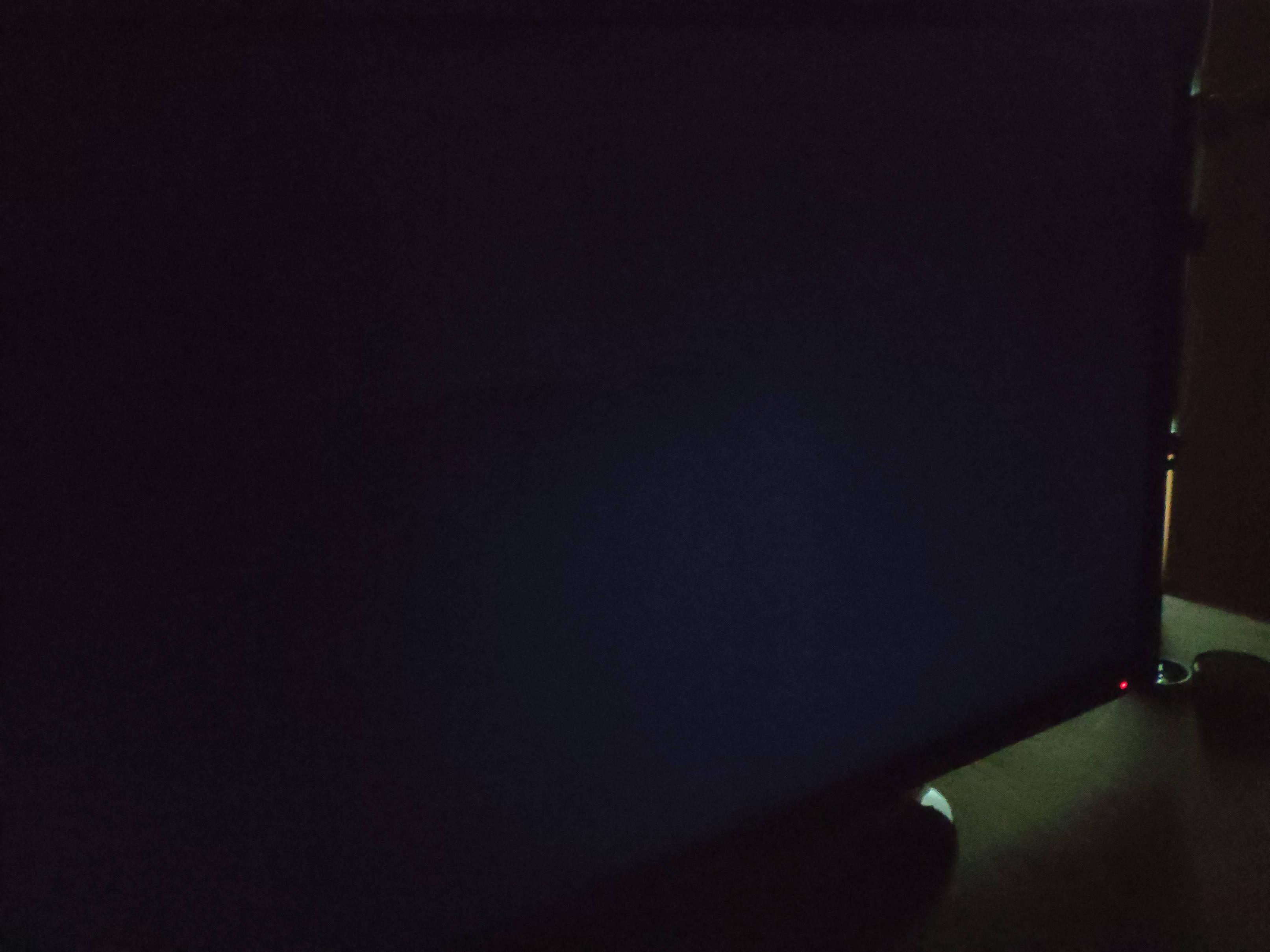

Samsung UE40D5003BW show logo and turn off itself
  • sn4k3
    • Oct 2016
    • 68
    • Portugal
    Samsung UE40D5003BW show logo and turn off itself
    Brand: Samsung
    Model: UE40D5003BW, UE40D5003BWXXC
    Chassis: BN41-01702A
    Panel: LD40BGD-V1
    Before this samsung started to lose sound itself, then it start to boot loop with samsung logo and now only turn on, show SAMSUNG logo and after some seconds it turn off, standby LED blink RED at start and then stay red all the time.
    Remote doesn't respond and i can't turn off/on again, it got stuck on that phase.
    Backlight is always on, but when samsung logo is gone the backlight go dimmer, still visible from the back.
    Things i've tried:
    1) Output voltages from PSU are present
    2) All voltages checks from "No Power" Service manual page 29. are ok (A5V_PW, B13V_PW, B5V_PW, A3.3V_PW, B3.3V_PW, B1.5V_PW)
    3) BIOS reprogram
    Anyone experienced same problem before?
    https://youtu.be/Z5cKOTEwLJo
    Last edited by sn4k3; 01-08-2019, 01:22 PM.
  • Diah
    • Feb 2013
    • 6395
    Re: Samsung UE40D5003BW show logo and turn off itself
    the main board fitting on the chassis so funny, to my eyes its belong to other model... between how many time the RED LED blinks before it stay on red always
    • nomoresonys
      • Jan 2013
      • 12206
      • U.S.
      Re: Samsung UE40D5003BW show logo and turn off itself
      Is that first one it? looks the same, a couple nand chips in the list too, didn't look too closely at them. https://www.ebay.ie/sch/TV-Boards-Pa...kw=ue40d5003bw
      • sn4k3
        • Oct 2016
        • 68
        • Portugal
        Re: Samsung UE40D5003BW show logo and turn off itself
        Originally posted by Diah
        the main board fitting on the chassis so funny, to my eyes its belong to other model... between how many time the RED LED blinks before it stay on red always
        I don't know, that board was been there for years and match plastic holes. Maybe because i don't place every screw it seen wrong to you.
        Red blinks here: https://www.youtube.com/watch?v=MB6X...ature=youtu.be
        Is that first one it? looks the same, a couple nand chips in the list too, didn't look too closely at them.
        I didn't get the bold part, what you refer to?
        • nomoresonys
          • Jan 2013
          • 12206
          • U.S.
          Re: Samsung UE40D5003BW show logo and turn off itself
          The first mainboard on the ebay link, looks the same as your board, can't tell if sticker numbers match tho.
          • Diah
            • Feb 2013
            • 6395
            Re: Samsung UE40D5003BW show logo and turn off itself
            okay, from the video on your first post, it sound we have problem with B13V_PW on PSU. take it out and take look underside , and follow this B13V_PW section even you said it present but it may going down when the LCD screen flashing to go out
            Last edited by Diah; 01-08-2019, 02:31 PM.
            • Diah
              • Feb 2013
              • 6395
              Re: Samsung UE40D5003BW show logo and turn off itself
              also in other wrords put your voltmeter on the B13V_PW pin out then turn on and keep watching this . it going down and then up again or remain same vlaue
              • maik
                • Dec 2015
                • greece
                Re: Samsung UE40D5003BW show logo and turn off itself
                Did you fixed? Any news?I have exactly the same problem.I guess is the main ,SEMS20 CHIP.
                • sn4k3
                  • Oct 2016
                  • 68
                  • Portugal
                  Re: Samsung UE40D5003BW show logo and turn off itself
                  Originally posted by Diah
                  also in other wrords put your voltmeter on the B13V_PW pin out then turn on and keep watching this . it going down and then up again or remain same vlaue
                  I've checked, it's always fixed, no fluctuations, both 13v and 5v fixed, no changes when it turn off
                  Originally posted by maik
                  Did you fixed? Any news?I have exactly the same problem.I guess is the main ,SEMS20 CHIP.
                  No, but is possible, bottom side is a bit darker on CPU side, i have SEMS20 on stock, if all other tries fail that will be my last guess and solder a new on.
                  Does your also start misfunction with other stuff too? Mine as audio
                  Last edited by sn4k3; 01-11-2019, 07:12 PM.
                    09-07-2024, 05:50 AM
                    09-06-2024, 11:40 PM
                    09-06-2024, 11:40 PM
                    09-06-2024, 08:40 PM
                    Samsung Galaxy Book Ion NP950XCJ-X01DE Notebook Specification for Upgrade or Repair
                    This specification for the Samsung Galaxy Book Ion NP950XCJ-X01DE Notebook can be useful for upgrading or repairing a laptop that is not working. As a community we are working through our specifications to add valuable data like the NP950XCJ-X01DE boardview and NP950XCJ-X01DE schematic. Our users have donated over 1 million documents which are being added to the site. This page will be updated soon with additional information. Alternatively you can request additional help from our users directly on the relevant badcaps forum. Please note that we offer no warranties that any specification, datasheet,...
                    09-06-2024, 06:20 PM
