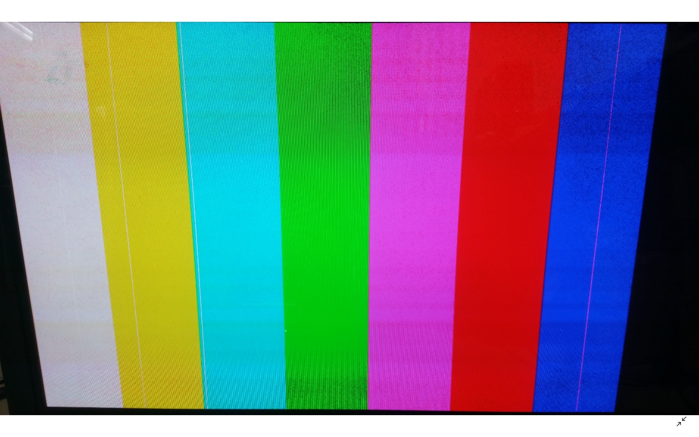

    I have this plasma tv that has this grainy aspect (more at the borders) and some vertical lines at intervals.
    VA/VS voltages are ok.
    Any tips on what may be causing this problem?

    my friend the screen is faulty suspect. the screen tab connectors bottom of the tv is either dirty or faulty please try to clean it. if not requires new pdp screen.

      Did the cleaning in the bottom tab connectors but the problem remains, thx for the info.

        check the Z sus for bad connections on the inductors
        Increase Y sus voltage 5Volts
