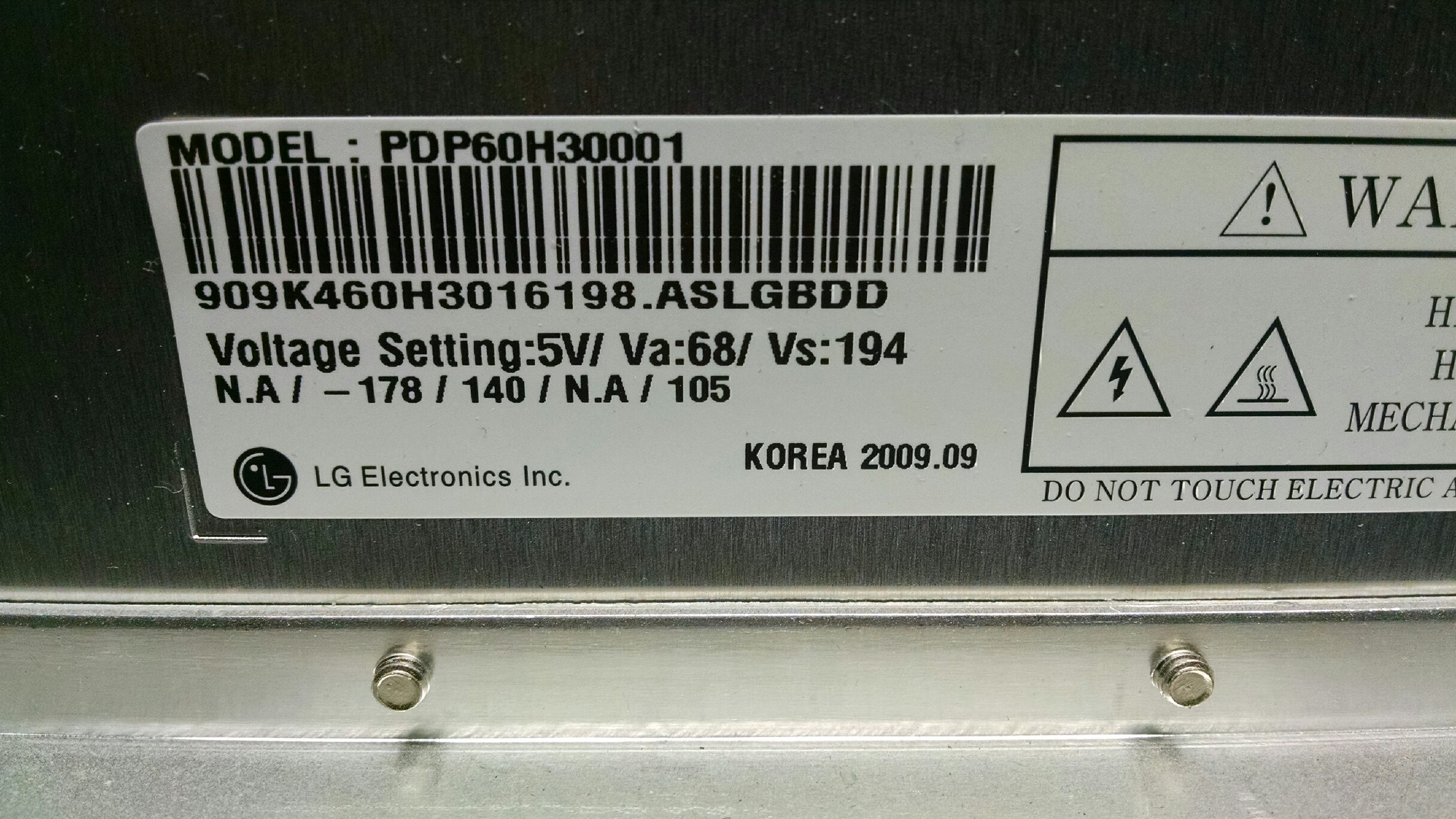

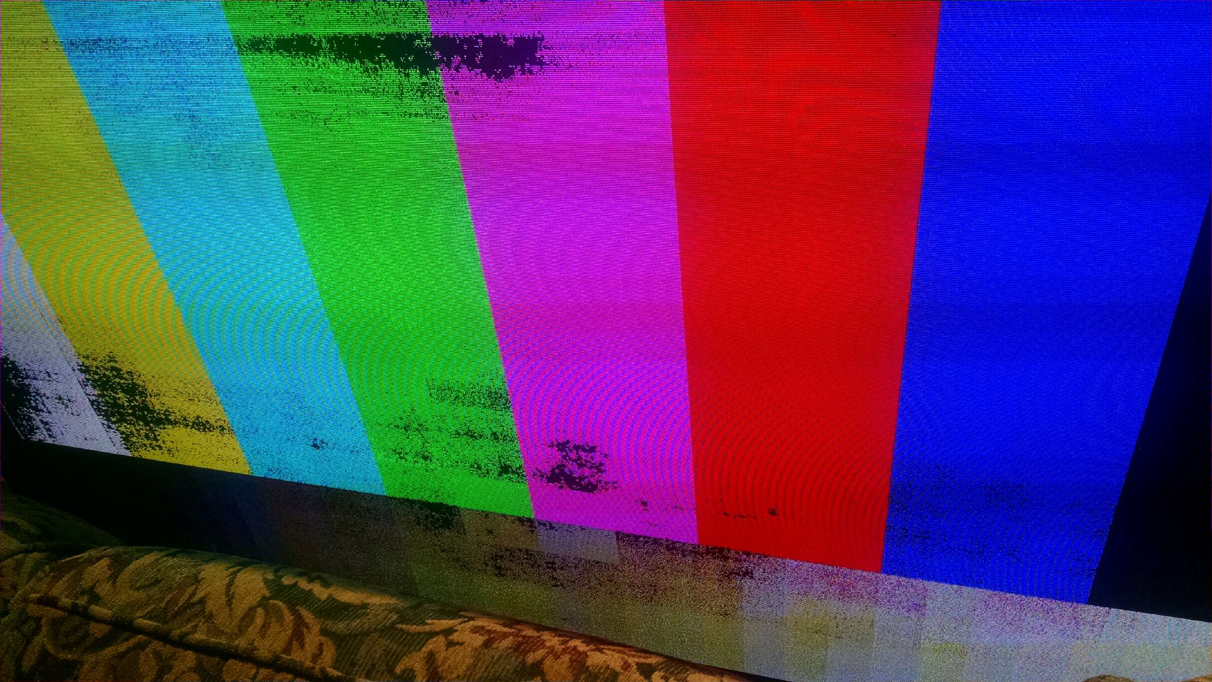

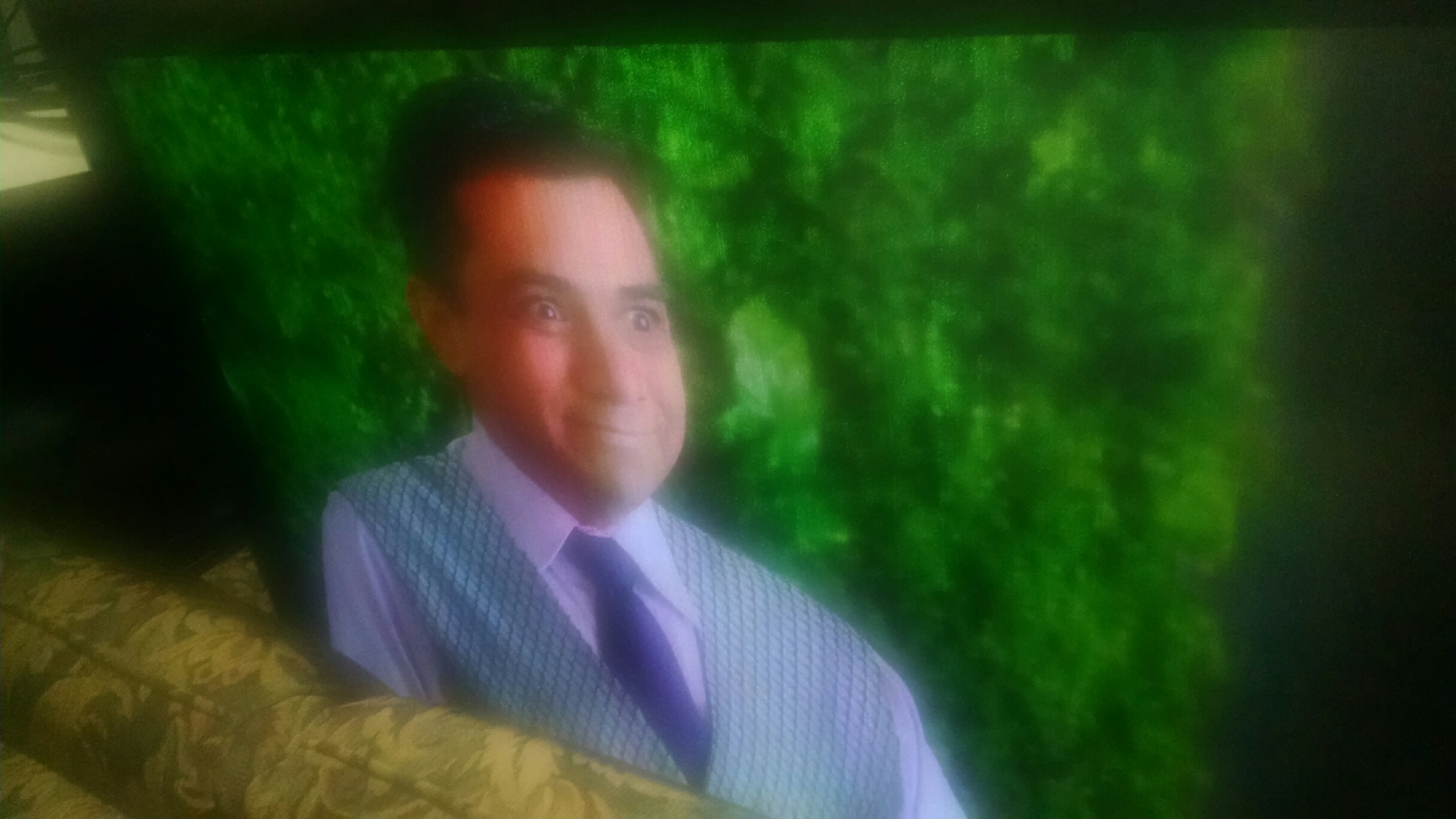

    I have an 60" LG plasma 60ps60 with a Y sus board EAX55656202.
    The set has image retention,artifacts, mal discharge.
    Y SUS boards are scarce and expensive for this set.
    voltages are as follows
    VS-195
    Va-67
    -vy-178
    vsc-140
    z bias-104
    Can I run it with with a buffer board removed for testing?
    Or will it blow the Y sus.

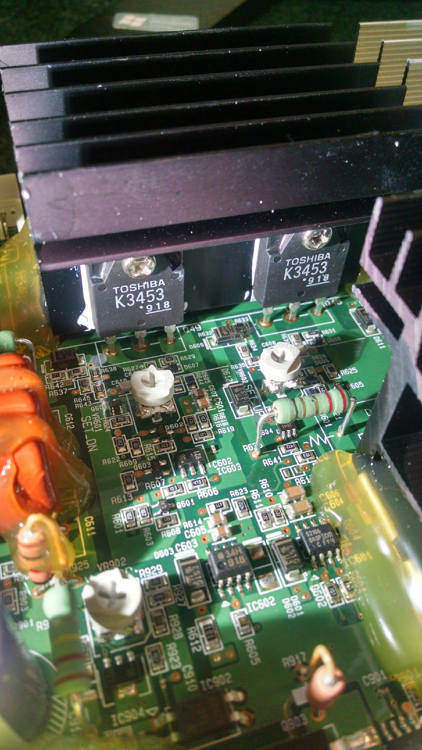

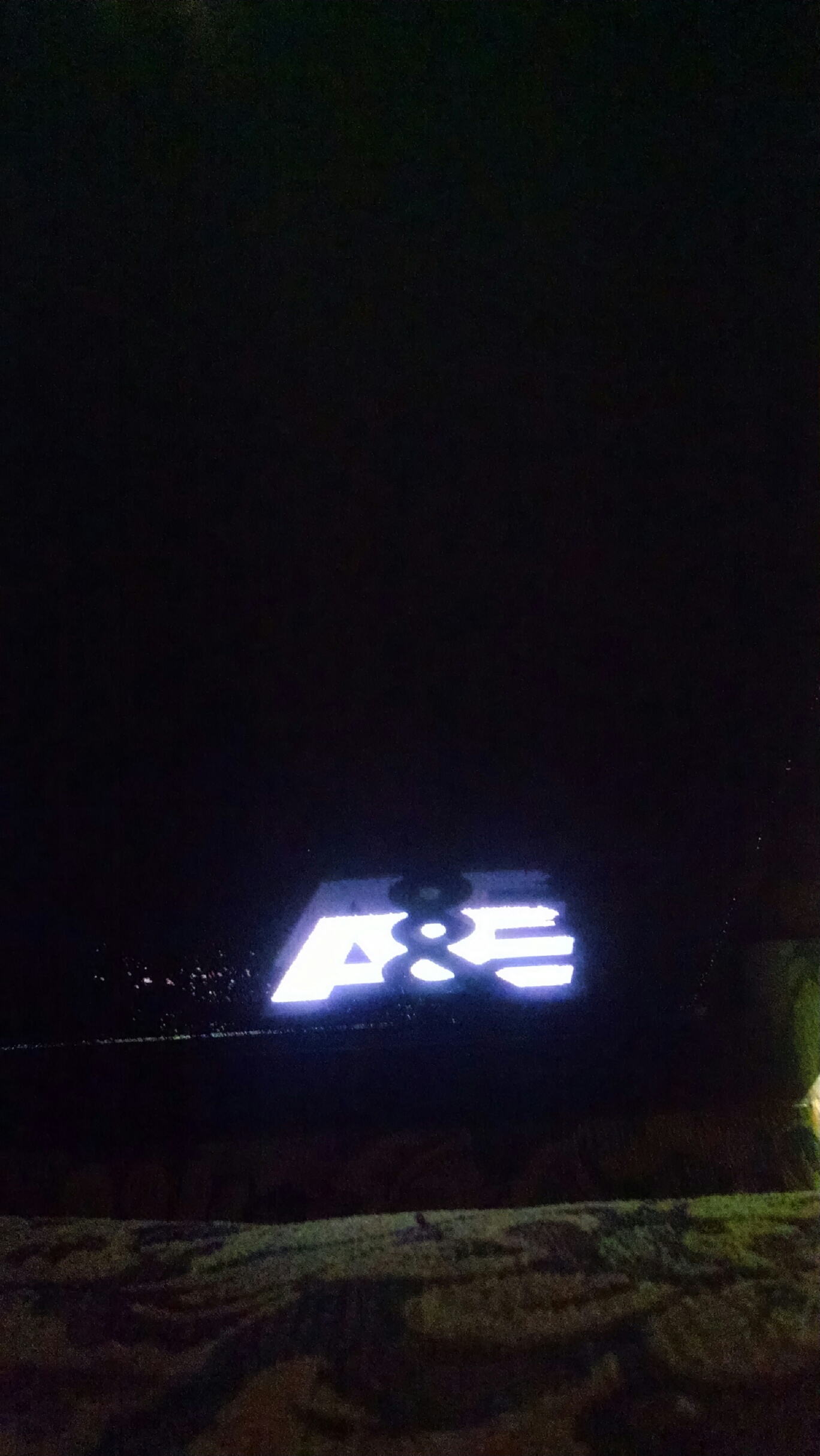

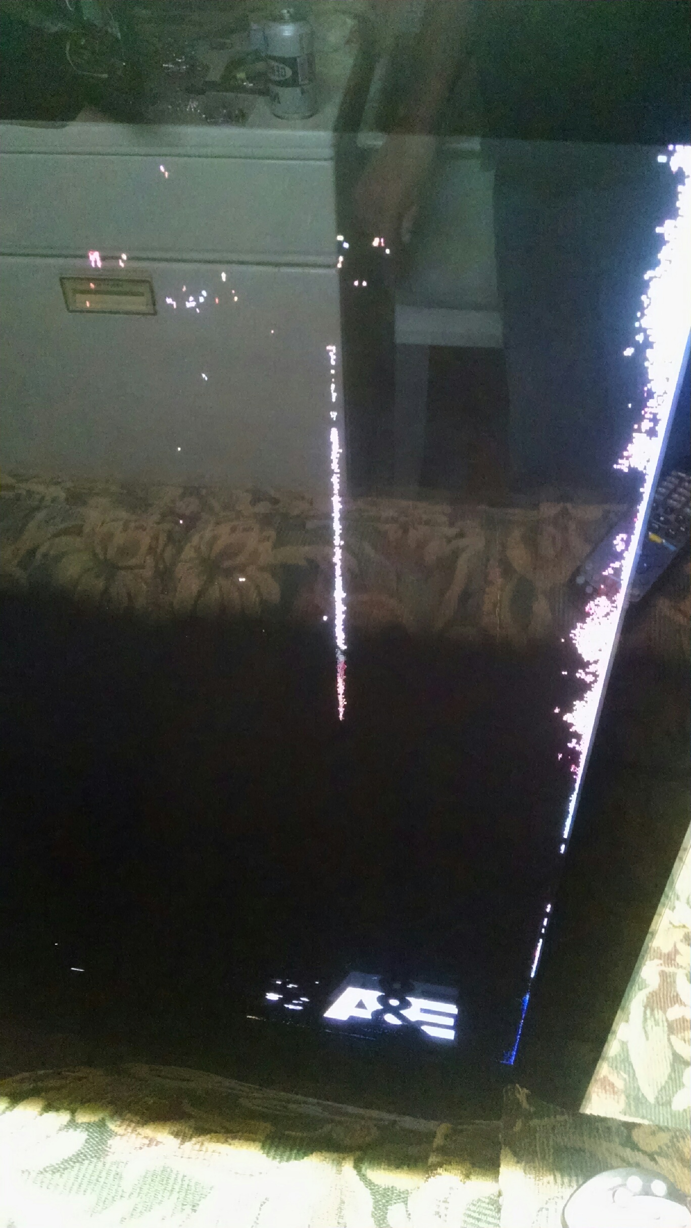

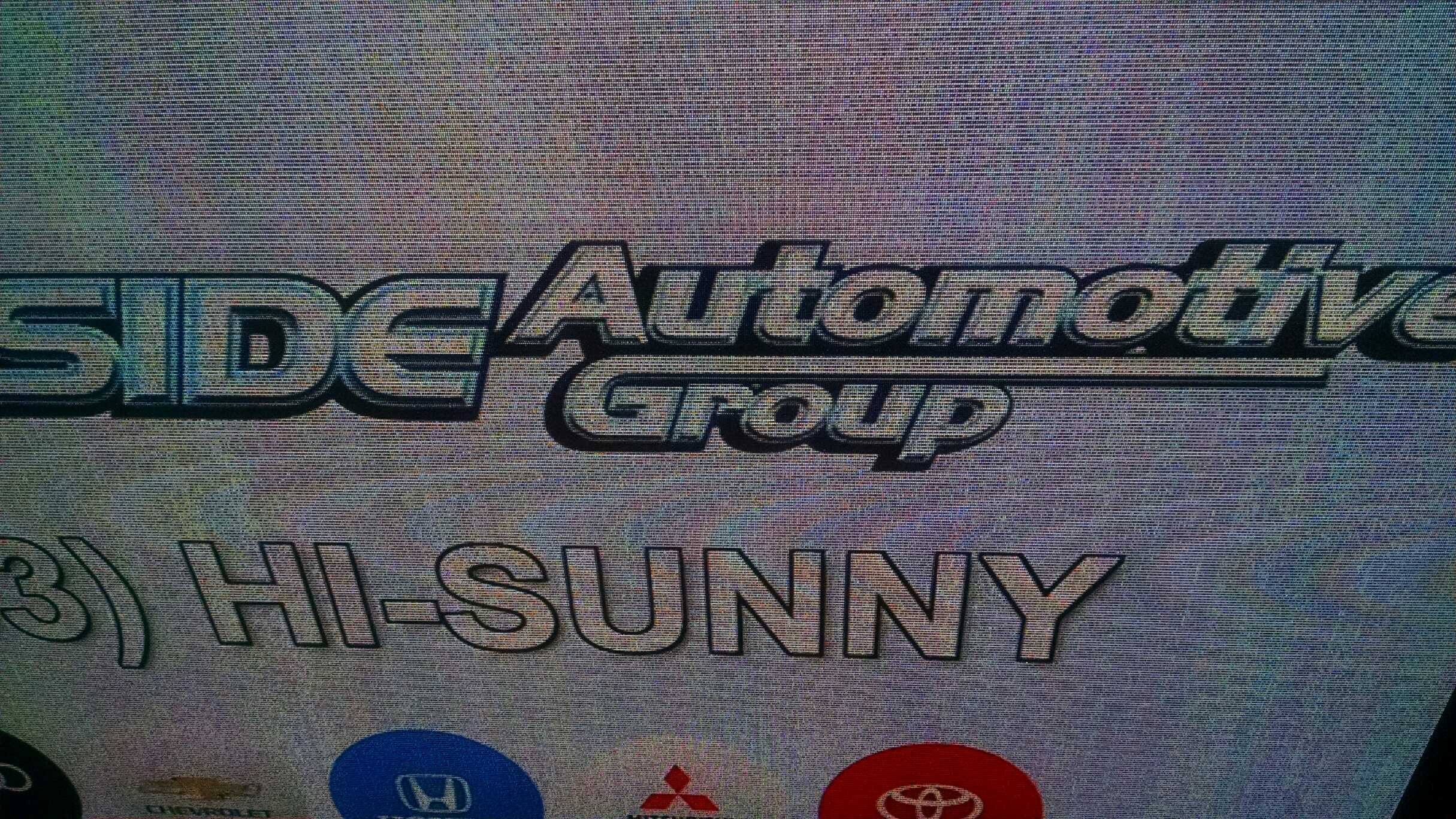

                    Well fellow plasma enthusiasts ... I have been through two Y sus boards (used)

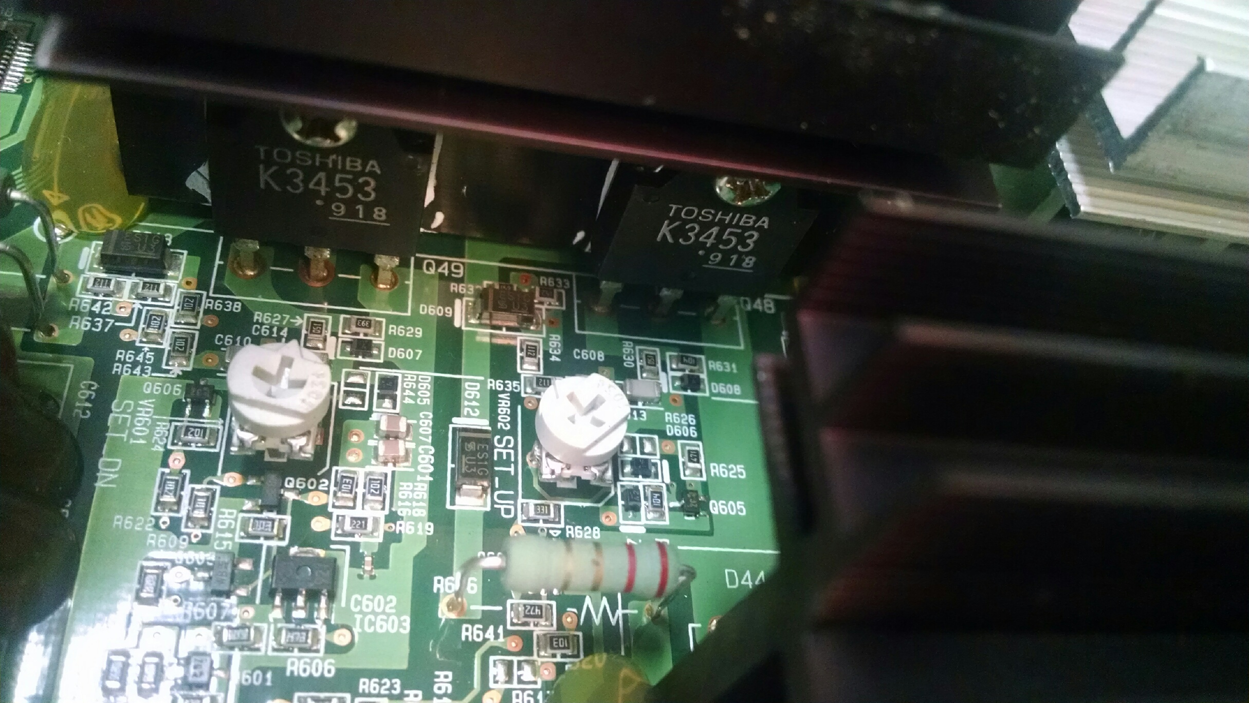

                    All voltages are within specifications. There is a heat sink with two K3453 Field Effect Transistors on the Y sus that gets Hot faster than the rest .
                    Pic has a few sparkles at turn on that go away after a minute ALL voltages were good..
                    Last Ysus played about half an hour then a little pop set when dark with images..
                    Any THOUGHTS

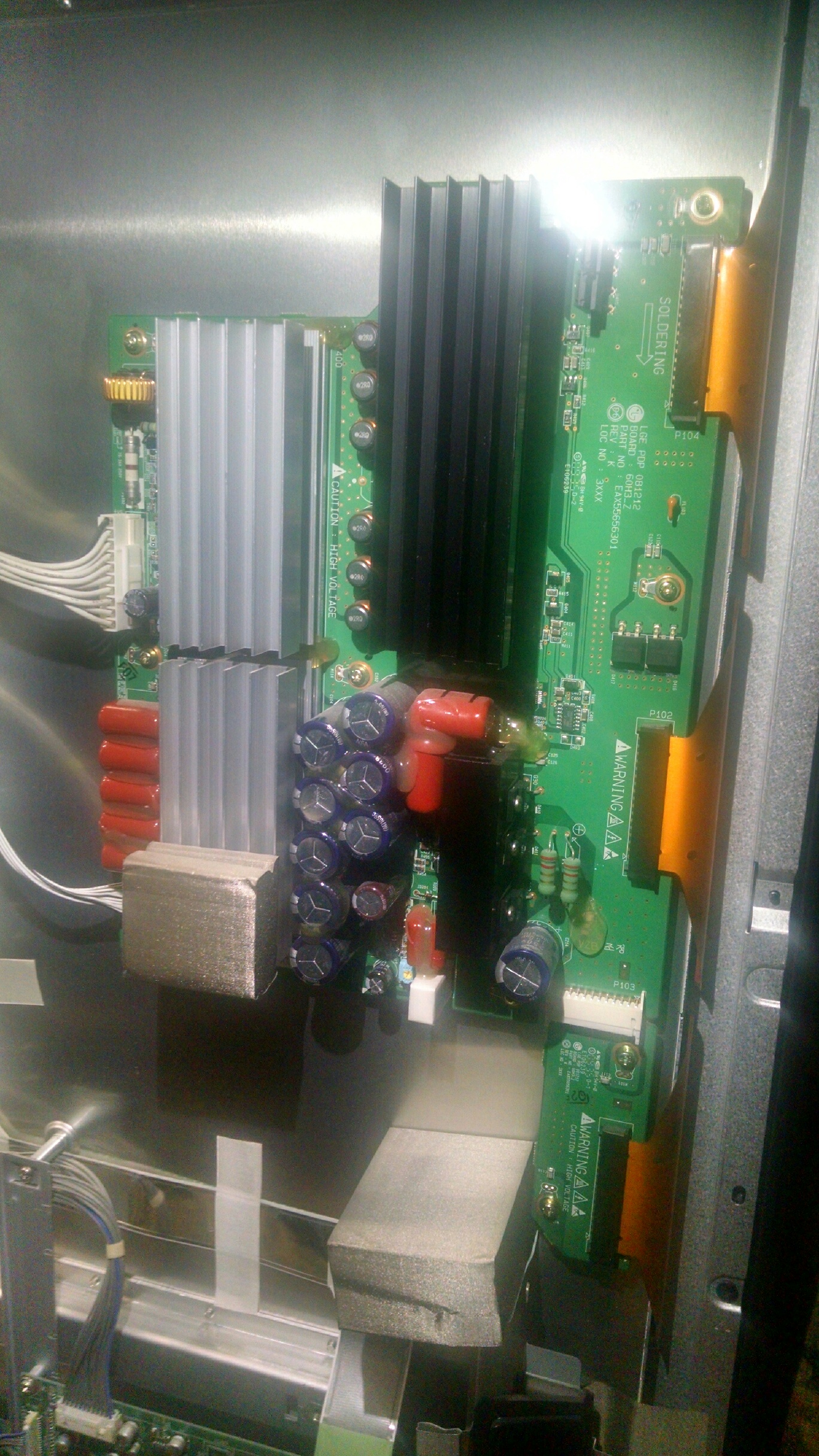

                      TVBOB:
                      You are mis-reading other people's replies. Users "chrismurphy" and "Andrew F. Ali" have told you to look at Z SUS board, not the Y SUS board.
                      Z. Not Y.
                      Z SUS is commonly associated with mal-discharge issues.

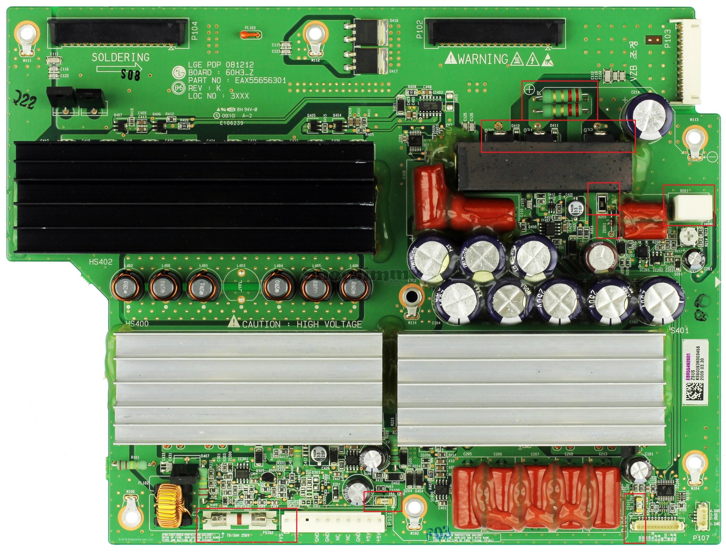

                      Please post photos of your YSUS and ZSUS board.
                      If you have ZSUS board EAX55656301 / EBR55492601 you may want to check components around the small heatsink Q30, Q31, Q32, large white ceramic resistor R201 (5 ohm or 10 ohm I think?), resistor R209 (1 ohm), zener diode ZD201 (15V or 16V), both 0.22 ohm fusible resistors (red red gold gold), and 6.3A fuse FS102 10A fuse FS100, 2.5A fuse FS101.
                      You should also check other mosfets or igbts on the other heatsinks.
                      Not saying any of these are your problem, but I would start there.

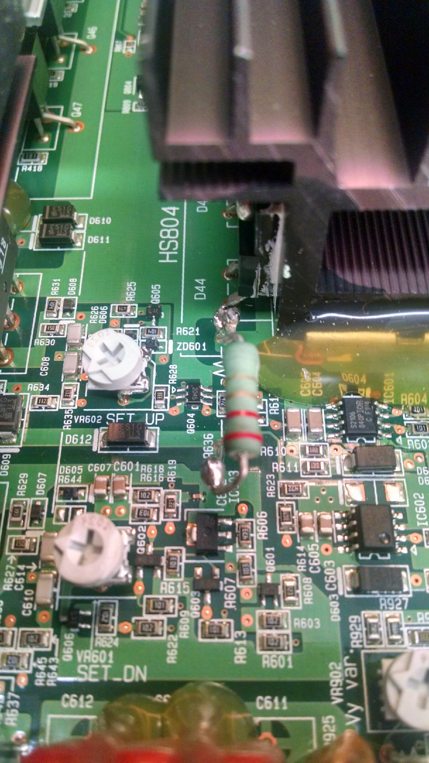

                        I revisited my Ysus that I heard Pop
                        Removed board and removed the dampening tape.
                        Checked all Major semiconductors for shorts and found NONE.
                        Reinstalled Ysus and I had a pix for about 5 min and goes very dark.
                        Turn the set off for about 10/15 min and pix is back on and goes dark again.
                        I know I heard something pop butt found nothing shorted and all voltages
                        (vs-194,va-67,-vy-178,vsc-140,Zbias-104) Good
                        I must be barking up the wrong tree.
                        I will be looking at the Zsus EBR55492601 Thanks Again

                          TVBOB:
                          Please re-read my previous reply. The panel is priming with a raster and apparent video, so I think the YSUS is working (which is why you did not find any shorts).
                          Mal-discharge is usually ZSUS problem. Check the parts in the description of my previous reply. See attached image.
                          Also, you uploaded an image with two 2SK3453 Toshiba MOSFETS. Can you please measure the resistance of that 0.22 ohm fusible resistor in the photo? Looks like it has a pinhole in it and could be suspect. In fact, measure all of the low resistance fusible resistors on YSUS and ZSUS boards.
                          • Tvbob
                            tvbob
                            • 204
                            Re: LG 60ps60
                            You are right again That .22 resistor is open (that is what i heard pop)
                            My eves are not that good
                            That resistor also must of opened on the other Ysus boards that I had in there.

                              Did you check the components on ZSUS I listed and highlighted in the photo I attached?

                                I changed the .22 ohm 1watt (i think) resistor that was open on the Ysus.
                                I also checked the components that unspub01 suggested along with the other power semiconductors on the Zsus No dead shorts.

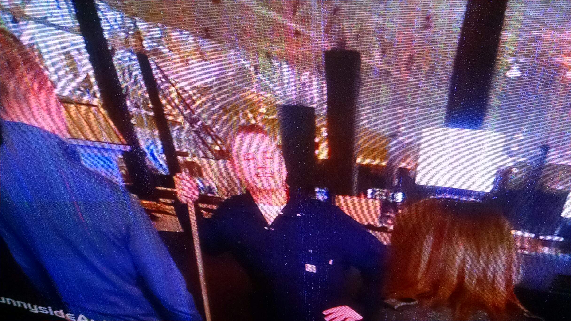

                                The new resistor over heats immediately and still shows a picture with some vertical lines. Also tried Removing one of the buffers (upper or lower) still overheats
                                Unpluged power cable to Zsus There is no picture but do have raster, and resistor still overheats.
                                I sent my old Ysus boards to a repair shop in Texas. They do a lot of plasma board repair on ebay, Thy told me they can't service them. I let them keep the old boards.
                                I am going to oder a board... either a 4th Ysus or Zsus. Chime in please.

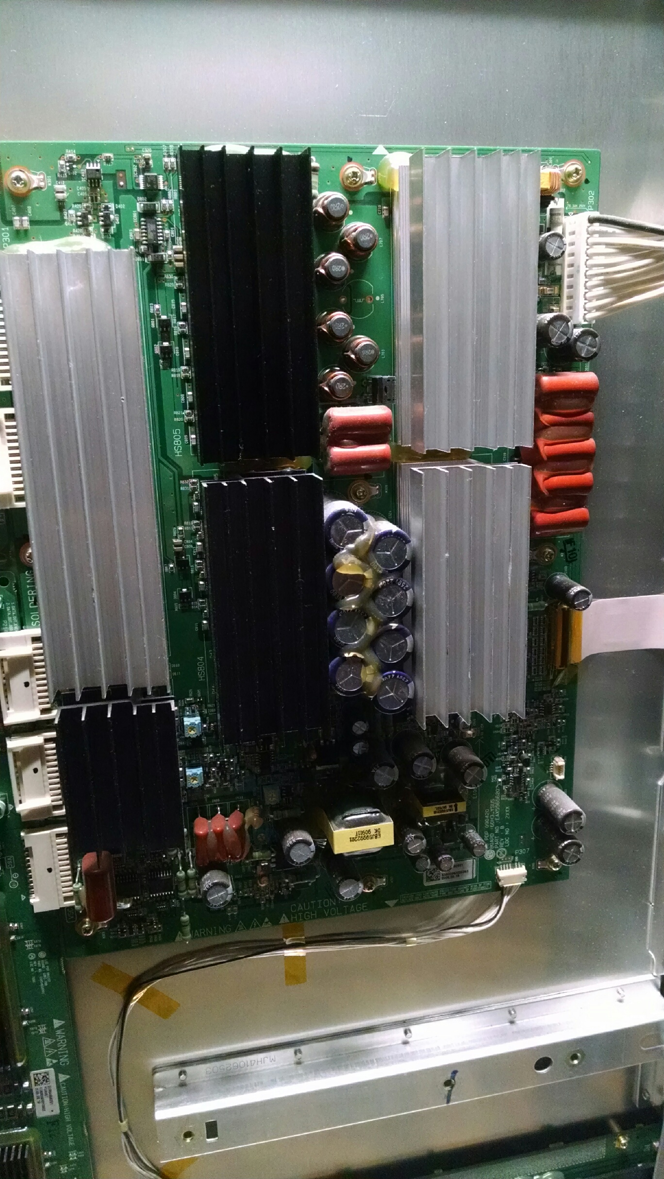

                                    The company Is coppell tv repair.In All fairness They Did send me a paypal invoice for return shipping to get my boards back.
                                    (here are the pic's with hot resistor)
                                    Buffers for this set are on the endangered species list...Should I try and turn set on with NO buffers connected to see if resistor get hot?
                                    I have did the static check for shorts using my DVM many times. There are more upper buffers available than the lower .
                                    maybe oder a upper buffer and try it solo to see if resistor gets hot
