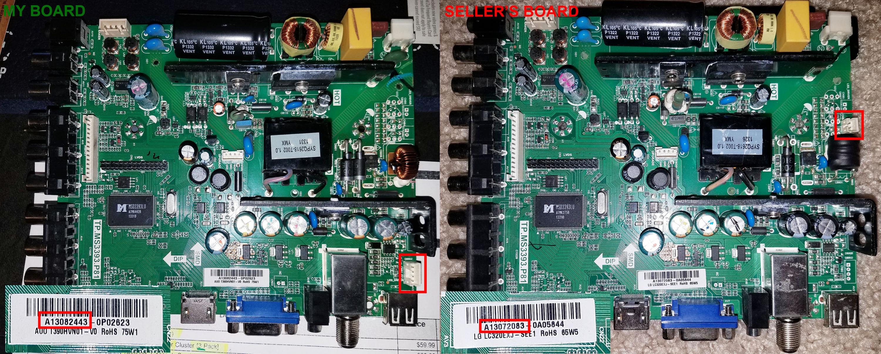

    Hi all!

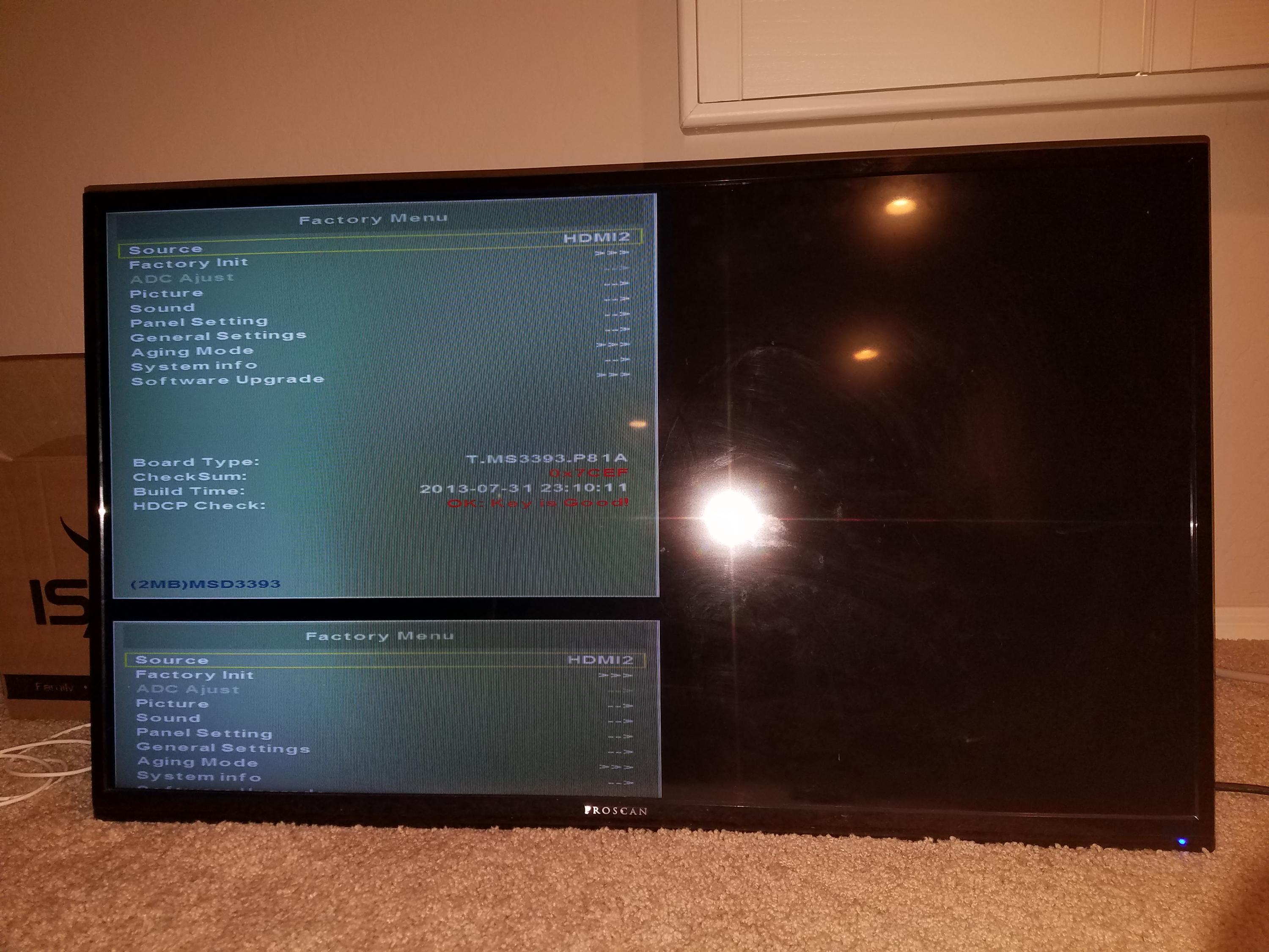

    I got this PDLED3992A TV for free locally. No standby light. Would not power on. It has a single board inside that controls everything. I bought a replacement off of eBay, but the seller sent me the wrong part (my board is A13082443, they sent A13072083). The LED header for the board was in the wrong position. The seller refunded my money, so I decided to try to take the LED header off my old board and put it on this new board. Well, the TV powers up, but it looks like this board is configured for the wrong panel type (I looked up the part number and this board is designed for a 720p TV, while the one I have is 1080p)
    So, I figured I'd poke around the service menu and see if I could change the panel type. I got into the service menu by pressing the menu button on the TV while typing 1147 on the remote. But, alas, I couldn't find the right setting. I didn't want to risk doing things like "Reset panel data" or "Reset firmware" because I wasn't sure what those would doe.
    My questions...
    -Does anyone know the right setting to set the correct panel type for my TV?
    -Is it possible? Or do I need a new firmware or eeprom?
    -If I need a new firmware or eeprom, does anyone know where I can get the firmware? Will that work? Or even if I update the firmware, will I still need a new EEPROM?
    -If I need a new EEPROM, does anyone have the correct EEPROM image for this TV?

    The board that the seller sent you is for a different screen type. You can read the screen type below the part number. The one that he sent you is for 32 inch tvs, but your tv is 39 inch. Anyway you can try changing the eeprom it must work. Good luck!

      Yes, I know, but what I was getting at is - is it possible to change the screen type in the service menu? Or can I fix it by flashing the firmware for my set to this board through the service menu options? Or does it require completely replacing the EEPROM?
      If it requires replacing the EEPROM, does anyone have the EEPROM image? (I have a DediProg and can probably flash it).

        those boards are not populated the same . at least one diode and a coil different .

          Just solder your old eeprom into the board that you recieved from the seller and you are done.
            Good idea but I don't have the tools to do SM work. If no one replies with a way to update this new board to work with my TV, I will give it a try.
