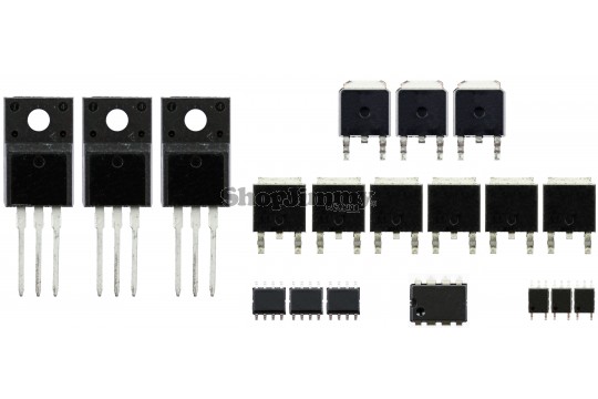

            Disconnect the plug on the Y-sus board and check the resistance between VS and ground on the Y-sus and also on the X-sus boards
            Shopjimmy has a X/Y board repair kit, I would check the fets etc. for shorts.
