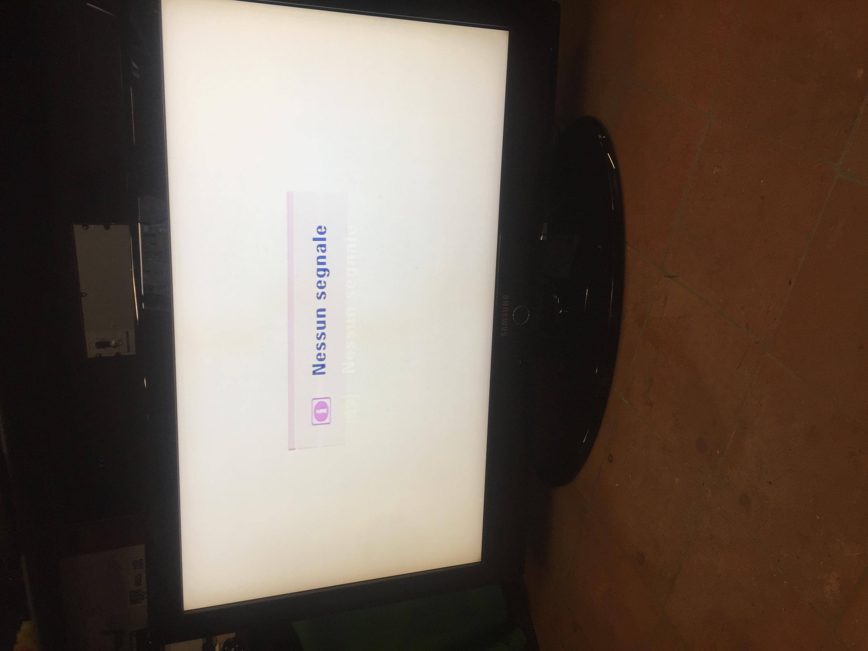

    Hello guys!
    so there's Samsung le37m86bdx/xec which arrived with defect - switched off after a while. Solved that soldering the contacts which seemed to have micro crepes. Now it goes negative after few minutes of working should i check t-con? resolder chip contacts or just change it? Thank you!
  • Davi.p
    Hobbist Tech
    • Sep 2009
    • 4543
    • Italy - Milan
    Re: Samsung le37m86bdx/xec (le37m86bd) goes negative after few minutes of working
    Not good English, express yourself better... as15 chip on tcon to replace!
    • ducky29
      • Dec 2015
      • 369
      • Europe
      Check with your finger if the as15 is hot. Replace as15 or tcon
      • mitsukiso
        • Sep 2017
        • 31
        • Италия
        as i thought, Thank you guys!
