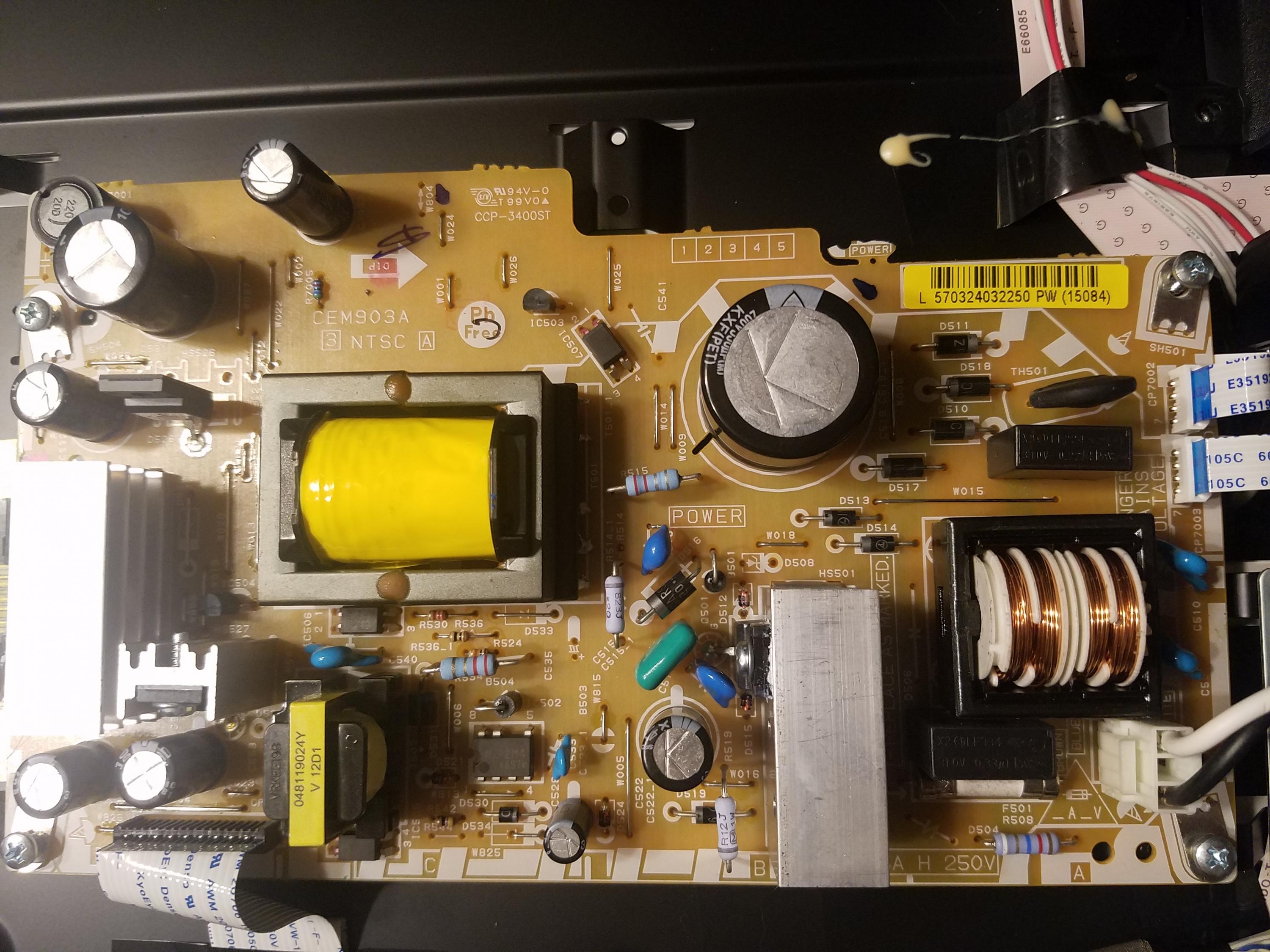

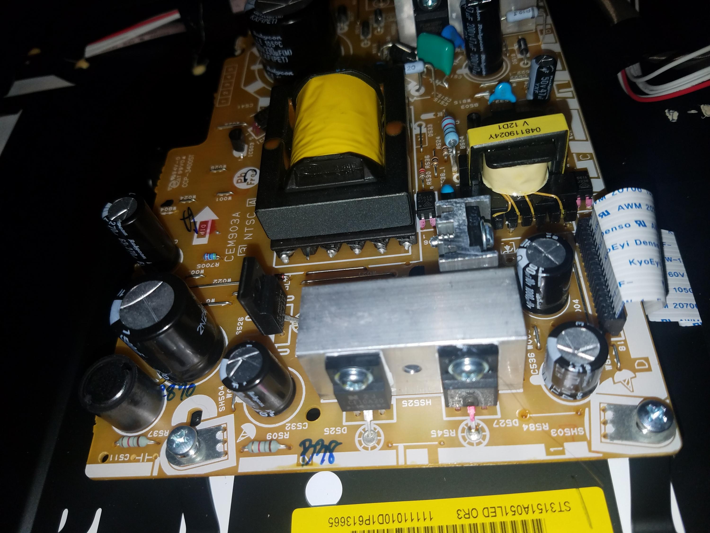

    Just noticed the brand new TV combo I got for 75 bucks is from 2013 and will not turn on, checked all the voltages and im getting 6VSB and all the regs are correct its just giving 6 volts instead of 5, the red LED on the front panel works, and when i unplug the unit the backlight flashes and thats all i can get from her... tested all the caps and they were perfect except one 63v 270UF which consistently reads 235-238UF.. any help? im leaving friday for a road trip in my RV and really want to watch old ass DVD's instead of reading a stupid book..
    SANSUI SLEDVD329A
    Power Supply Board Number cem903a

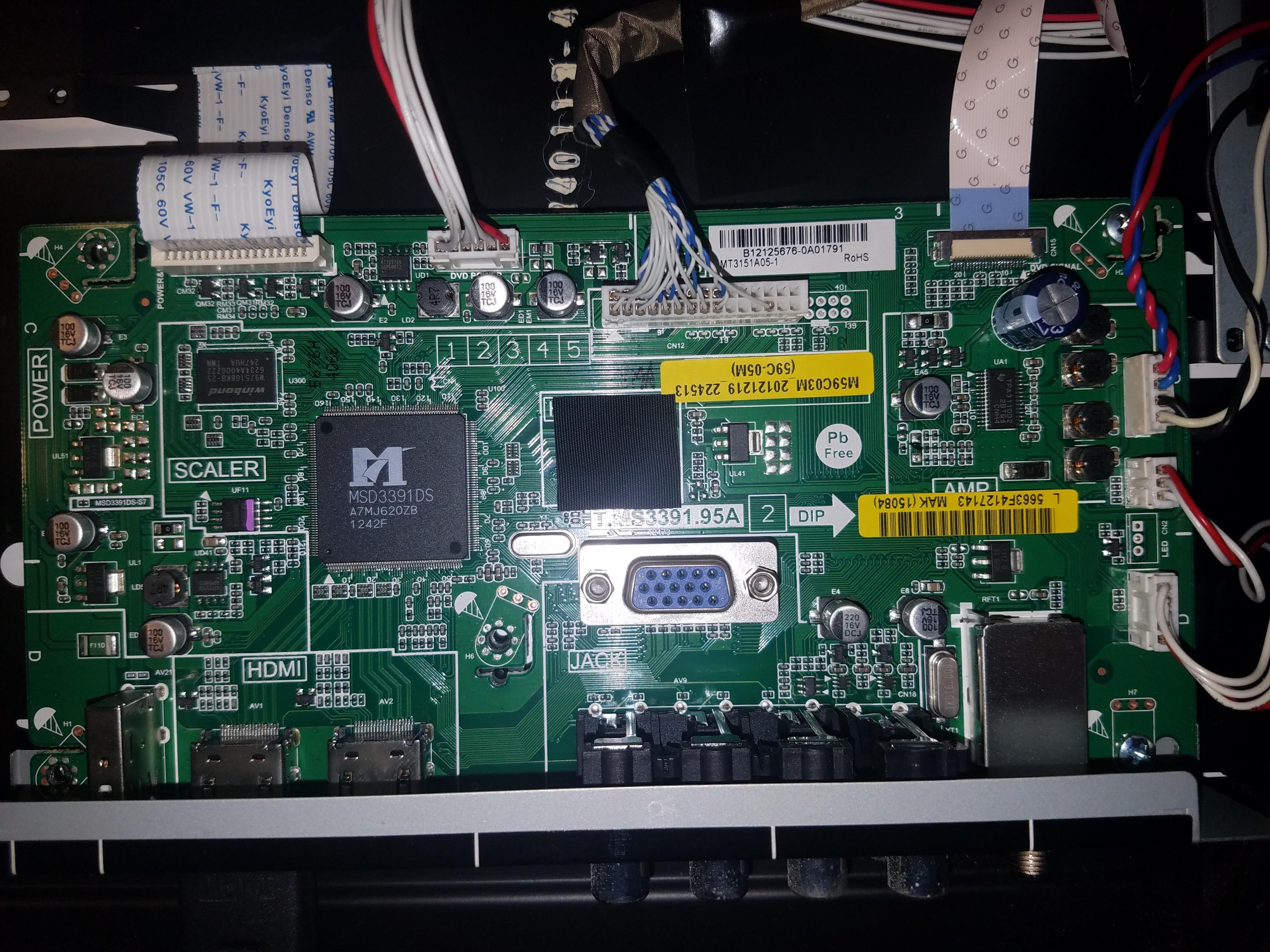

    With that said capacitor is not really all that bad but you can go ahead and change it Could we get photos of the PSU and the connectors and the main Bd. that are clear and focused?

      Can you post some photo's of your circuit boards. What voltage do you have between the two legs of the large capacitor rated at 450V DC.
            Rated 200v and 330uf, tested at 162v

              Re: sansui dvd combo tv, brand new from 2013
              As it should be with nominal 115-120 line voltage.

                      This is not a FUNAI, it appears to be an Orion product. Hence the labelled main board & high quality capacitors on the PCB.
                      It's not all that bad, tbh.

                        This manual is not exact but uses a similar power supply [CEM842] Standby is listed at 5.5 volts, power on is at pin 4 (which looks right according to shopjimmy picture of your board)

                          OK, finally got back to trying to fix this thing.. The 1117B AD is wonky I believe, input is 4.48v output is 1.843 and ground has .578v... wtf..
