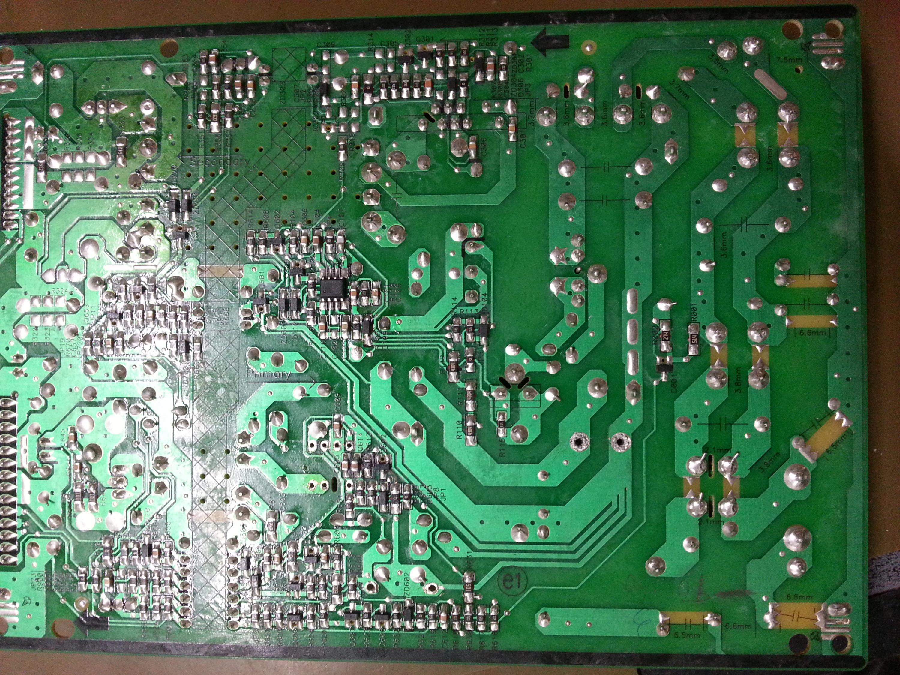

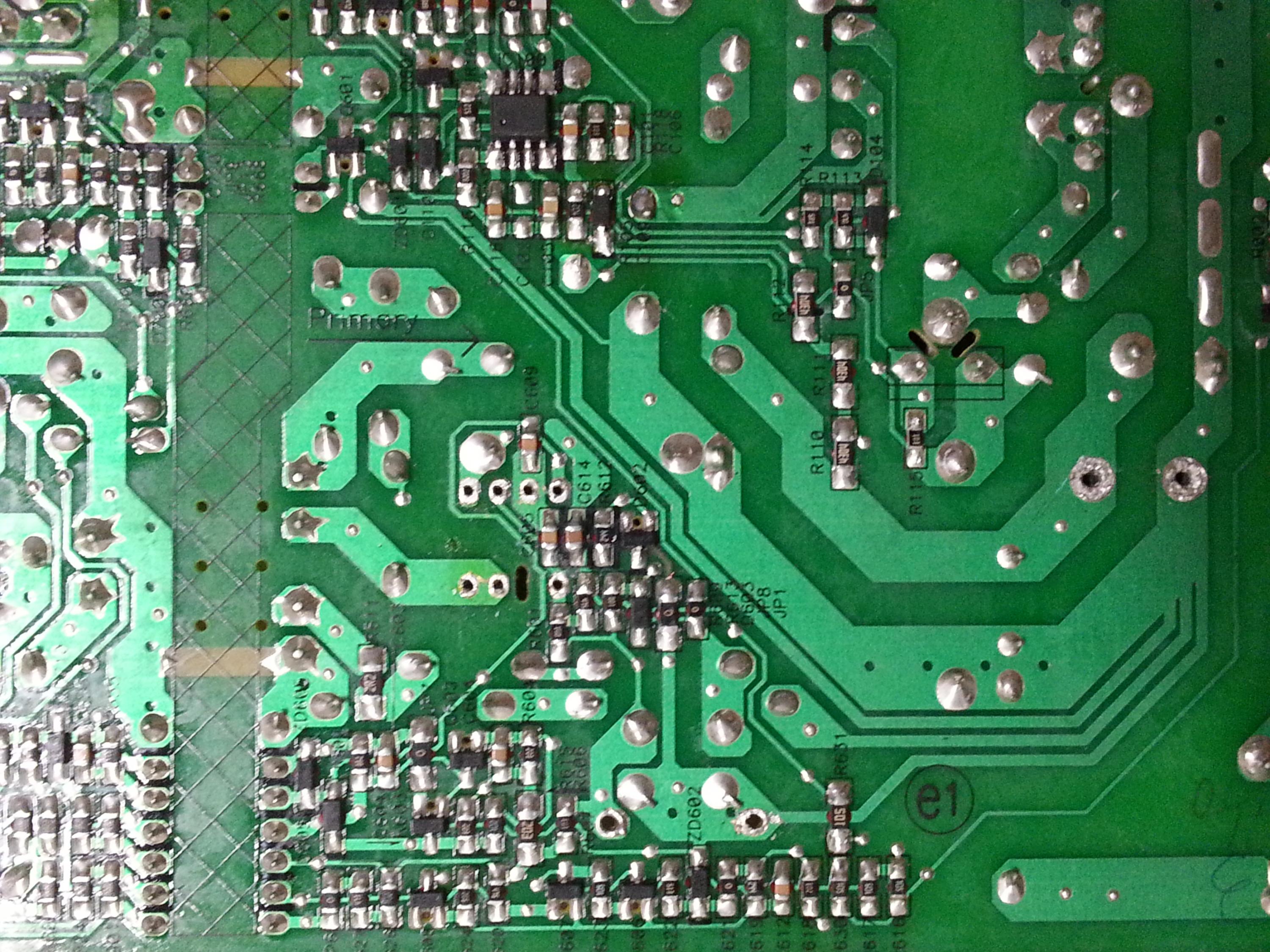

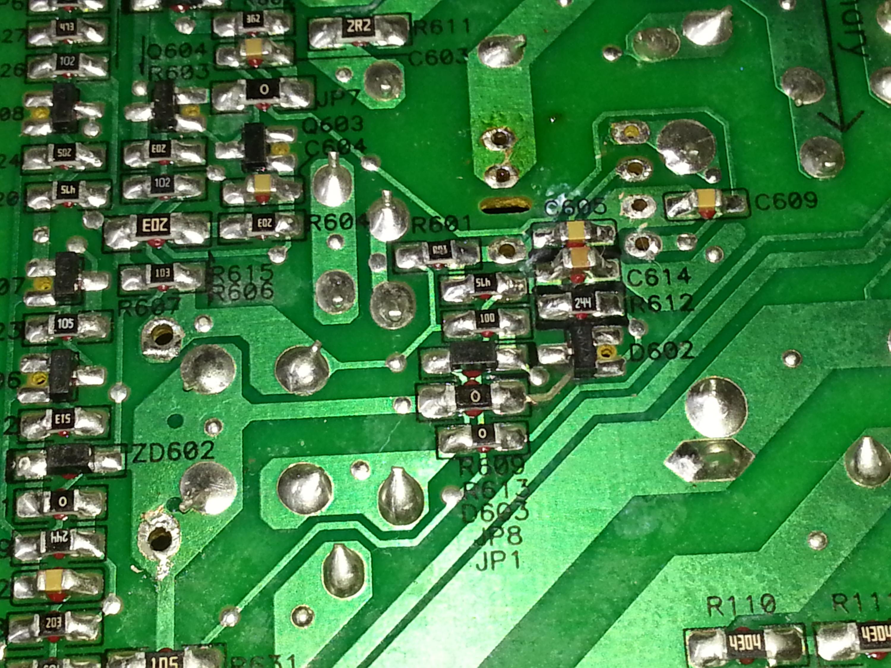

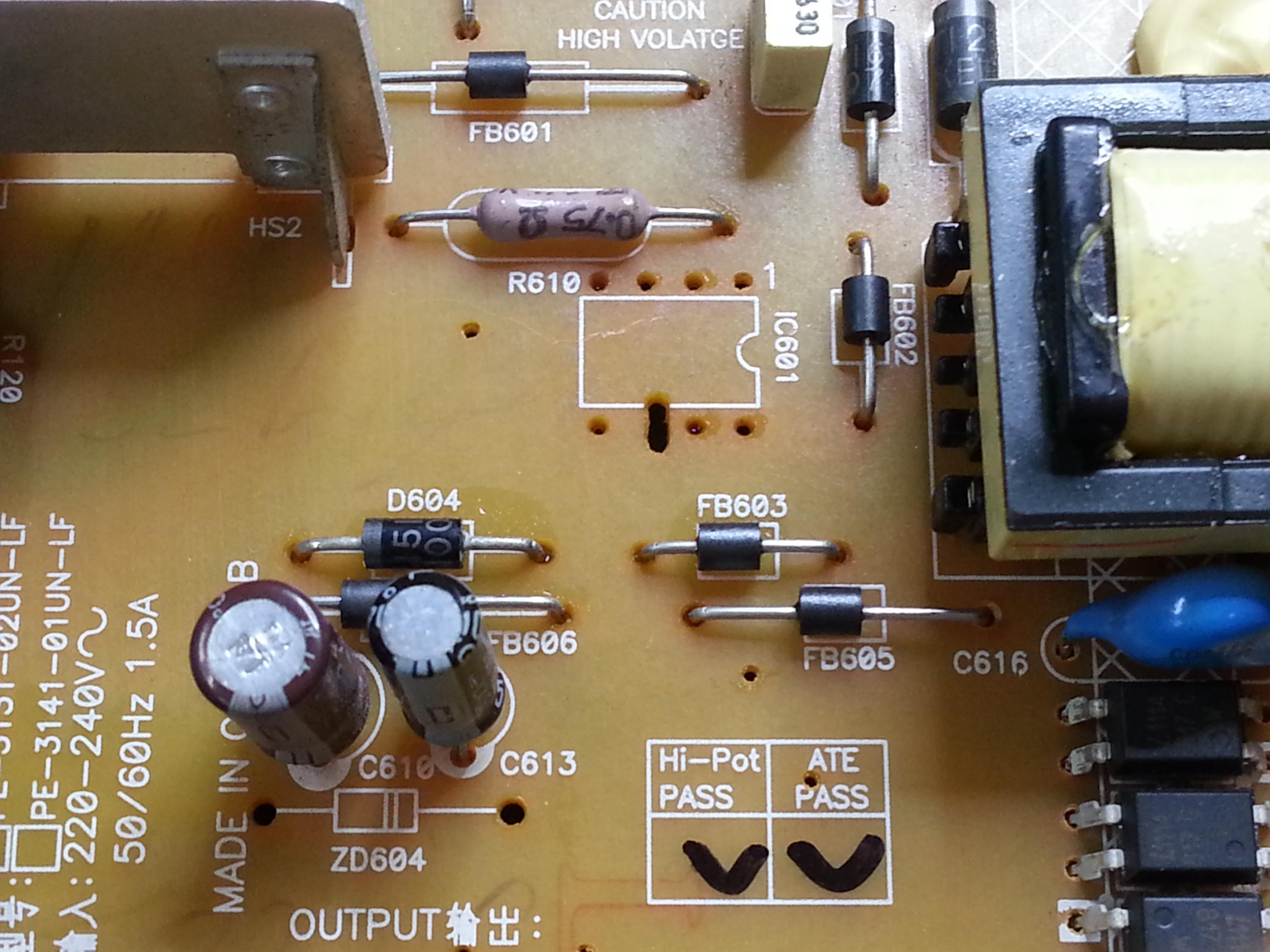

      Re: Toshiba 32av833G PSU schematic (missing parts)
      Ok guys here's some pictures of this board. I got myself an a6069H after all, which is hopefully the correct one. Here's the datasheet.
      The other missing part is ZD604 visible in the picture where IC601 is also gone. On the back though.....this is where things start to get Lionel Messi
      There's a burnt trace between JP8 (the larger 0ohm resistor) and D602. D602 appears to be good, so hopefully I can rebuild that trace and we're done there.
      R601 has a hole in it. I can just about make out "100" on it, so I reckon it's a 10 ohm resistor going to the VCC pin of IC601, so we're done there too hopefully.
      Now ZD604...what could the value of this possibly be ? Looking in the datasheet for the IC, the maximum VCC is 32v, so perhaps this is a 30v zener ? Trouble is if I select a value that's too high, it could fry other components not designed for that voltage. If I select a value that's too LOW, it would fry the series resistor since it's now dissipating too much power (imagine dropping a 40v line down to 30v - only 10v dropped. Now if I use a 5v zener to drop the same 40v line, that's 25v dropped - way more!). What do you guys think ? Should I got with 30 ?
        Yup, you're on the right track there.
        I kinda wish you also posted a full view of the solder side so I can make more stuff out, but so far it looks like this PSU has separate standby and main supplies, along with APFC.
        Now, the standby/offline PWM controller, APFC controller, and main PS PWM controller all likely get their power from the same primary-side auxiliary winding that is generated by the standby PWM controller.
        What I've traced so far is that the primary-side auxiliary winding first goes through SMD resistor R611 (2.2 Ohms), then ferrite bead FB603, then rectified by diode D604, and finally stored into electrolytic cap C610. From there on, power from that auxiliary rail splits for the various primary-side controllers, including the a6069H standby PWM one. So check these components and make sure they are good, if you haven't already.

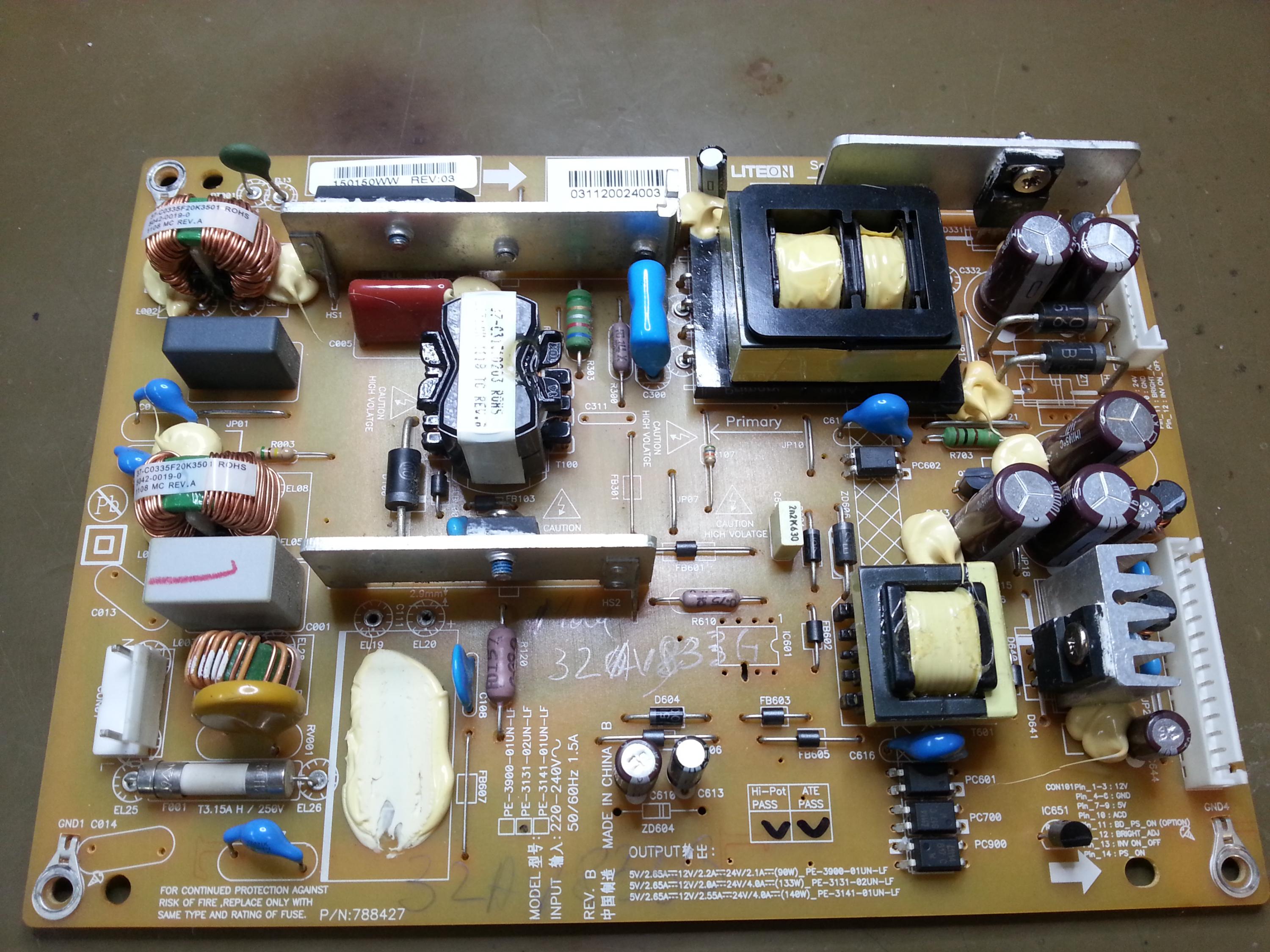

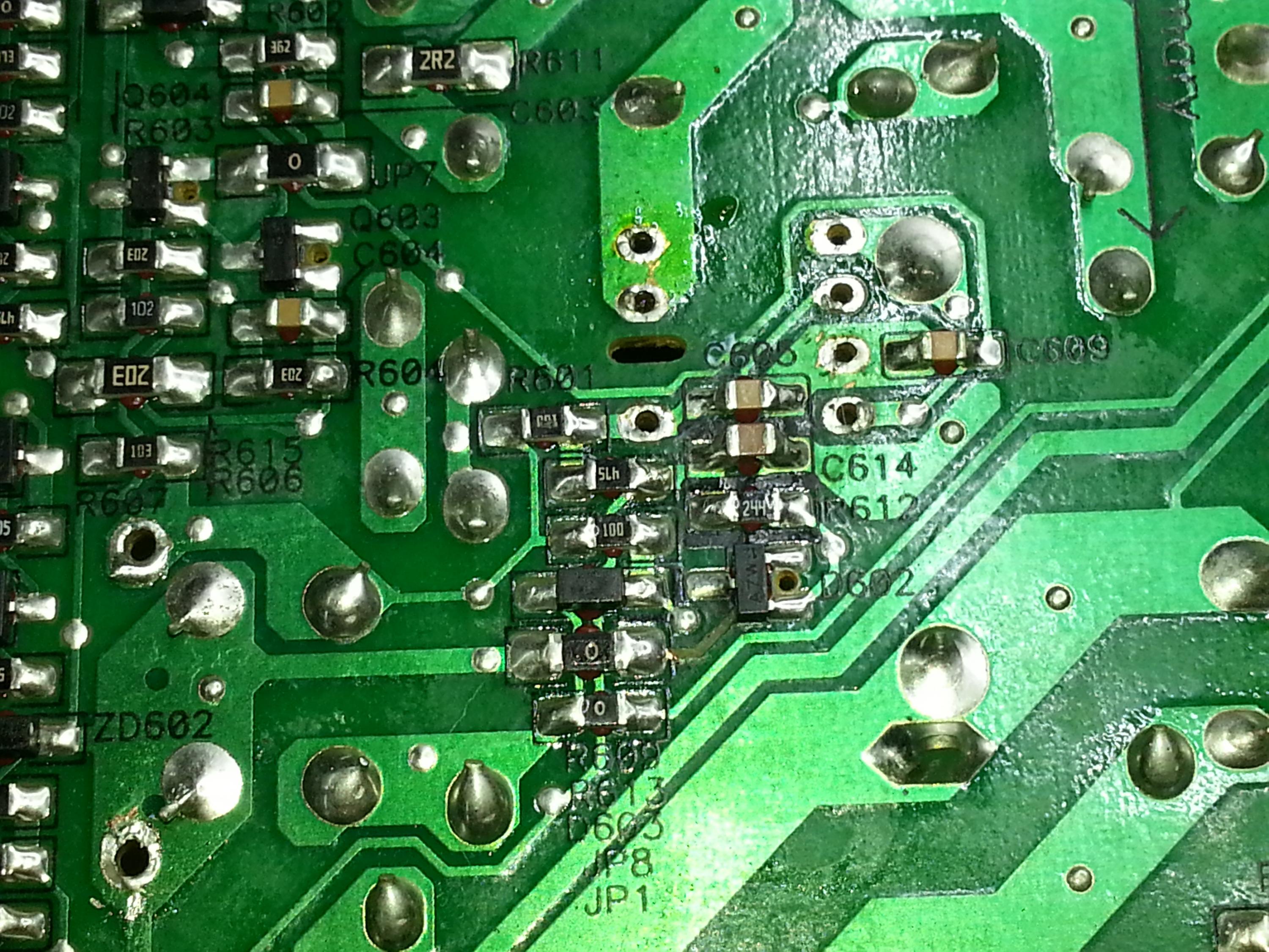

              Another reason I believe the PFC booster is fine is because funnily enough the fuse is fine, so I imagine it would've blown if it were a PFC fault.
              EDIT: Here's some more pics: one of the full board and one up close of the problematic area....hope they're clear enough. I can never get the lights to shine properly.....
                I always do the lightbulb test when repairing PSUs, even if I know it's been fixed and there's no way it would blow again. Have done it hundreds of times now
                Ah that's right.
                I think I might have been confusing you with another member.
                Thanks. Should be helpful if you get stuck and we need to help you. But looks like you got this down pretty well. Just replace the burned parts above and hopefully all should be good. Hopefully.
                  I rebuilt that burnt trace and replaced the 10ohm resistor and now I'm waiting for my diodes to arrive - I'll go with 19v...hopefully nothing blows. I'm not worried about the IC itself, since we know that can take up to 30v, but I'm not sure the rest of the components feeding off that regulated line would be so tolerant to large voltage jumps...yikes :|
