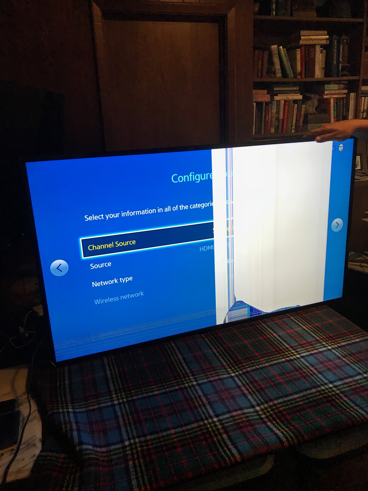

    Samsung Tv model UN50F6300AFXZA
    My tv shows two problems. First left half looks ok, but right half has vertical lines (see pictures). Second, at bottom shows a crack.
    I have tried Two main boards and a tcon board, but nothing changes. I have reconnected the ribbon cables from tcon to long panel board at the bottom many times. No changes. I have looked for anything burndt etc on the panel boards but did not see anything unusual.
    Does anyone have any thoughts? With the crack is it fixable?
    The tv may have been a victim of lightning .

    Re: Samsung Tv model UN50F6300AFXZA
    Here are pictures.
      nope, that crack is your problem and its non-repairable. Your boards are probably good and could likely be salvaged / sold. If the "lightning" came thru the window and hit the screen... maybe. :-)
