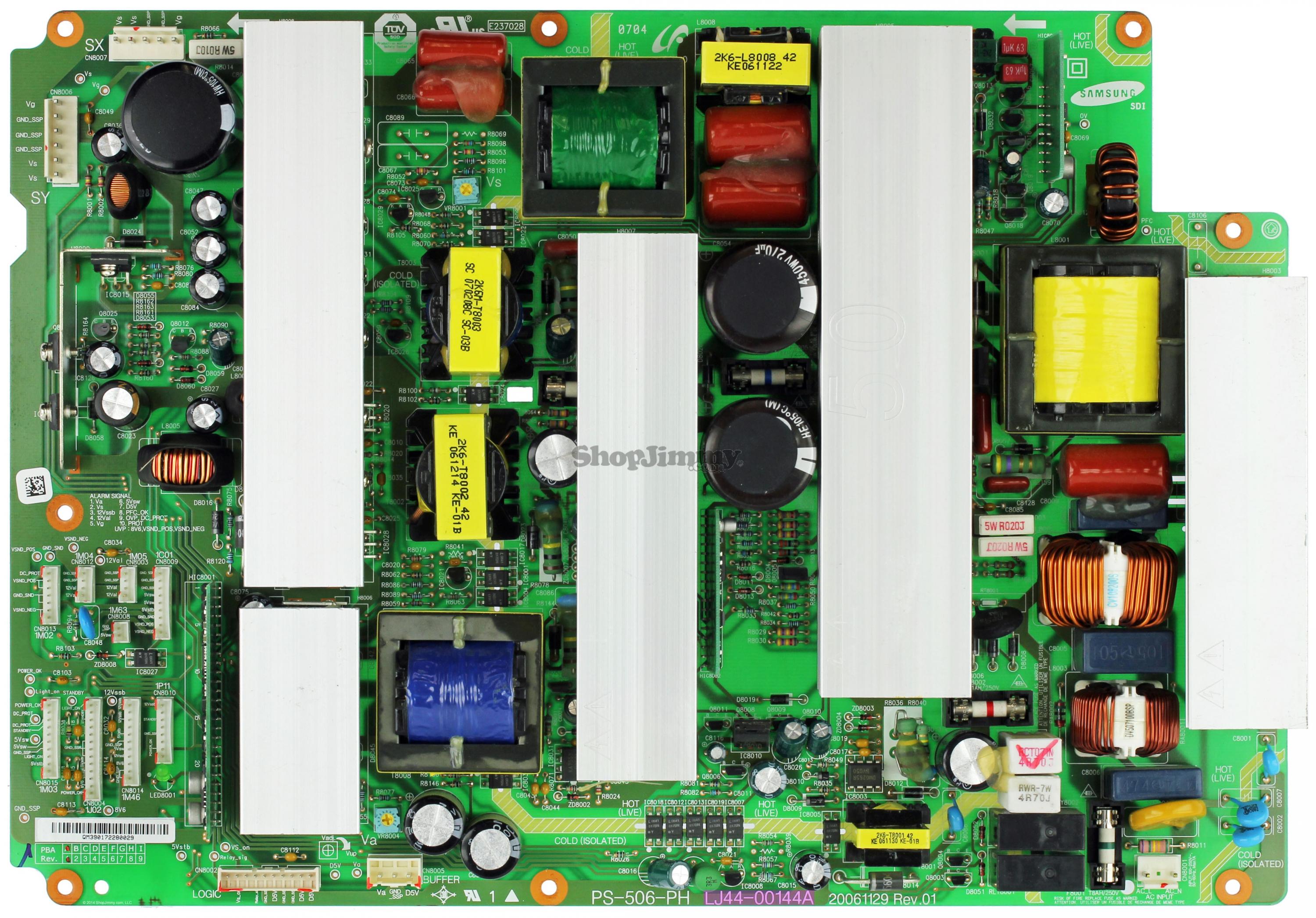

    Philips 50PFP5332D/37 part info
    Hello: This is a Plasma tv, and IC8003 has popped its top off. So i don't know the part number. Does anyone have a schematic that would help find the part number? This IC is on the power supply.
  • tvtimmy
    • Mar 2015
    • 1160
    • usa
    Re: Philips 50PFP5332D/37 part info
    Here it is from shopjimmy.
    • dick_barton
      • Aug 2015
      • 6643
      • Wales
      DM0256R (FSDM0256R)
      Check for short circuited components around it which made it disintegrate.
