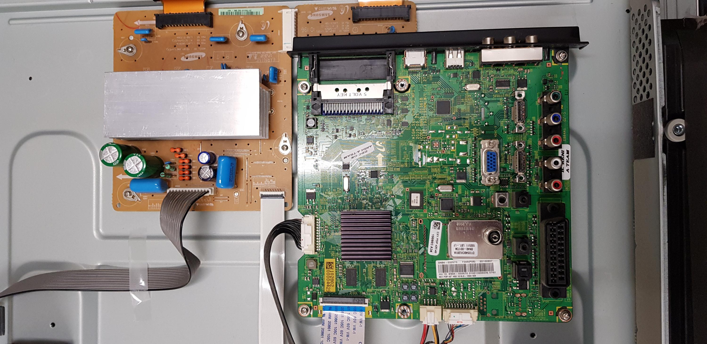

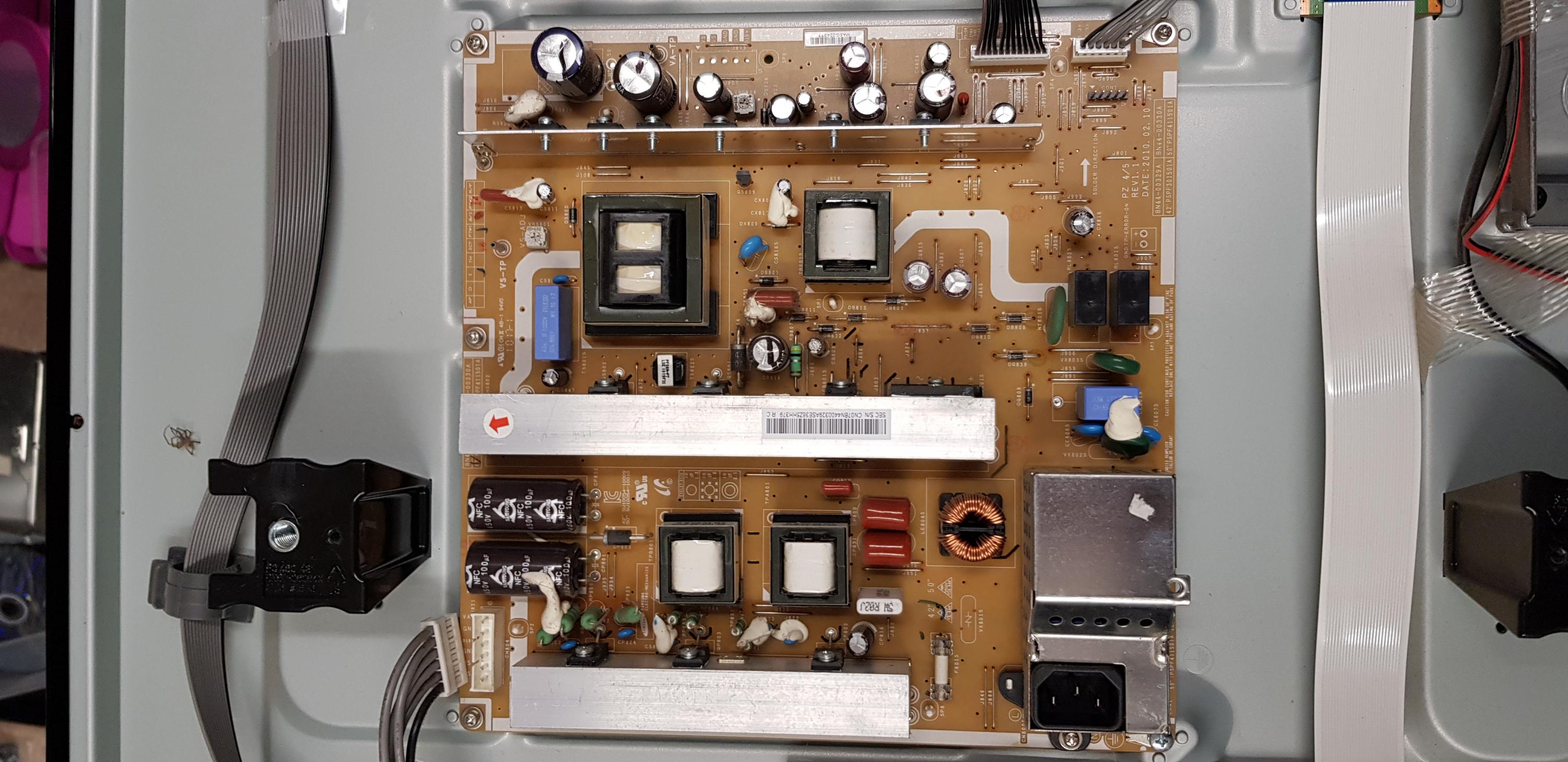

    Samsung PS42C450B1W CLICKING sound.
    I have this tv which once connected to power it clicks and won't display standby light.
    If i isolate the power board it doesnt click anymore. And there doesn't seem anything wrong with the board. Looking for some pointers thanks. Photos included

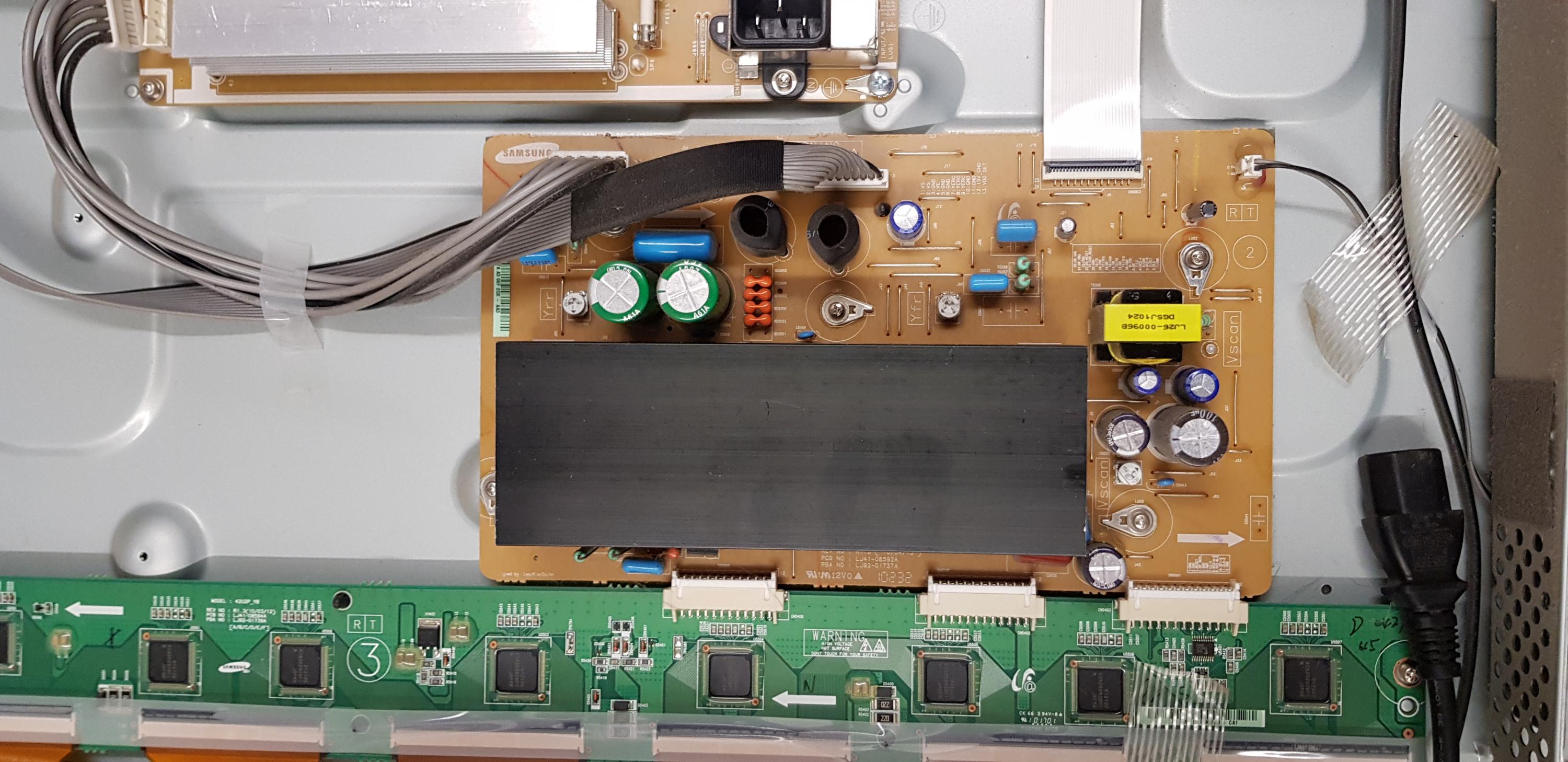

    Re: Samsung PS42C450B1W CLICKING sound.
    OK. The PSU is OK. So what you are saying is that when you disconnect the Y-main Bd. the PSU does not click anymore. You may have a bad Y-main Bd.
      Thanks for your reply. How can I be sure it's a board issue.
        Disconnect the Y-Main from the PSU. Do a diode test across Yfr and Yrr and test the ohms reading from GND and the Vscan test point. Report your findings.
