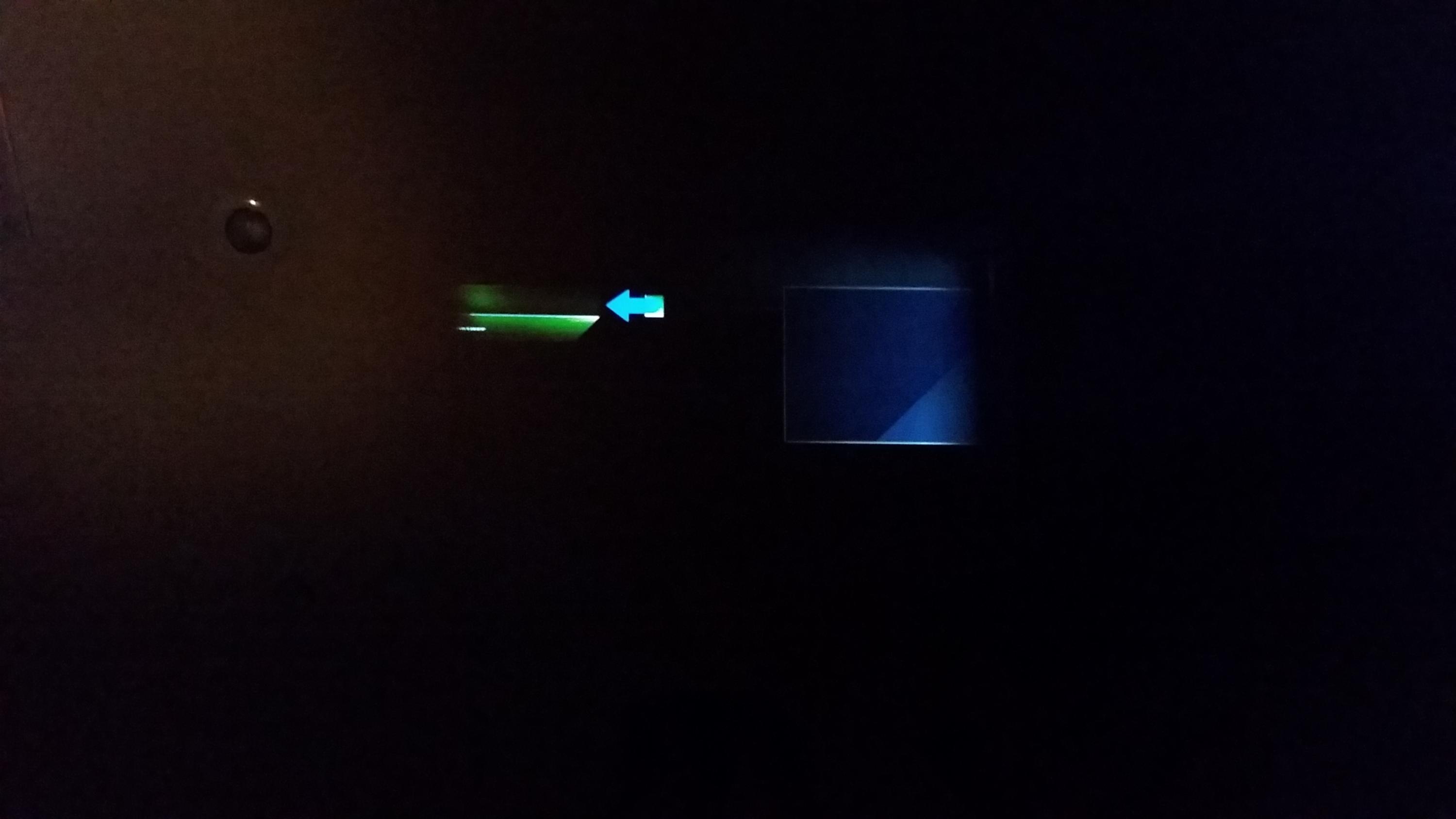

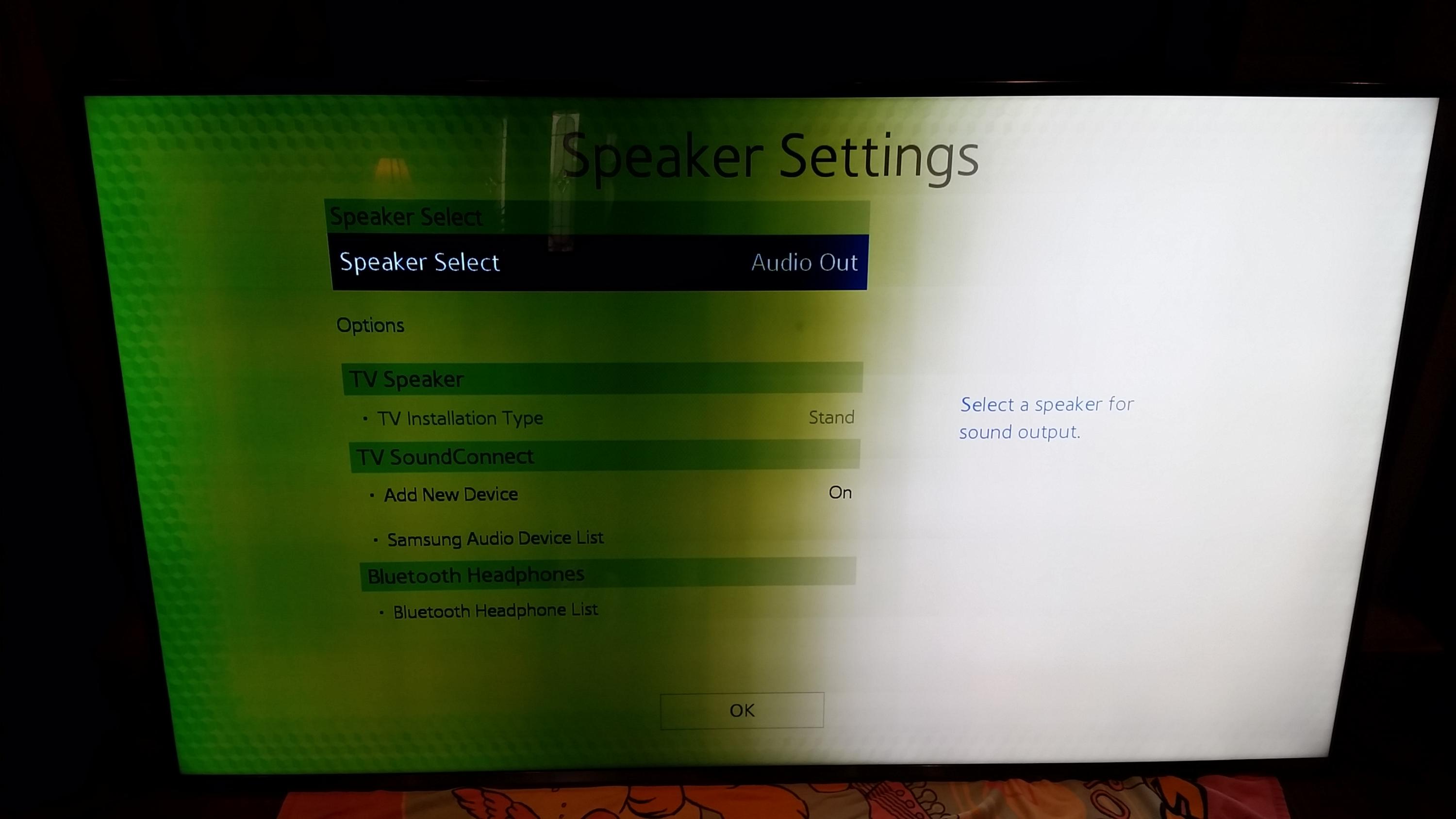

    Hi everyone. I have the above TV that had washed out colors on half of the screen. I replaced the TCON board, and now I see this on the screen.
    I get no response on my remote now, except for power on/off.
    And this little blue arrow flashes back and forth.
    Anybody ever seen this before?
    from what I can tell, the colors on this little bit that's displayed seem to be good now after the TCON board was replaced.
    Thank you.

    disconnect one of the tcon to panel cables (with power off) and check what happens. Do the same "test" with the other disconnected. This may check if there is a panel issue.

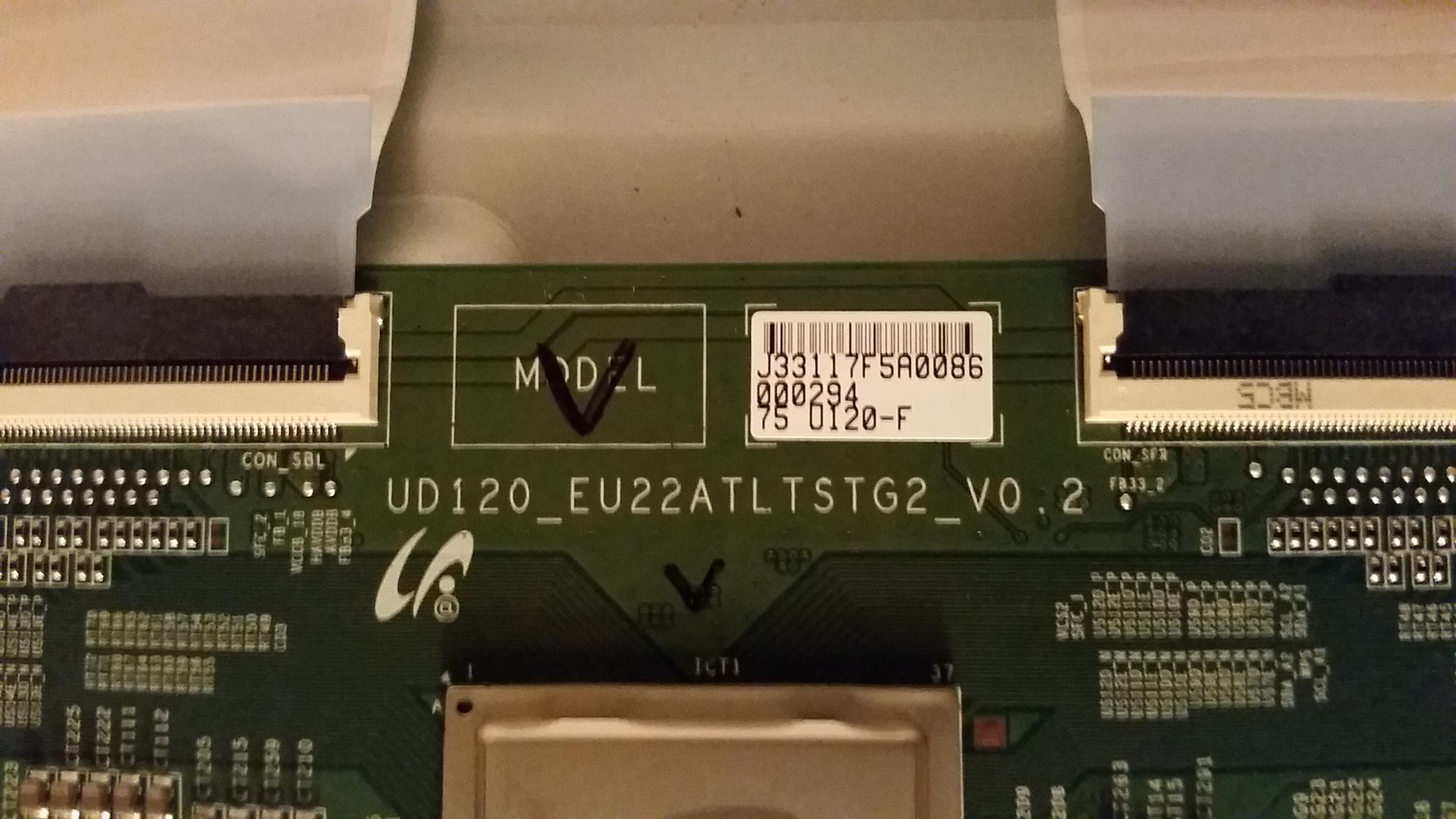

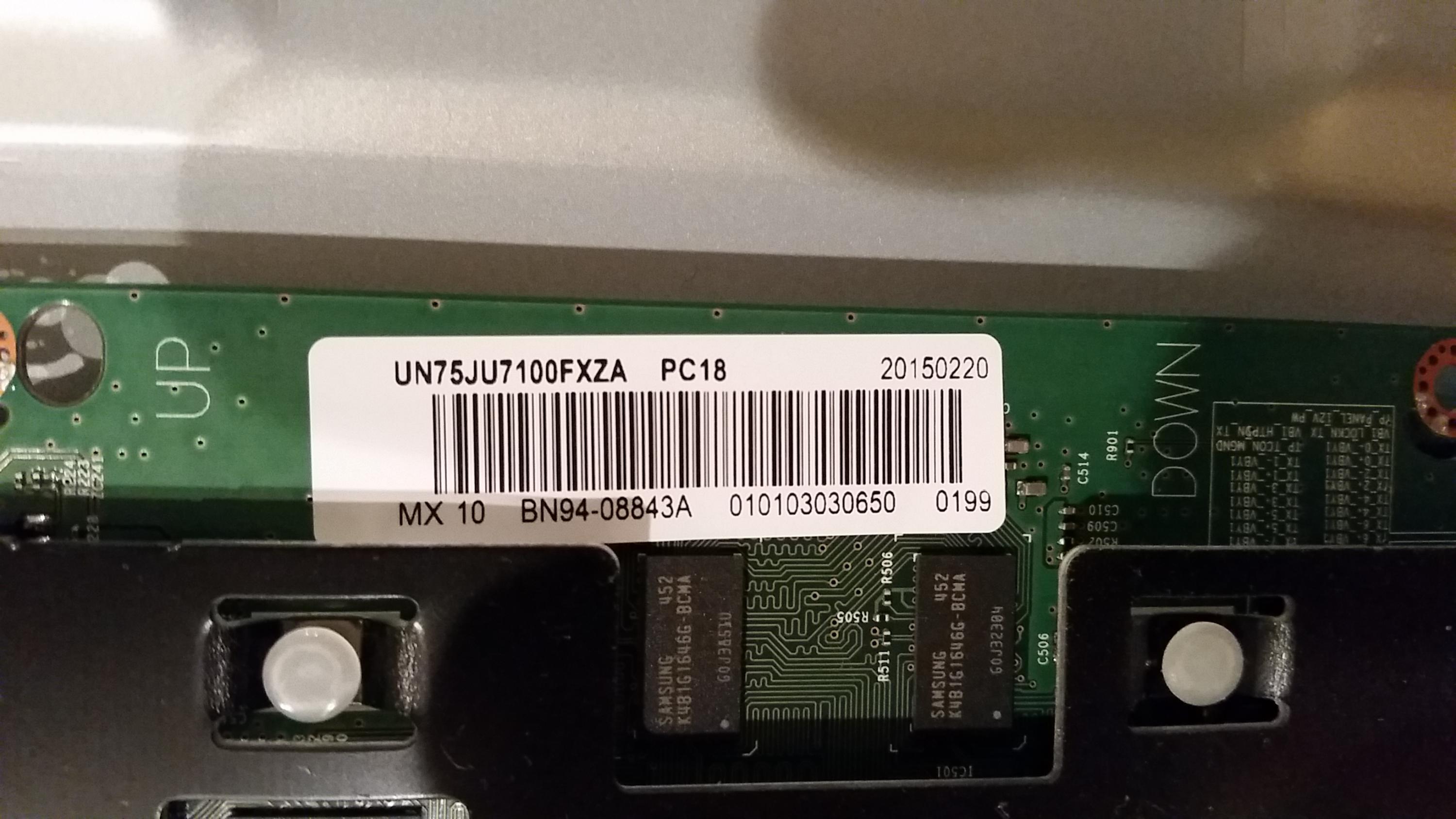

      This is a pic of my original TCON board before I replaced it.
      My replacement (used from ebay), had the correct model # on it,
      but instead of PC18, it said PC23.
      I didn't know if this could have been a possible mismatch with my mainboard or not.

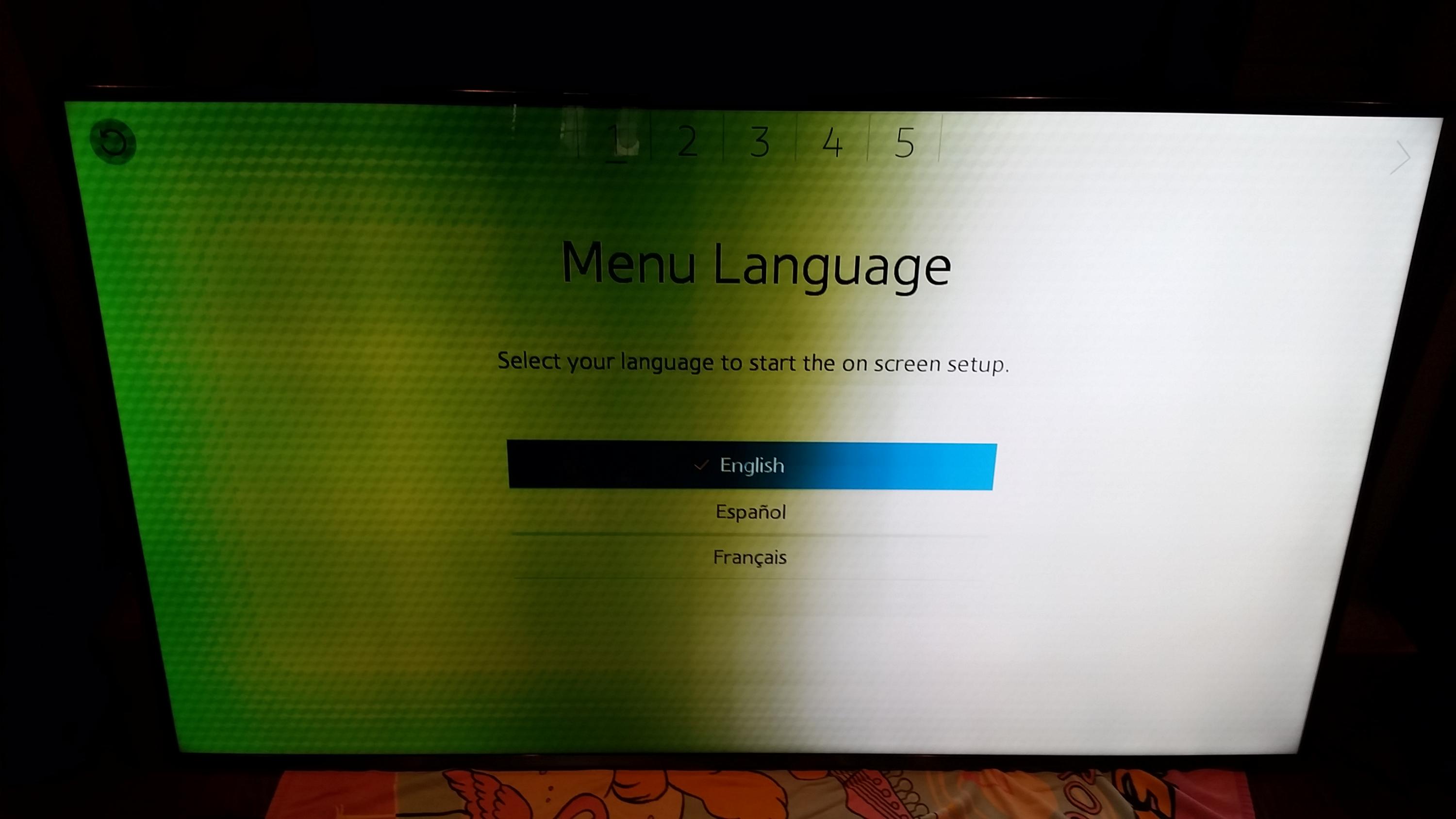

          It isn't connected to anything, internet, HDMI, etc.
          I was simply trying to get the built-in TV menus to work after I replaced the TCON board.
          Everything else worked fine on the TV before I swapped the TCON board out, with the exception of the washed out colors.
          I could go into the TV menus, play a movie, etc, even though the colors looked distorted.
          Now, the TV will only display this 1st image and won't do anything else no matter what I press on the remote.
          Sorry for the fuzzy picture.
          It looks a little fuzzy to me on the TV as well.
          It seems to be a small green box with upside down the word samsung on one side, a small blue arrow flashing back and forth to the other larger blue box.

            This looks like it might have something to do with the mini connect hub.
            But I already tried hooking it up with the same result.

              That is not the t-con board, that is the Main Subcon board, for model UN75JU100FXZA (version US02)
              Maybe the board you recieved is for a different version panel or maybe its just defective, I would install the original and see if you can get back to what you had originally.

                  It could be that the fault IS with the t-con, so remove the "new" subcon board and install the original subcon board. that should get you back to the "washed out colors on half of the screen" then troubleshoot the t-con or possible panel problem.

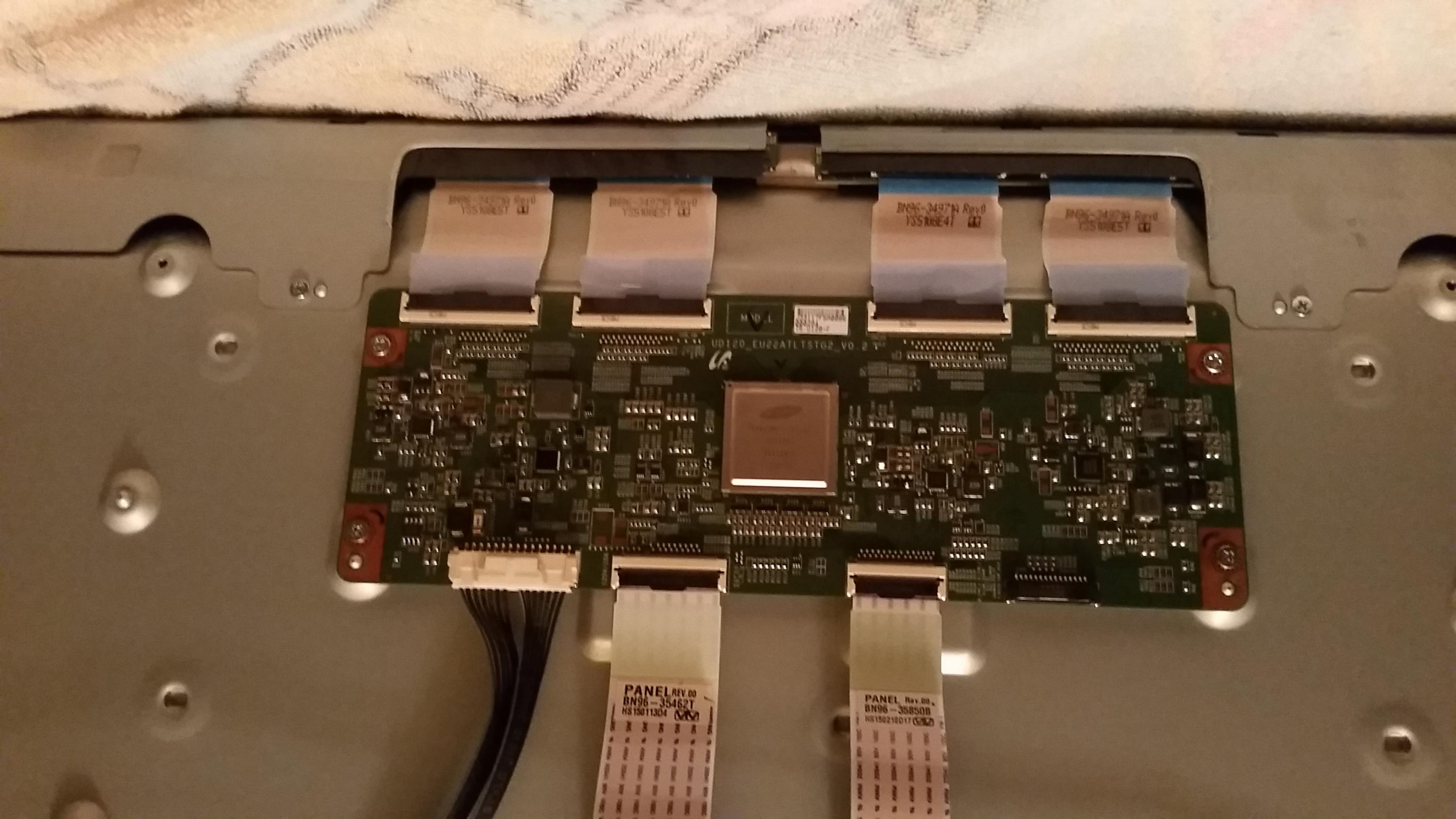

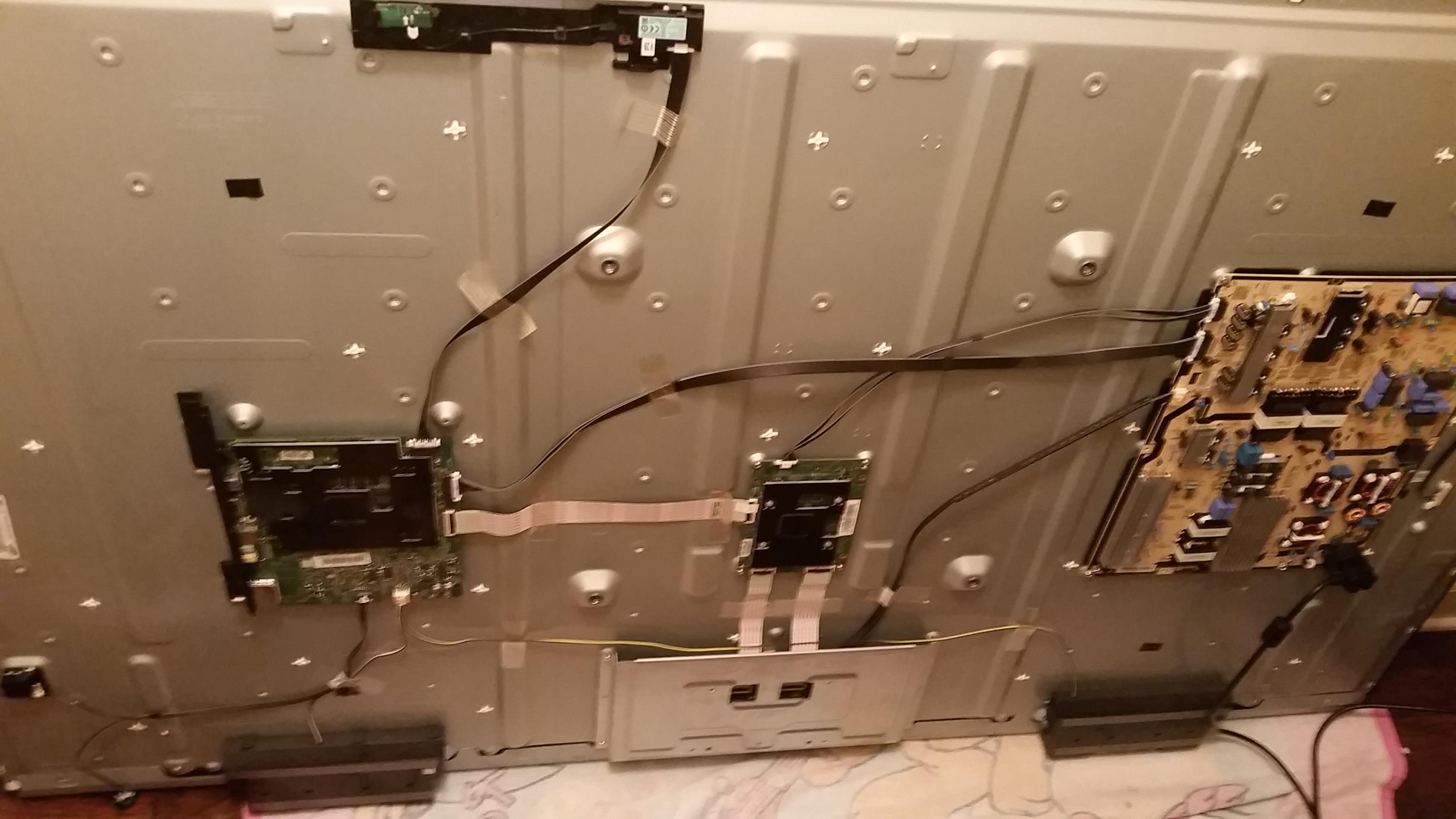

                    ok, apparently, I'm an idiot!
                    I thought I knew what the TCON board was, but evidently not.
                    I've taken new pictures of the entire rear of TV, with the original subcon board back in place. And then I took pics of what the picture looks like, and it now works again. Apparently the other subcon board I purchase wasn't the correct one for this TV, or is bad.
                    Regardless, maybe this will give me a fresh start with this.
                    And please help me confirm that this board at the very bottom of the TV is in fact the TCON board. (As i'm smacking myself in the face!)

                      there you go.... :-) Anyway, my guess is your "panel" is bad. The drivers on one side appear to have an issue... if the line in the middle isn't part of the picture and the darkness on one side is always there. You might be able to still save the panel by removing the bad side tabs. Hopefully, you can locate them easier than the tcon... :-)
                      Tons of threads about bad side tabs and the method for "saving" the set by their removal.

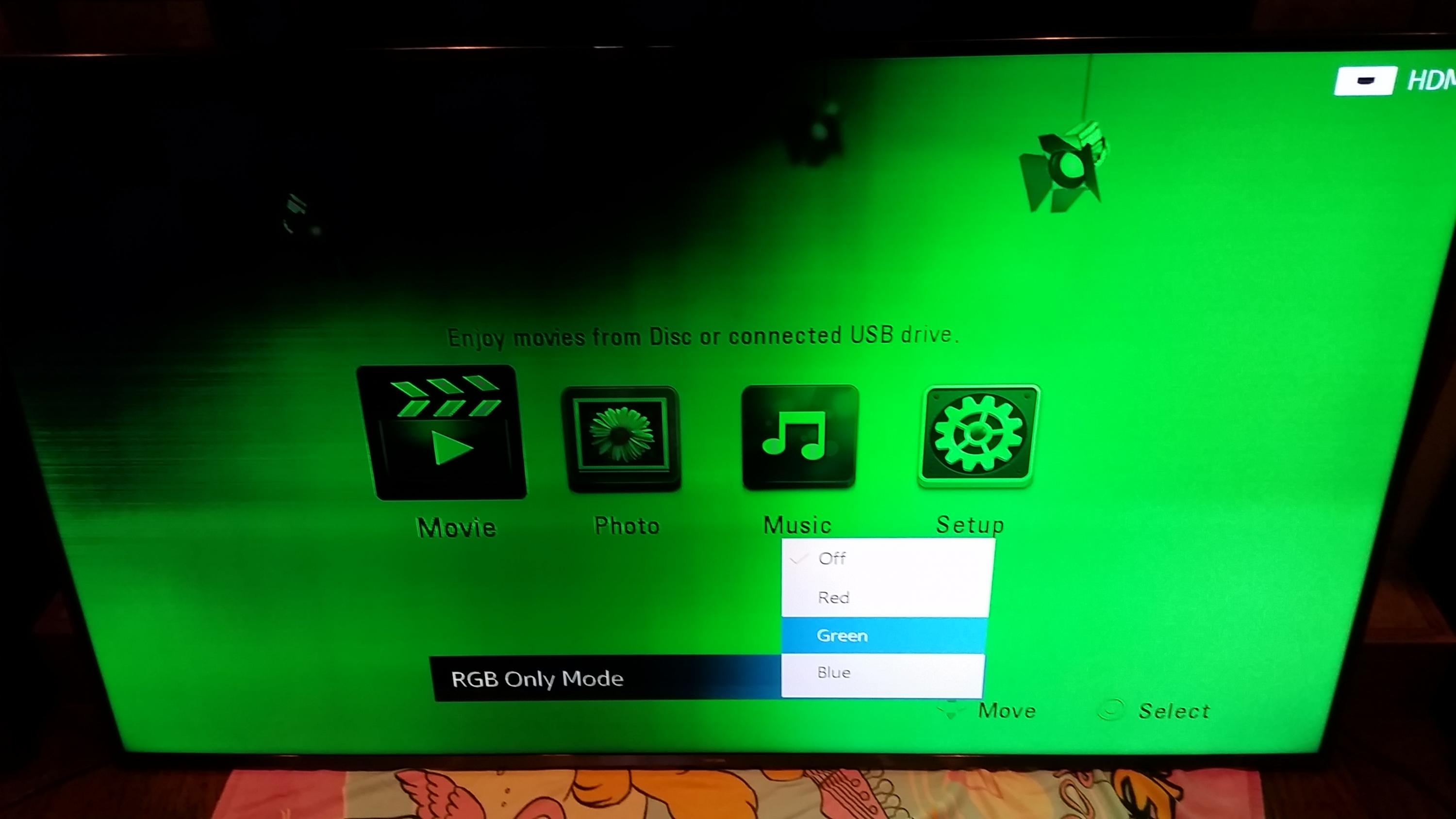

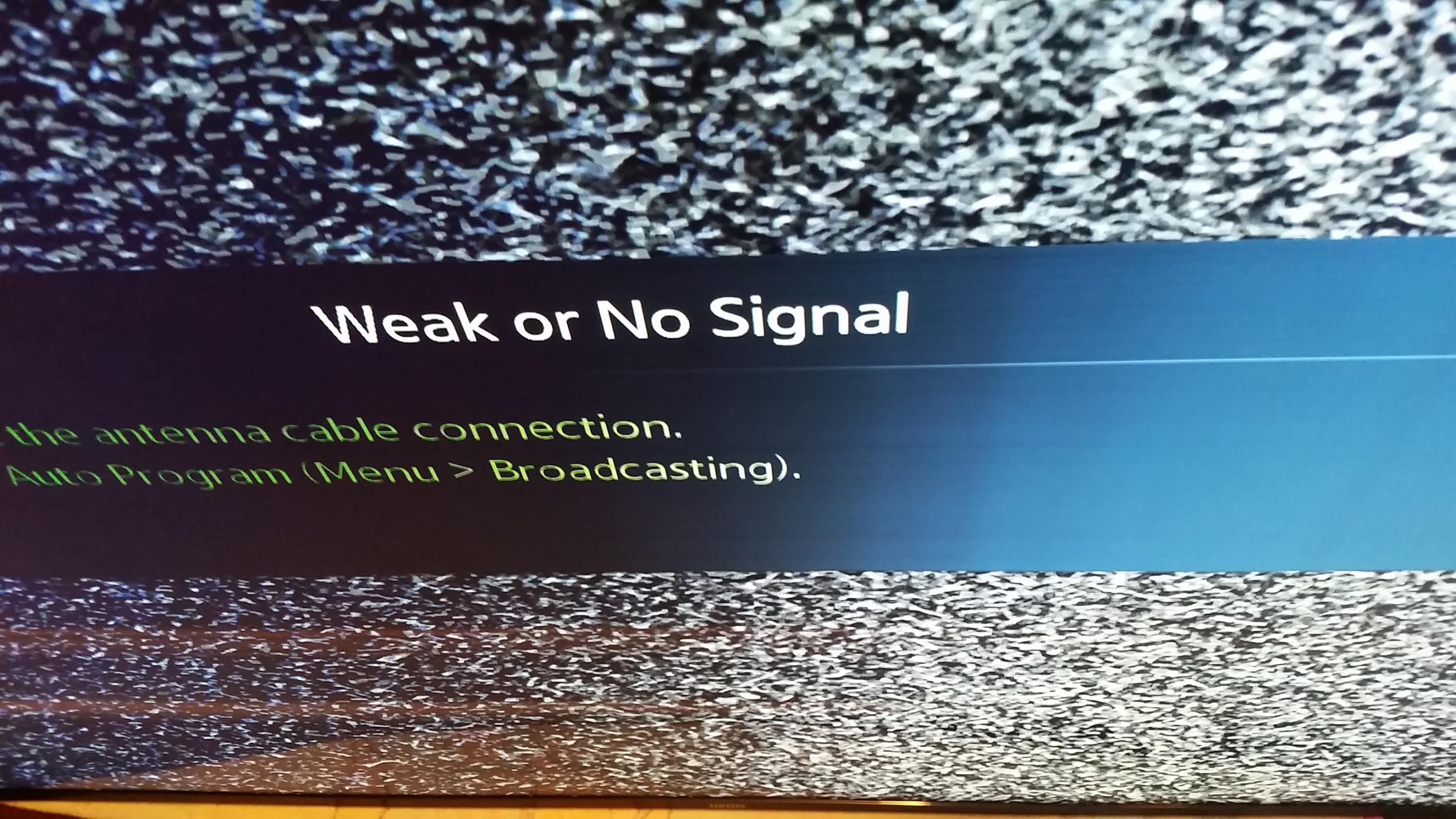

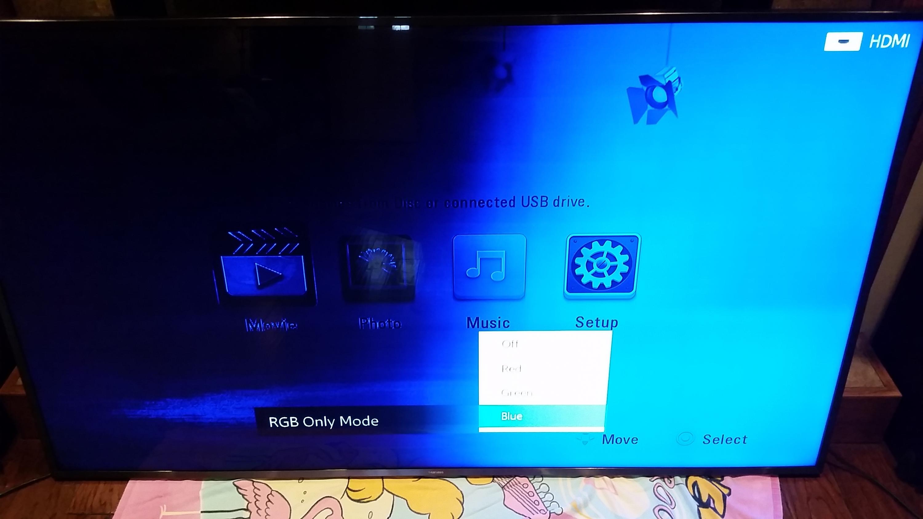

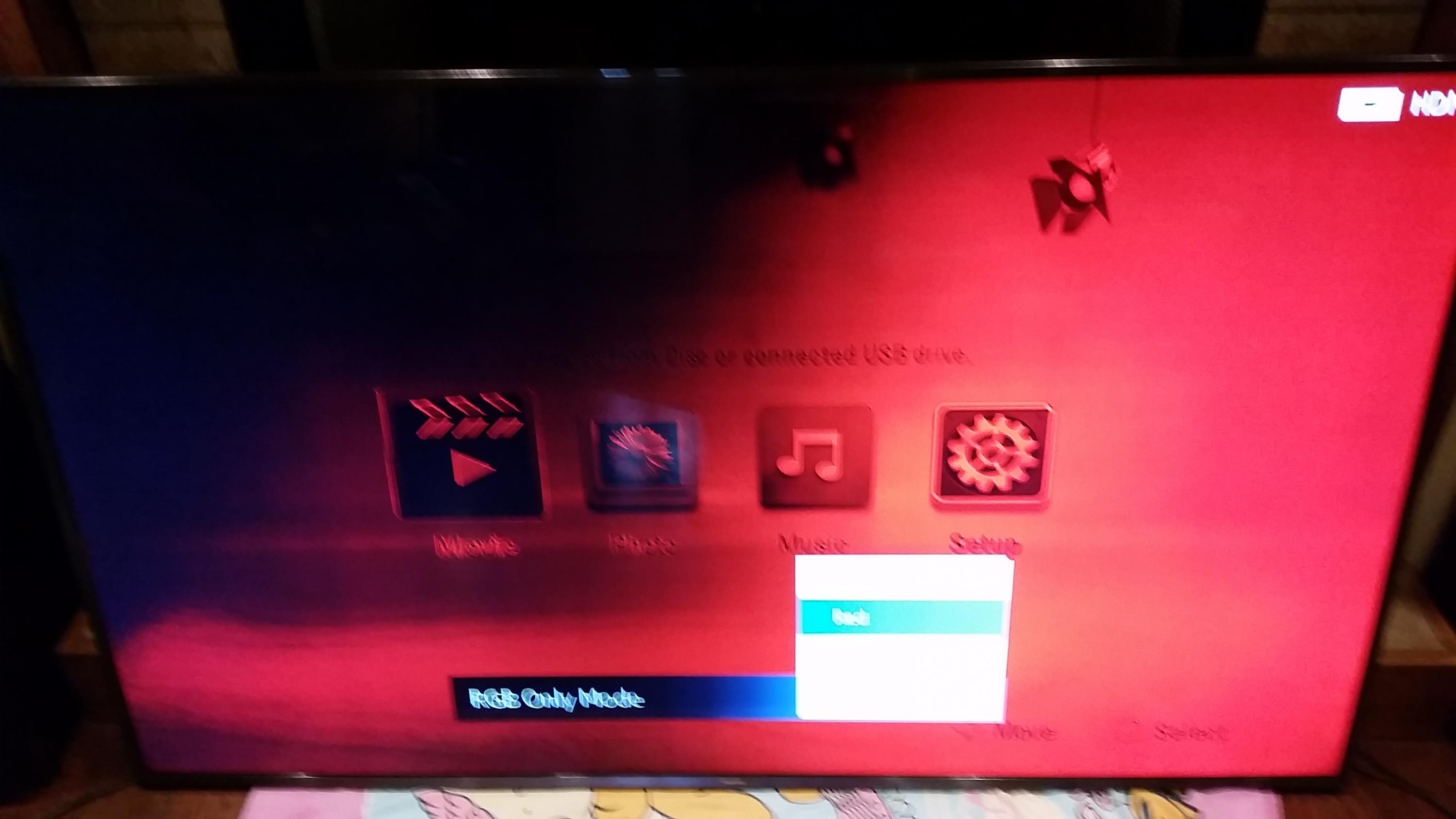

                          I already had a replacement TCON board ordered since I didn't get it right the first time.
                          So, I figured since the tab removal procedure was a last resort, I would wait until I swapped the TCON first.
                          After that, I poked around on the different ribbon cables hoping it was an intermittent or bad connection. No dice there.
                          And these pictures are a better look at the different menus I see.
                          Some are from a RGB test screen in the menu.
                          I mainly just wanted to get a confirmation from someone that after seeing these pictures, and what I've troubleshooted/swapped out, that the tab removal is my only/last option here.
                          Thanks.

                            It certainly is looking very much like a side tab issue.

                              hmmm... not sure based on those pictures as the darkness is there but I don't any horizontal lines which would be a "reasonable sign" and a tab / panel failure.
                              What's the history of the TV? (ie. how did it get into this "broken state")
                              In your previous pictures, that last one showing the tcon (2 cables in 4 out).... note there are cable connectors on the other end of those 4 cables... have you checked them for proper seating / reseating?
