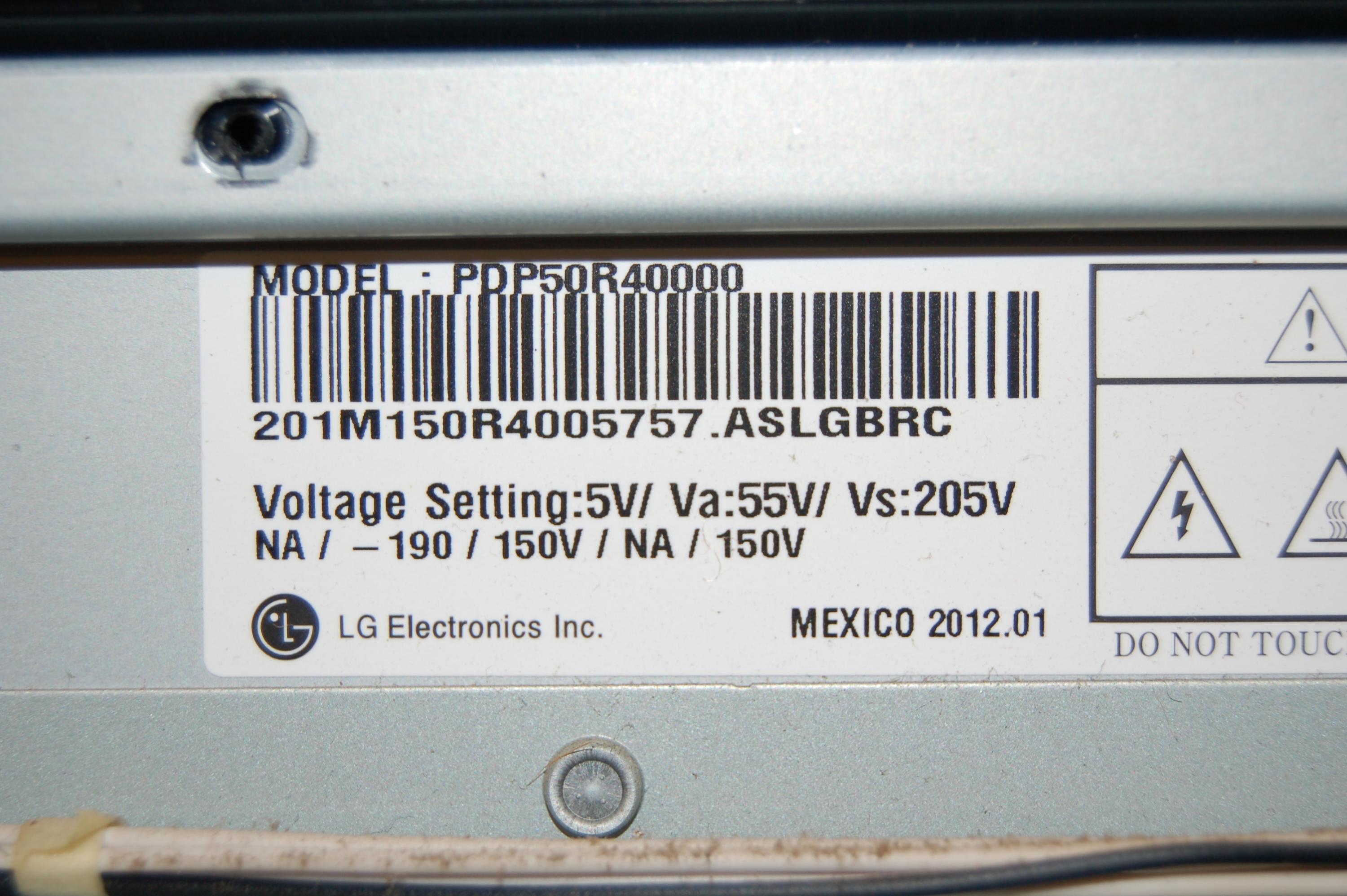

    Hey guys. I have an LG 50PA6500 TV with no picture. TV automatically cycles to/from standby when powered; indicated by red light which clicks on/off. There is a buzzing sound coming from y-sus when light is on. When Y-sus was disconnected, the red light stayed on (i.e. cycling stopped). I have read all posts on badcaps regarding this model. As per sticker (see attachment), ideal voltages are:
    Vs = 205 V
    VZB = 150 V
    VSC = 150 V
    Va = 55 V
    -VY = -190 V
    When both buffers were removed and y-sus connected, buzzing continued and the voltages were:
    Vs = 206.0 V
    VZB = 149.7 V
    VSC = 151.3 V
    Va = 54.5 V
    -VY = 191.0 V
    When top buffer was isolated and y-sus connected, cycling continued on/off with no picture; similarly with bottom buffer. Buffers were tested for continuity and no shorts were found on either.
    Is a tear possible without any shorts on either buffer? If so, is the only conclusion a tear in both ribbons?

    Look at the CTRL Bd and search for 2 pins/holes labeled AUTO-GEN. Disconnect the Main Bd. from the CTRL Bd. Solder/connect a jumper between the AUTO-GEN pins/holes. Apply the ac and if the Panel is good the Test Patterns should show. If the screen shows a perfect White display, then the Panel is OK and your Main Bd. or LVDS cables is the fault.
