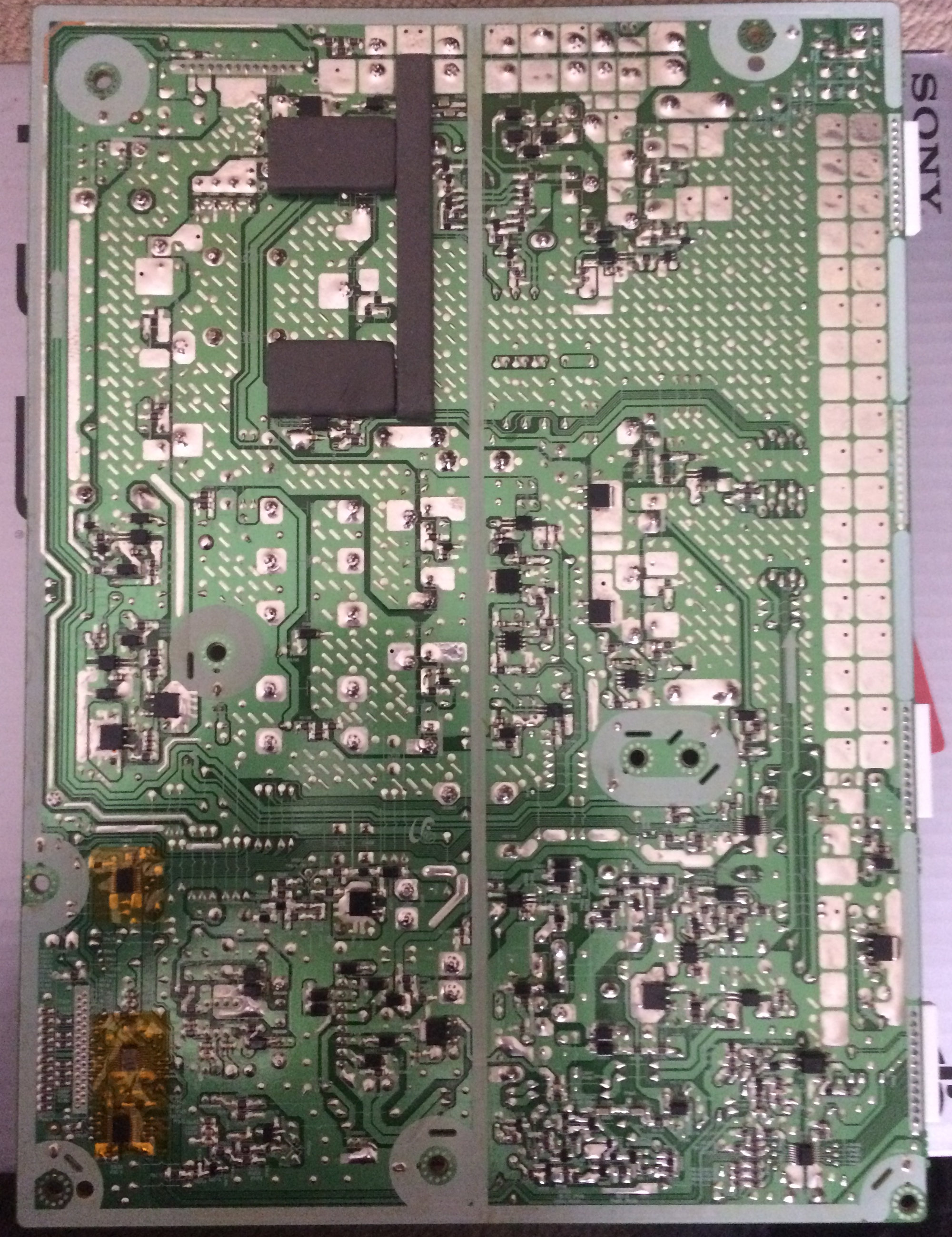

        Hi guys! I am attaching some images for sake of posteriority. Perhaps these will be useful for someone in the future.
        The first is the model and pcb numbers. The second is a photograph of the Y-Main top side, the third is the bottom side and the fourth photo is of the large heatsink with the offending 'fets'?
        I also have a question if anyone happens to be reading this. I have purchased a replacement Y-Main that is apparently in good working condition. Are there any precautions I can or should make, or tests that I can carry out prior to installing it to avoid damage to any other components if it is not good, or else a way to test X-Main also as currently I am assuming that only Y-Main was damaged as that was the only thing mentioned by the Samsung Tech.
        Also as previously mentioned I have tested the Y-Buffer and it appears to be fine.
        Thanks in advance for any assistance!

          Don't attempt to power up without all the screws done up tightly on the Ysus board or you'll have more problems than you started with.
          50~100 ohms, Kohms, Mohms?. If Ohms then I would remove the component and test them out of circuit

            Test the new board between vs input pin and earth ( at screw hole) to ensure not shorted. I didn't do this recently when eager to fit new board I got but it was shorted after I turned the set on - a problem elsewhere can cause that to happen!!

                You test the board out of set with dmm in diode mode first to see if it beeps (short) then in ohms to see what it reads then - post result but low ohms probable problem.

                  Thanks for the reply. Well this is strange (at least to me). When I measure my own blown board in Diode mode it shows a number, does the slightest of squeaks then shuts off. If I measure in 200 ohms i get a reading of 0.03.
                  When I measure the replacement board in Diode mode I get an initial reading of random numbers then after a second it shows 0L. Subsequent measurements I get 0L and it seems quite random to get a reading. 200 ohm I get nothing.
                  Perhaps I'm not doing it right, or have been sent a dud.
                  *Edit. When I test from the solder points on the bottom of my original board i get the tone. When I do so on the replacement board I get the same behavior as before, first a reading in Diode mode and then nothing.

                    Well I got impatient and tried the board anyway and got a picture so I guess we can consider this solved. Hopefully it lasts. Cheers for the help!
