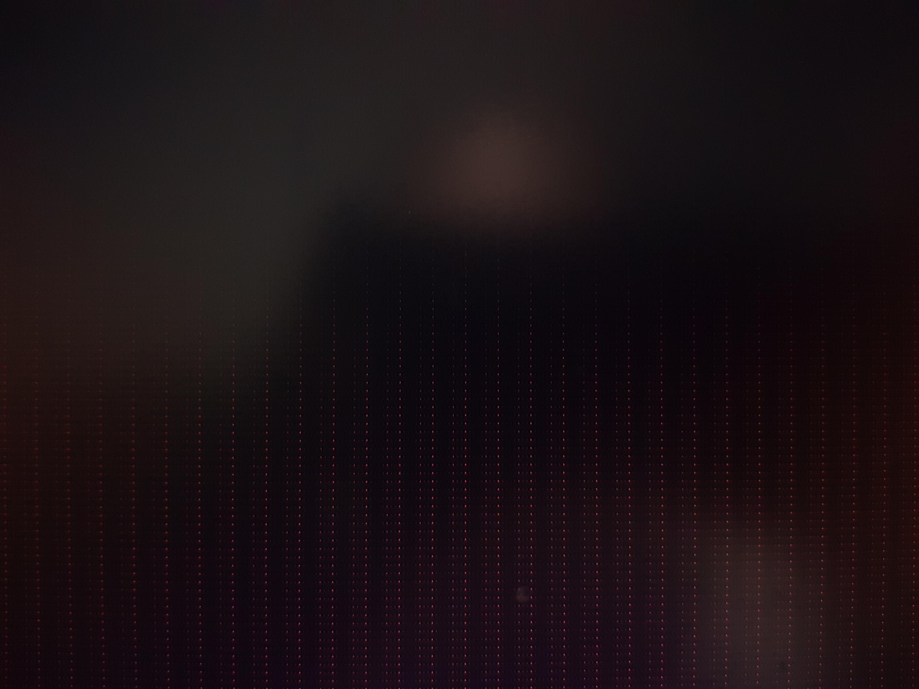

    Samsung SyncMaster 2220wm tiny dotted lines
    I'm getting these tiny dotted lines on my Samsung SyncMaster 2220wm monitor. I tried plugging the same HDMI cable (using a HDMI to DVI converter) into my MAG Innovision monitor, that seems to be fine (no lines). Has anyone encountered similar issues before? Is it caused by a bad cap or do I need to change out the input circuit board?
    Thanks.
