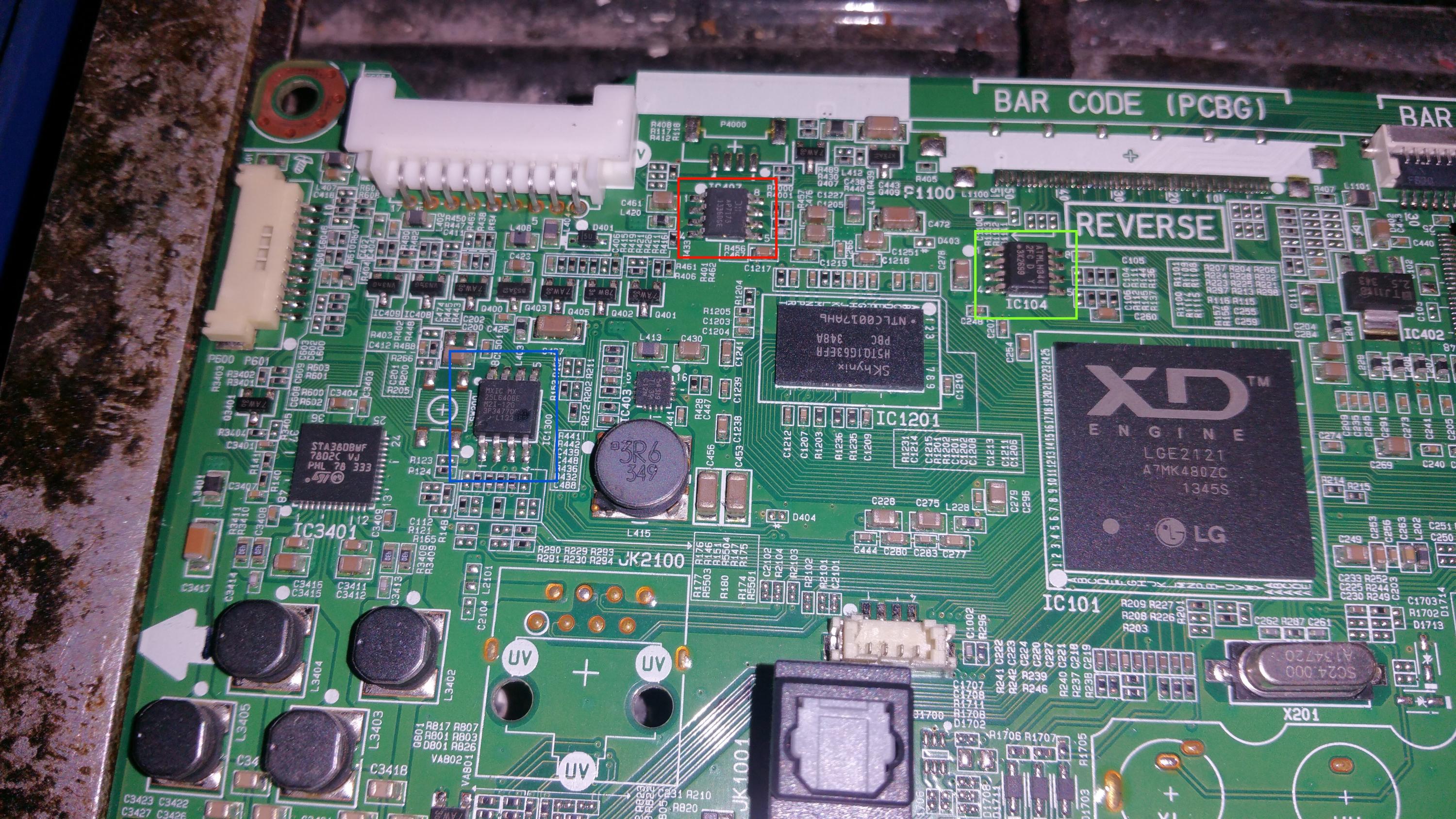

LG 32LN530B Best Candidate for EEPROM
  • Michale32086
    • Nov 2011
    • 1453
    Red, Blue or Green??
    I am thinking Green...
  • freakaftr8
    • Oct 2012
    • 3743
    Re: LG 32LN530B Best Candidate for EEPROM
    Its green. Blue is the serial flash for the display controller IC.
    • vinceroger69
      • Mar 2012
      • 6714
      • uk
      Blue? 1C1300 after doing a quick ebay search
      https://www.ebay.co.uk/itm/PRE-PROGR...75.c100623.m-1
      • Michale32086
        • Nov 2011
        • 1453
        I was thinking GREEN because ATML = ATMEL which is usually an eeprom, right???
        • vinceroger69
          • Mar 2012
          • 6714
          • uk
          looking at 1c1300 part number that is a eeprom as well so not 100% sure which is the correct one.
          this shopjimmy link also suggests ic1300
          https://www.ebay.com/itm/LG-32LN530B...-/251556571920
          • freakaftr8
            • Oct 2012
            • 3743
            Oh I'm wrong then. It has 2 eeproms I guess
            • lookimback
              • Aug 2013
              • 1489
              Blue is definitely an eeprom.
