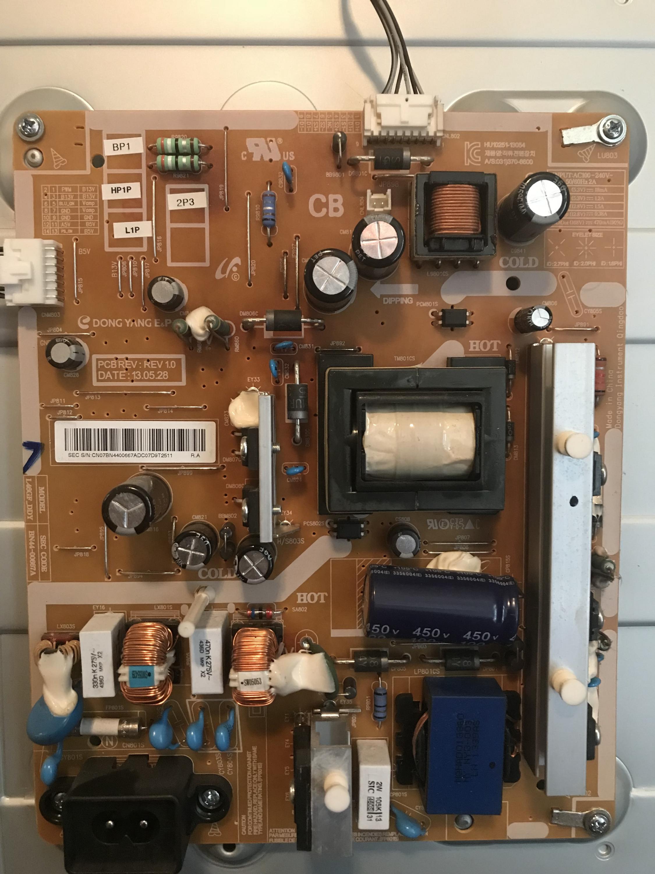

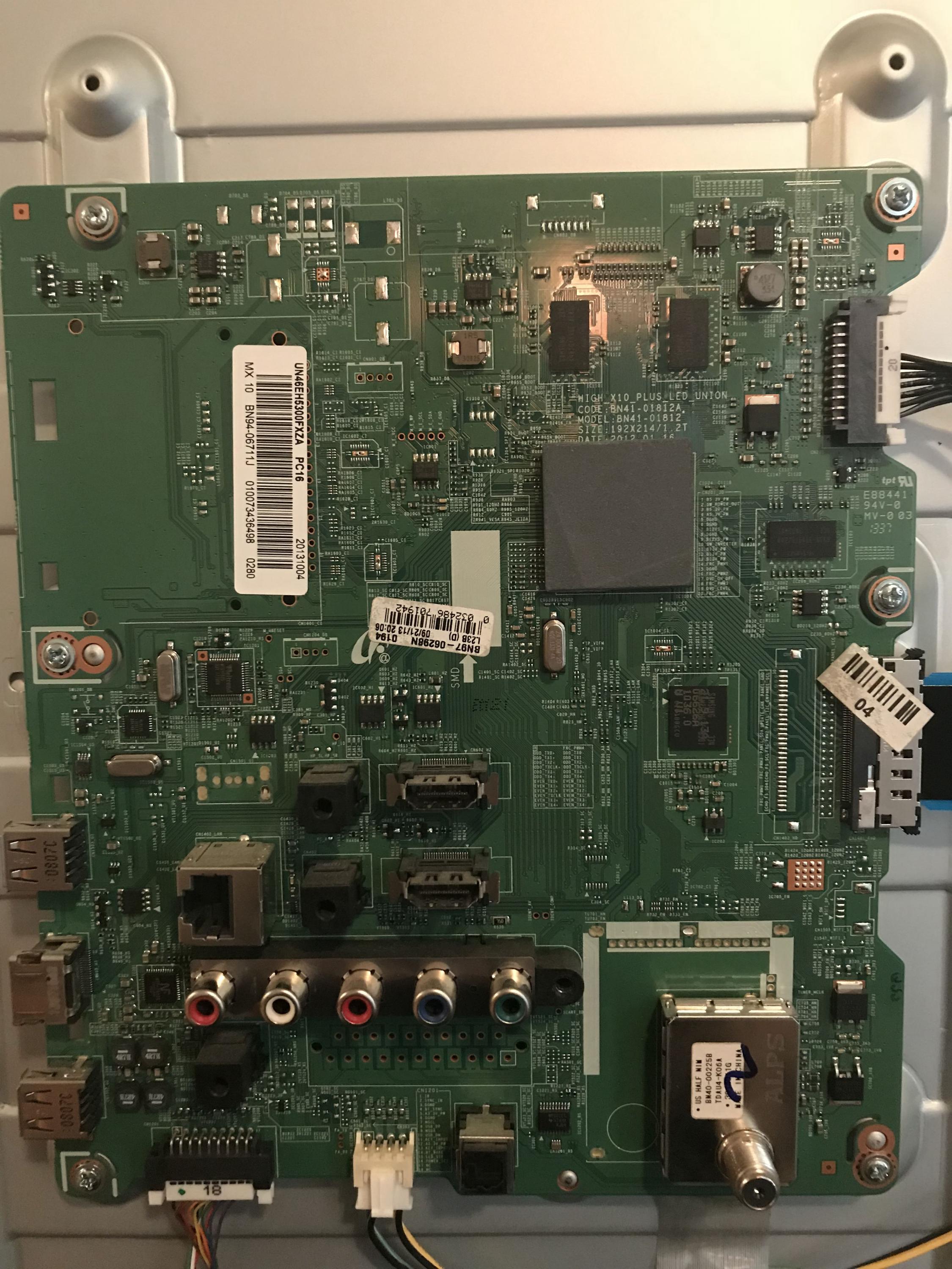

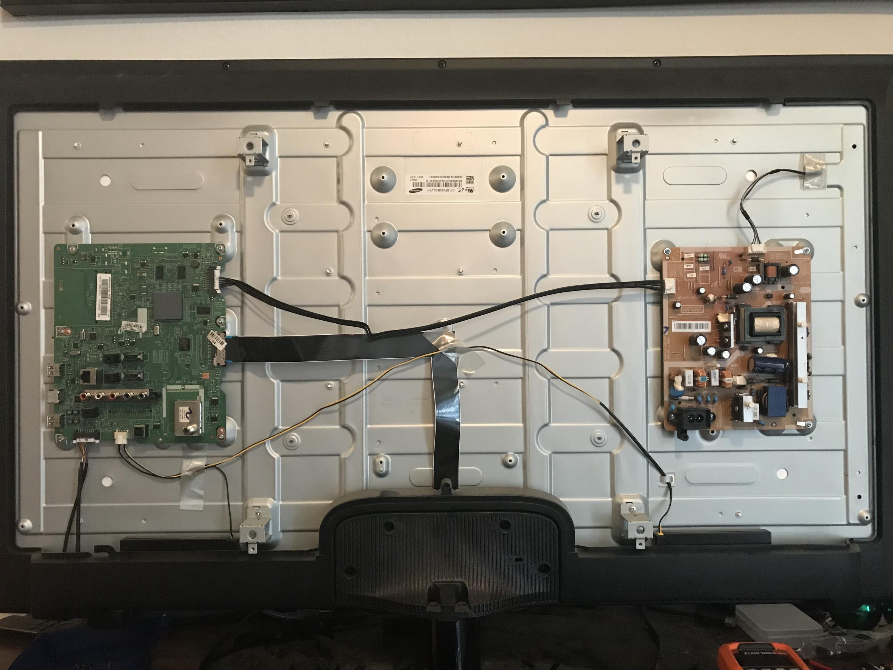

      09-07-2024, 05:50 AM
    • max789
      Samsung UE48H6410 replaced Mainboard but backlights doesnt go on
      by max789
      Hello, I have a problem with my Samsung UE48H6410SSXZG with the main board BN41-02156A and the power board BN44-00709A. Everything seemed like this, the TV could no longer be switched on, the standby LED always flashed 5x2 times. Backlight was off and no sound from TV. Also made the flashlight test and there was no picture.
      I made the following tests:
      1. Disconnected the main board from Power Board = backlight works.
      2. Connected the main board and disconnected the T-Con = backlights does not work.
      So I ordered a main board from Ebay also BN41-02156A but from...
