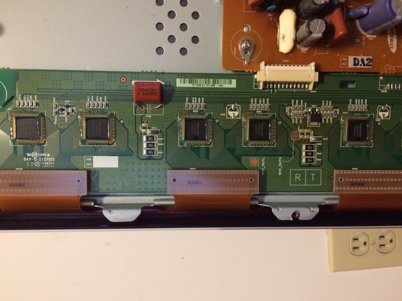

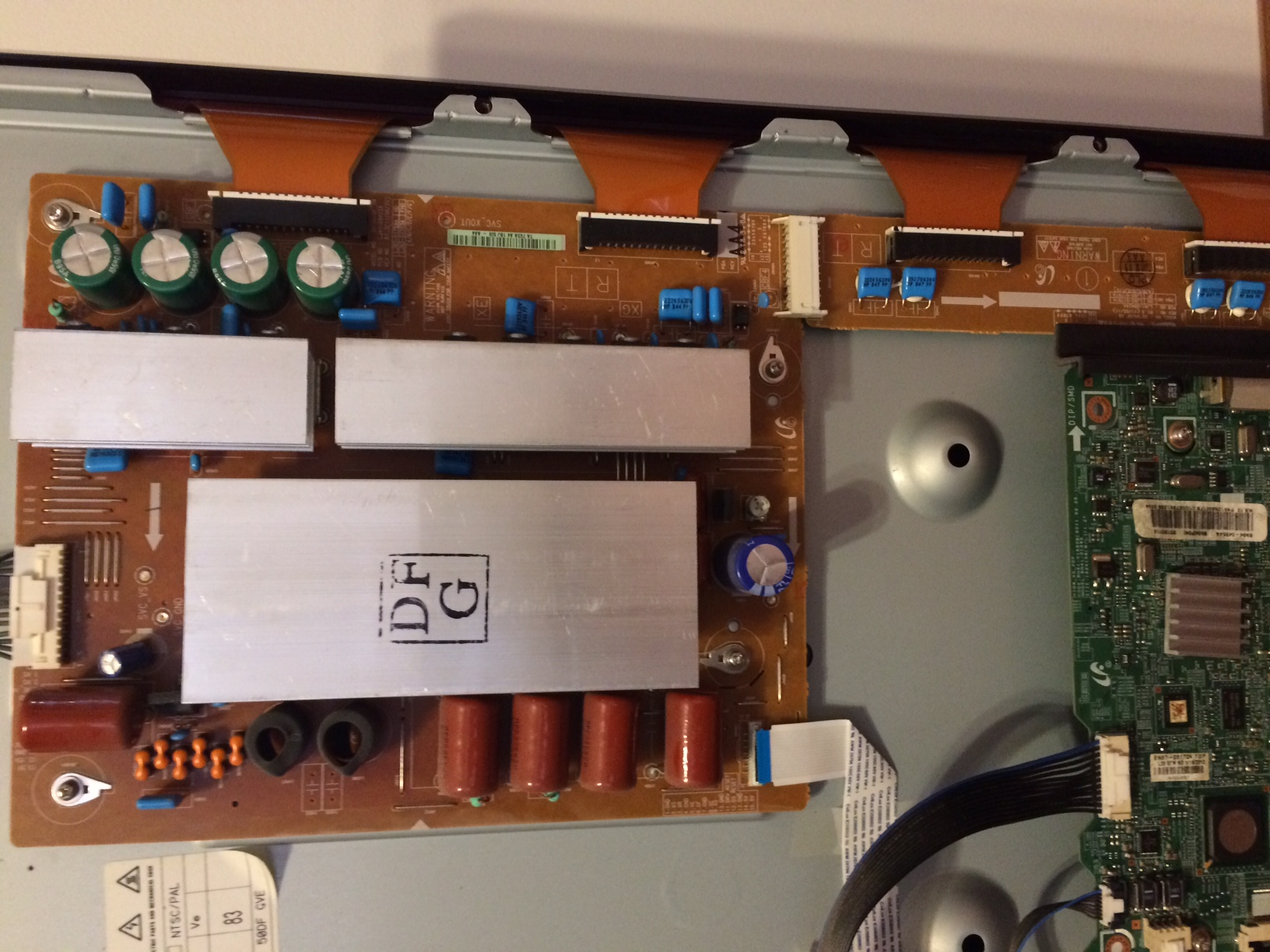

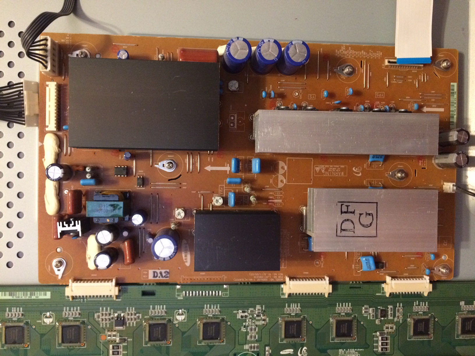

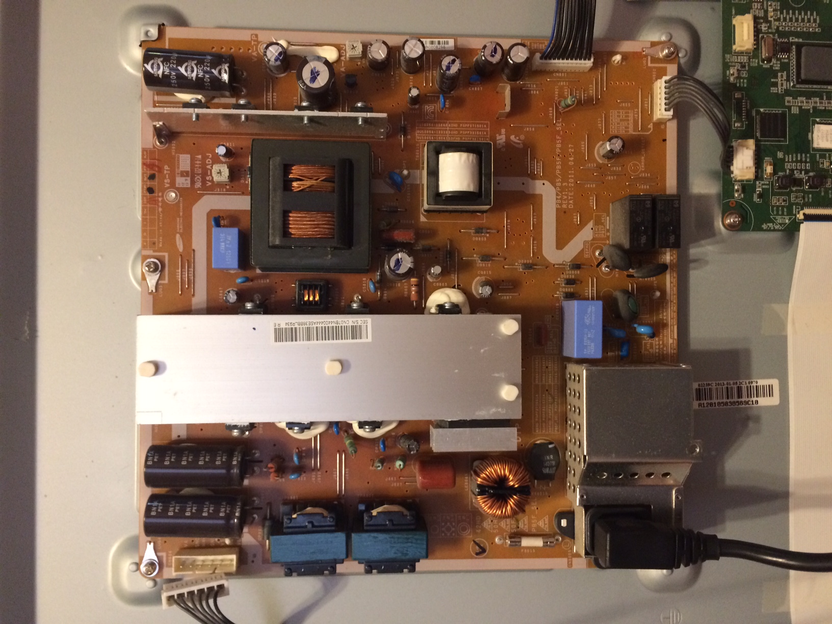

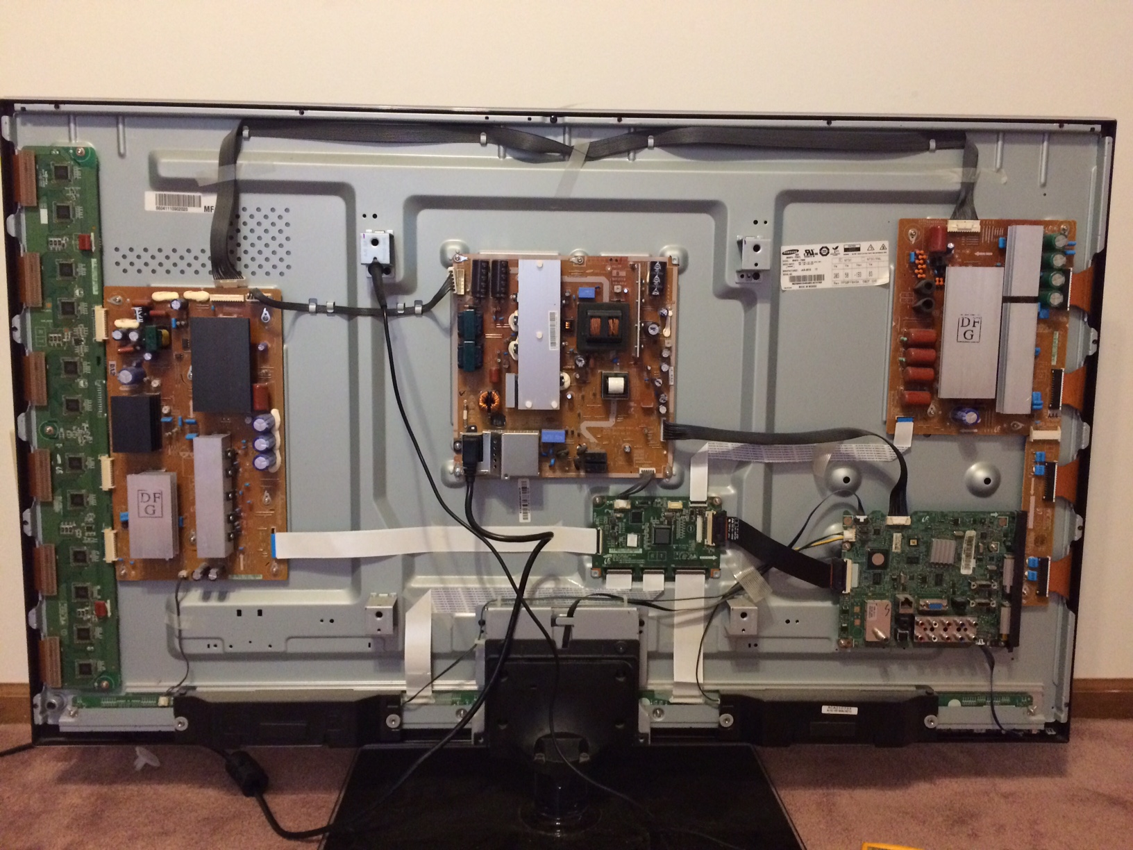

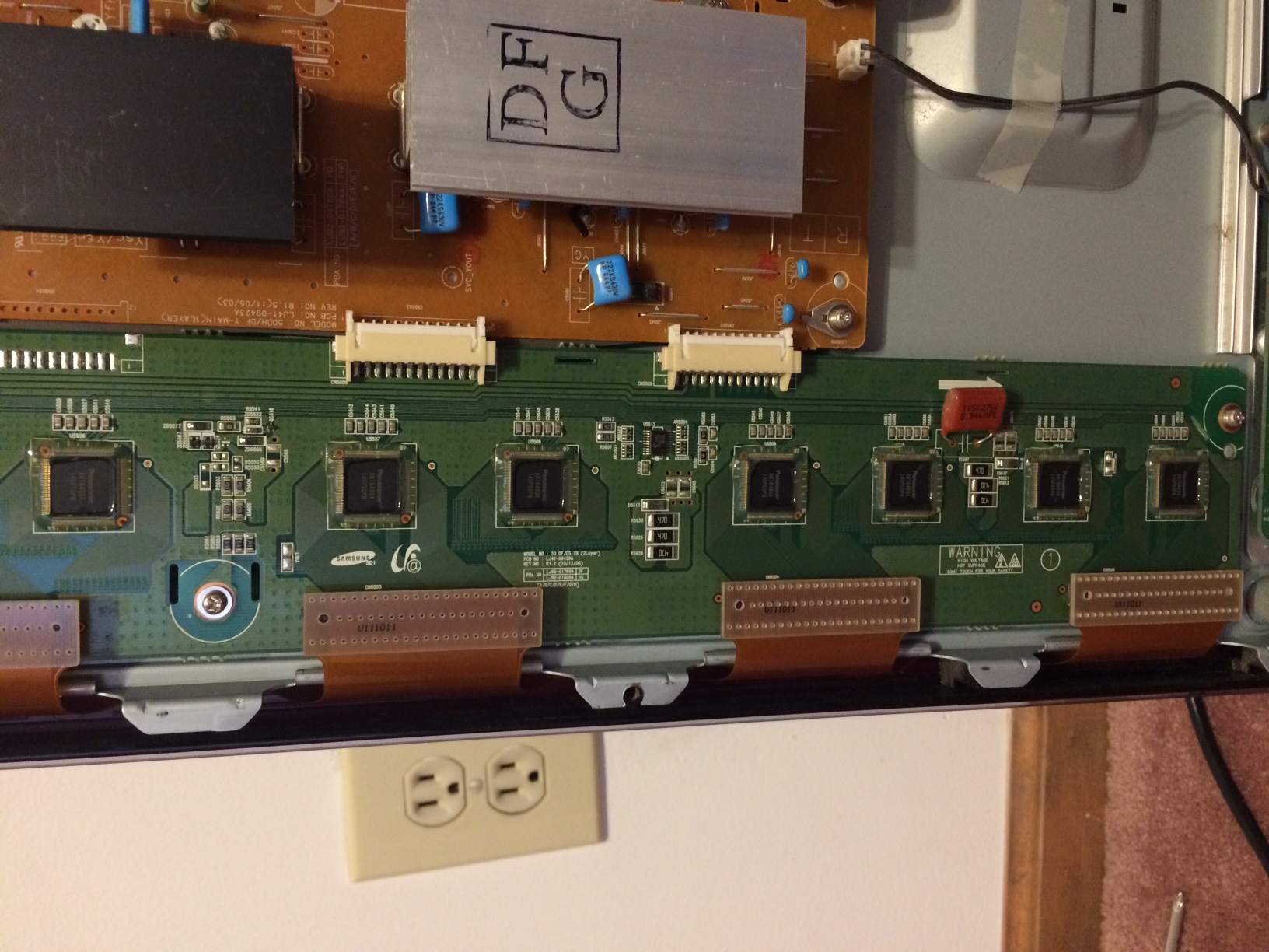

    pic of back of set - pics of boards. I would bench test SMPS with 2 100 Watt bulbs on Vs. sounds like Ysus bd is bad

      I've added some pics. Let me know if you need others and I'll get them for ya'!
      I've never done a bench test on the SMPS with bulbs before. Where should i attach the 100w bulbs, and is this simply creating the "load" that the y and x boards would draw if attached? (or should i simply put the bulbs in series with the meter when testing?)

        If you measured the Vs voltage with it disconected from the Ysus/Zsus it will read high and likely shut down, it needs to have a load, you can use 2- 120 volt, 60w or 100w incandesent lamps in series from the Vs pin to ground to test, and the voltage should be close to spec.
