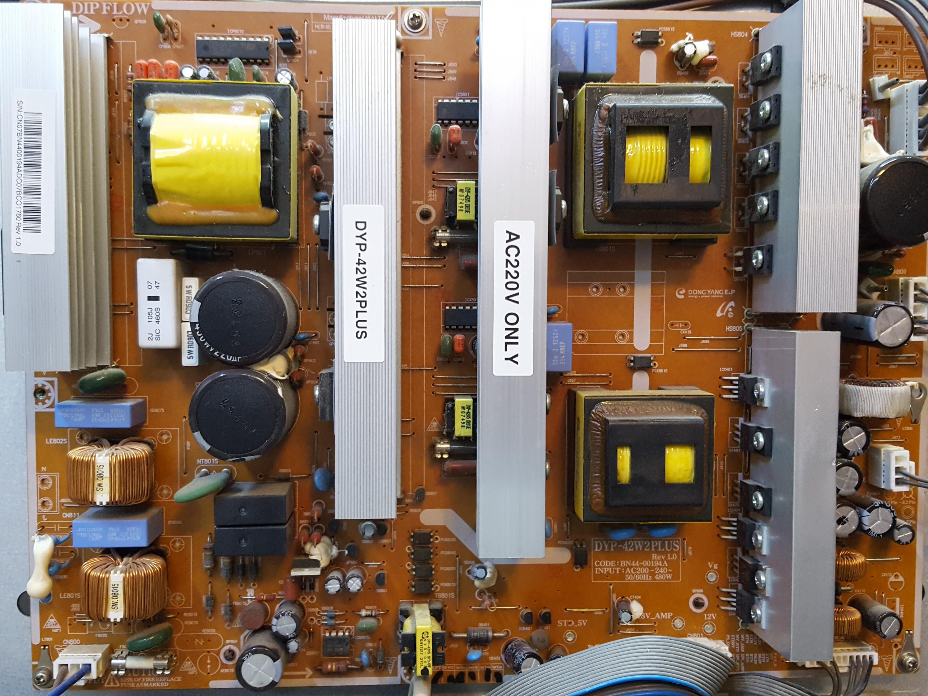

    I would start by inspecting the solder connections on the components mounted to the heatsinks on the power supply, also check the transformer connections, then do the same on the Y-sus & Z-sus boards

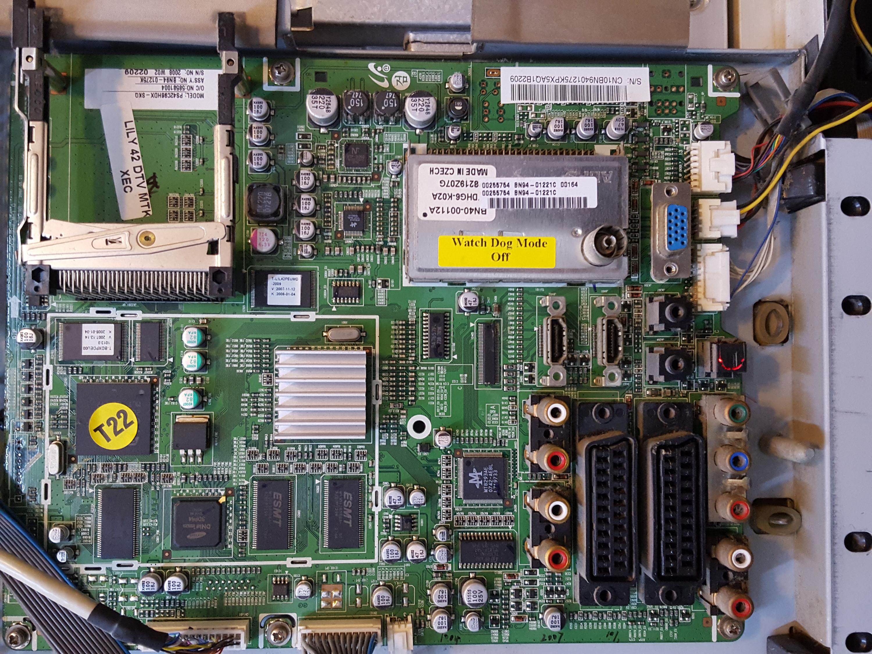

      Actually, looking closely at the photo of the main board I did notice some charring around D's 5401 ~ 5404 so that will be the starting point.

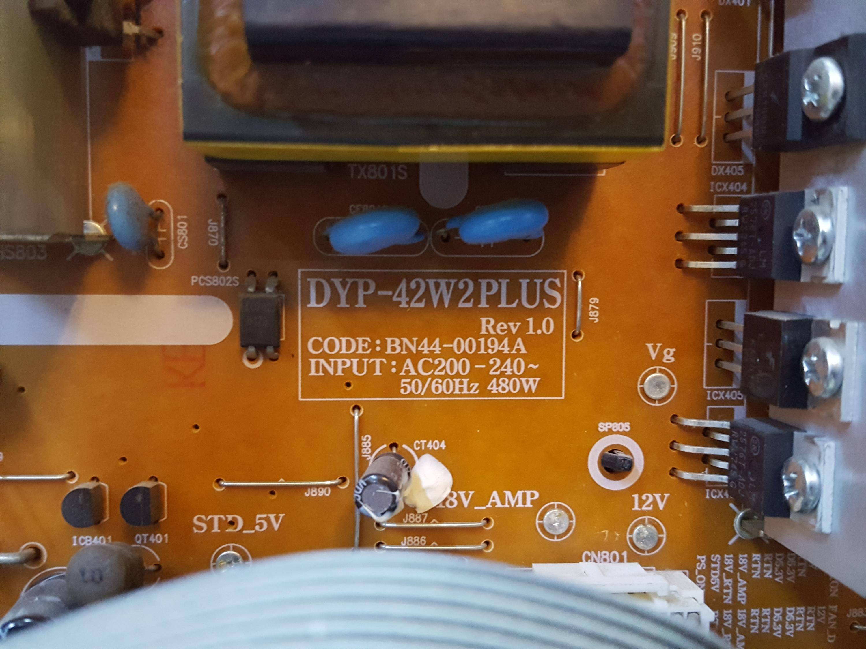

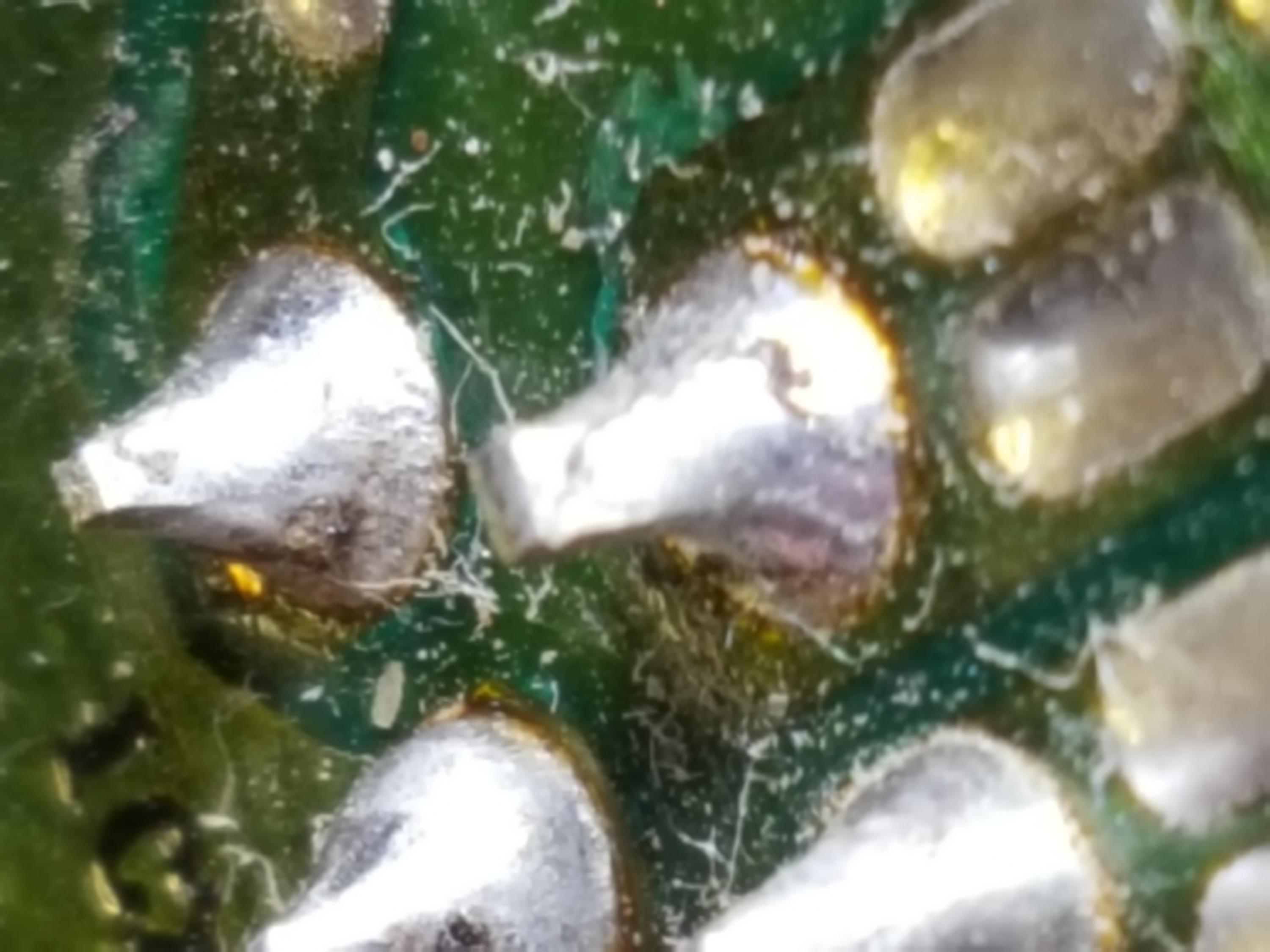

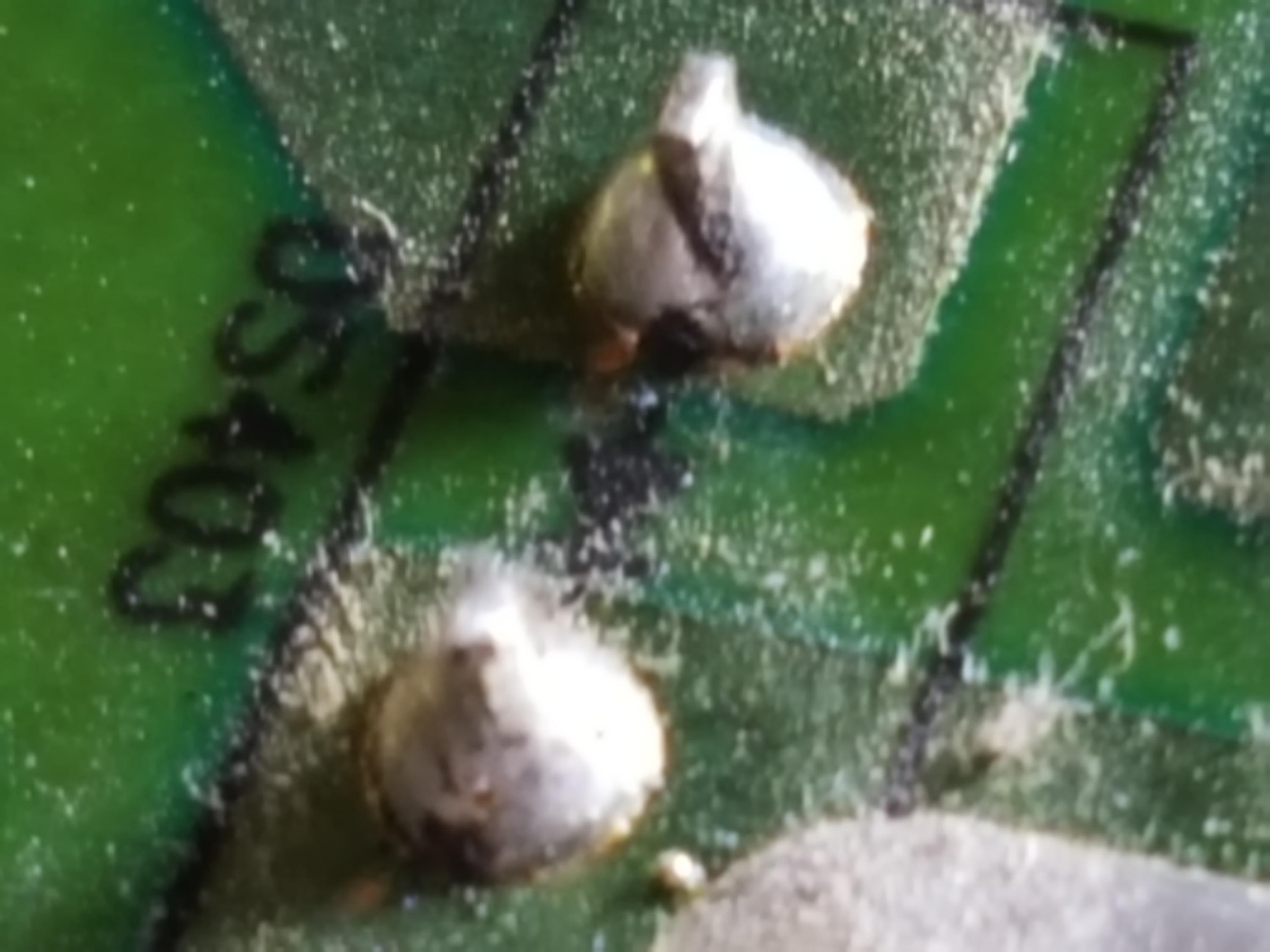

        OK, had a busy day today so only managed to check the power board. It didn't take long to find some pretty horrible looking solder joints which I have now tidied up. Included in those were the aforementioned diodes.
        I'm not convinced this was the fault but can't do any harm.
