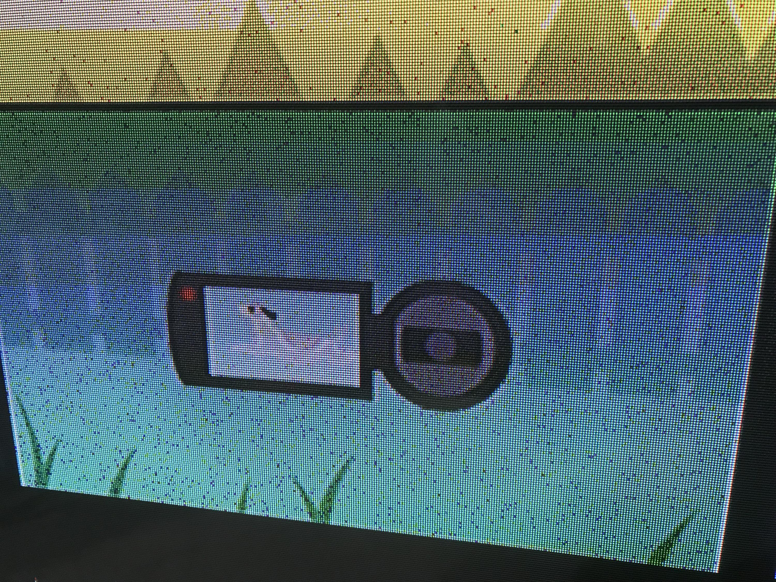

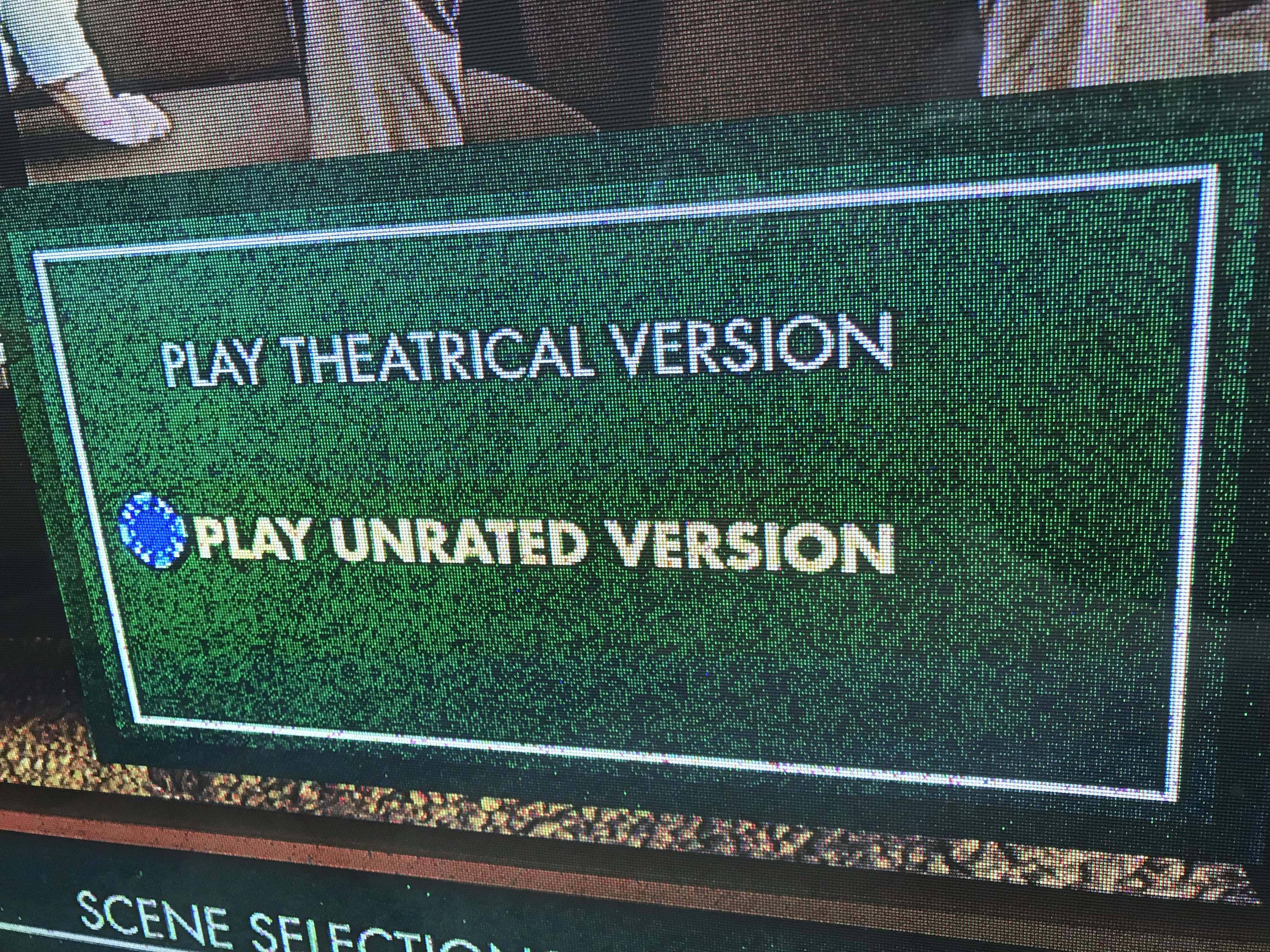

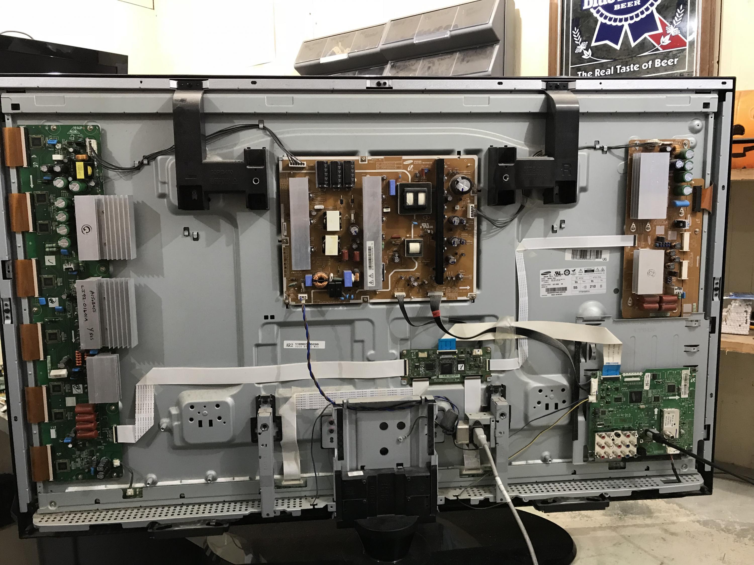

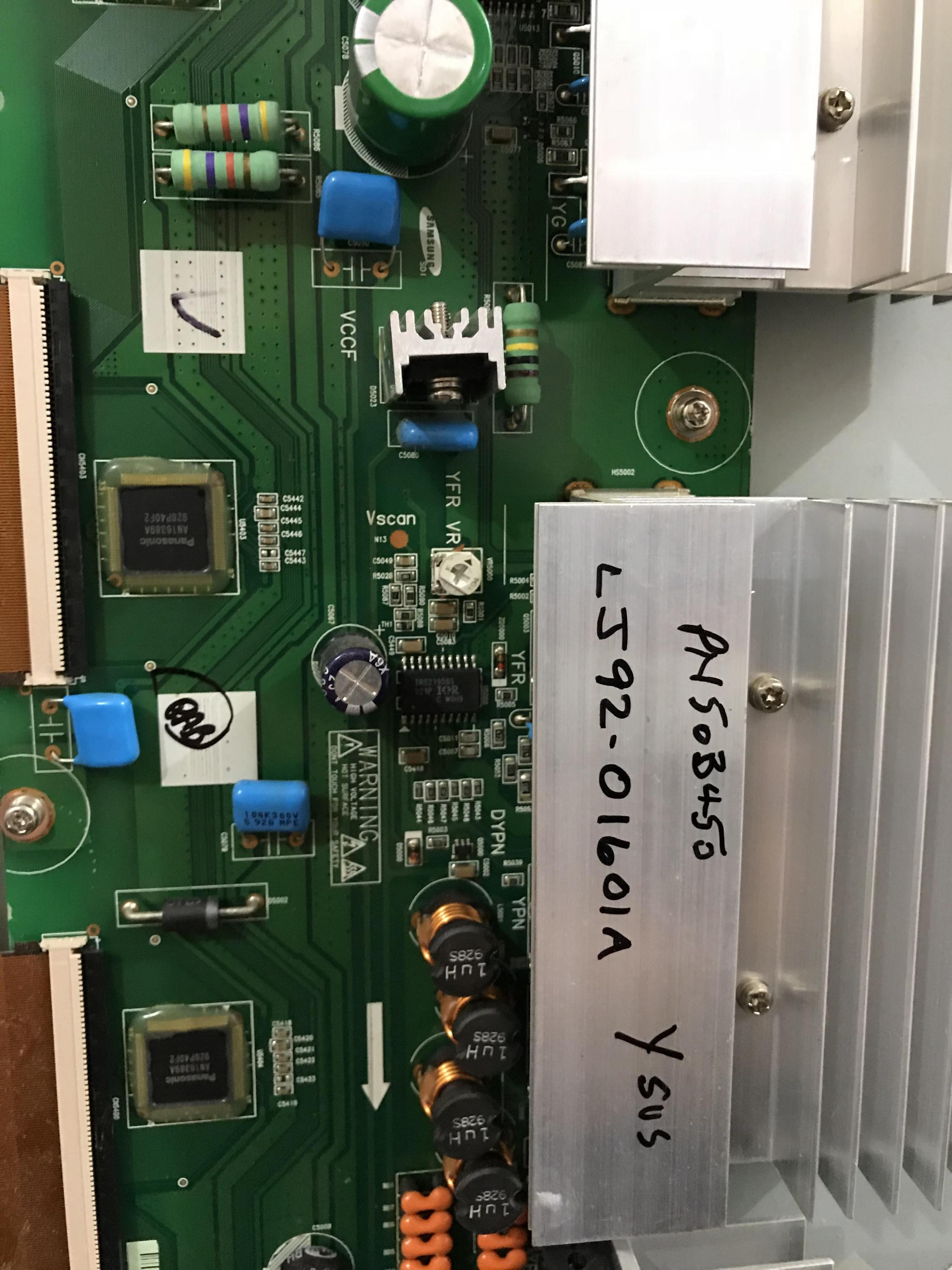

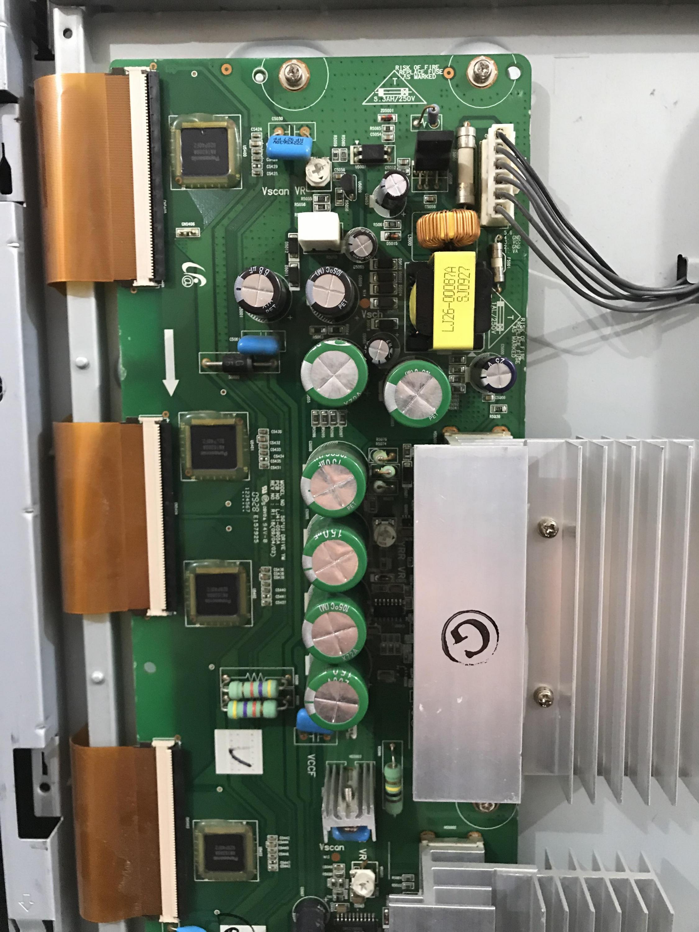

    I manage to work my way through just about any problem these days but this one has me stumped. Picked up said TV from someone used (completely free). Checked it out and it had an obviously blown Y-Main. Buffer chip had a hole in it plus other shorted components. Typically, I wouldn't spend much on this model but the guy said the picture was beautiful until the day it died. Less than a week ago. Anyway, I got a replacement Y-main on ebay and have it installed. TV is functional but has an extreme amount of red and black sparkles. Vs, VA, VSC, are all exactly on spec with the panel. I tried adjusting Vs up and down about 5V and it didn't seem to help at all. Possibly slightly at +5v but definitely not enough to make the TV watchable. Based on what the owner said, it seems to me that it's got to be an adjustment issue. Any opinions on it? I'd certainly like to complete the repair at this point.
    Thanks,
    Aaron

    Re: Samsung PN50B430 Sparkles After Y-Main Replacment
    Looks like a y ramp issue. At the very least slight possibility could be a faulty control board. What's the resistor for y ramp checking?

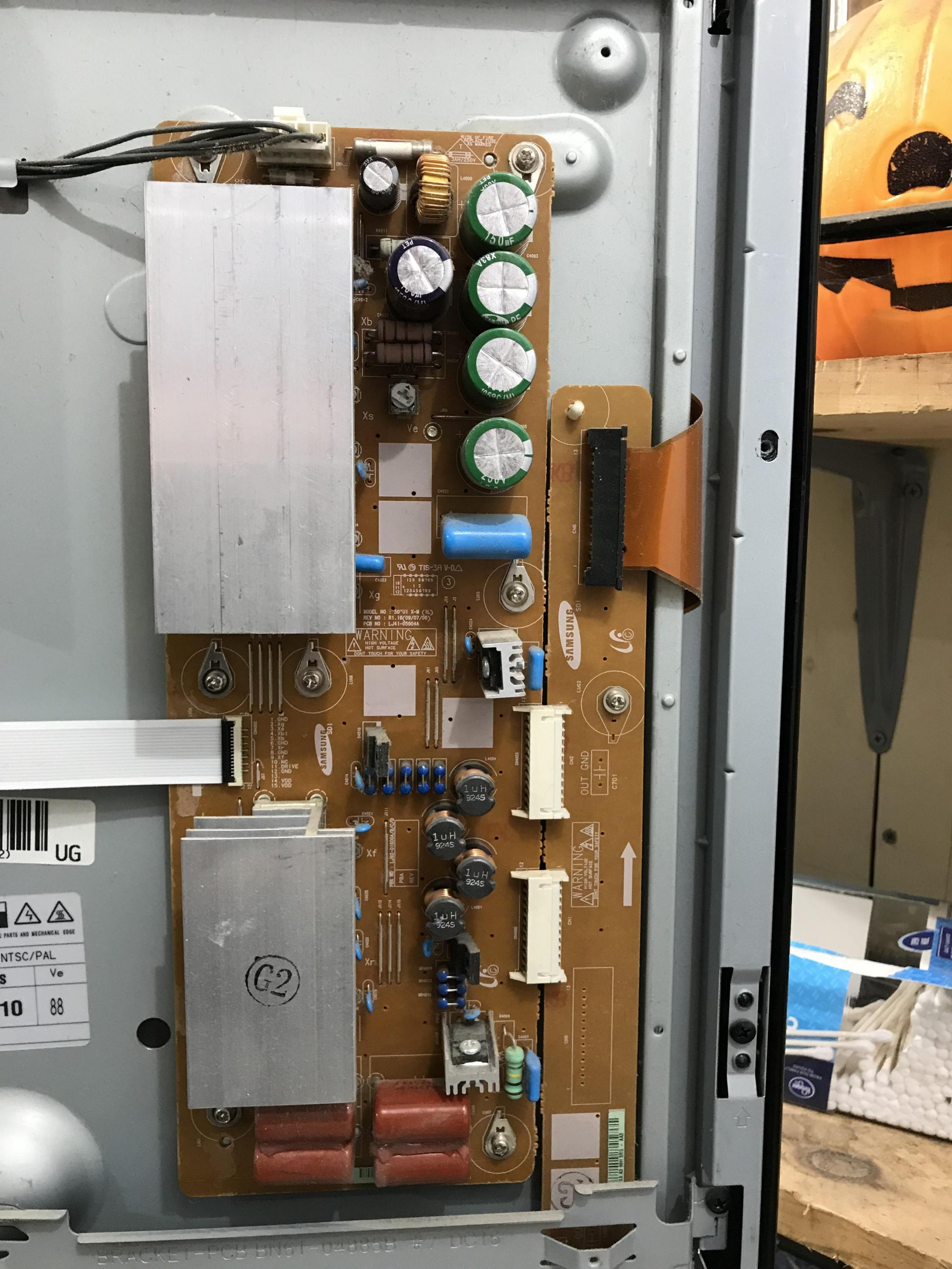

        I'm not to sure I looked over the board this is a board that has the buffers Built-in to the sustain board. Y ramp should ne located off one of those big green resistors It is possible that it could have damaged the Z sustain. What is VE reading on z sustain? Does that match the label on the panel?

          I'll check Ve and let you know. I didn't test that one before. Sure hope the X-main is ok cause at that point I might as well have scrapped the thing. The picture gets much, much worse if the X-Main is unplugged so it's at least doing something.

            You nailed it. Ve is only around 7V. I'm going to look for a repair kit for the X-Main. If I have to spend more than another $20 or so on this TV I'm over it.

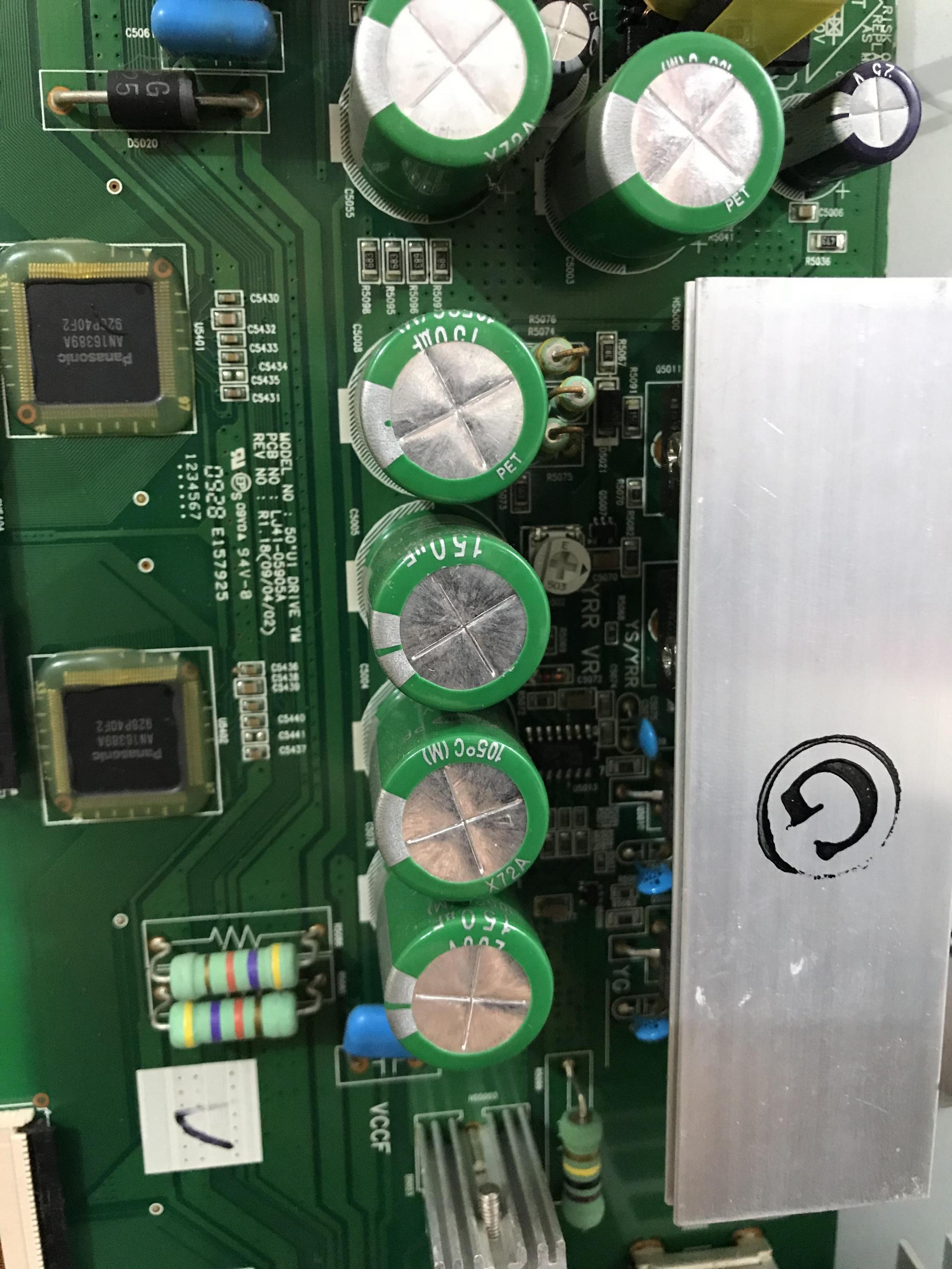

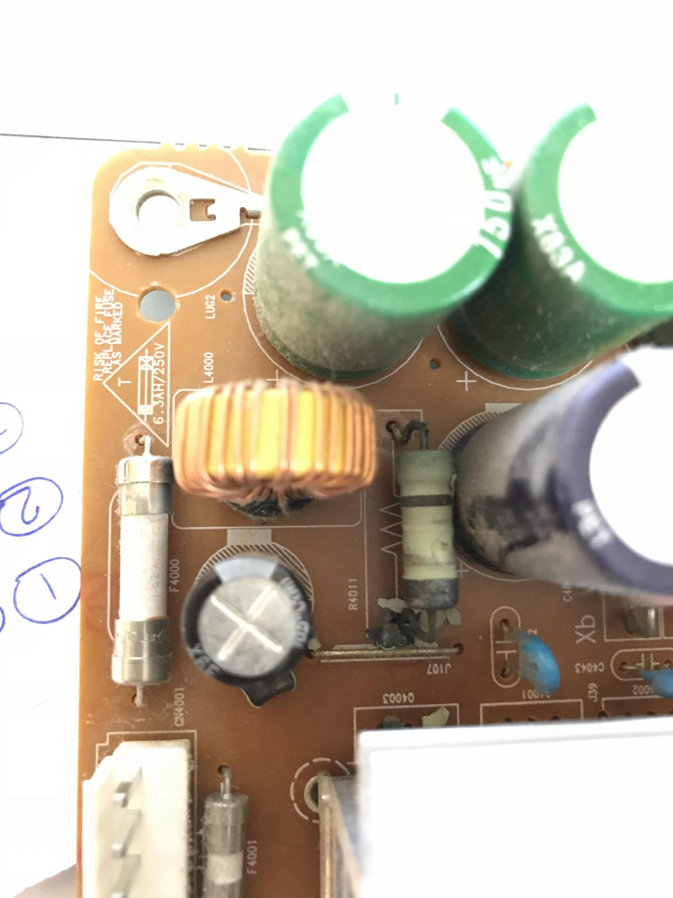

              Ok. R4011 on the X-Main is toast. Freakafter8, do you have the value for that resistor? If not, anyone else? Looks like at least a 1-2W, maybe higher. I cannot see the bands to identify due to the damage. It reads completely open. I've checked all the parts included in the kits available and they seek to be ok. I'm hopeful it just needs that resistor.
                Here's a closeup shot of your board from shopjimmy of the suspect resistor. Hope this helps.
                  Not sure why I didn't think of that. So, it's 82 ohms and I sacrificed one out of a different X-Main. I have 88 volts now for Ve, but drum roll.............The sparkles persist. And what's really weird, I can't tell a difference from when Ve was only 6-7V. So, think there's got to still be an issue on the X-main. If anyone has more things for me to test, I'm all ears.

                              There are 3 other pots on the Y-Main that I'm not familiar with aside from VSC (which is dead on). I'm wondering if it could be one of those but don't want to blindly tinker with anything.

                                Sorry was out at the park all day with my kids. If you found a burn resistor and replaced it now your VE is back up, That's does not necessarily mean that VE is reaching the panel you would want to check at the output ribbons of the X sus To make sure that there's no open components on the output.
                                The other parts of a Y main are ramp up, ramp down, -vy Which could equally be a problem. However given the design of this board I doubt that you will find a problem from a shorted buffer sense this board has not experienced this before.
                                I would be looking at more issues with the X sustain. I'm surly certain that the short a buffer traveled through the panel in damaged the X.

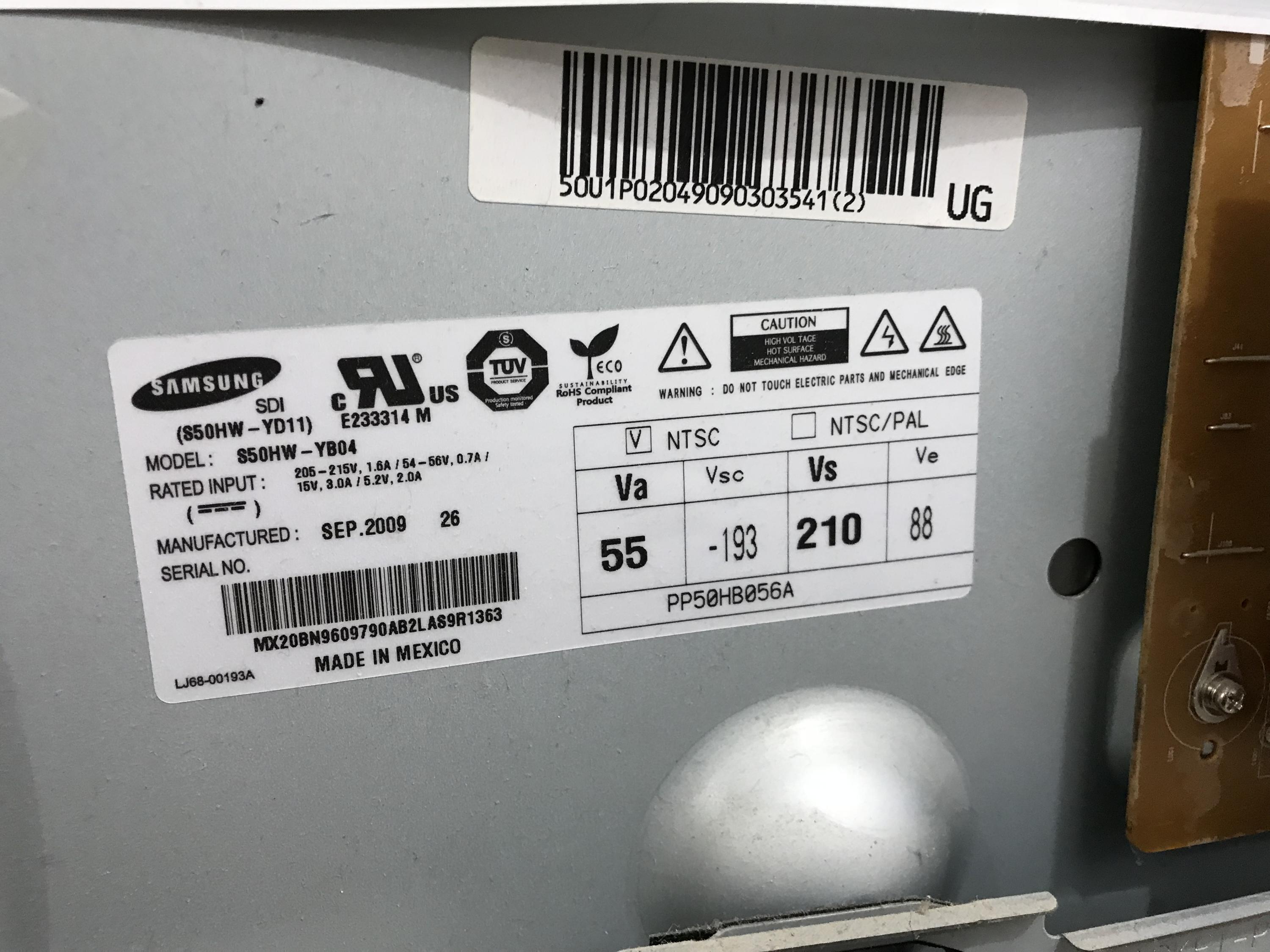

                                  Well, I have a positive update. After checking over everything I could think of on the X-Main without finding any additional issues, I went back to the idea of tweaking voltages again with the pots. This time with more of the attitude of it either works or it gets tossed. With the following readings, I have a beautiful picture on it and they seem to me to be 'close enough' to the originals to not mess anything up. Any opinions on the settings are certainly welcome.
                                  Ve 90V
                                  Vs 214V
                                  VSC -195V
                                  Va remains at 55V
                                  • freakaftr8
                                    • Oct 2012
                                    • 3743
                                    Those numbers I relatively close to the original voltage ratings. You could be compensating for an aged panel Which would make sense.
                                    Nice job!
