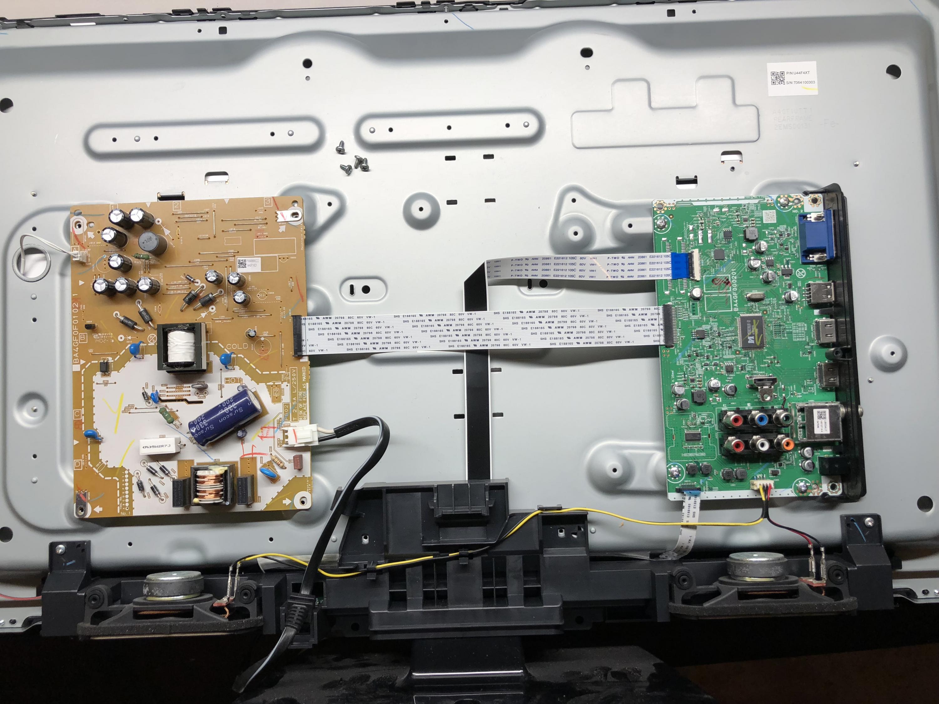

Magnavox 32ME304V/F7 Backlights no image.
  • jwillifixit
    • Apr 2017
    • 113
    • usa

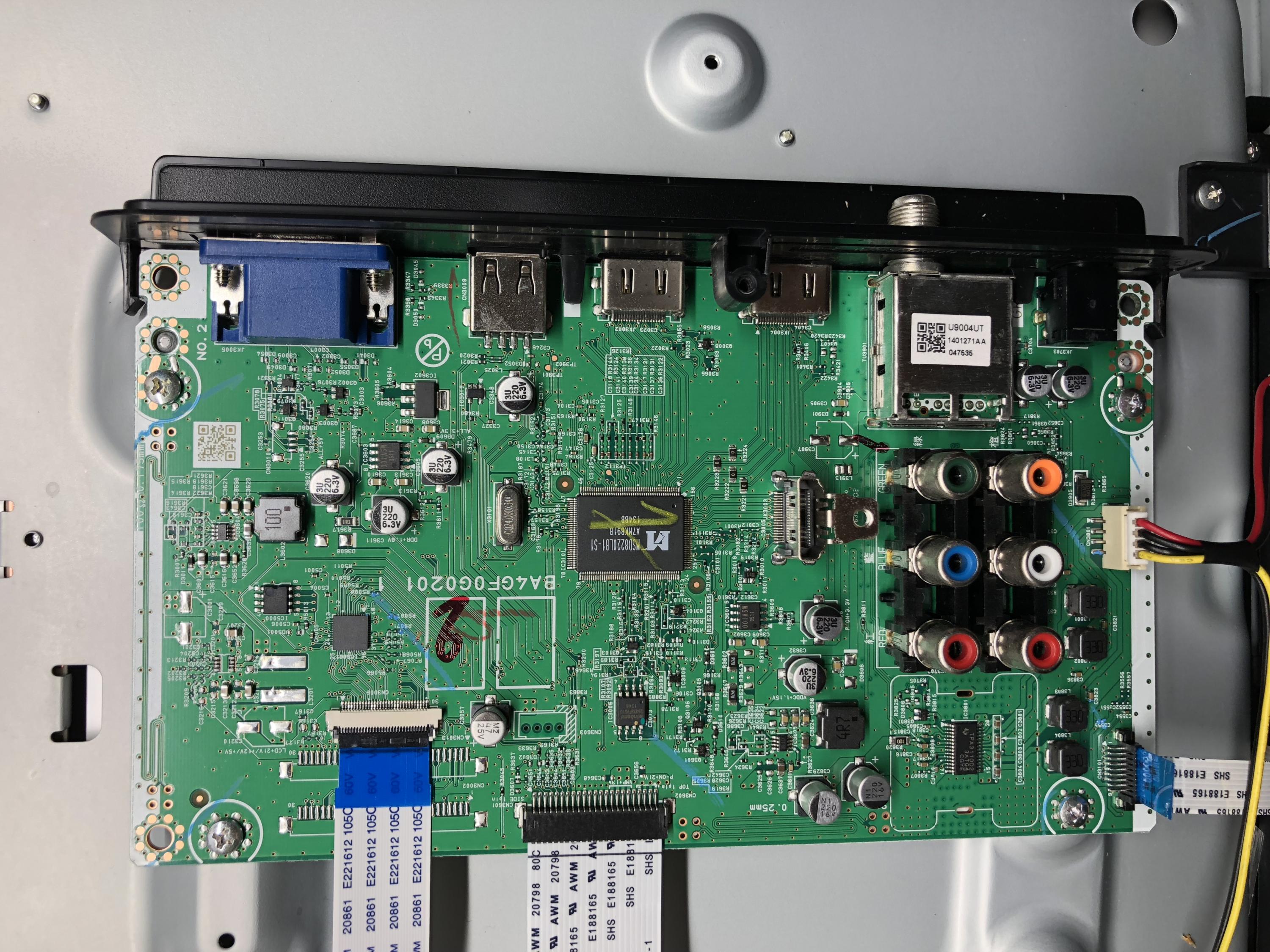

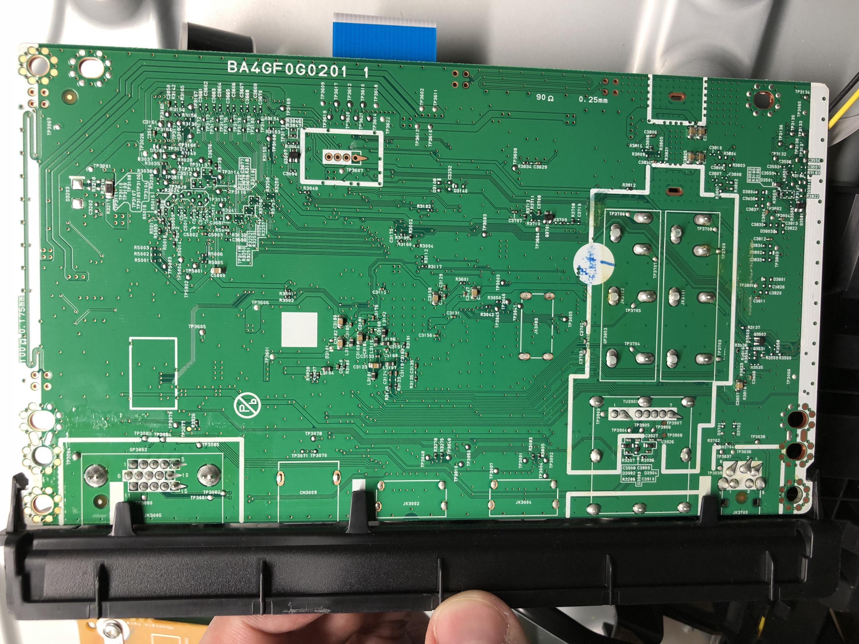

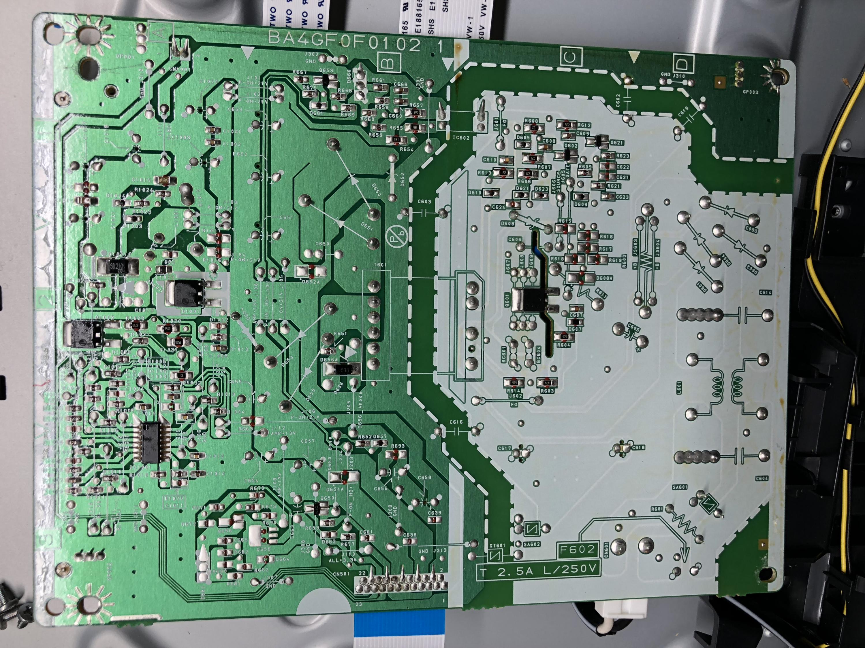

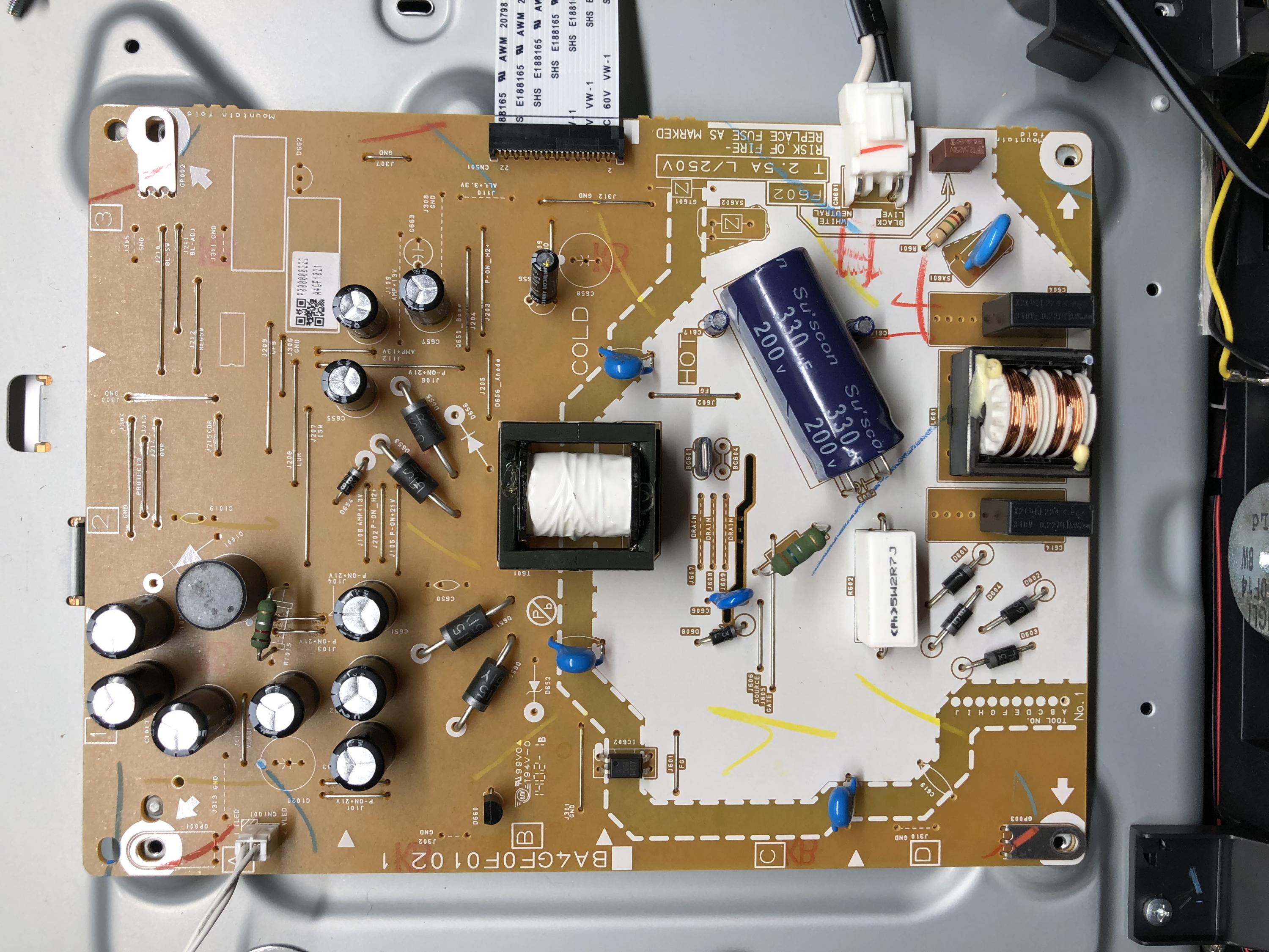

    Picked this up and it would make a nice monitor for out in the garage/shop however it's not working...
    Plugin and on it turns. Backlights are on but there's no image. Hit menu, source... nothing changes.
    PSB Pins 1-23 with backlight connector disconnected / connected and on
    1 - 3.2 / 21
    2 - 3.2 / 21
    3 - 3.2 / 21
    4 - 3.2 / 21
    5 - 0 / 0
    6 - 0 / 13.1
    7 - 0 / 13.1
    8 - 0 / 13.1
    9 - 0 / 13.1
    10 - 0 / 0
    11 - 0 / 0
    12 - 0 / 0
    13 - 0 / 0
    14 - 0 / 0
    15 - 0 / 0
    16 - 3.3 / 0
    17 - 0 / 3.3
    18 - 0 / 3.3
    19 - 0 / 3.3
    20 - 3.3 / 3.3
    21 - 0 / 3.3
    22 - 0 / 0
    23 - 0 / 0
    I ran this a few times as getting them with it connected and on proved rather difficult as the tip of my meter nearly makes contact with two at a time.
