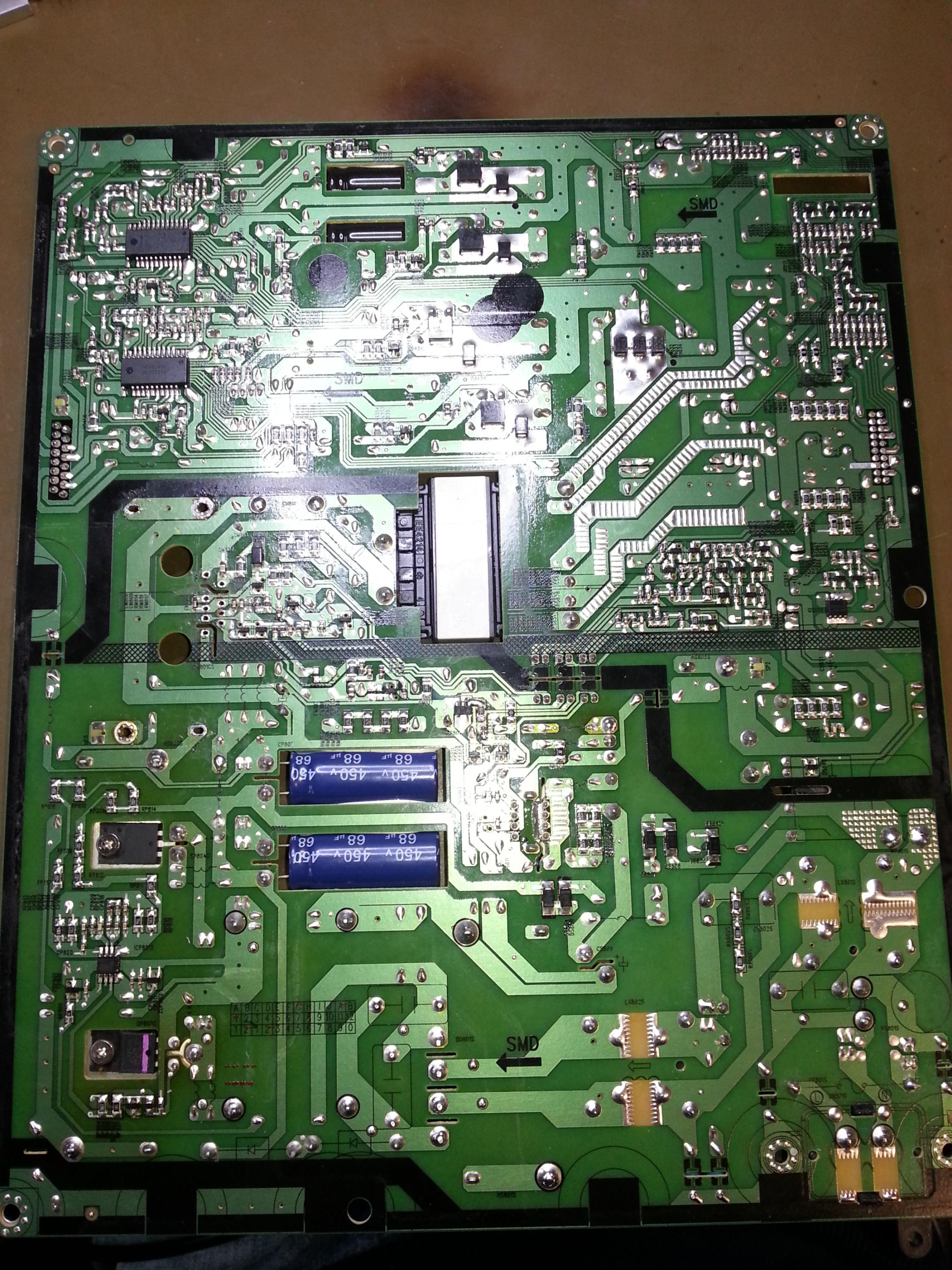

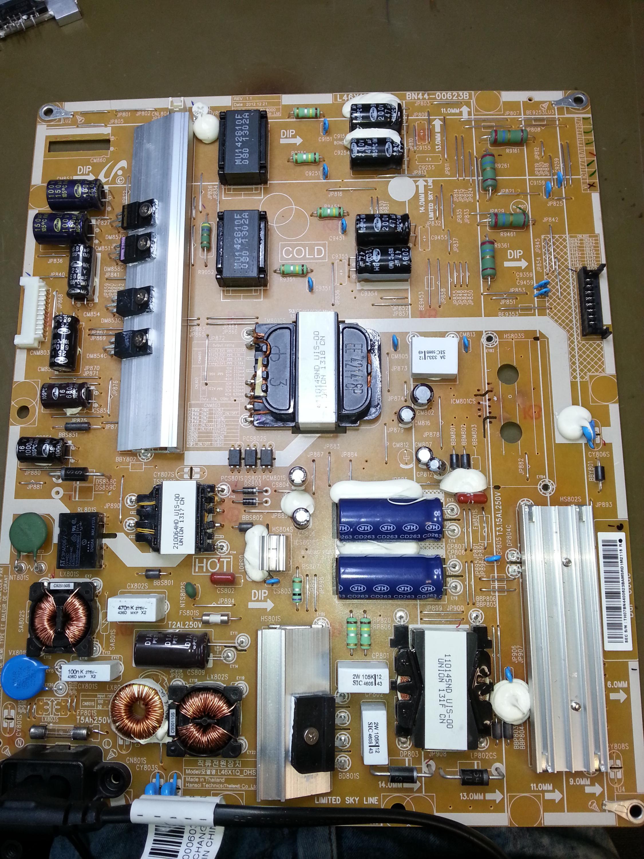

Good day folks. In this "episode", I need a bit of advice with this power supply: bn44 00623b. Can't find a bloody schematic :|
Problem is as follows: when I got it, ICM801CS (a FSFR1800 HSL) was blown. Other than that, nothing else appeared faulty - no shorts or anything. I replaced it and I tested it out using the lightbulb just to be safe. The bulb doesn't indicate any issues (as much as a bulb can do that

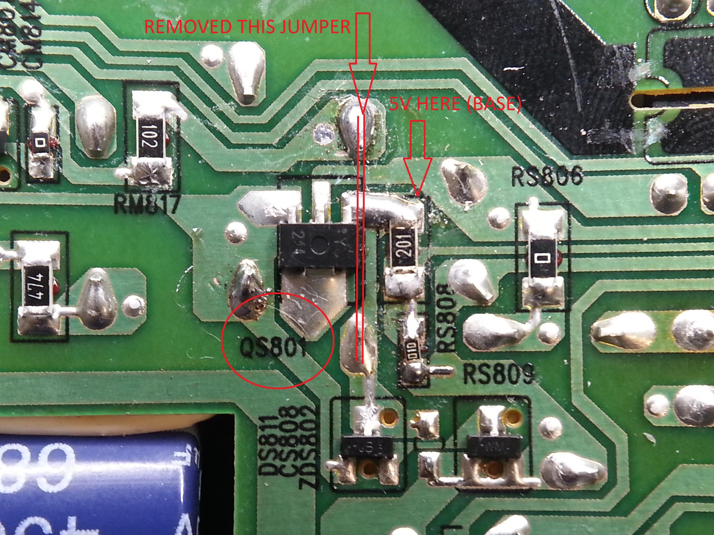

), the relay closes, I get 330v on the main caps and that's it: no output and no PFC. As far as I know, Samsung PSUs start with no main board connected, so this one SHOULD do that too and sure enough, I do see around 3v on the ON-OFF pin. Part of the problem is that I don't get 18-19v on the VCC pin of the PFC IC - I only get 5v which is not near enough. I checked the resistors around QS801 (a KTD1624 apparently, after a LOT of searching). This QS801 should control VCC for the switching ICs and I get 5v on its base, 18v on the collector and 5v on the emitter (which runs to the ICs).
I then tried "forcing" the PFC to turn on by turning on that transistor no matter what, so I removed the jumper going between the base and RM817 which goes to GND. This indeed turned on the required 18v, but my bulb also came on bright and steady and the capacitors only reached around 90v - definitely not OK and I'm not willing to risk putting this setup on mains
Could it be because of the bulb ? Does an APFC circuit start up normally with a series lightbulb ? My guess is the caps fail to reach the required voltage so the PFC IC keeps "pumping" to try and do so, which draws current and keeps the bulb on....not sure :|
