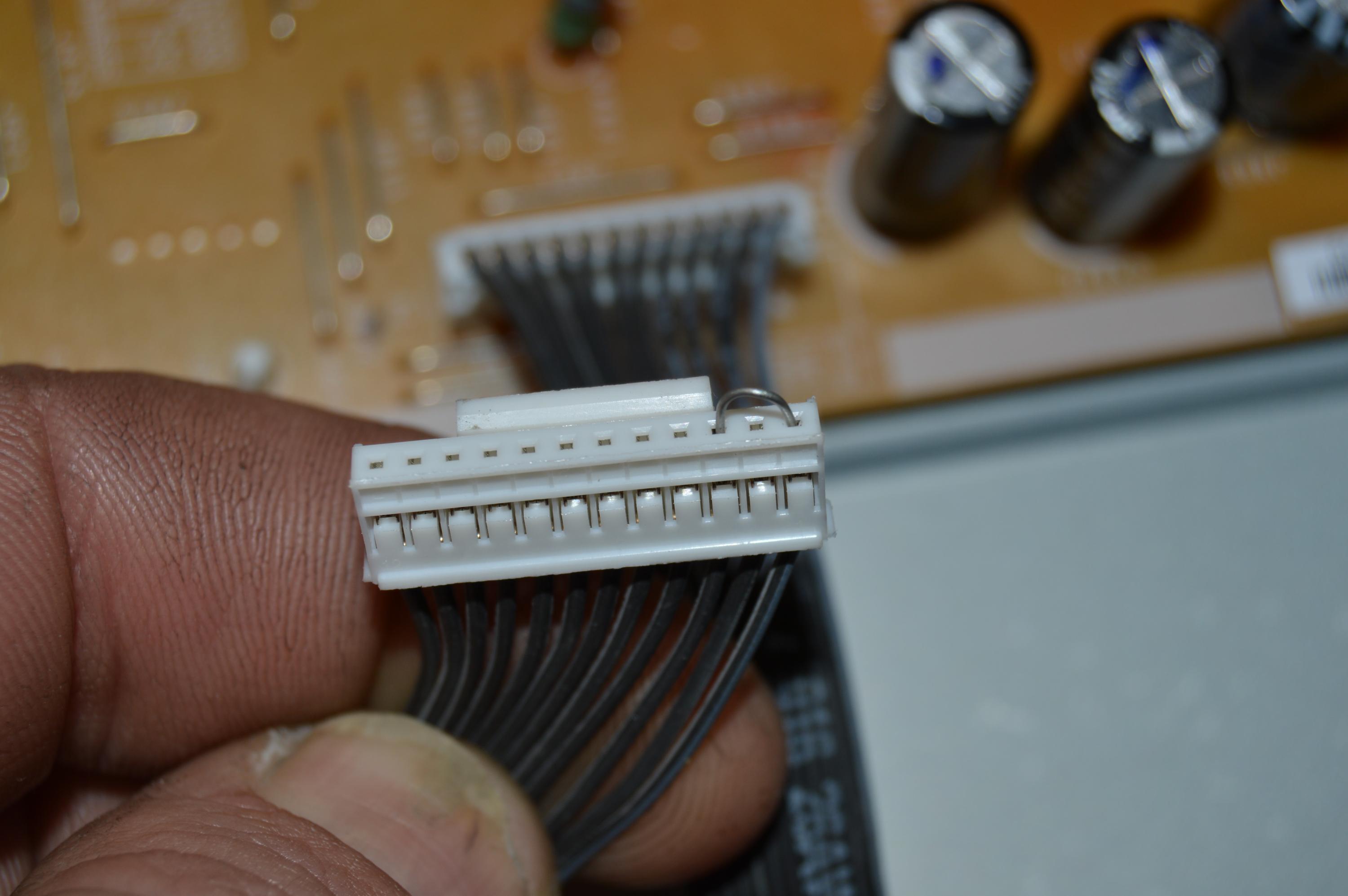

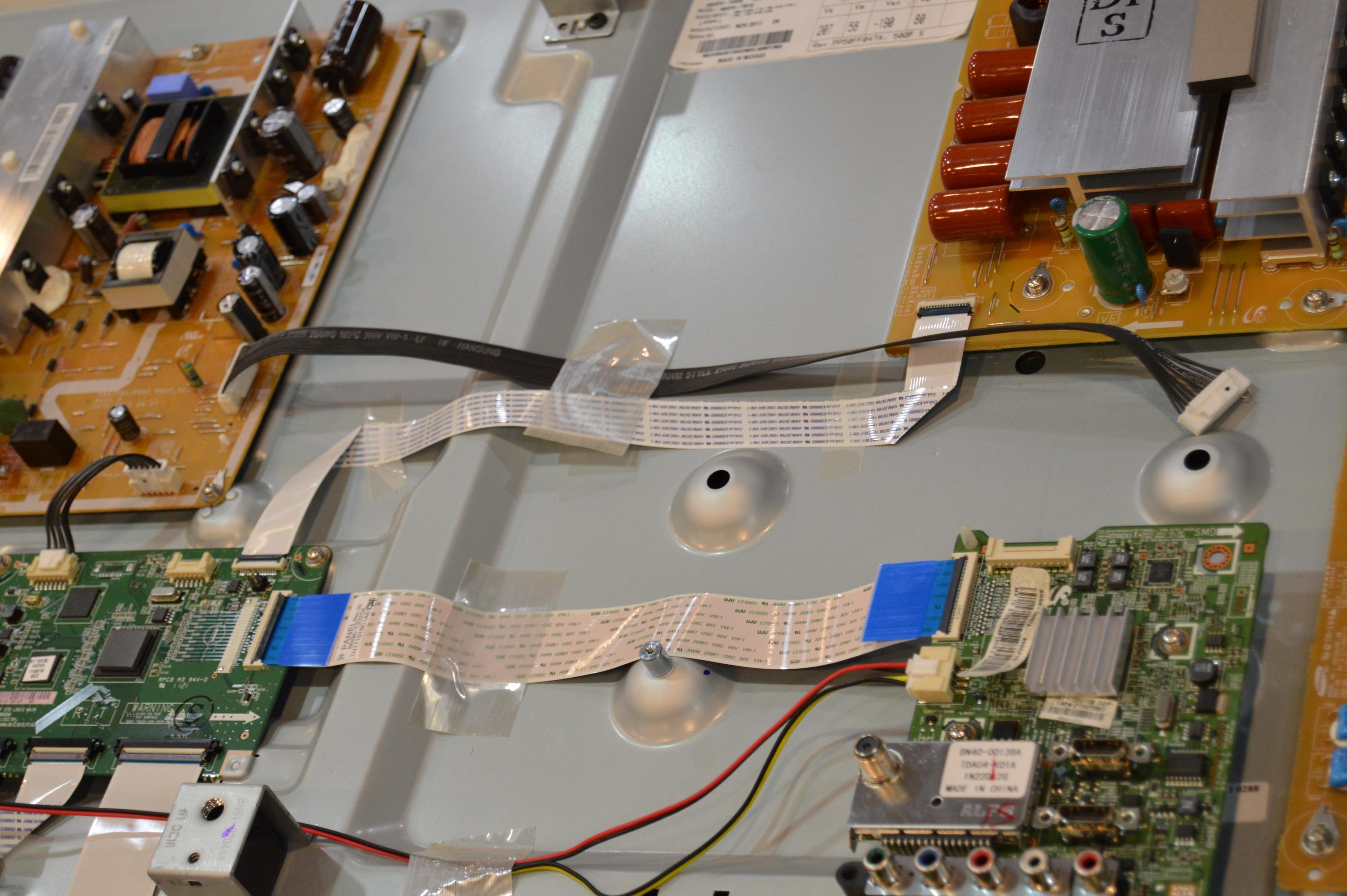

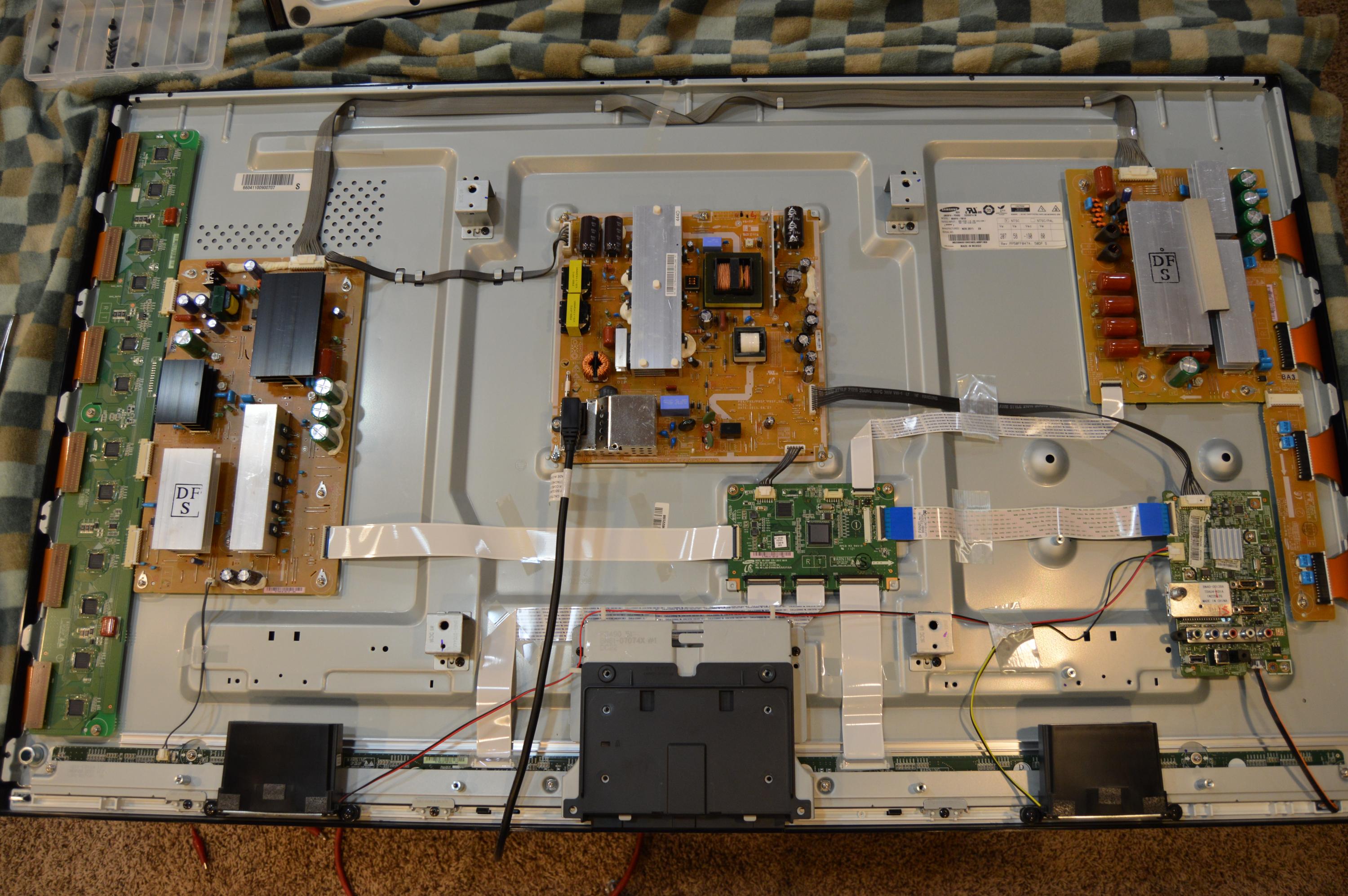

    Have a Plasma TV that won't turn on. I did replace the two 25v 1000uf caps with no luck. Any advice would be great. I have some voltage readings and pictures.
    Power on 2.82 vdc
    Stand by 5.2
    Everything else is 0
    https://www.badcaps.net/forum/attach...1&d=1512780371

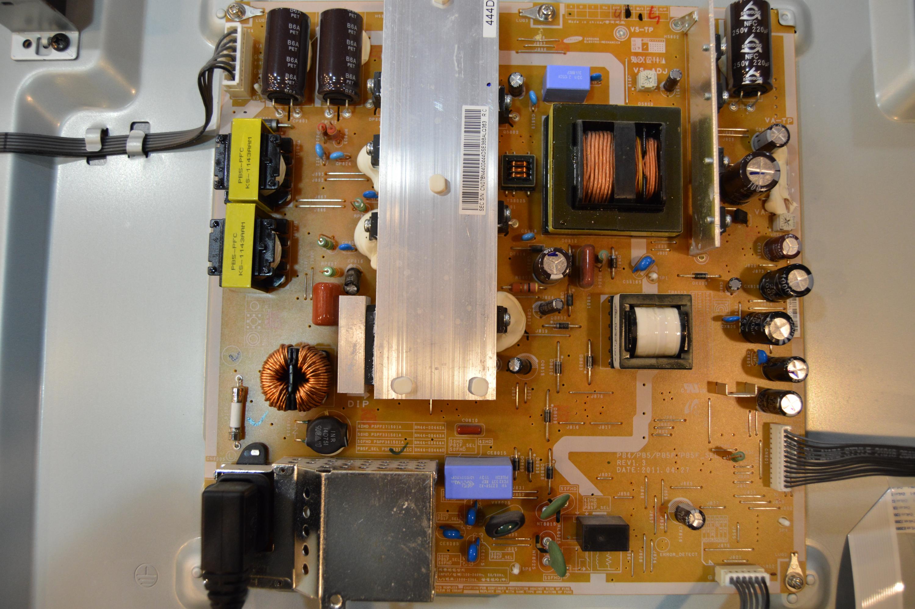

        Re: Samsung PN51530A3FXZA Dead Set
        do you get stdby voltage on the PSU to the main?
        • shadetreetrader11
          • Oct 2015
          • 230

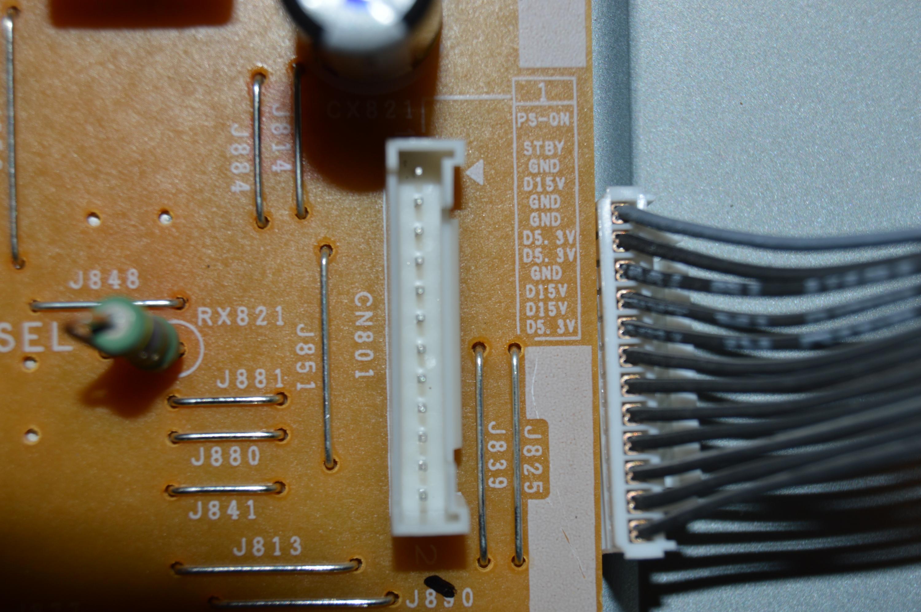

          Capleaker thanks for the response. On connector CN801 (psu to the main board). POWER ON has 2.82 volts
          STAND BY has 5.2 volts
          No voltages are on any of the large filter caps.
          I watched a bunch of youtube videos and it seems like everyone else is having the relay clicking on and off. I never hear the relay click. No light flashing on the display side of the TV. I should note that I do not have the remote for it. Only using the buttons on the TV itself. Maybe I should see if they are working
            on cn801 measure all voltages and report back.
            So far, you know that the PSU is producing STBY voltage and the main board returns PSon to turn all voltage rails on the PSU on. Now you have to find out, if the one of the other voltage rails is shorted on the secondary of the PSU,
            OR: if there is a problem in the primary side of the PSU. Also it could be that the relay is bad etc.
            The power button on the TV should be working as the main board returned PSon when you measured it.

                I jumped the PWR ON to GND and now I have some voltages to report to you. These voltages were taken with the cn801 connector unhooked from the main board (just like the picture).
                cn801
                1 pwr on 0 ( I have it jumped to gnd)
                2 stby 5.3
                3 gnd
                4 D15v 15.52
                5 gnd
                6 gnd
                7 D5.3v 5.29
                8 D5.3v 5.29
                9 gnd
                10 D15v 15.52
                11 D15v 15.52
                12 D5.3v 5.29
                cn802 (psb to logic main) Also the led (heart beat ) was flashing steady every second.
                1 D5.3 5.29
                2 D5.3 5.29
                3 gnd
                4 vs-con 3.27
                5 ps-on 0
                6 vs-on 3.29
                cn804
                1 va 58.4
                2 gnd
                3 D15v 15.52
                4 vs 207.4
                5 vs 207.4

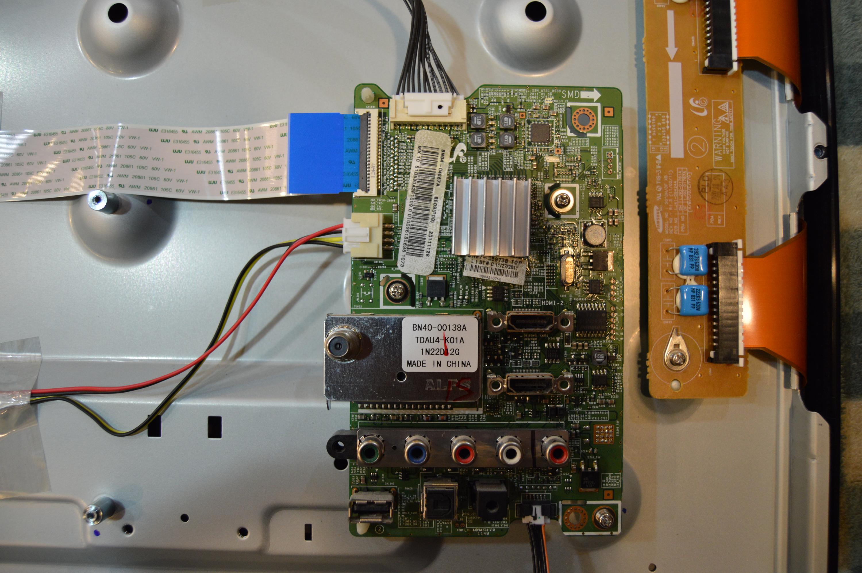

                  I'm assuming it's the main board that has problems?
                  • CapLeaker
                    Leaking Member
                    • Dec 2014
                    • 8214
                    That is what I am thinking too, since it won’t turn the PSU on
                    • shadetreetrader11
                      • Oct 2015
                      • 230
                      OK, I just ordered one, it fairly inexpensive. While I am waiting for it. I'm going to see if there is a shorted surface mounted cap on the board. Anyone have a schematic?
                      • shadetreetrader11
                        • Oct 2015
                        • 230
                        Ok I just finished installing the main board and everything seems to be working at this time. Thanks for the help guys.
