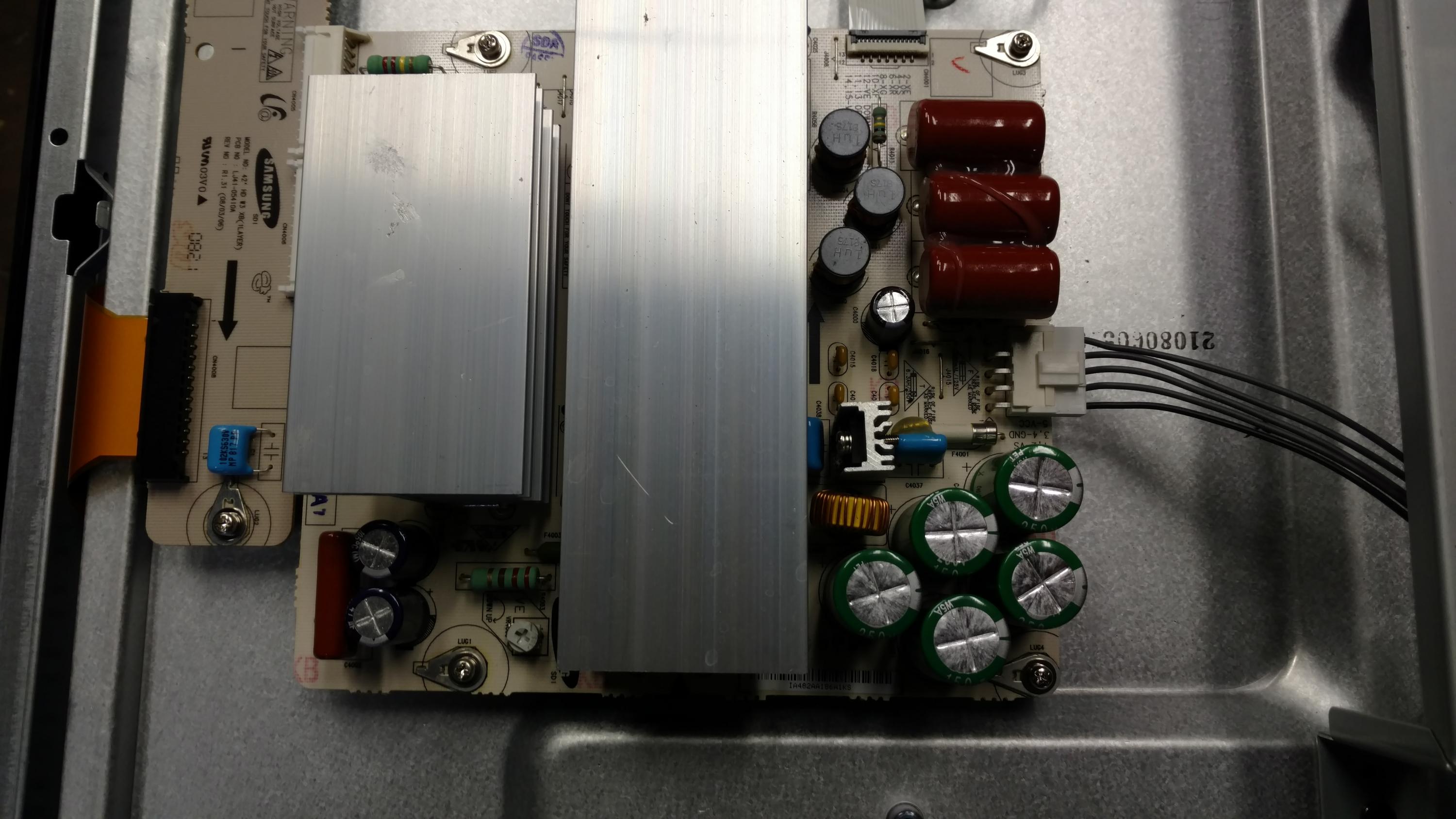

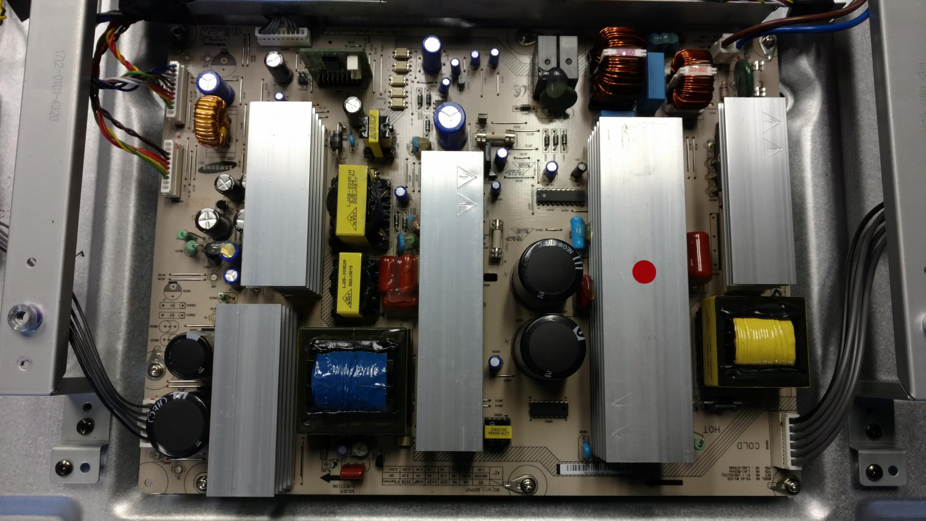

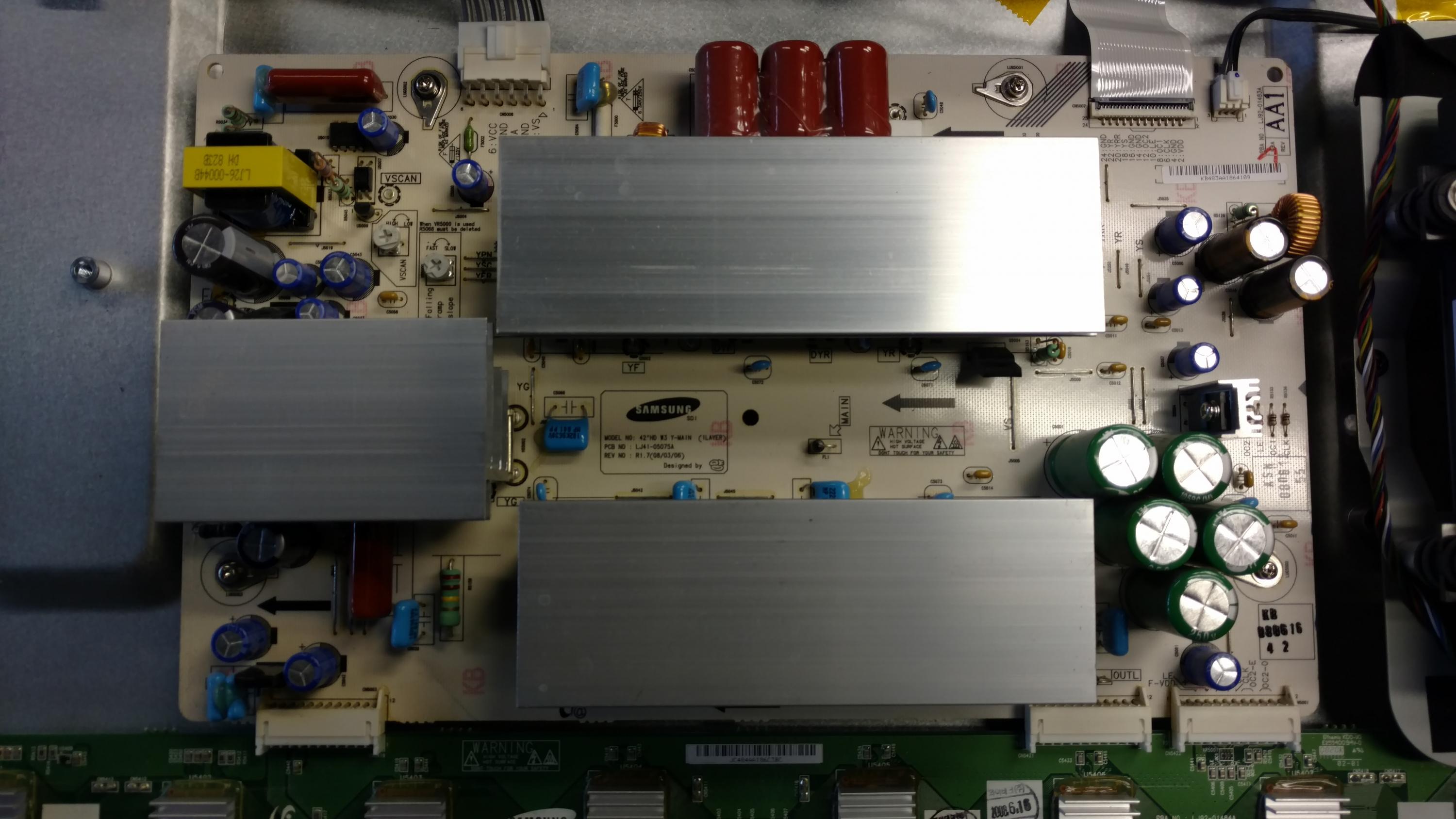

    Have a VIZIO VP423 that turns on (front name plate goes from orange to white) - power clicks on, all voltages are present on PWB. on Y_SUS Vsch = 55-77 Volts, Vscan = 185-192 Volts. On X_SUS Ve = 1.9V.
    Is this a PWB problem ?

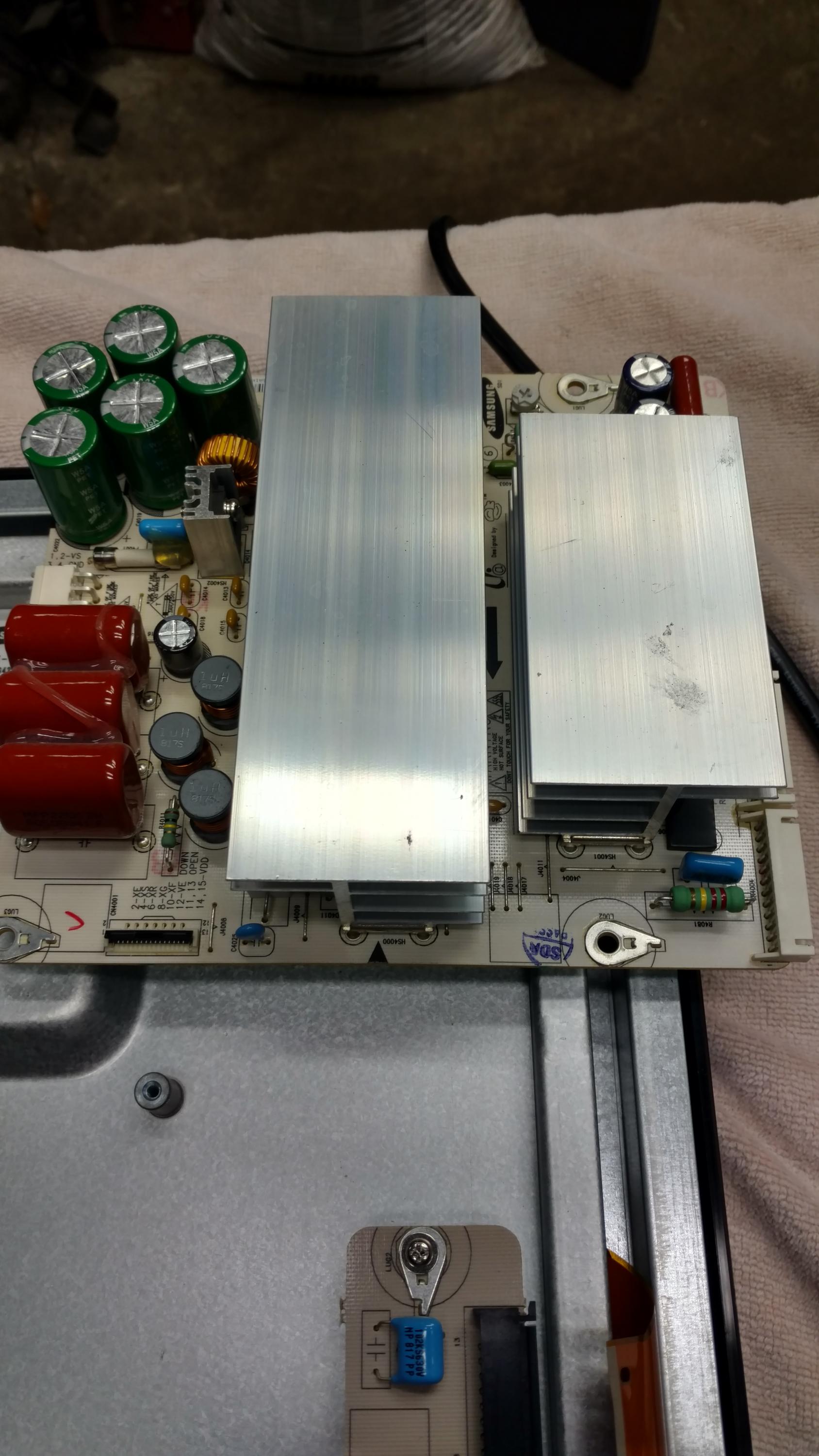

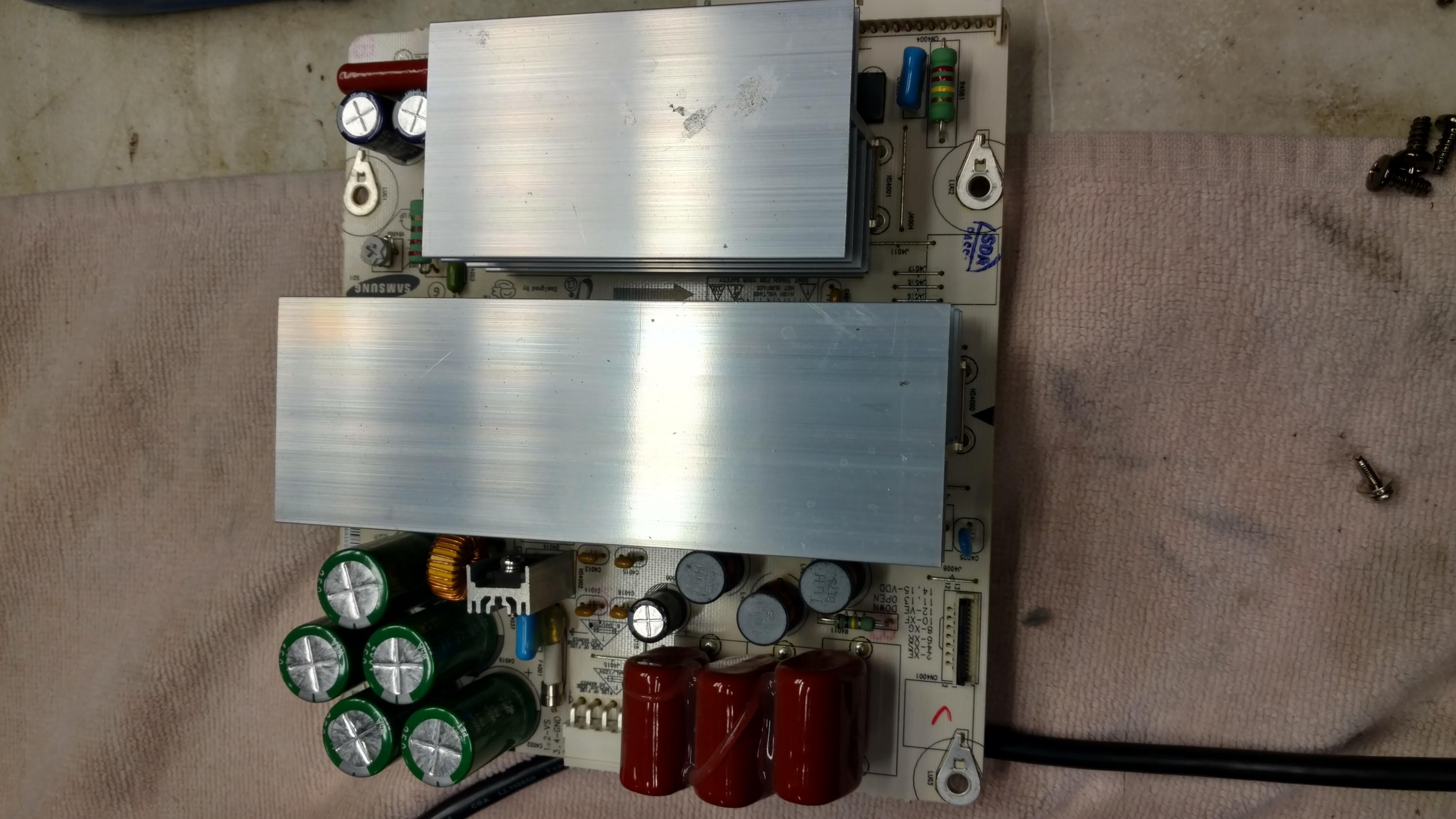

    I would try disconnecting the power connector to the X sustain. (Far right board) Your VE is way too low I'm suspecting an x sustain short on that board. Can you post a picture of the X sustain board
      Re: VIZIO VP423 no display
      X_sus board is posted above - I'll check for shorts and post some closeup pics of board.
        My apologies. Didn't see the pics before. How does f4001 test on xsus?
          nothing shorted. fuses F001 and F003 are good

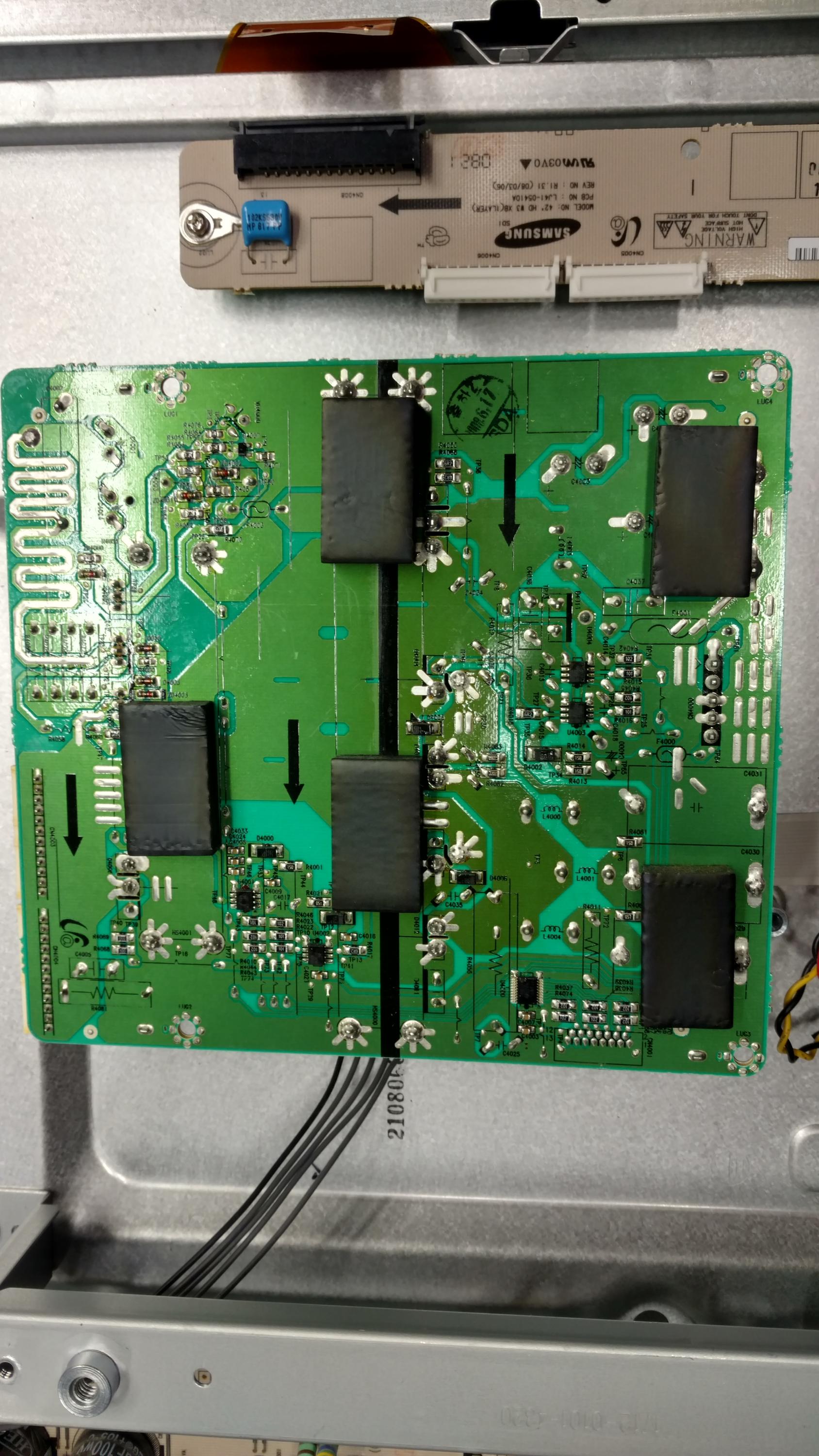

                Then in that case why don't you try removing the buffer board connections from the ysus. Possibly a shorted buffer board loading the system down

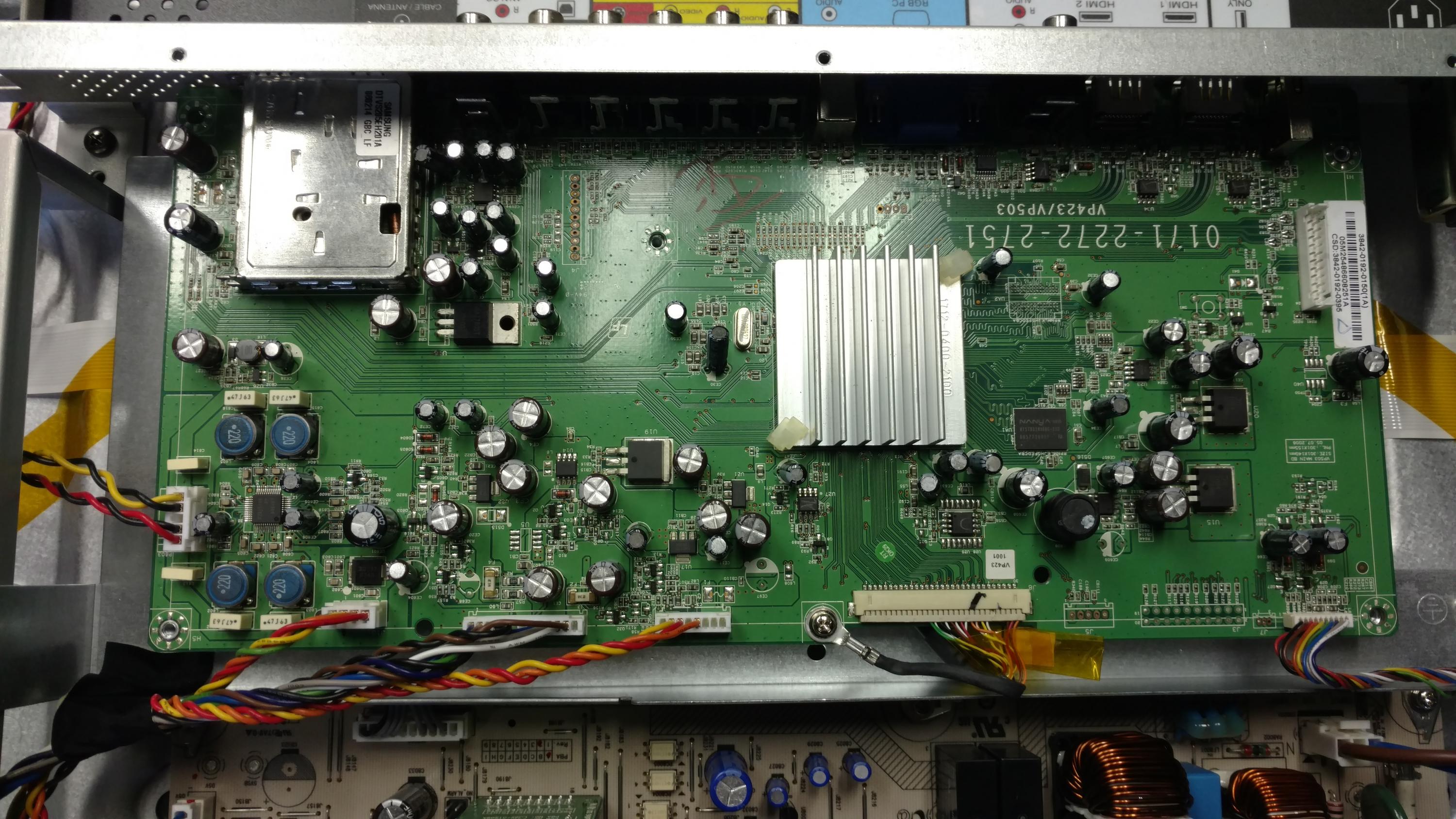

                  probably worth giving a little history of set. was working and would shut off. only way to get it to turn on with display was to wait overnite. I got the set and plugged it in - it worked. left it on overnite and next morning sound on but black display. after a week - I can't repeat this symptom. just black display but it seems to turn on (and stays on) - voltages are good and front vizio nameplate turns white from orange. changed main board with NEW one - same symptoms. don't think bad buffers would cause this scenario.
                    disconnected sustain boards & hooked up 2 100 watt light bulbs across Vs and ground. power supply comes on, bulbs come on and stay on. repeat test with X sustain plugged in - same result. All voltages are good. any ideas ???
