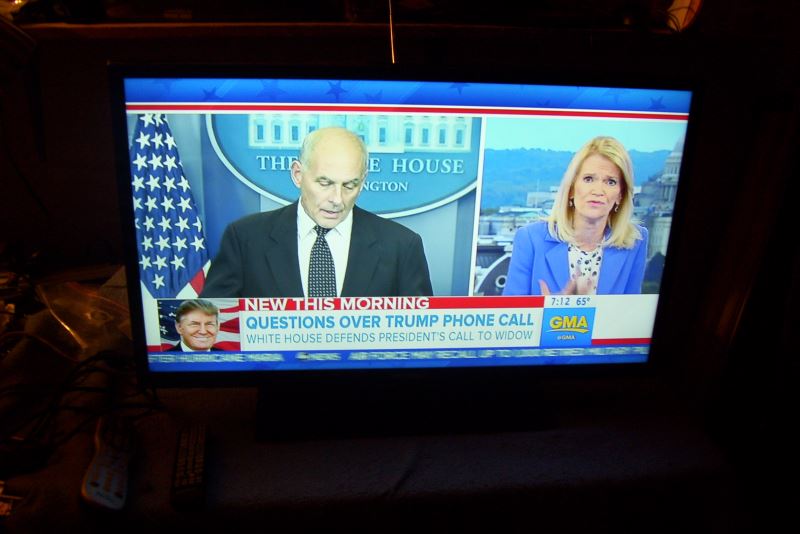

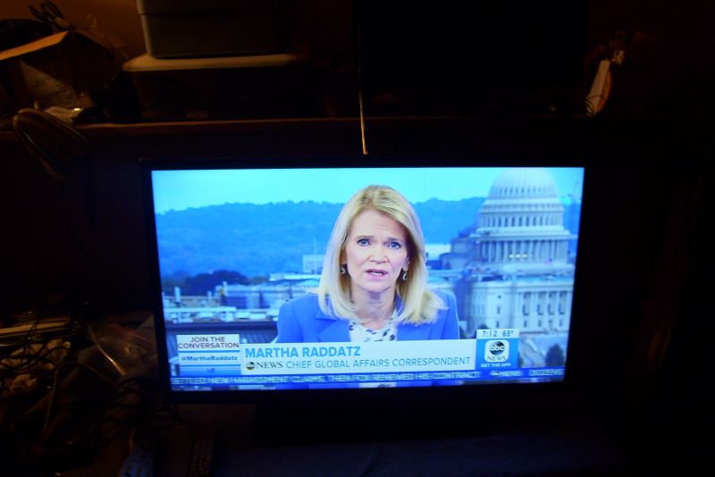

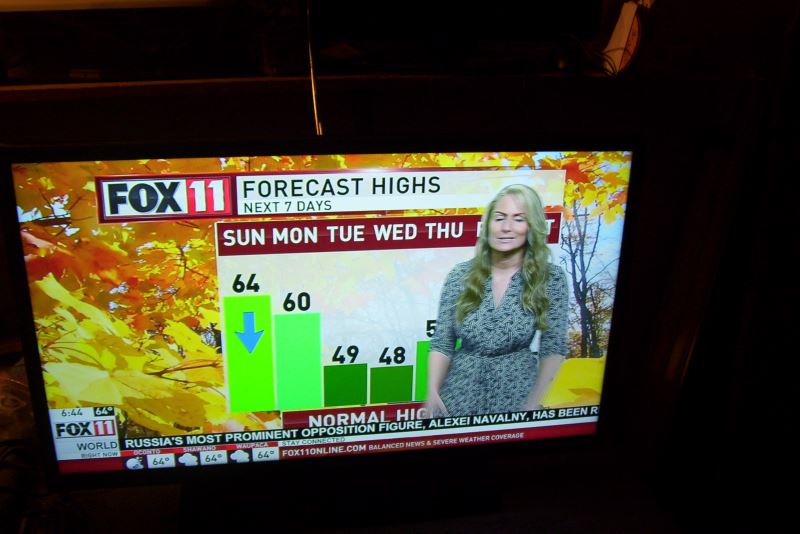

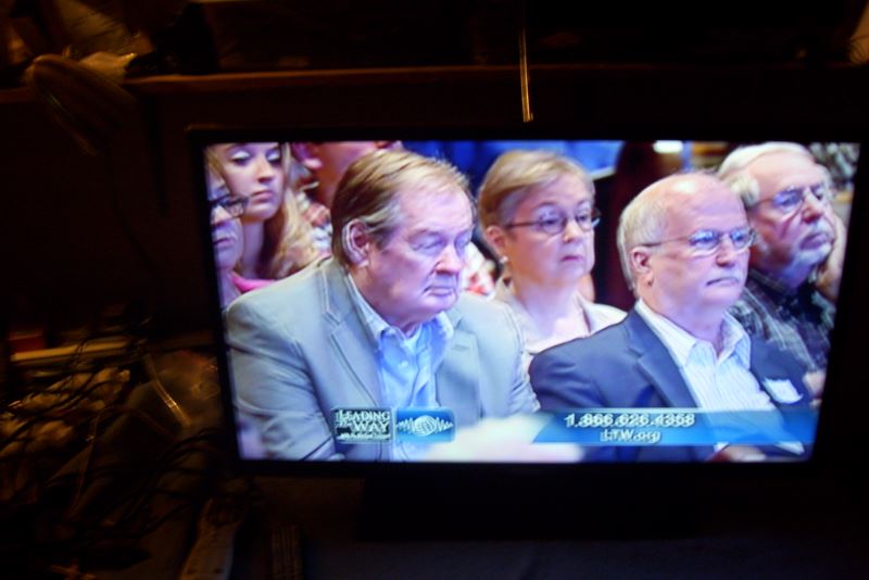

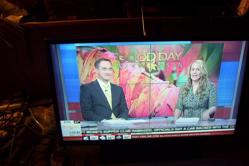

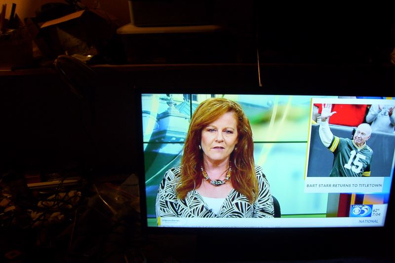

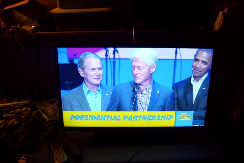

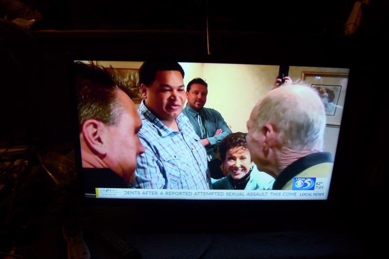

          Ok so I will try upload
          These pics the tv looks ok but could be better
          Tell me your opinions if the tv bad or is it jut my imagination
          Look at the one with the presidents that one it is more noticeable

            Doesn't look that bad, first one looks tad blurry, skin tone is little off but simply adjusting some settings should fix that. in my opinion. tried adjusting the RGB?

              Re: Samsung un32eh4003
              I have tried adjusting RGB so far I can only make it worse not better
              If I use the Dynamic pic setting it is too strong of a pic as if too much color sometimes a greenish sheen around peoples hair But I will try again with the settings
              • tom thumb
                • Jul 2013
                • 66
                Tried readjusting everything pic is better but not to my satisfaction
                it seem maybe I just am used to a better quality pic even for a 720p tv
                My sony 720p has a much richer color tone to it
                To me this tv has a washed out pic color wise and adjusting RGB either gives an ok pic or
                to much pinkinsh color Oh well looking at reviews for this tv people were not that impressed with it anyway so I will just give it away so some charity
