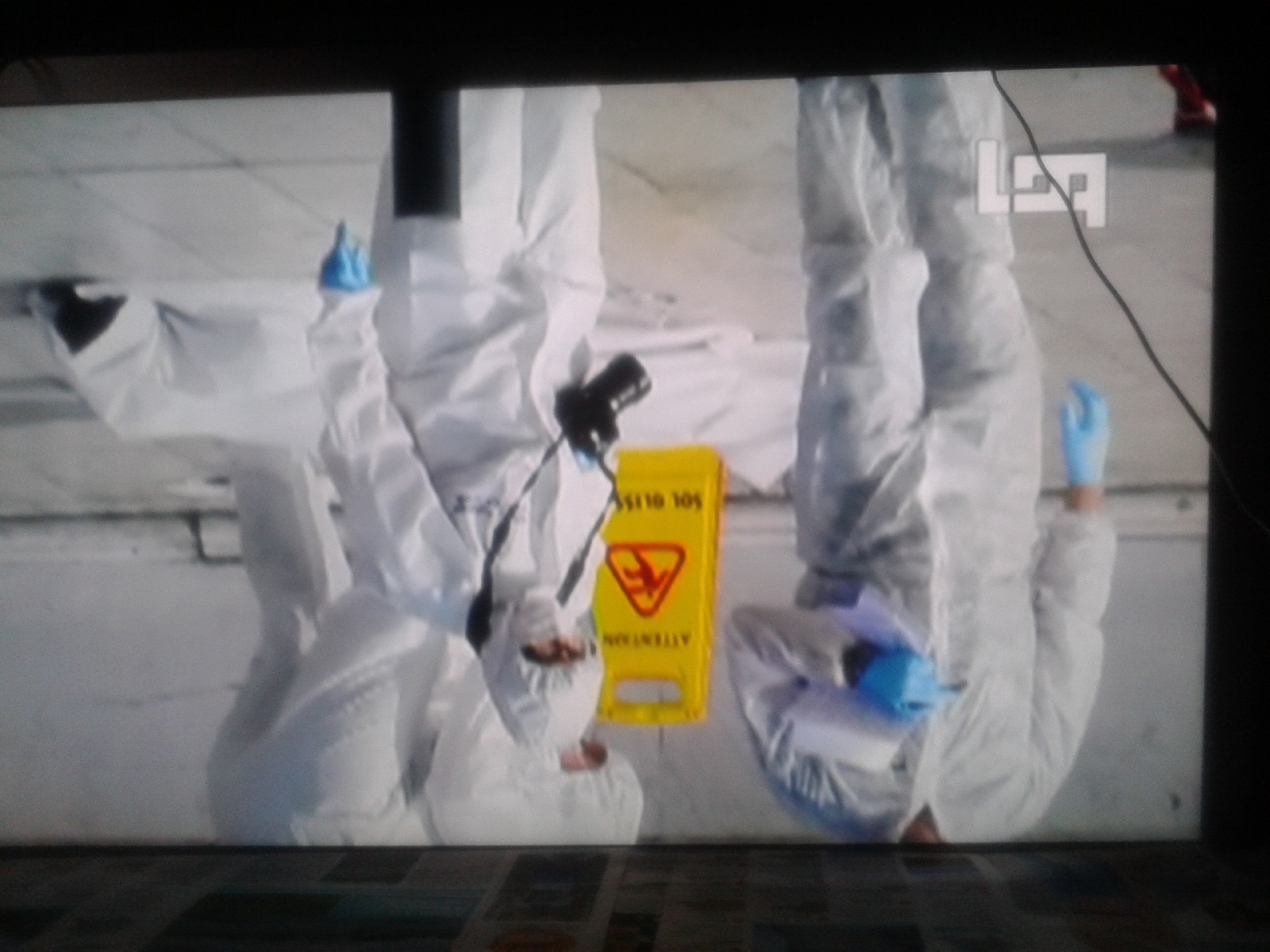

      Can you get pictures of the screen when it is on

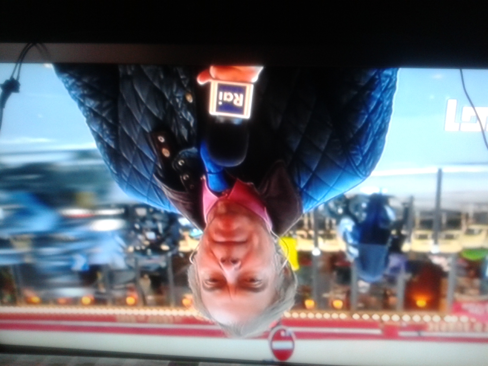

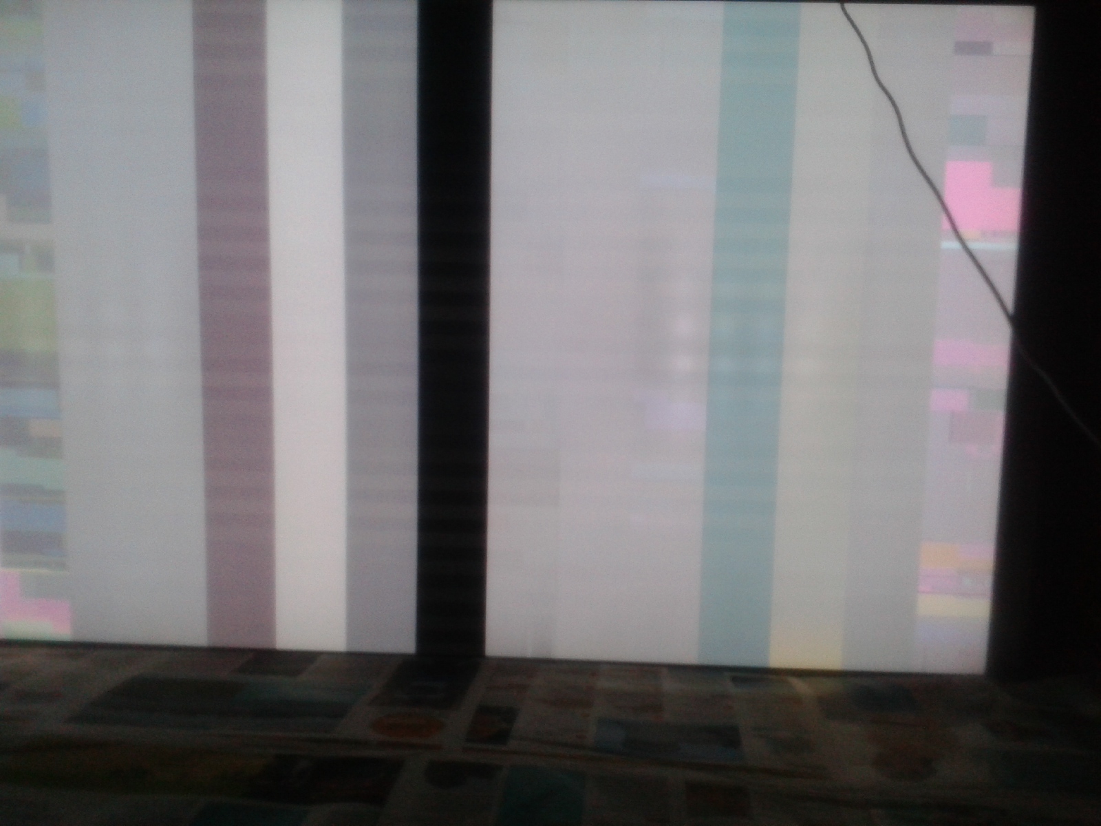

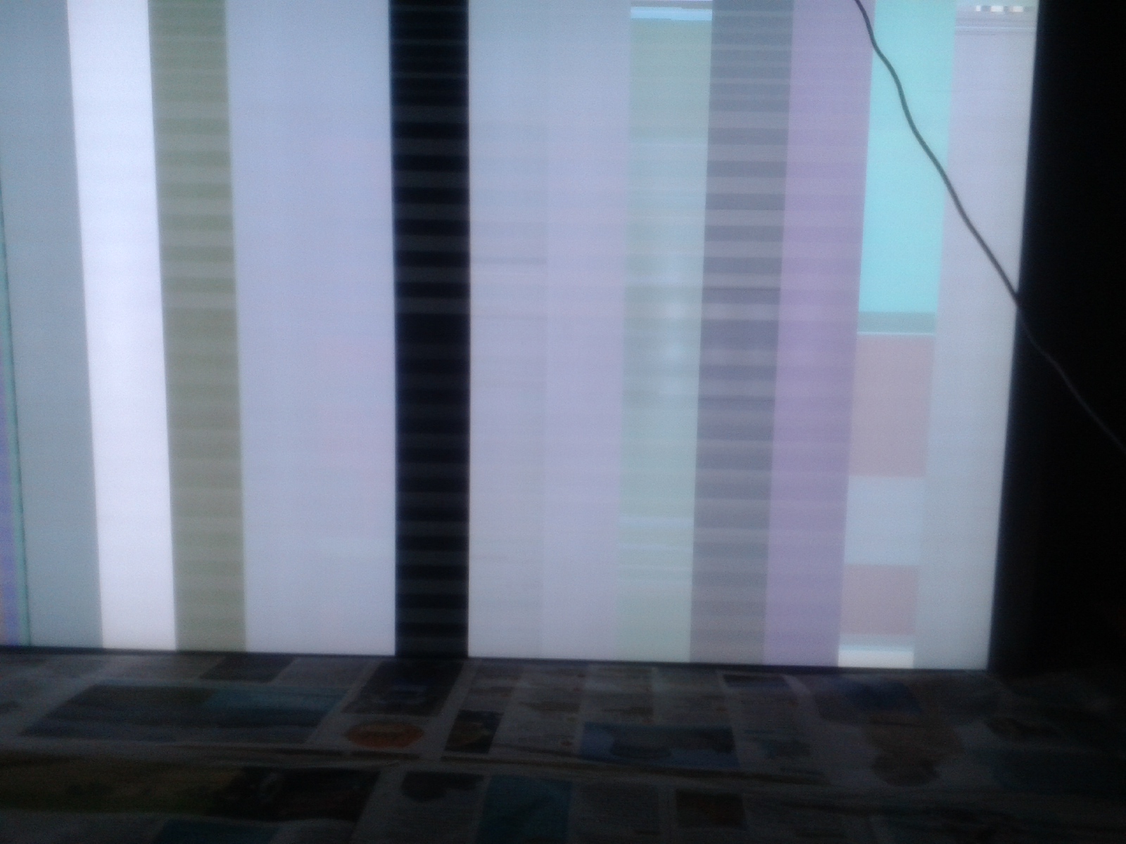

        OK i have some pictures, i can't believe that panel and boards are all faulty... at least i have to understand which one is at fault, the panel look strange to me to be faulty as i think i never seen a panel that display perfectly first seconds and then go bad..

          I would say not a bad panel. Have you tried disconnecting ribbon on each side of panel? Wiggling lvds cable

            No i don't have tried, one simple test i have forgot to do, but i've done it today, with the set cool, warm up the FRC main chip before switch it on, the result is a bit confusing, i have to redo, the heatsink was very hot, at the powerup i've seen PHILIPS logo with some garbage when in the past it never do at cool, but after this it showed perfect picture (!) then switched soon off. I've tried to warm it more just to be sure it was hot not only the heatsink (just paranoia) and at the second switch on Philips logo and any other image not displayed, so i've said "Hurra'" we have a culprit, but soon i have switched it off and on and again perfect image for many seconds before to become messed up again in approx. the same time as last days... bah. I will try to warm up also the mainboard CPU and the BGA chip near the big chip on FRC. Wiggling lvds cable doesnt show any change..
