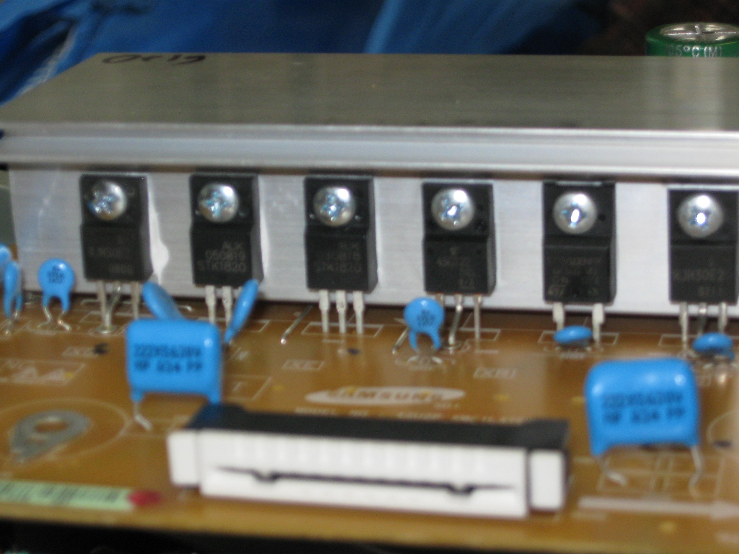

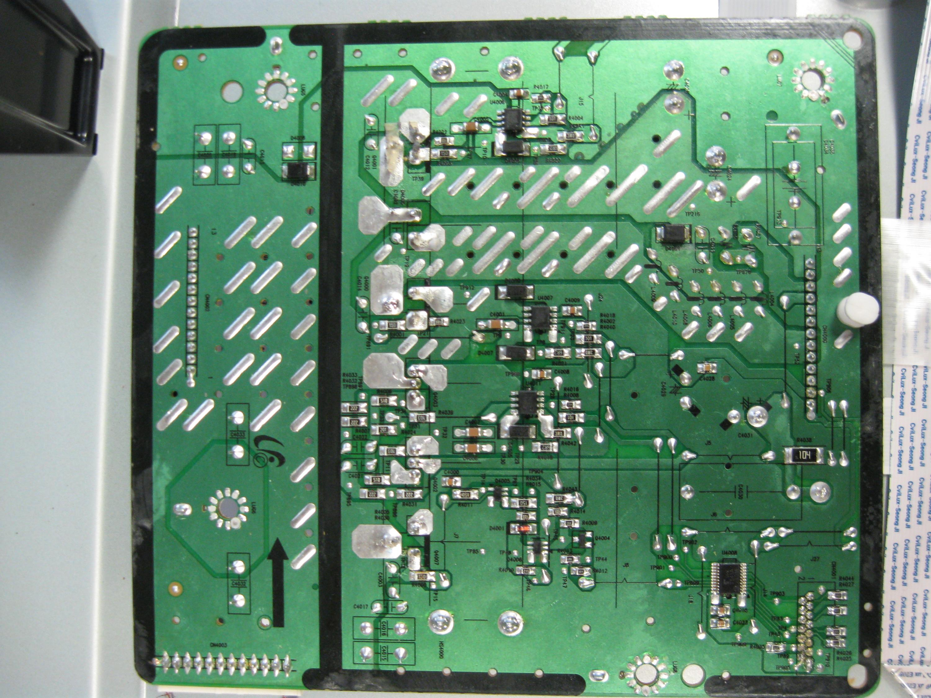

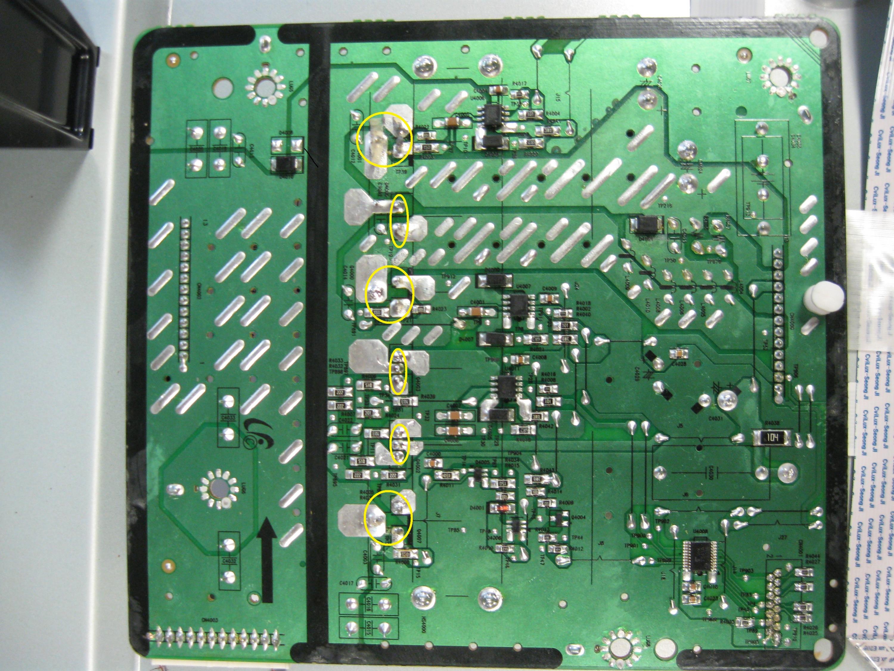

          Re: Need help troubleshooting Samsung PN42C450 Plasma
          Not great pictures, hope they're helpful in some way.
          The transistors/diodes mounted to the heatsink are Q4007, Q4002, Q4003, Q4000, D4000, and Q4001 from left to right.
          Positions 1 and 6 are labeled RJH30E2
          Positions 2 and 3 are AUK STK1820 (one has 050819 and the other has 030818, are those date codes?)
          Position 4 says 45G122
          Position 5 AUK 71517 SF10A400H
          I highlighted the pins on one image fwiw.
          • tvtimmy
            • Mar 2015
            • 1160
            • usa
            Check all the transistors. They start with the letter Q. Look for shorted parts. There is a guy on ebay that has one for about $16.
                Put your meter in diode mode and test the outside legs of the "Q" parts. A beep longer than 3 seconds means it is bad. Remove and test again. You will save time and money by replacing the board, the parts alone will cost $25 or more and you run the risk of receiving fake parts.
