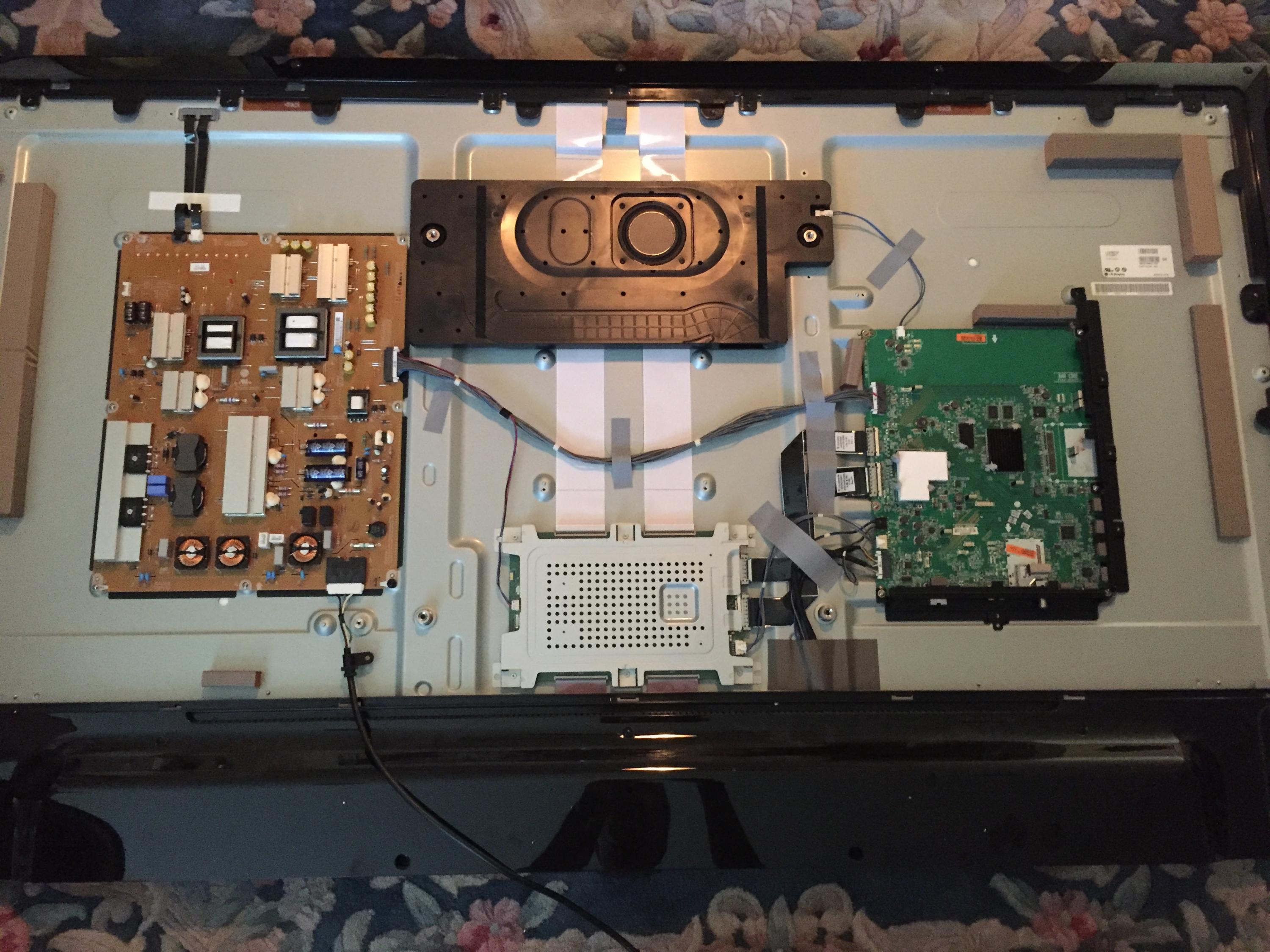

    Lg65ub9200 no pic standby volts on power bd
    3.5,12,24 volts ok
    Blinking red lite on power bd- blinks 5 times then repeats
    Red lite on main bd
    No back lite using flash lite test
    Don't know if sound works
    What should I check next? Help

    Pictures of the boards would also help to fix your problem

      Picture of lg65ub9200 panel

        Pic of panel
        Also no backlite menu or sound

          I r&r power board no help.
          I got different symptoms i.e. Relay clinks on then off- no red on main board and no red lite blinking on power board. Defective board from
          Shopjimmy? Leaning to the main board.
          Anybody got a cue? Reinstalled original power board and it returned original symptoms of post 8/20/17
