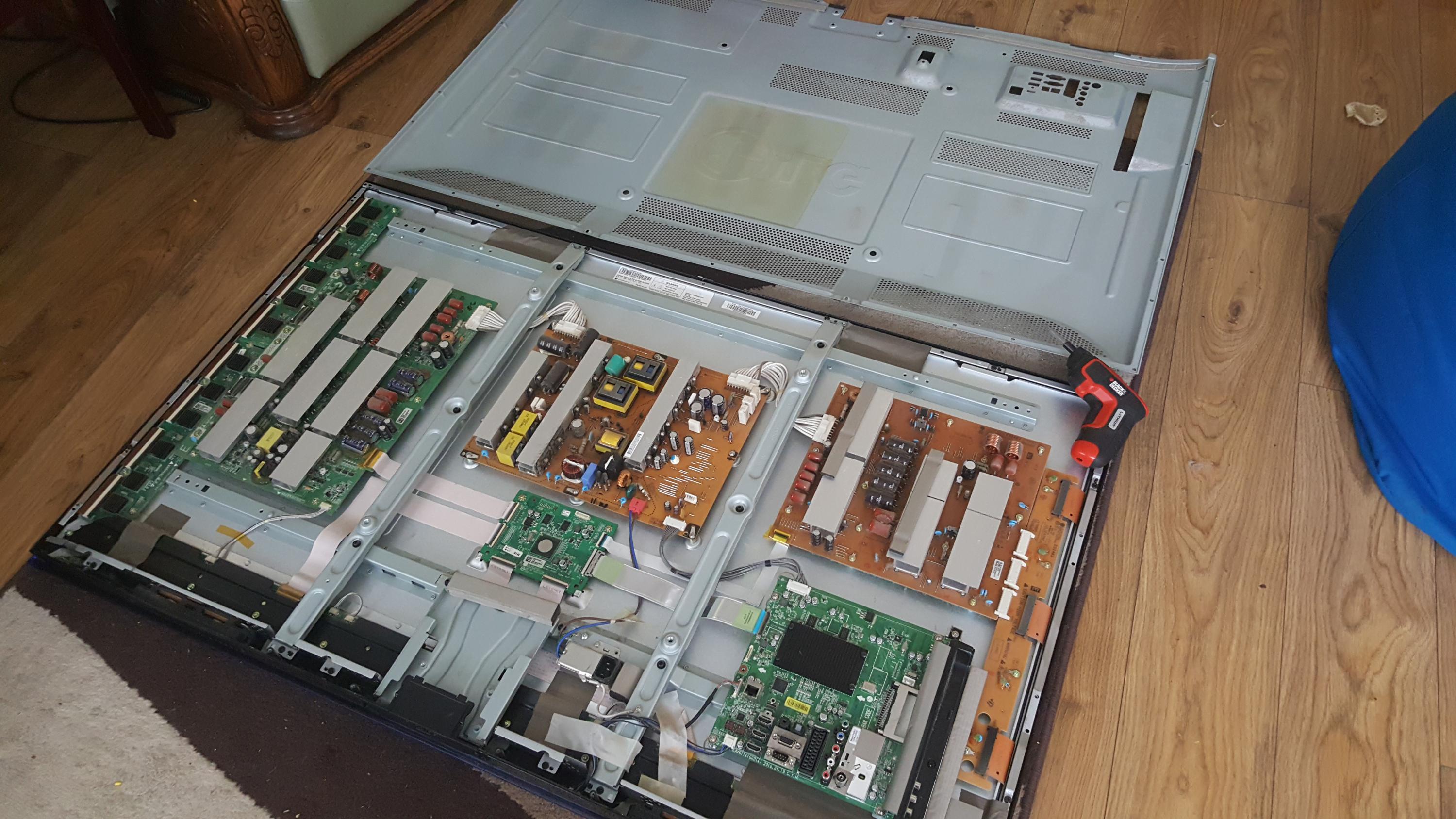

      Re: LG 50PK590 green background colour
      If it's going to save replacing a nice TV that might be able to be repaired then I'll happily take the back off it. I'll have to do it after work this evening. What will I need to do once the back's off?

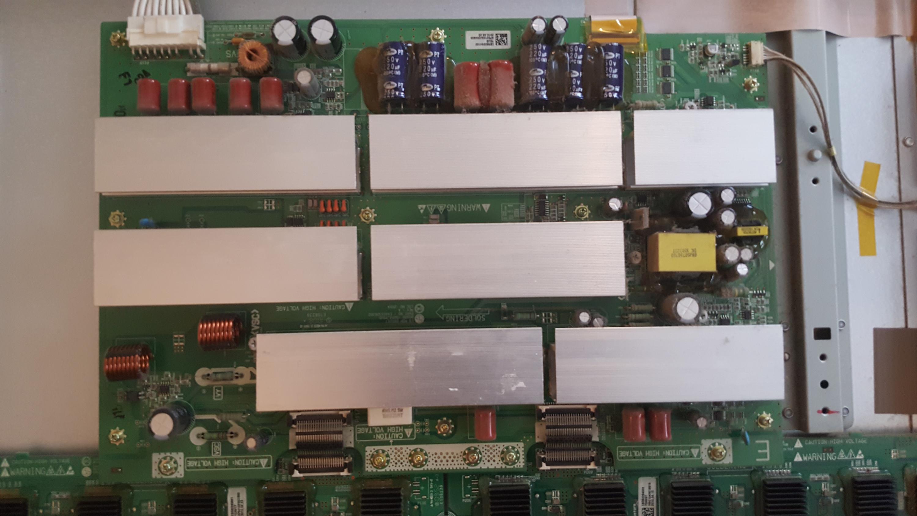

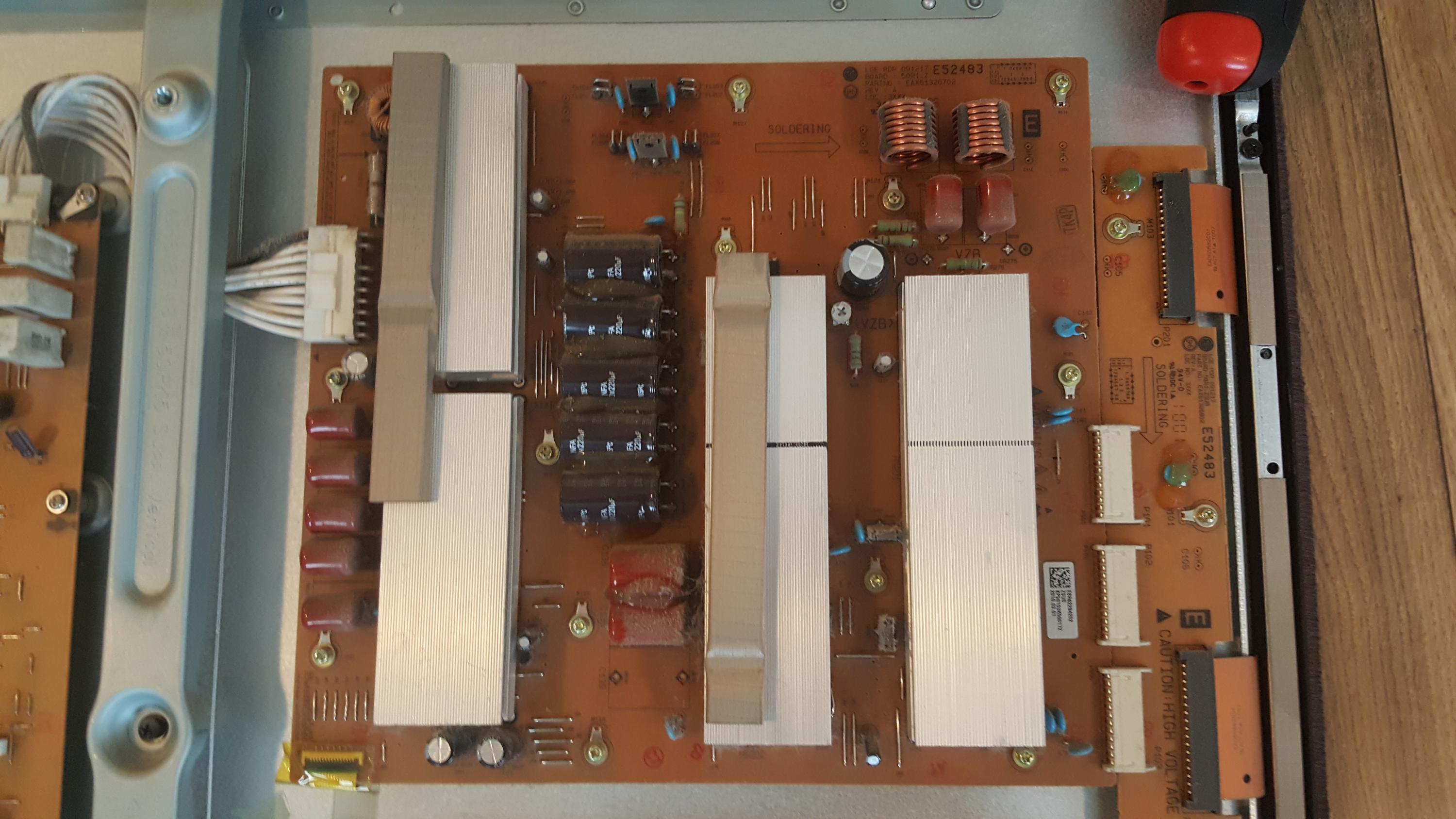

        Take good clear pictures of the whole TV circuit board layout and one of each main circuit board. There are many circuit boards. Don't worry about the ones for the infrared or anything that's buried, just the obviously visible ones.
        You can usually service these TVs with the stand on, so don't take that off (or put it on if it's wall mounted). The bolts will usually need to be out, but usually the stand bracket will hold the TV in place.
                Just take the back off (there will be a lot of screws) and get nice clear, focused pictures of each board. I don't have this TV in front of me, so I'll need these pictures as my eyes.

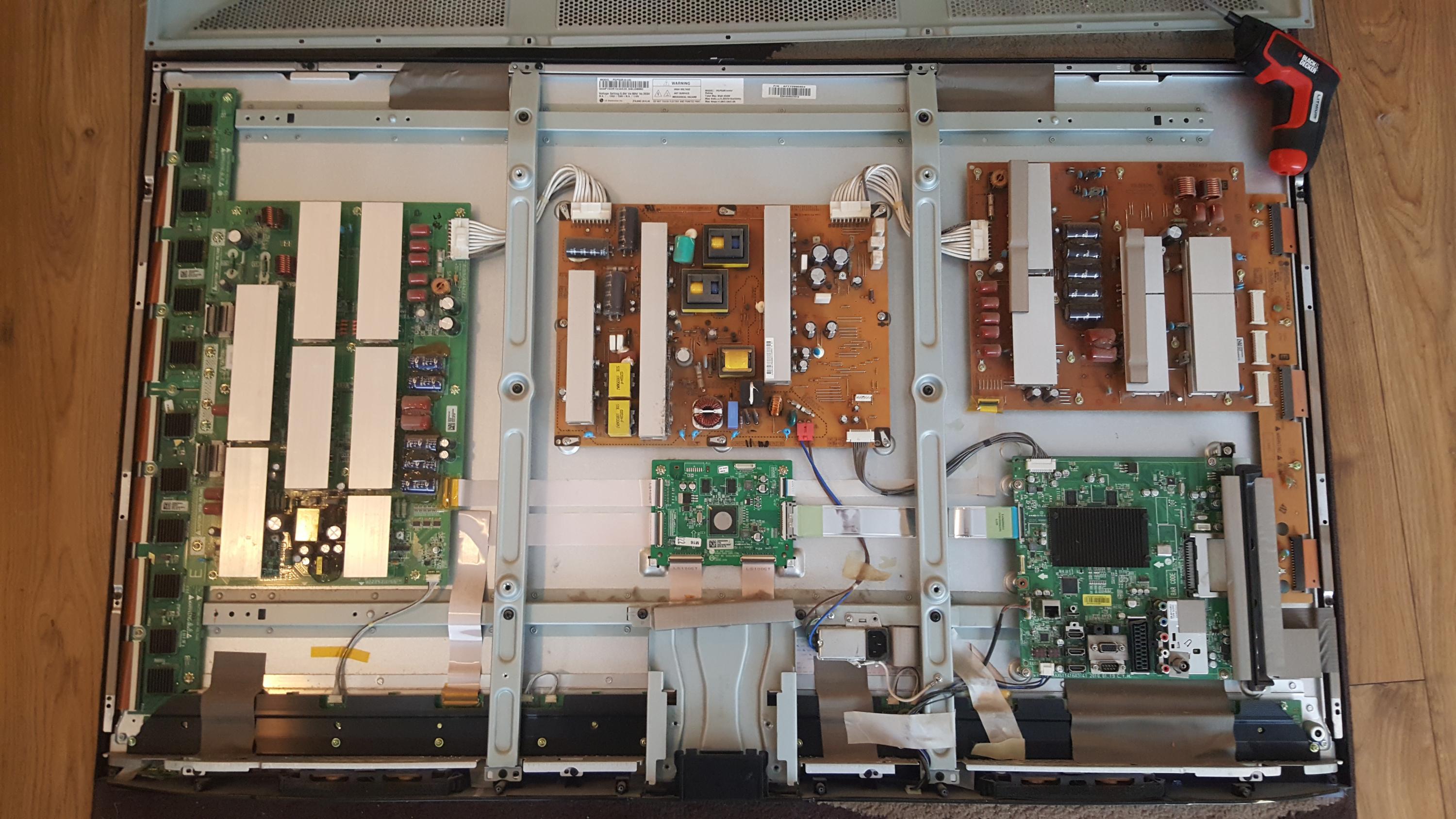

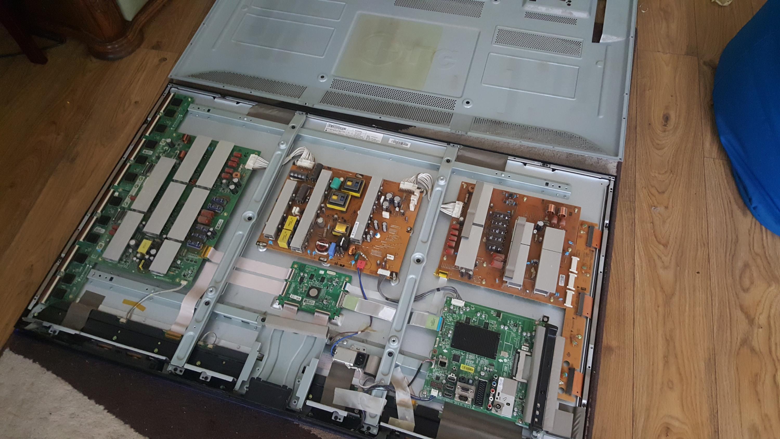

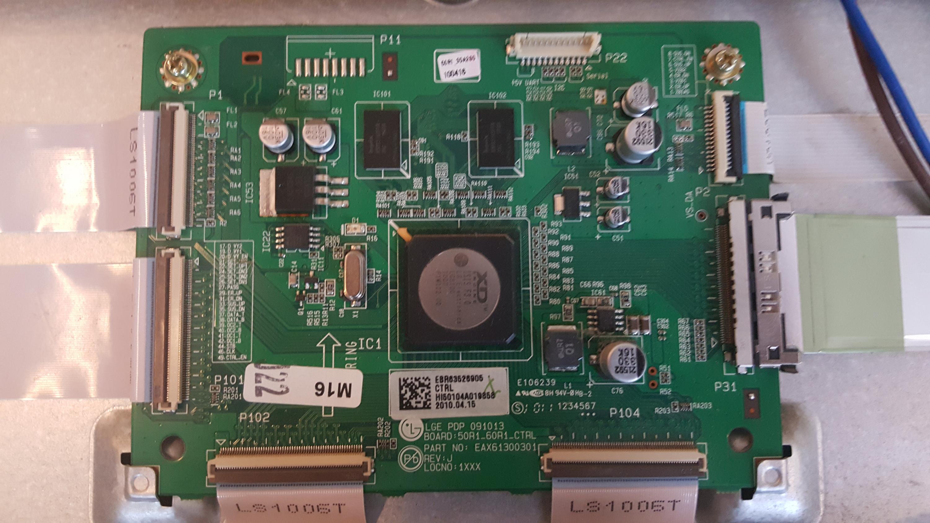

                      Thanks for the pictures. They are good.
                      We need to see what is going on with the control board, please follow the steps below.
                      1. Unplug the TV and wait a minute for everything to discharge.
                      2. On this board (attached), you will see two holes. Place a jumper wire between these holes. Could be a bent paperclip, a piece of wire... Make sure it's shorting these holes together and nothing else.
                      3. Disconnect the highlighted connector. (Squeeze the edges and gently tug on it)
                      4. Prop the TV up so you can see the screen.
                      5. Plug the TV in. CAREFUL! There will be high voltage exposed on components inside the TV, do not touch anything inside the TV while the set is plugged in.
                      6. If the TV is in standby, use the remote control to turn it on.
                      7. You should see a series of test patterns cycling on the display. Try to see if the green issue is present with these, you may need to darken the room. There is a pattern in the cycle that is black; use this in particular to tell if there are parts of the screen that are green.
                        Interesting set of eye boggling test patterns - plenty of pure black and no signs of errant greenness.
                        I mentioned that there were occasional periods where the tv was still working as it should. But they were generally pretty fleeting so hopefully this wasn't a fluked test pass.
                        (As a side note, when watching normal television the greenness has been the full screen - or, rather, any blackness anywhere on the screen would be green. It hasn't seemed to affect only parts of the screen)

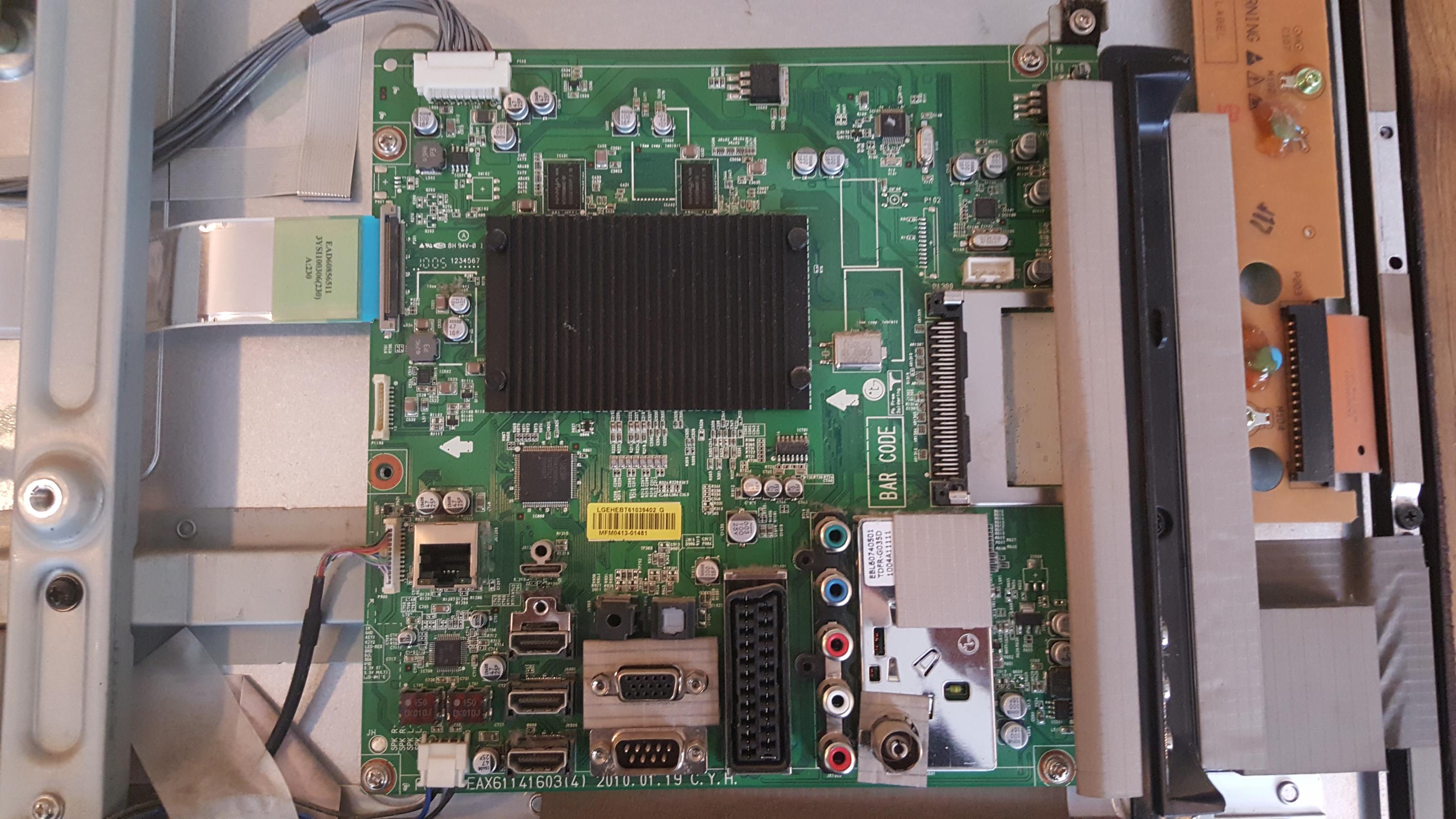

                          Assuming that the past test was not just a fluke (as you stated), that would point to the main board as the issue. That's the one with all the input jacks (A/V, HDMI, ect.).
                          If you search for a replacement, use the number on the yellow sticker (EBT61039402). Do not use the EAX number that's stamped on the board itself. You may be able to locate someone that can service the board as well. Not sure on the cost over there of service or replacement. Tom may chime back in with an idea.
                                Cool. Looks like the main board is faulty.
                                Something you can try before swapping the main board is removing the LVDS cable, cleaning it using some contact cleaner on both ends, then testing the TV again. You need to connect the cable both ends and remove the test jumper.
                                In fact, provided you feel safe enough with your hands behind the TV (or perhaps use a plastic/cardboard tool) try flexing the cable back and forth to see if it has an intermittent fault. Coloured tinges can happen with failed LVDS cables; I'm not exactly sure of the cause but it's a fairly common fault.
