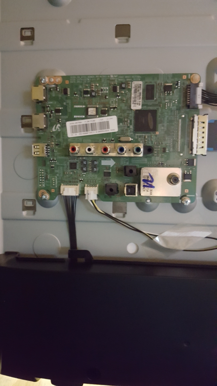

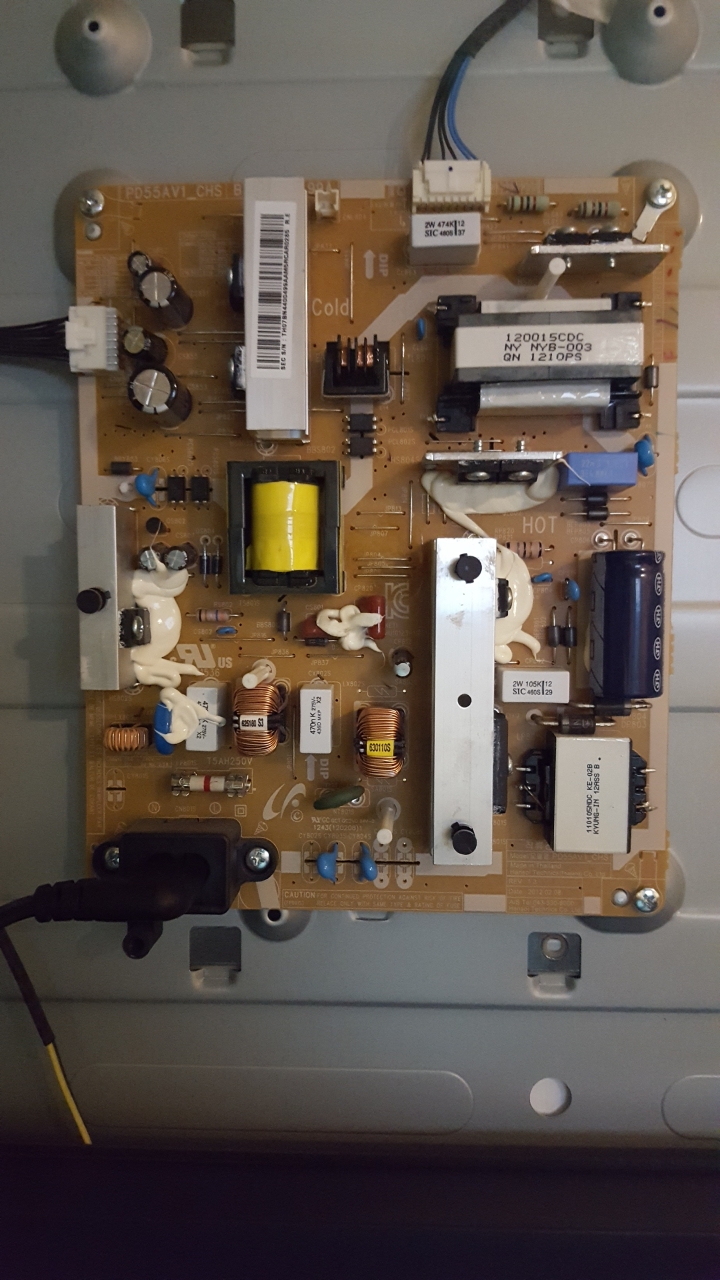

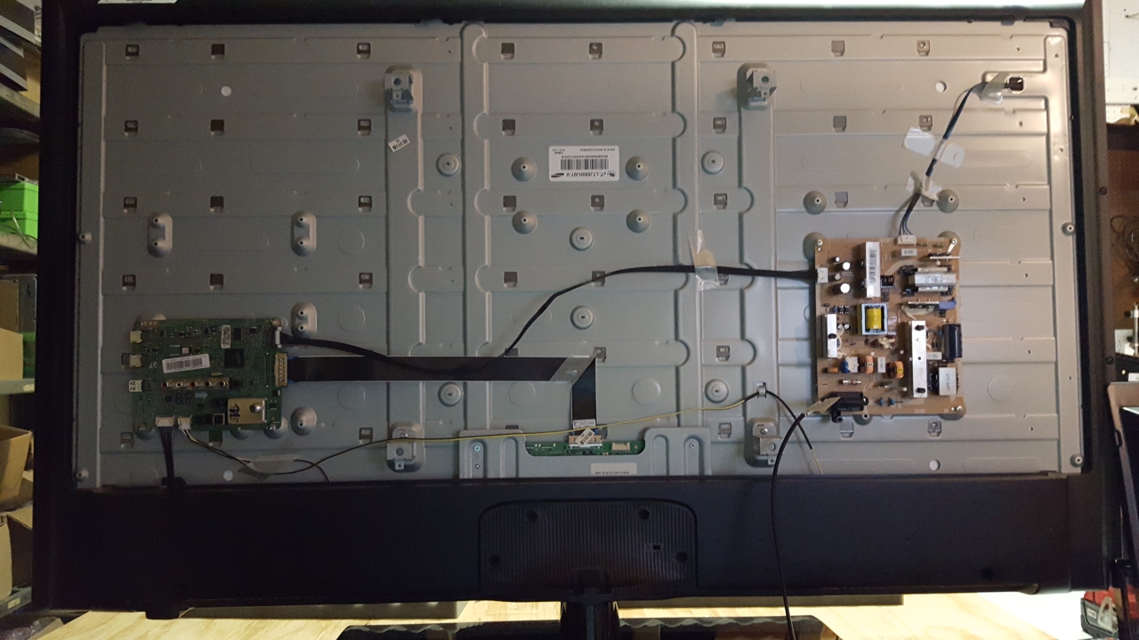

    Samsung un55eh6000f Powers on the instant it is plugged in -Backlight-no picture.
    I disconnected remote sensor and button array - same thing, it lights up LED backlight looks bright and good, no picture and no response.
    I disconnected main board from power supply, it still lights up the same. Am I crazy or is this just a bad power supply. I don't think the LED backlights should come on when only the power supply is plugged in. Also note the backlight connector is the ONLY thing connected to the power supply now.
    Photos below:
    Thanks in advance for advise.

    Re: Samsung un55eh6000f Powers on the instant it is plugged in -Backlight-no picture
    You've got a bad main board on your hands. The power supply has a built in pull up portion that is active with the main board disconnected. The fact that the screen lights up proves that it's functioning properly. Main boards for this model are very cheap. Should be a low cost fix.
      +1 At least you didn't waste money on power supply before posting. Your main board sounds dead. Probably missing voltage, bad regulator
                  Quick update. It was the main board. i replaced it and VIOLA! no troubles.
