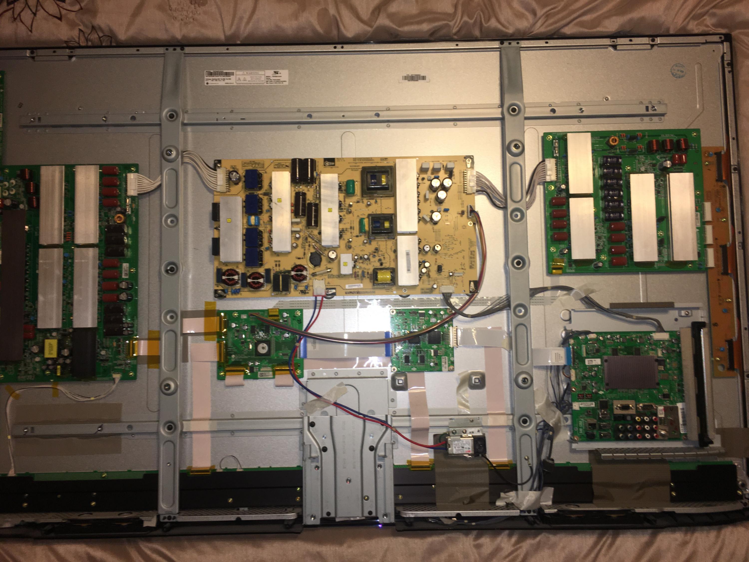

        Need good clear straight on pictures of back of tv with cover off and each board.

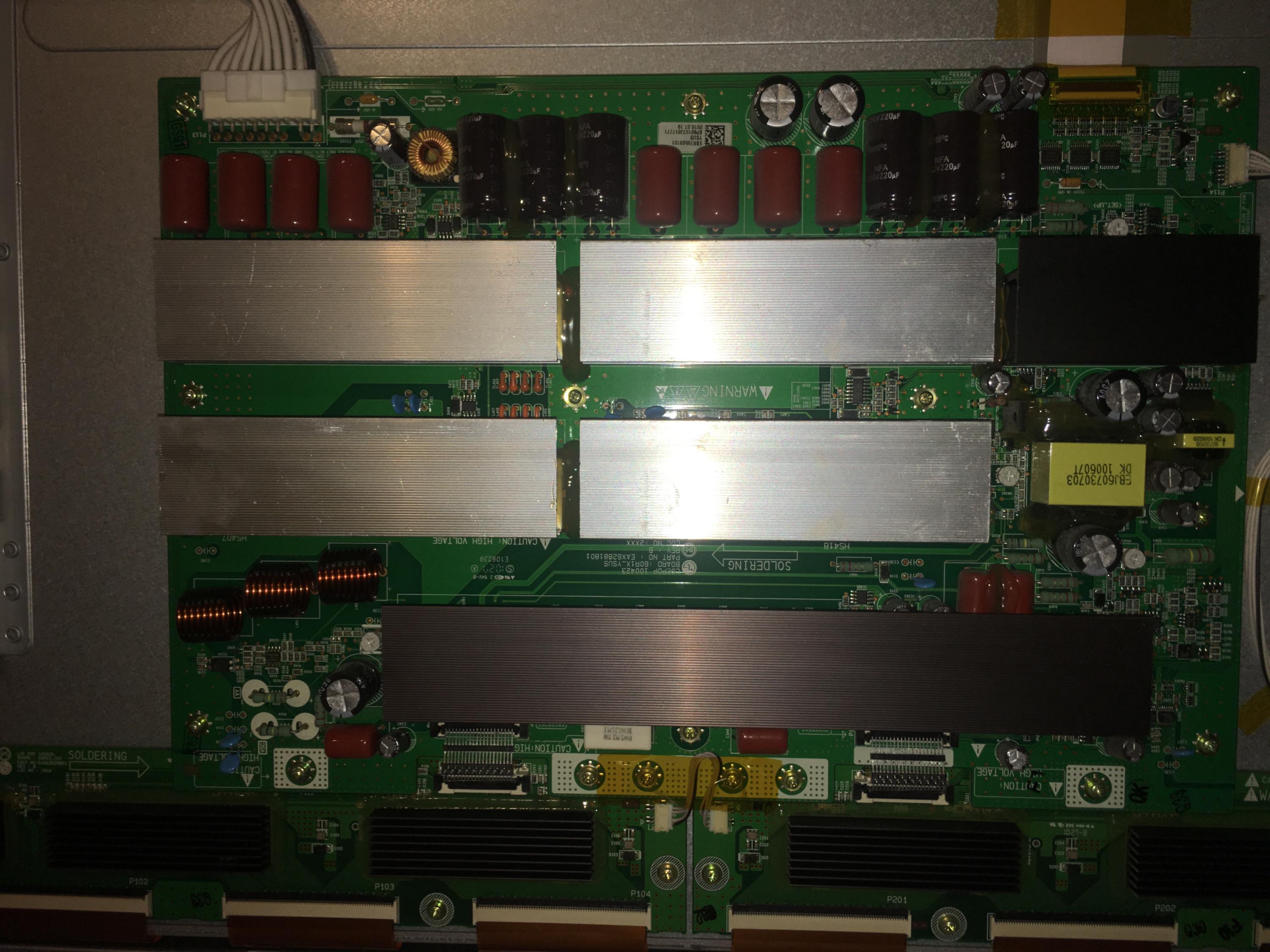

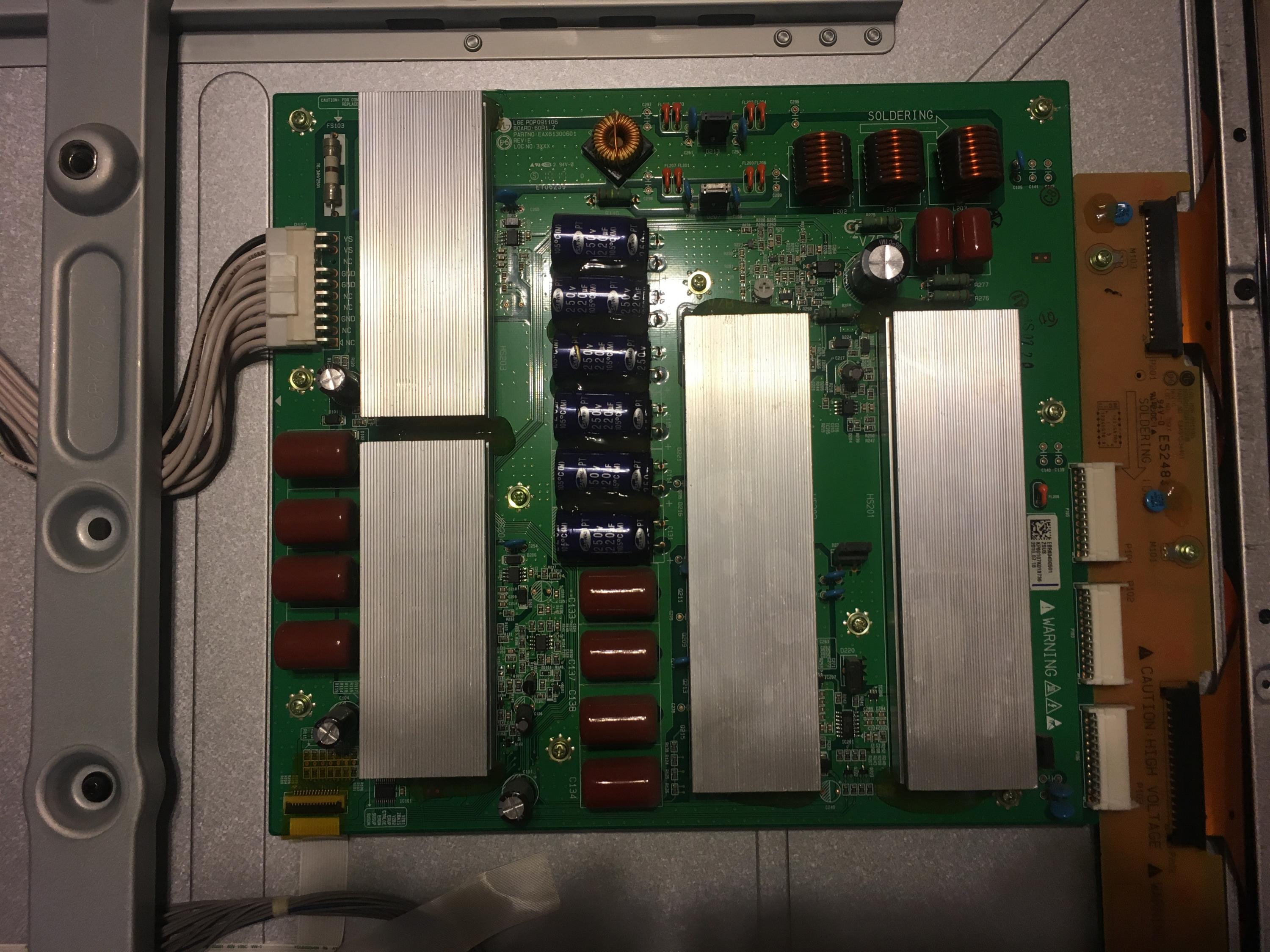

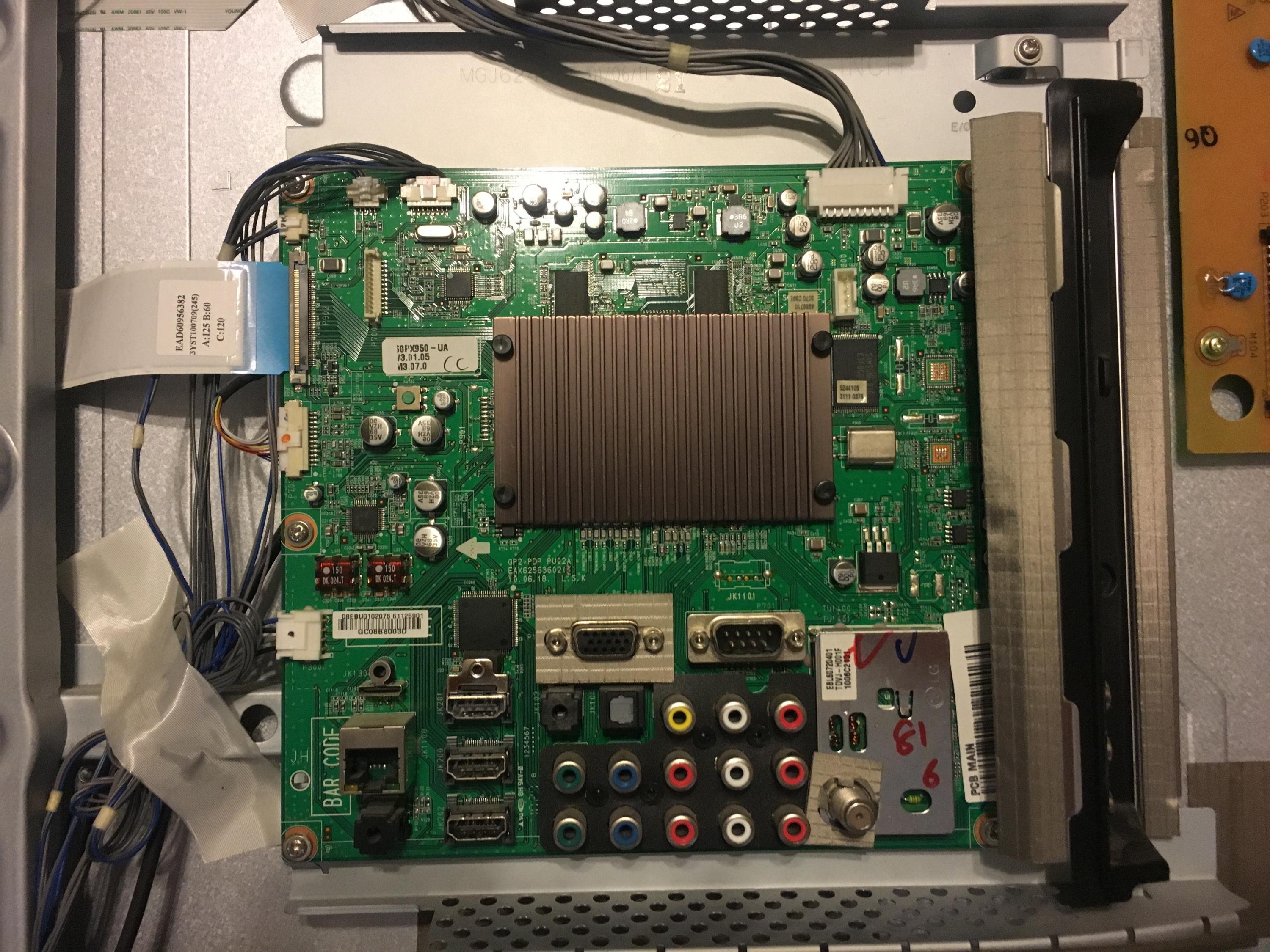

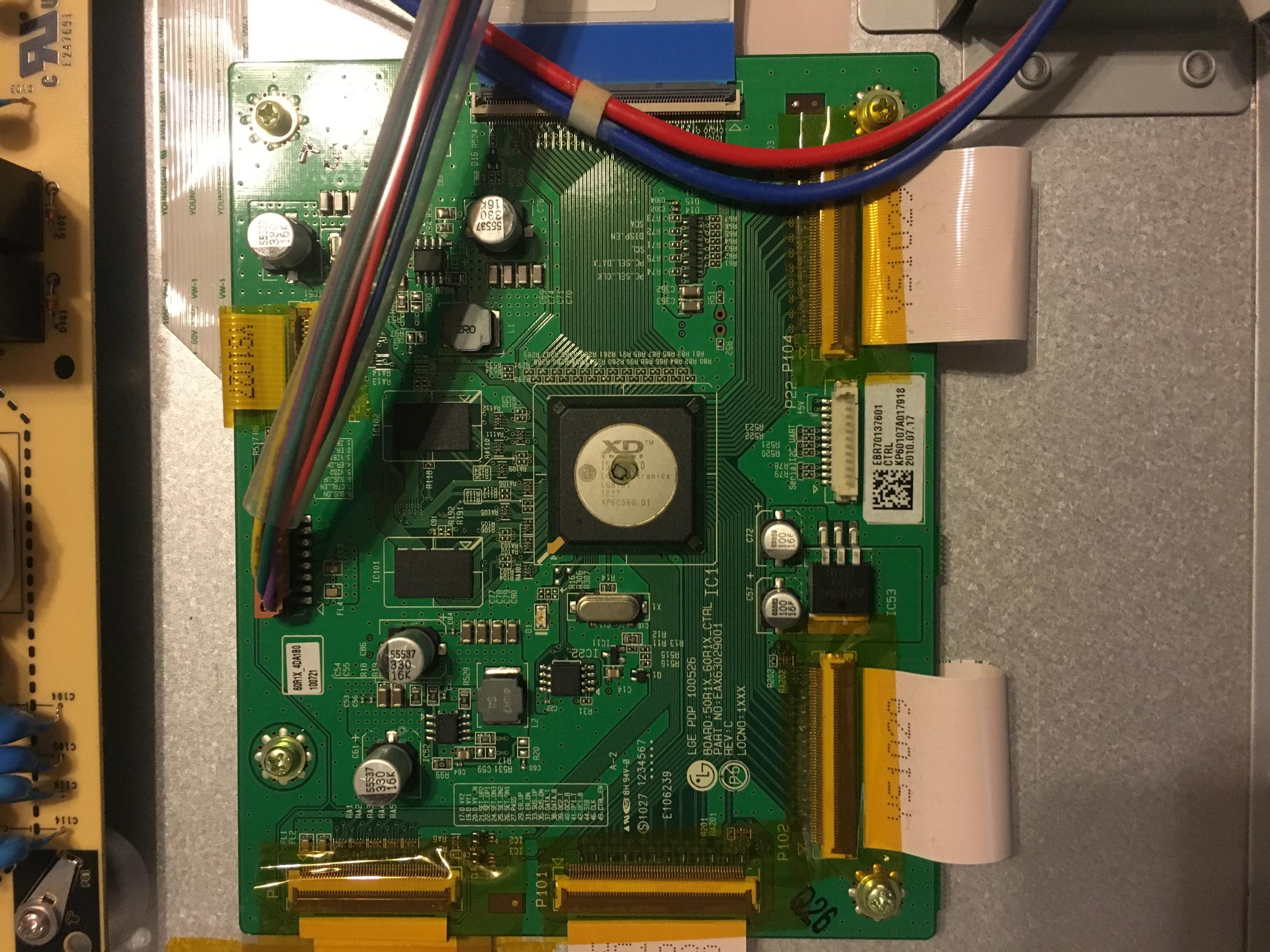

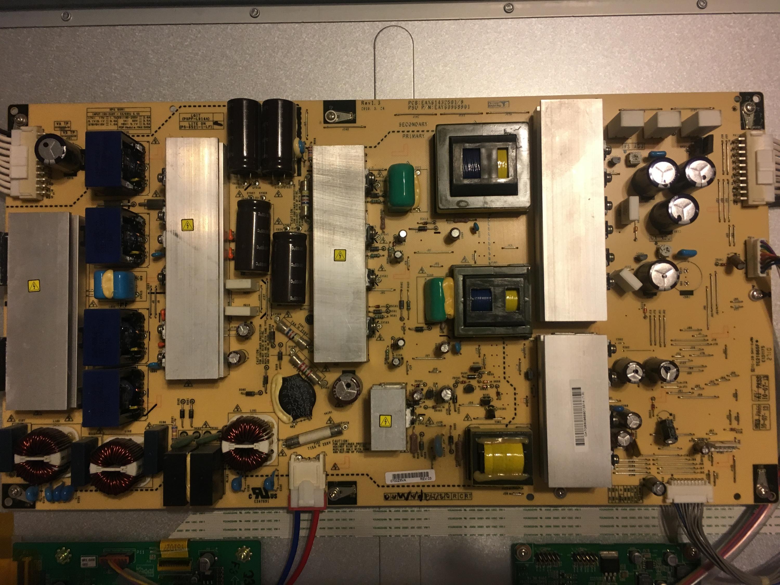

            Here are the pics I took of everything. Please let me know if you guys need to see more detail in anything.
              Re: 60PX950 No display
              Check your VA, VS voltage points on power board and compare them with panel sticker. Don't see sticker maybe under something.

                Center of control board, lower right. Two holes marked R52 & R51. Take a paperclip bent in a U and put an end in each hole, only after shutting down the tv!!!!!!! Remove the flat ribbon cable that goes to the mainboard. Turn on set. You should see test patterns on the screen. If you do, the mainboard on yours is bad.
                  Ok so I did that and the test patter came on (tv screen ran through a series of colors then did some gray testing). I could not see everything based on how I have the tv laying but I'm pretty sure that was it. So this may be a dumb question but by main board I assume that it is the board in the lower left corner names main board (lol). I have seen some repair services on eBay, but does any one else know the best place to get one of these boards?
                    Lower right in the picture of whole tv
                      Perfect, that's what I thought. I got the part number and did some searching. Looks like the part is hard to find, but there is a sub model. I see some people have had issues with the sud model so I will send this board of for repair and if that does not work I will get the sub model if I can't find the oem model.
                        I just wanted to follow up and let everyone know I did get the plasma working. I sent the board off for repair and I got it back in about 10 days. TV came right on with no issues. Total cost was $115 and everything is working great now! Thank you guys for the help!
