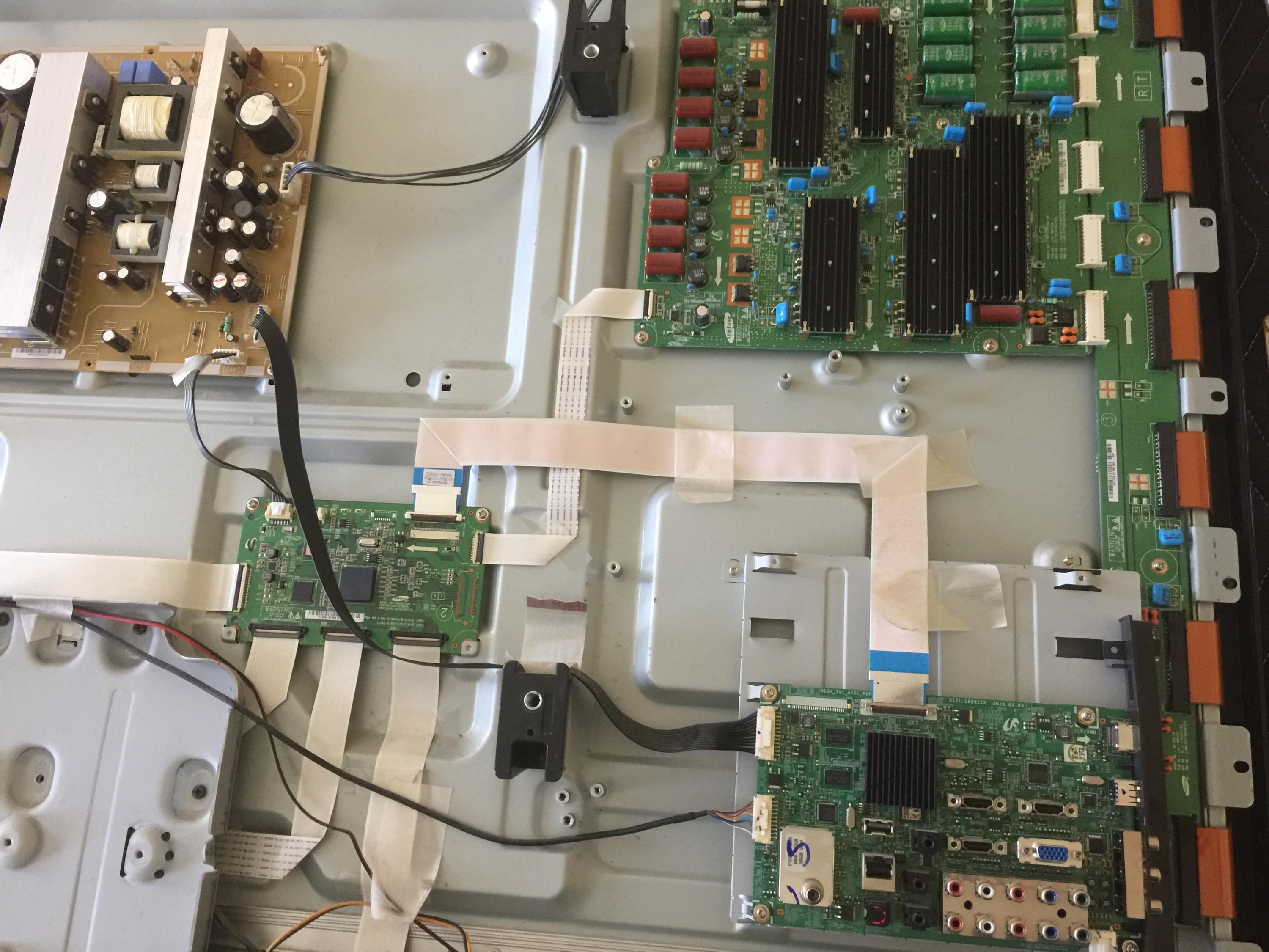

    Hey guys so someone was throwing away this tv that didnt work. Brought it home and turned it on. The plasma looks like it tries to come on it would show pixelation very fantly and a bunch of purple dots just fades away. You have to disconnect the tv wait for the caps to drain turn it back on and it does the same and fades away. So i chcked with my meter the power supply for VA VS and VS i think if i could remember is 205V and im only getting 10V. VA is suppose to be 50-60 i think and i get 6v. So i am guessing the power supply is bad? I did plug in a bluray player and i am getting sound.

            Ok so i ordered a new power supply for my tv. Samething, stand by light kicks on and blinking like its powering on. Does samething picture pixelates and fades away. I also get sound. But no picture.

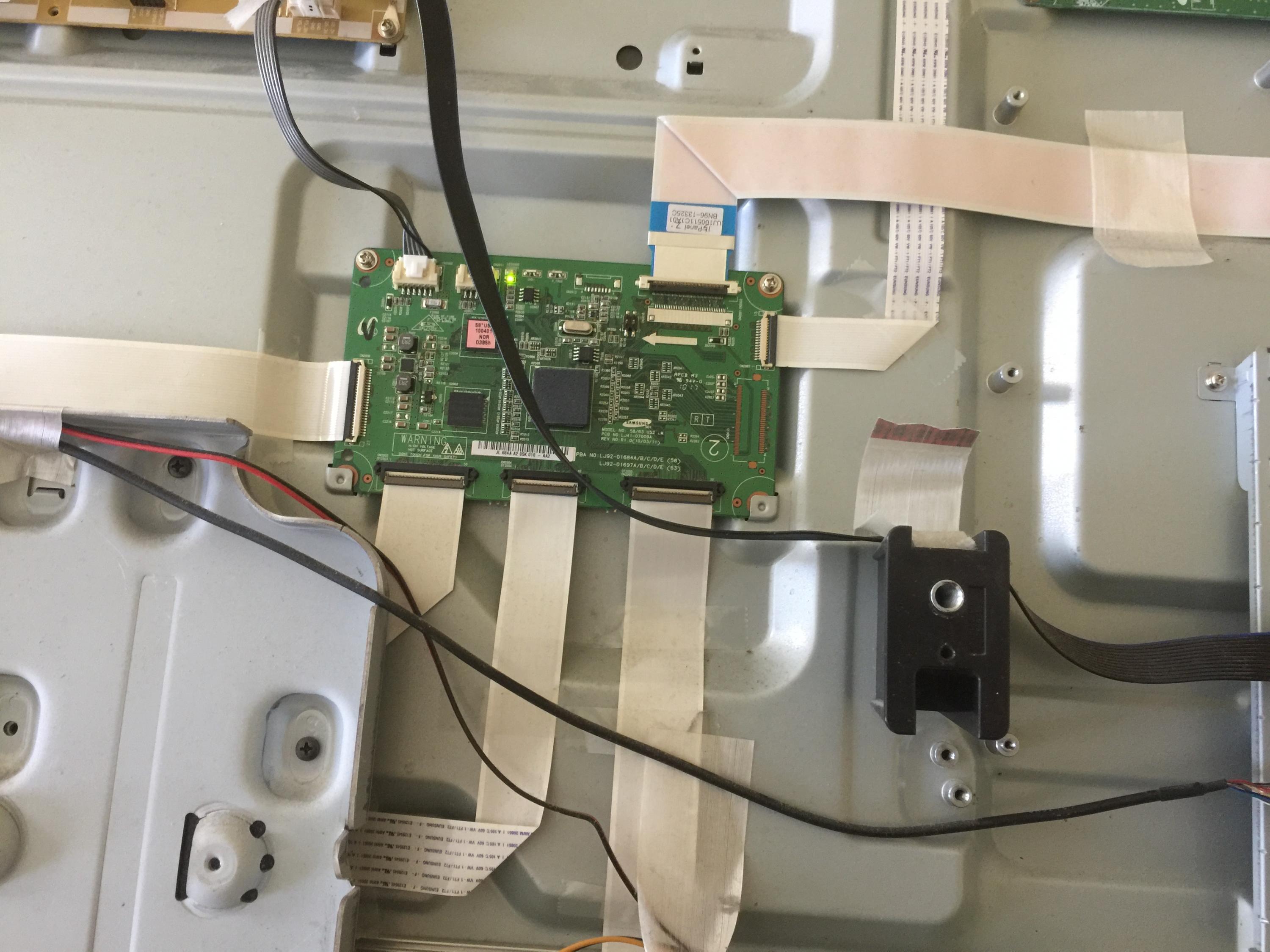

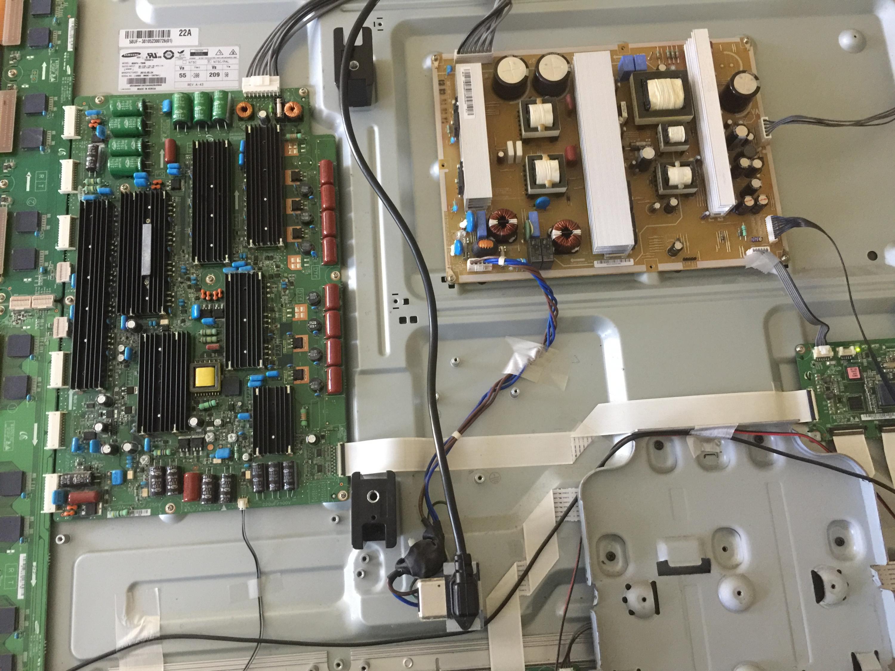

              Here are pictures of the boards i forgot to mention i also replaced the Y board and samething.
