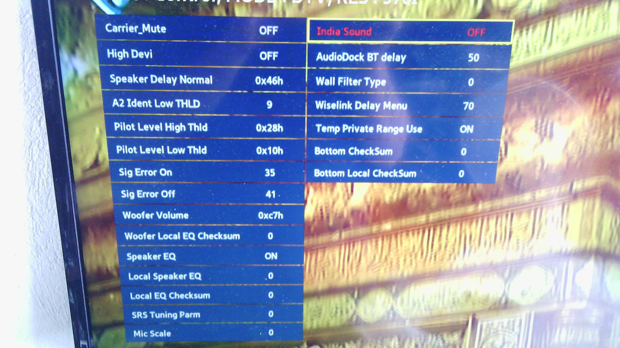

    led samsung UA32F5000AR no sound
    hi to all
    led samsung UA32F5000AR no sound.sound ic (ntp-7412s) changed and same problem.
    in headphone jack we have sound.both speaker tested and its ok.
    mainboard part number: BN41-01955
    please advise me

    Re: led samsung UA32F5000AR no sound
    I assume you have made sure speakers are not disabled in menu?
      every things is ok in menu.
      here is a picture from sound menu on line service
        after resolding sound ic problem solved.
