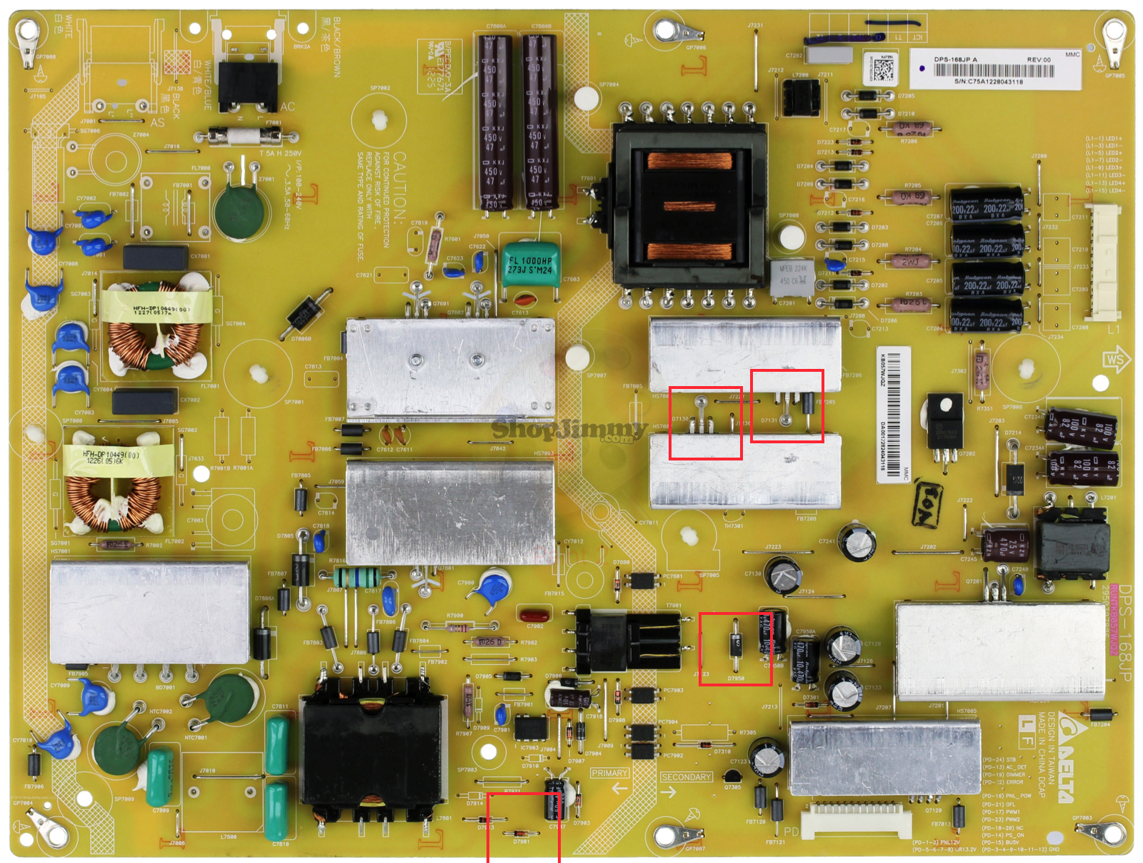

            Update: This website is a wealth of knowledge. Thank you all of the help you give. I have been reading and testing trying to figure this thing out. I found two diodes that tested funny in the board. D7950 and D7901. When I pulled them out of the board I think they tested fine. D7950 - Open one way and .325 the other. D7901 - Open one way and .771 the other way.
            I'm not quite sure how to test the three pin diodes. I tested D7130 and D7131 in the board. Both tested identical in diode mode on the DMM. From the center pin (2) to pin (1), tested .164 one way and .693 the other way. It tests identical from pin 2 to pin 3.

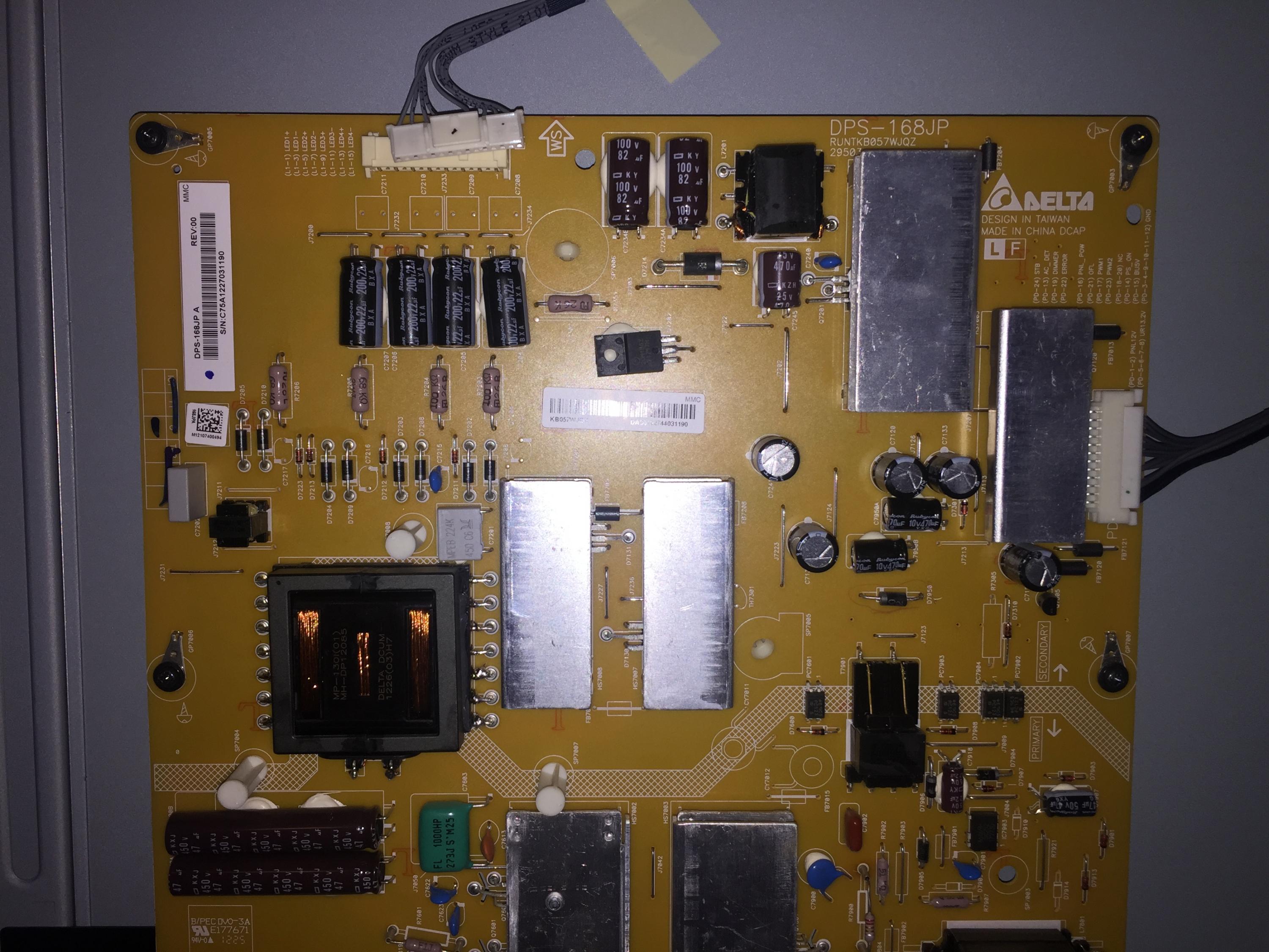

                Can we see the pictures of the whole back side of the TV so we can see how all the boards are connected together?
                  Re: Sharp LC-60LE600U won't stay on

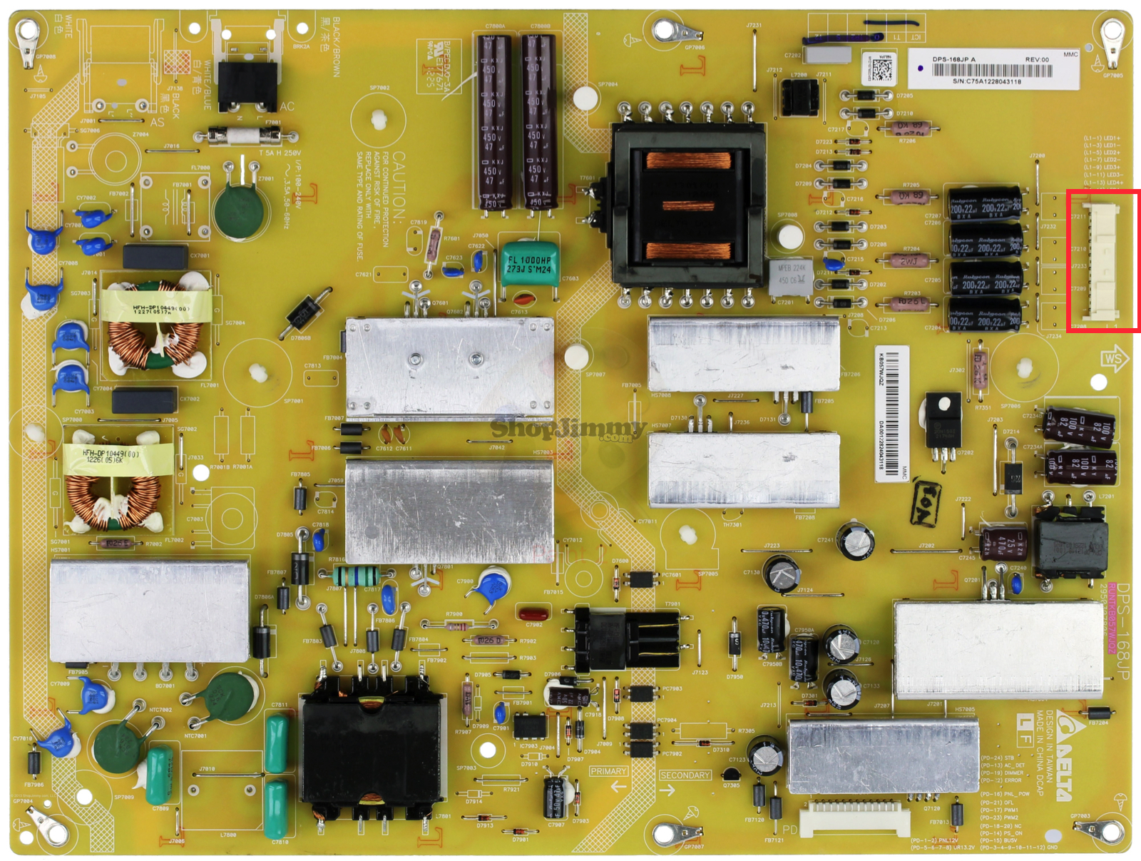

                  Thanks for helping budm! Attached is the back with the three boards connected. Also attached is a closer pic of the board where the led plug is located.
                    With the led backlight plug removed, and the TV running, I am measuring 147 Vdc out of each of the 4 led outputs. I am assuming one of the led's is shorted in a led strip. Is there a way to test the led strips while still in the TV?
                    If not, can someone head me in the right direction to disassembly to access the strips to test each led?
                      The 147V is the no load Voltage of the LED power supply that supplies top the Anode of the LED string.
                      Lets try this first: we need to see if there is bad LED wiring that is has low resistance to GND or not first.
                      1) TV not plugged in, put the LED connector back in place, thenput meter in Ohm mode. 2) Put black probe on the chassis, then use the read probe to check the resistance of each pin of the LED connector to see if any of them show low resistance, make sure to report if the resistance is in Ohm, K Ohm , or M Ohm.
                      You can also buy LED tester to check each string of the LED, it looks like you have 4 strings of LEDs..
