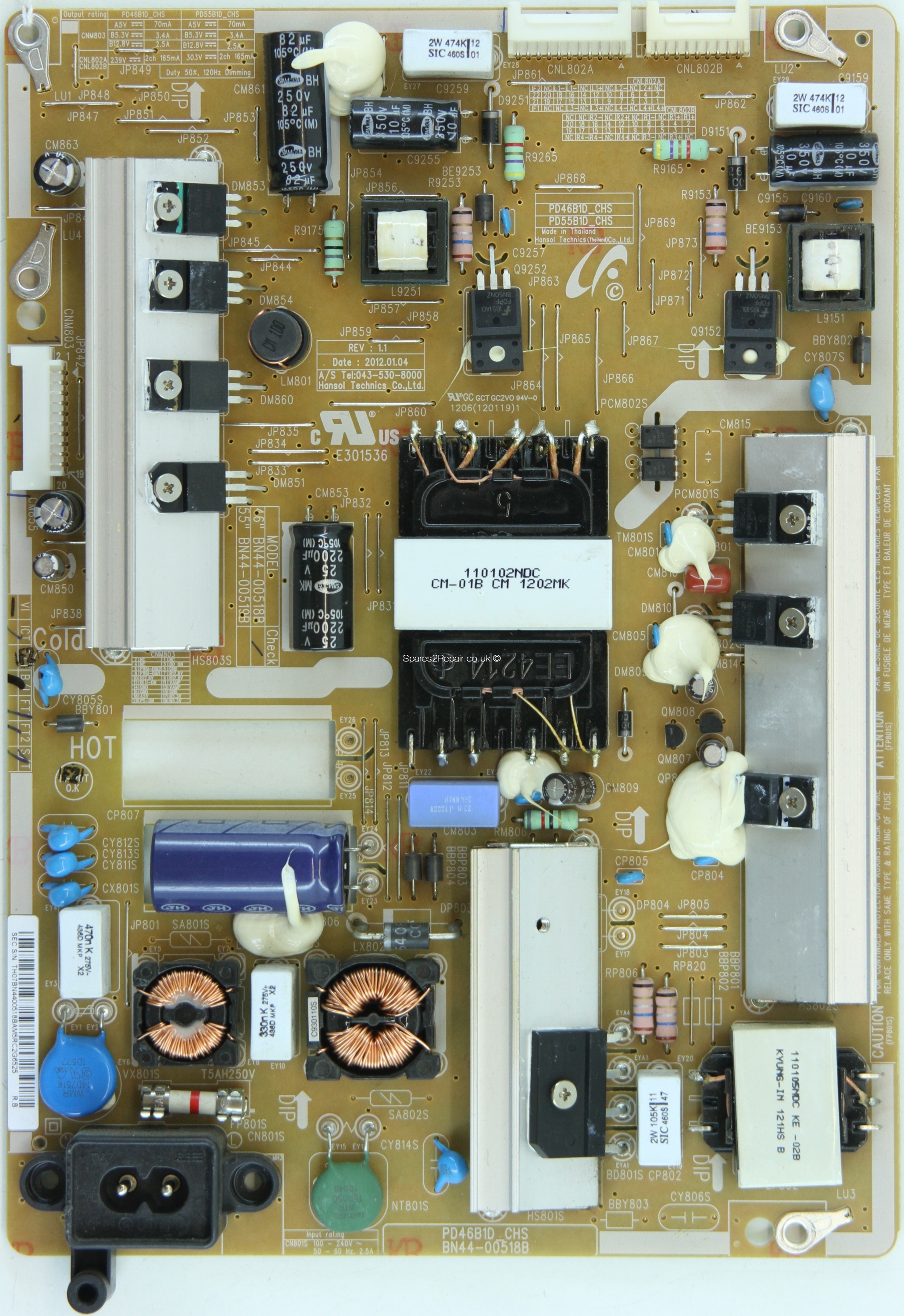

Samsung 46ES6200 random dead problem
  • dhavalrpatil
    • Feb 2017
    • 11
    • india
    samsung 46ES6200 having random dead problems...checked power supply 12v becomes 5v -6v on load (sometimes), PSU number-BN44-00518B..any solution?
  • dick_barton
    • Aug 2015
    • 6643
    • Wales
    Re: Samsung 46ES6200 random dead problem
    Are the 5V Standby and 24V lines stable?
    What voltages do you have on the 20 pins of CN802
    • dhavalrpatil
      • Feb 2017
      • 11
      • india
      yes 5v stby is steady...ther is no 24volt line in this supply...on CNM803 in standy 12 is coming...but when load is connected 12 volt becomes 5v..., i think
      there is no current in 12volt line...
      • dskall
        • Oct 2016
        • 2905
        • usa
        What is voltage across your main cap when powered on?
        • dhavalrpatil
          • Feb 2017
          • 11
          • india
          on main cap 340v steady
          • dskall
            • Oct 2016
            • 2905
            • usa
            Are you 220vac? Is that in standby or powered on?
