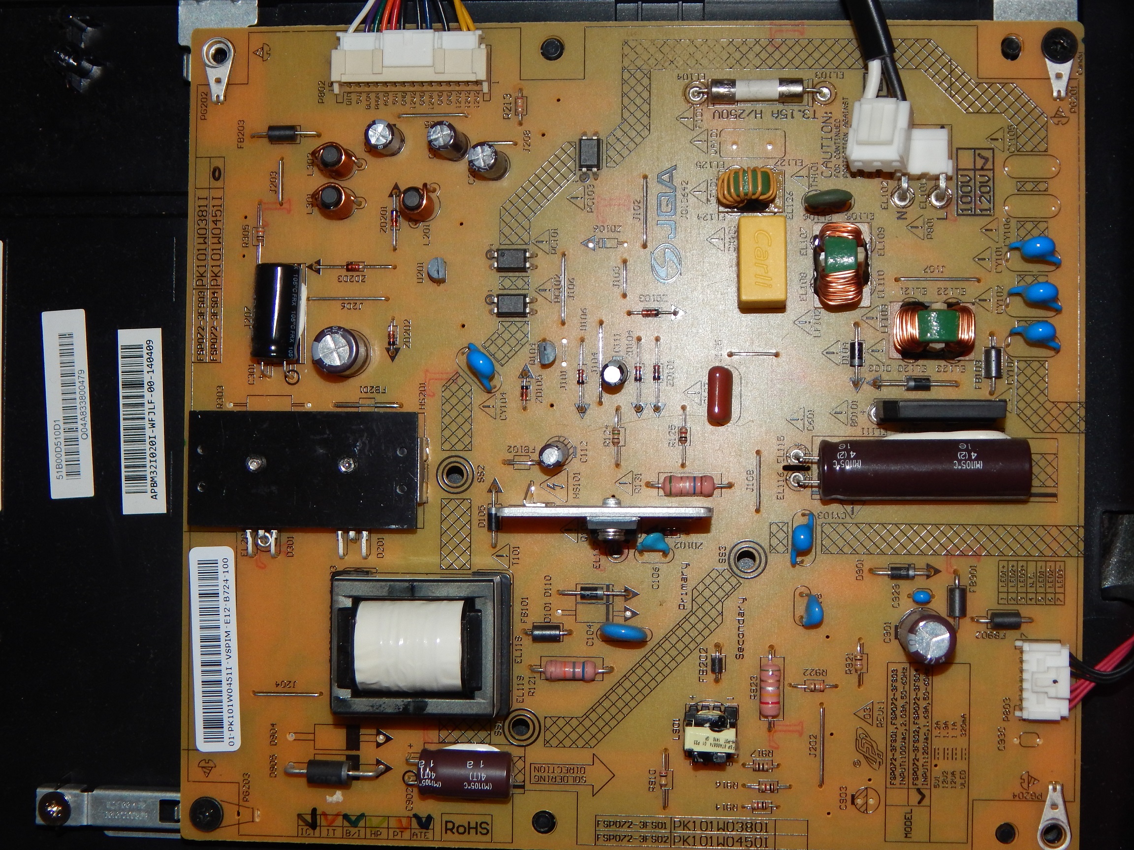

    I have first checked the Power Supply Board, the fuse is OK, and I think I get correct voltages in the output.
    With the main board not connected, I get 0V in the output.
    With the main board connected, I get the following voltages in the output:
    DIM 3.2V
    5V1 5.2V
    BLON 0.00V
    PWON 3.3V
    ACD 3.2V
    5V1 5.2V
    GND 0.00V
    12V2 12.4V
    GND 0V
    12VA 12.4V
    GND 0V
    GND 0V
    12V2 12.4V
    12V2 12.4V
    12V2 12.4V
    With the mainboard hooked, I connected a resistor across the 5V1 and BLON pins and the backlight turns ON OK.
    Pressing the power button does not produce any change in the PWON or any other voltage of the PSU.
    I get 170V across the large capacitor.
    I don't know if I should test further on the PSU, I think it is working properly.

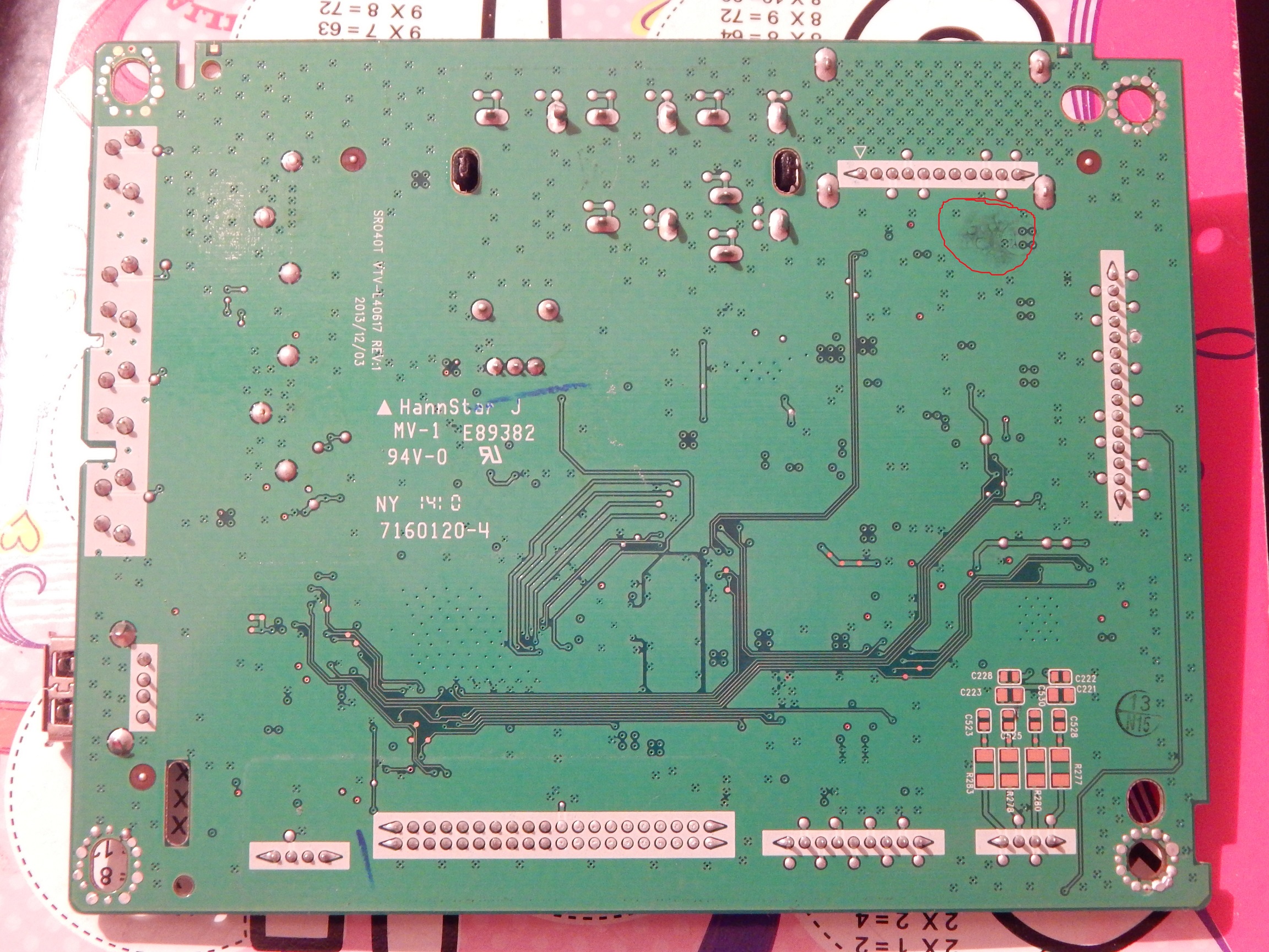

    Regarding the mainboard, I see a little area near the tuner that in the back of the board, is darker, also I see some signs of humidity and oxide.

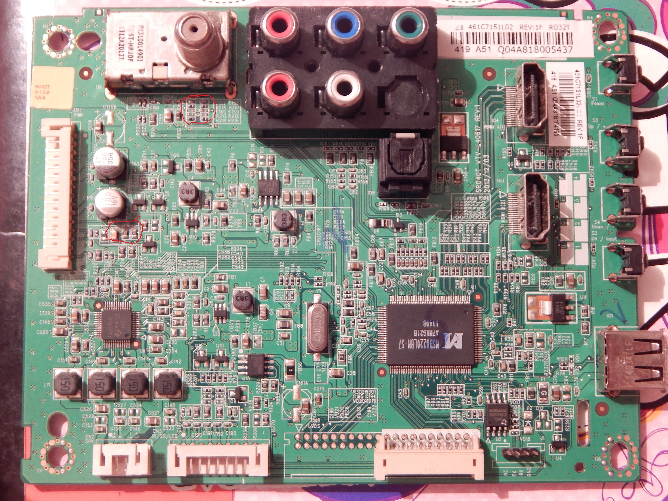

    Its the main board not sending out the BL-ON command to turn on backlights circuit so you need to check the main board at this point. I see two Voltage regulators, U11 is one of the two. Any sign of corrosion should be cleaned off, and inspect the suspected bad parts really well with magnifying glass.

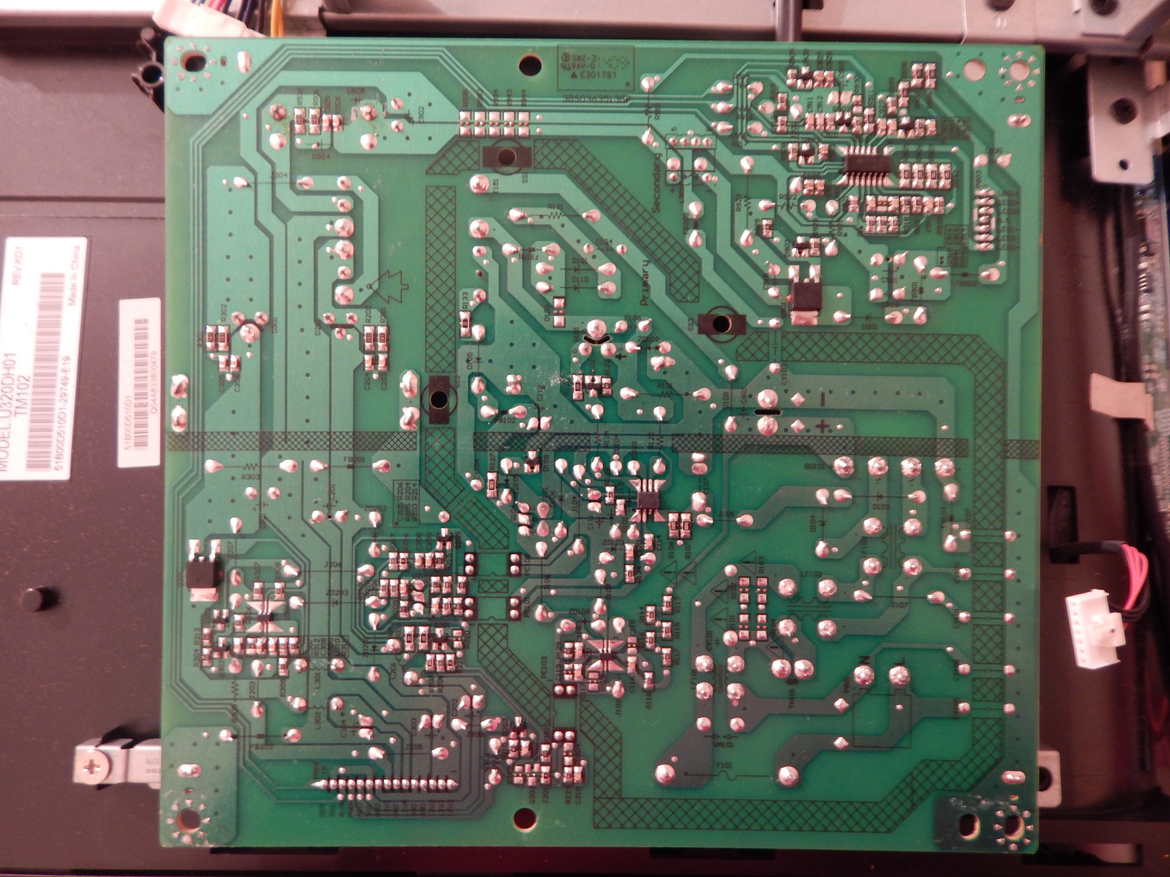

      Your bottom red circle on your third picture looks like it maybe in the bl-on circuit. Third pin up. I would check that area over real good.

        I checked the two regulators U11 and U14.
        U11 is an adjustable regulator G1117.
        R1=249ohm , R2=110ohm so Vout=1.802V
        I measured:
        PIN1=0.55V
        PIN2=1.79V
        PIN3=4.99V
        error% (to 1.8V)= 0.55%
        Vout-Vadj=1.24V
        U14 is a fixed regulator: 1117-3
        It does not have resistors, I measured:
        PIN1=0V
        PIN2=3.26V
        PIN3=4.99V
        error% (to 3.3) = 1.21%
        Regulators to me are OK.

        I cleaned the board with alcohol and a toothbrush, that seems to have removed the corrosion in that area. I still don't see anything wrong around there but I'll re check.
        I have to add: I made it turn on, by connecting a resistor across the 5V1 and PWON. I got image it worked fine. Then I turned it off (by pressing Power button) and the LED indicator remained on, just for a seconds, then it died again, I tried to force it to turn on again but this time it did not work, only get backlight on when I connect the 5V1 to that pin (BLON), I still get the same voltage at the output of PSU.
