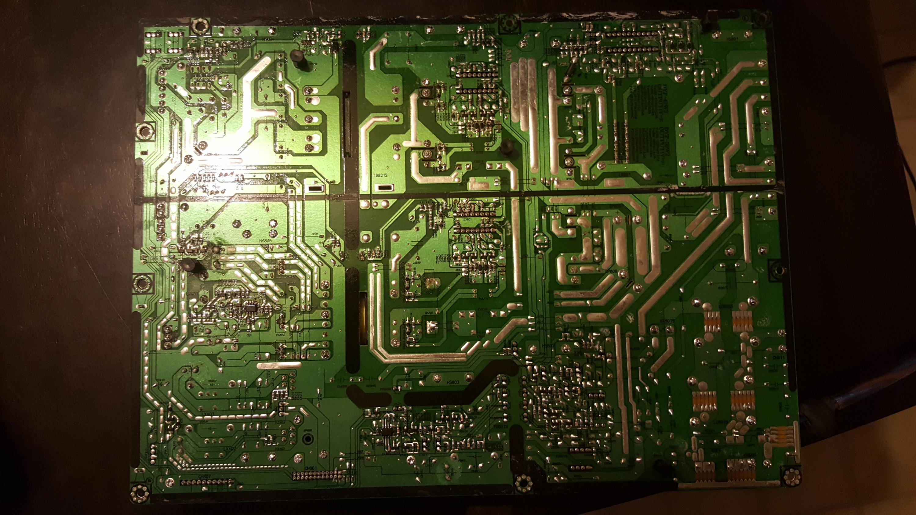

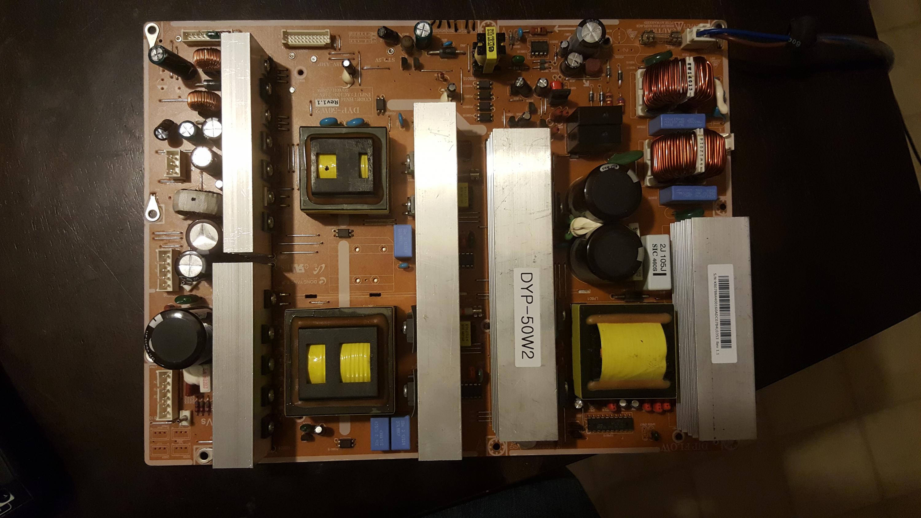

    Have samsung hpt5064 was a few bulging caps they were replaced by someone but set would turn on but no video can't determine sound . All voltages are present except VS . 5v 18v VA etc is there. I removed psu jumper ed psu on and vs on still no vs so it's somewhere problem on vs supply . Large caps all have 387v across. Which fets are for vs line to start testing for shorts.

          On back side I did some voltage tests I have 375v going to transformer but nothing on the secondary side

                  I watched that video don't have scope. But I tested those fets out of circuit they were short and 1 smd surface mount so I replaced the 2 fets and smd now blows fuse by ac in. I removed fuse by the 2 fets and now fuse doesn't blow by ac in line. But the 2 fets I replaced show short I have no idea can't find any other shorts

                    Pulled 2 fets I replaced and there blown again. Possible transformer shot? Without fets in I don't blow fuses . Don't have ring tester any other way test transformer?

                        Check ZD 801/2/3/4,DS 803/4 and RS 812/3/5/5 these will fail along with the two VS Fets and should always be replace on all BN44-00159/ 00160 power boards

                            You will find that the SMD diodes and or zeners are shorted, but check the resistors as well, you will find the schematic listed under BN44-00159 it is the 42" unit but runs the same components. common fault no VS there are repair kits out there(shopjimmy ),but will have more parts then you need. I hope this is of help to you

                              Zd all showed open one way and 0.713 other in diode mode. The DS 803 804 were .020 in diode mode RS 812 was .020 rs813 open rs814 .020 rs815 .020

                                just to help you on your way, ZD801/2/3/4 zeners marked 10 = 22v 5ma LM3Z22VT1G diodes DS803/4 marked 5A= 5a 70v switching LMDL6050T1G , RS812/814=10R and RS813/815 =10K. Flocko

                                  So rs813 is blown open would that cause fets to blow again? Rest seem ok unless the 2 ds803 804 might need take them out circuit retest

                                    Rs813 is 10k rs815 is shorted . Looks like rx814 and rx816 are short too but doesn't blow that fuse .

                                      Ok I am spaming my post. I removed the resistors all test fine out of circuit removed ds803 and ds804 test fine out of circuit open one way .703 other way in diode mode. Thought I was onto something back to square one

                                        Have you done a voltage test on the zeners ? it is no good just doing a test with meter set in diode mode, did you replace the insulators on the Fets when fitting them. Have you found the schematic for this board yet (BN44-00159)
