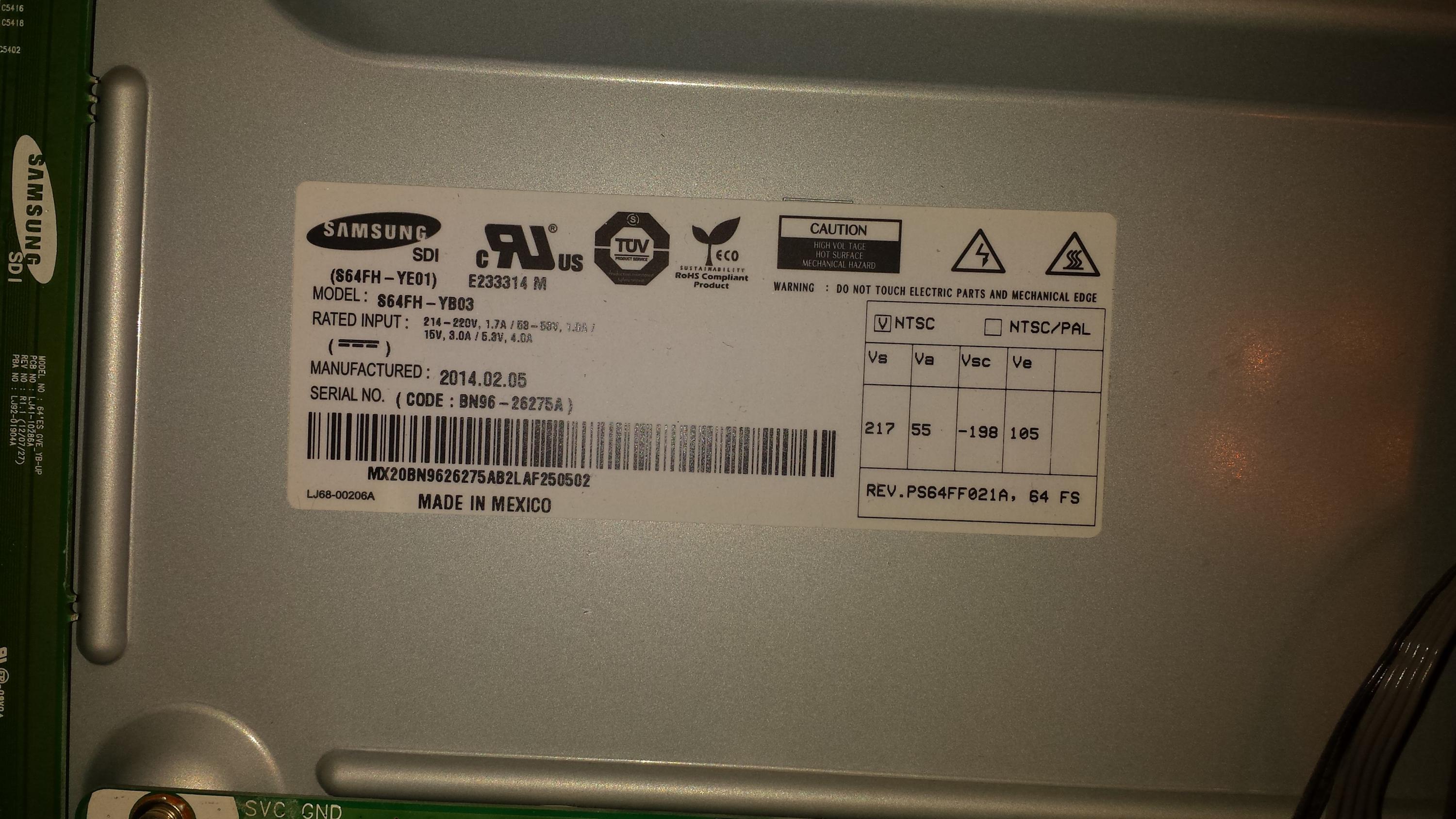

    Initially check your Va, Vs, Ve, Vsc voltages as given on the label attached to the back of the plasma panel. Popping sounds like maybe some mosfets have possibly blown.

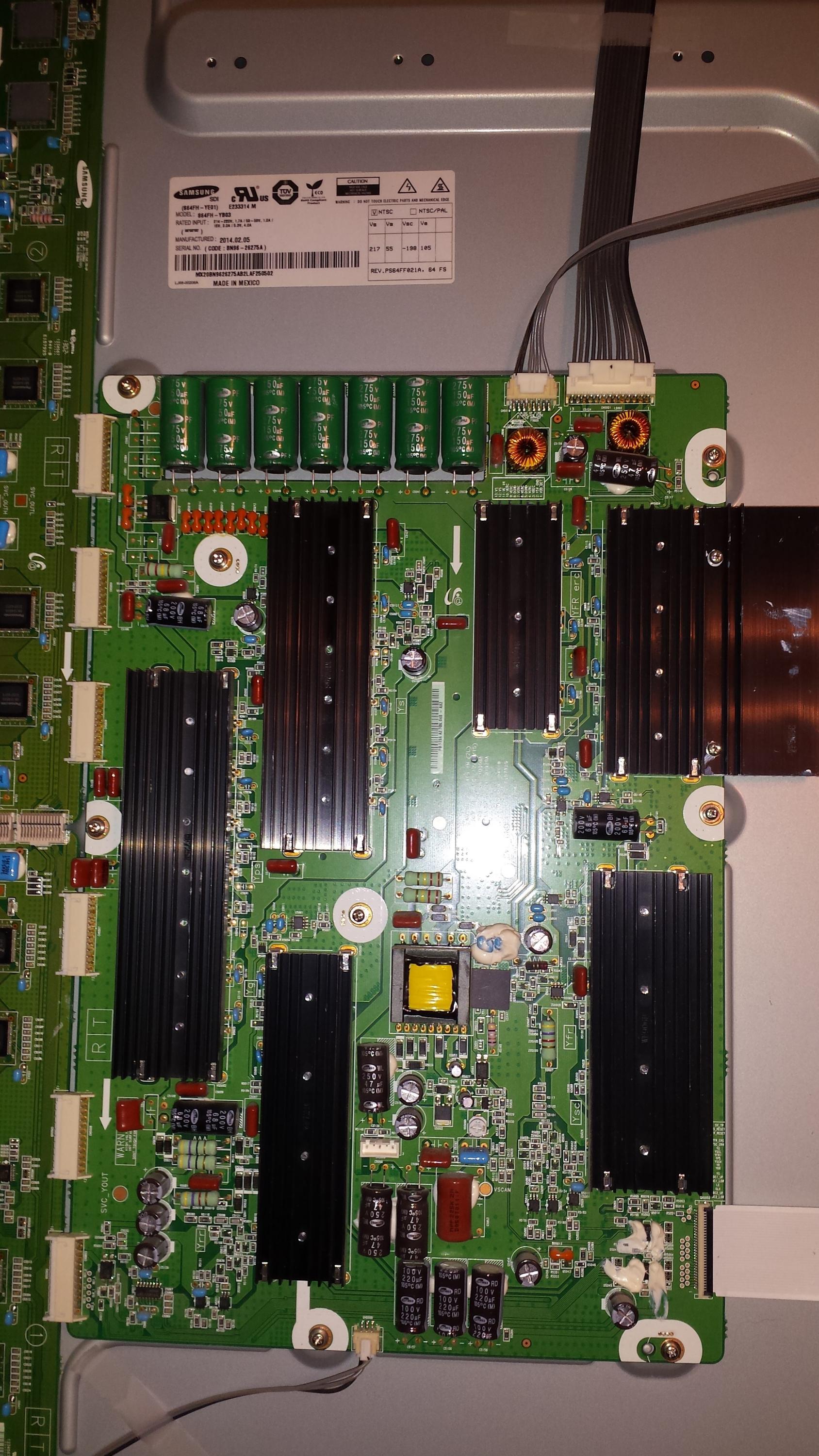

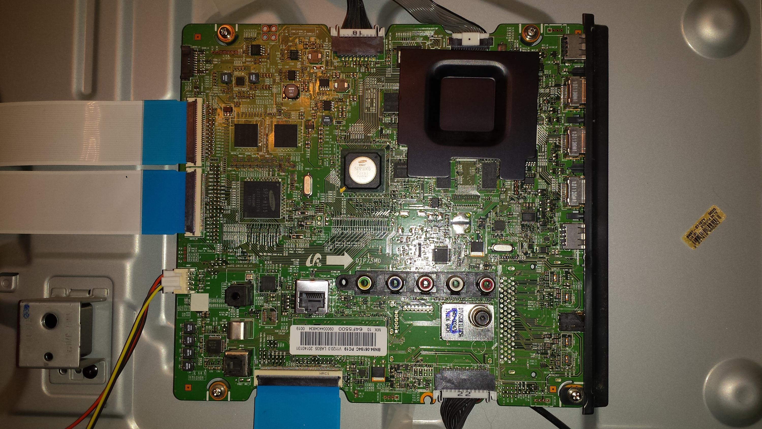

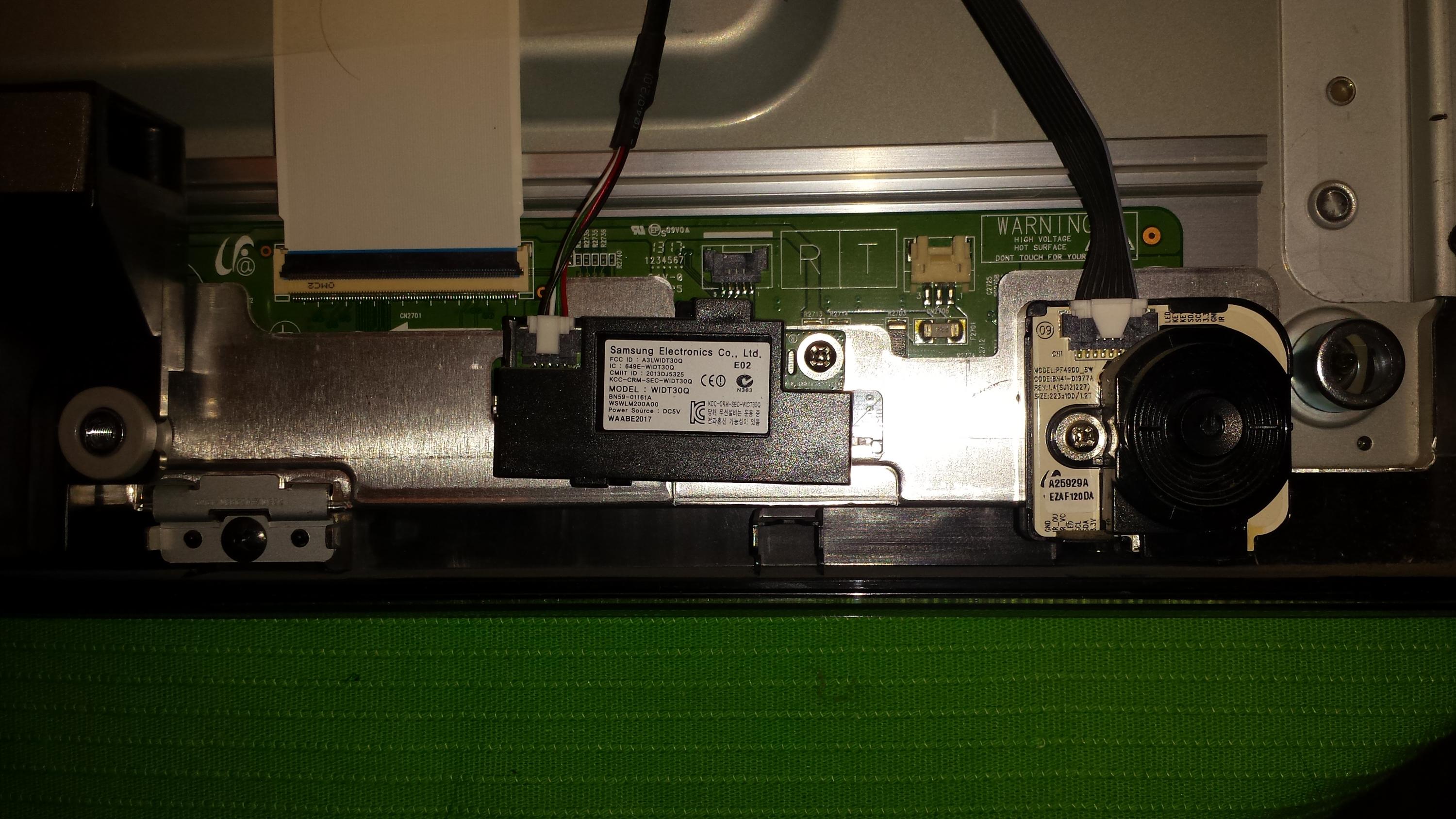

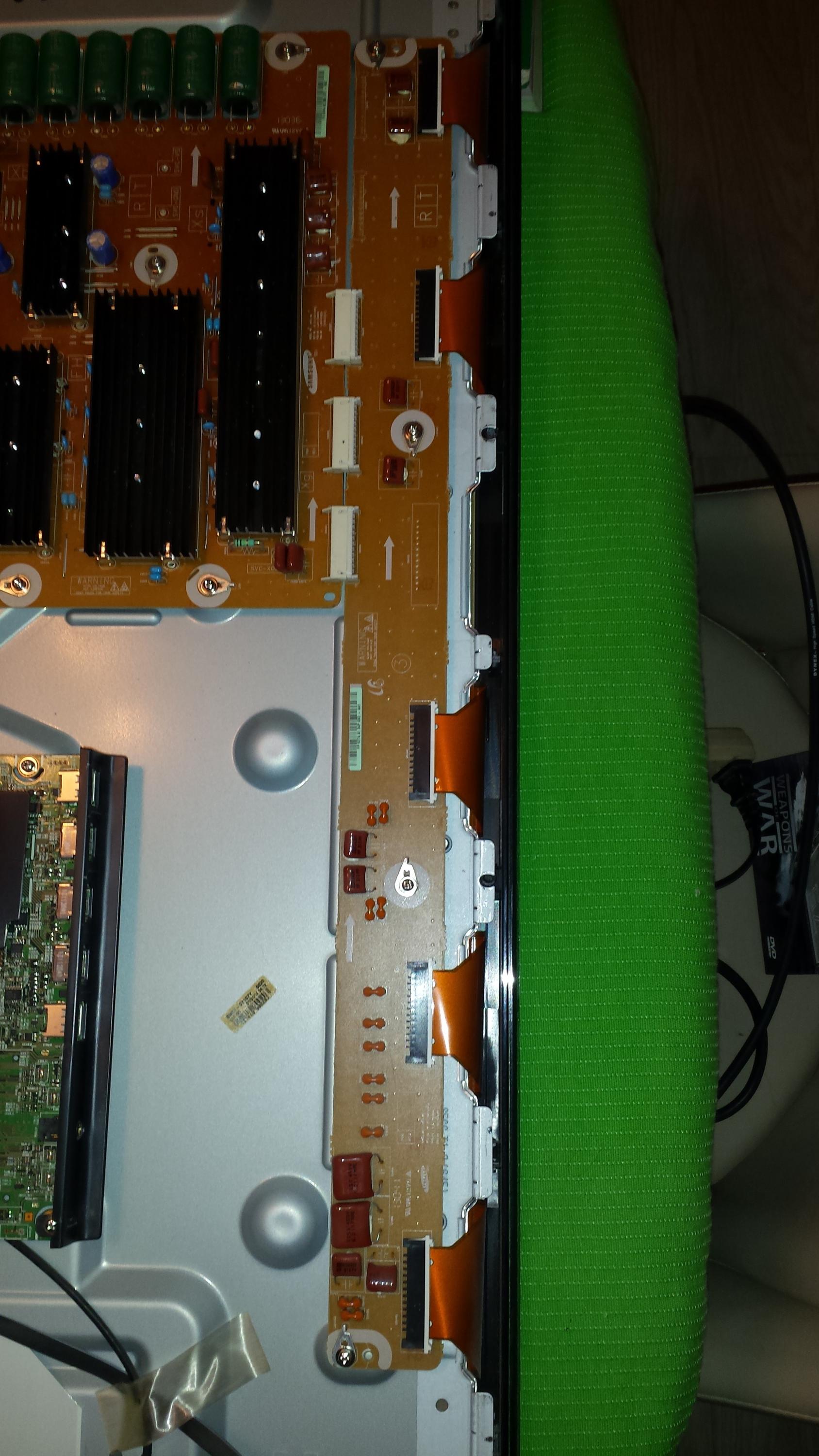

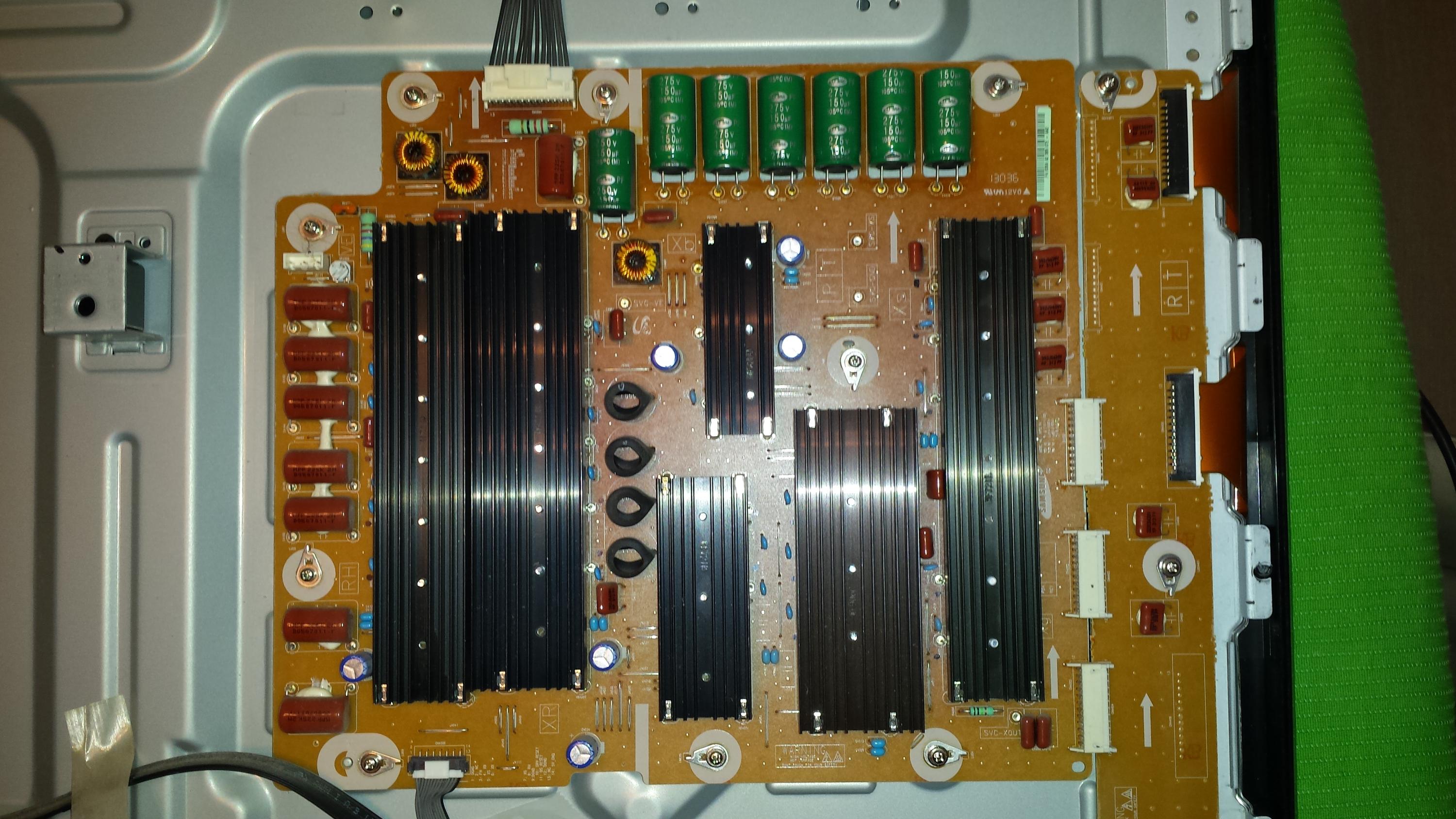

      Post some good pictures of boards and back of TV. With popping there should be visual clues to where to start. Burnt spots, holes in semiconductors etc. Checking voltage and discharging of high voltage is a must before poking around.

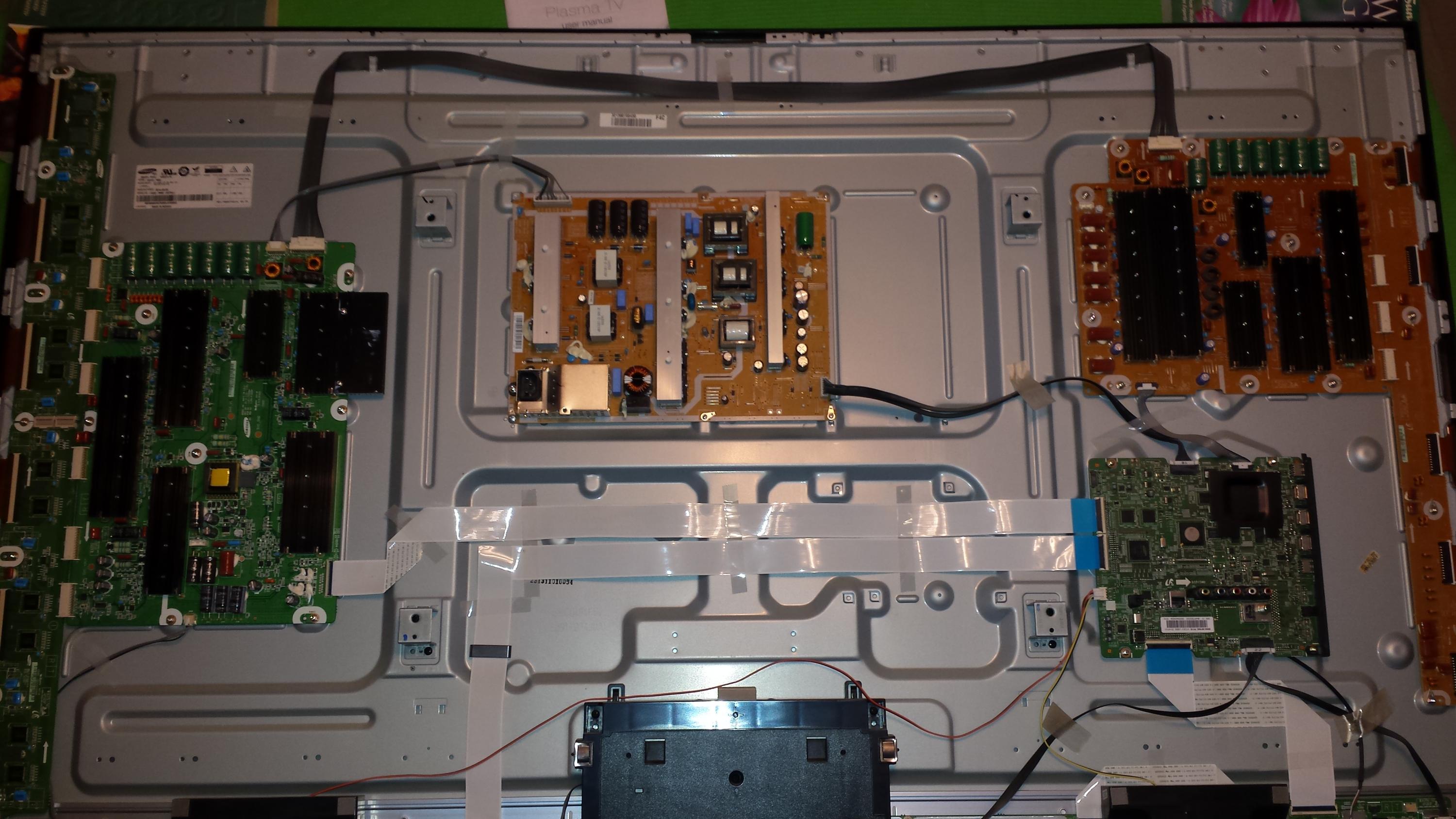

        OK, shot some pics for reference. Any ideas where to look for test points to get Va, Vs, Ve & Vse readings?

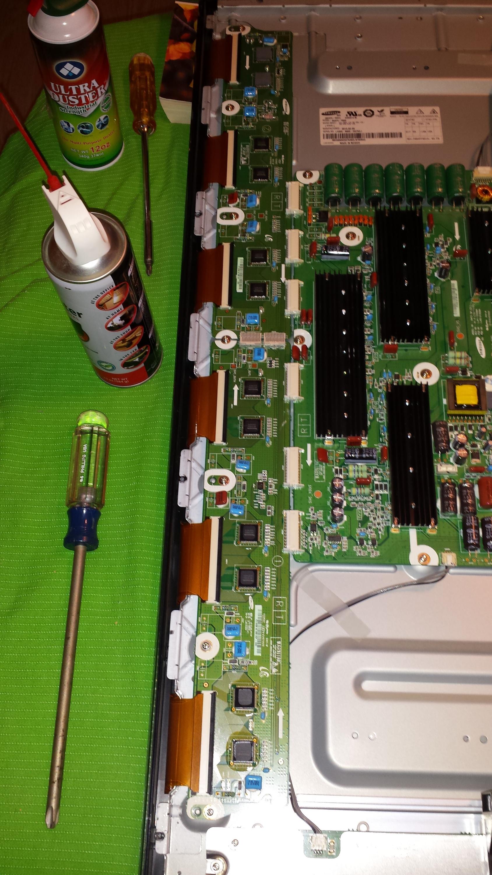

          Saw no obvious signs of burnt components and none of the typical odors thereof. I assume these voltages are all DC, right? And is there a way to discharge multiple capacitors at once, or must they be shorted individually? Any other components that retain a dangerous charge?

              "...control 12v sound about 18v and Vs about 200v and Va about 65V (correct values should be on a label on rear of panel) at turn on with RC."

              The label on the plasma panel indicates the following:
              Va = 55
              Vs = 217
              Ve = 105
              Vsc = -198

                    Ve- located on xmain board. Vsc- located on y-main board. looking from back of tv ymain on extreme left. x=main on right, power supply middle top.

                          Thanks for the clues, rccrasher65. Looked again and found the following test pads:
                          On the Y board:
                          VSCAN (could this be Vsc?)
                          SVC_YOUT (could this be Vsc?)
                          SVC_GRND (obviously ground)
                          SVC_VS
                          SVC_GRND (same as above)
                          On both of the two Y buffers:
                          SVC_OUTL
                          SVC_OUTH
                          On the X board:
                          SVC_GRND
                          SVC_VS
                          SVC_VE
                          The labeling was a little confusing, as it was different than on the power board.

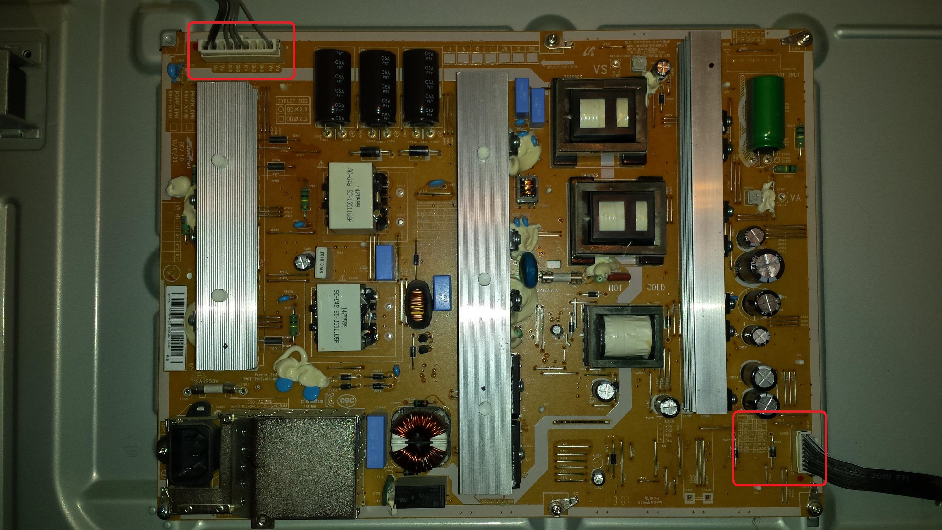

                                  Well done and looks as if the power board ok but as dickb says check them voltages at final output from the board or at in connector on Y or X if easier. If still coming on within the 3 secs then I would suggest you pull the y for examination - carefully as buffer connections can be tight.

                                    What about the voltages on the connector at the top left hand corner Va = xx, Vs =xxx

                                      That last pic I sent shows the readings I got on that power board connector going to the main board (during fault shutdown). Do I need to test those (and at the power board connector going to the Y & X boards) during that initial 3-second power-up before fault shutdown?
