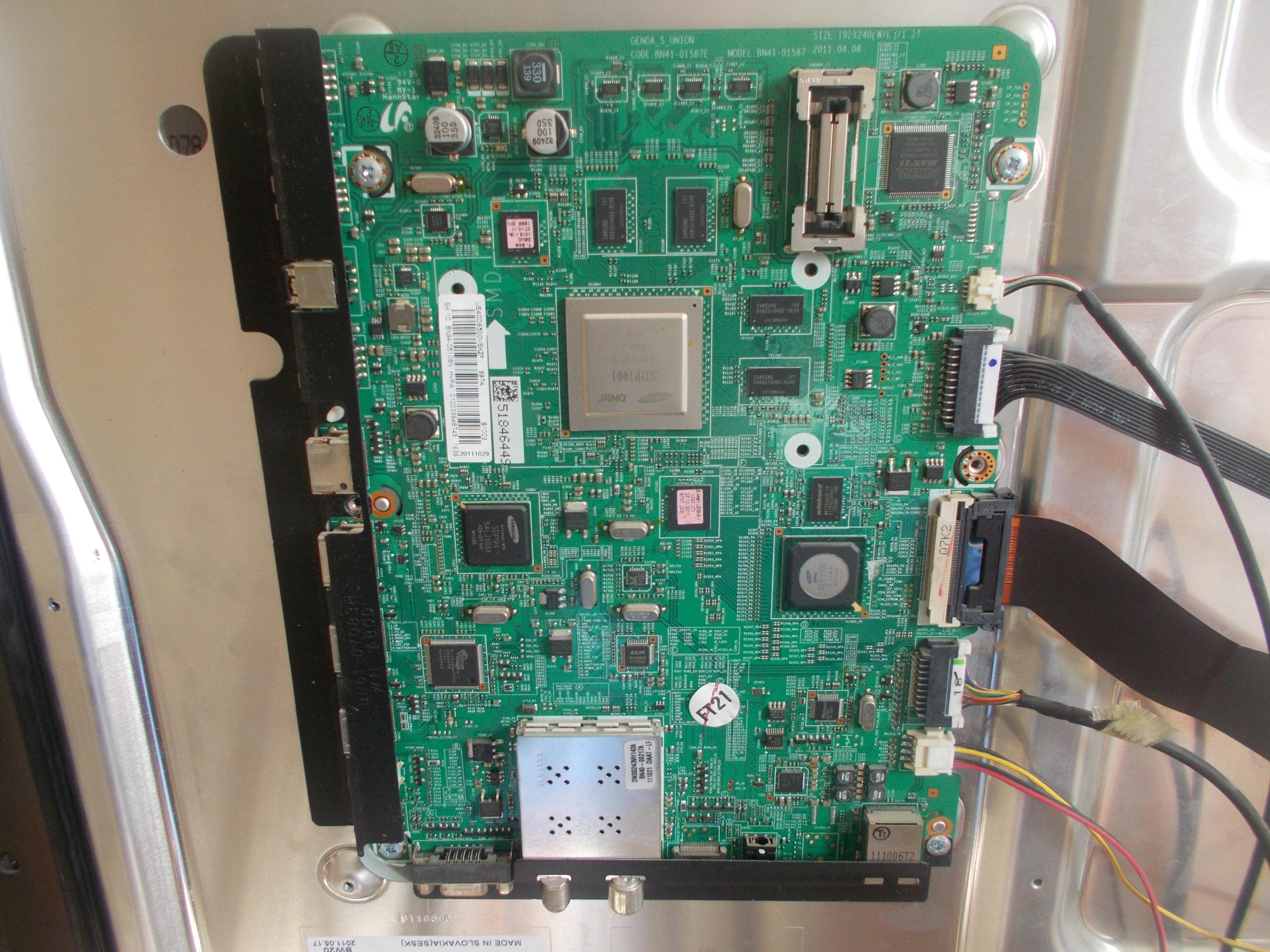

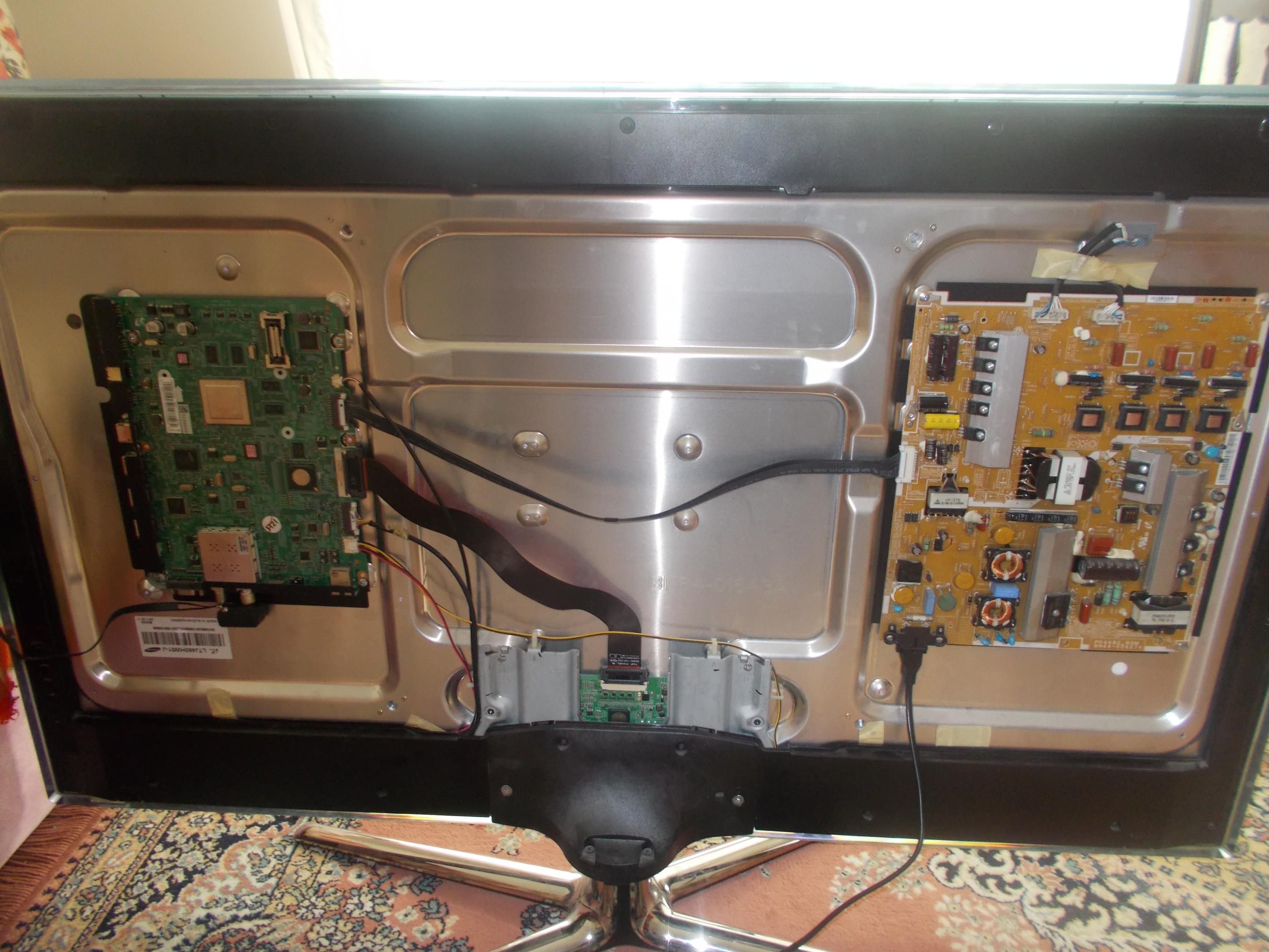

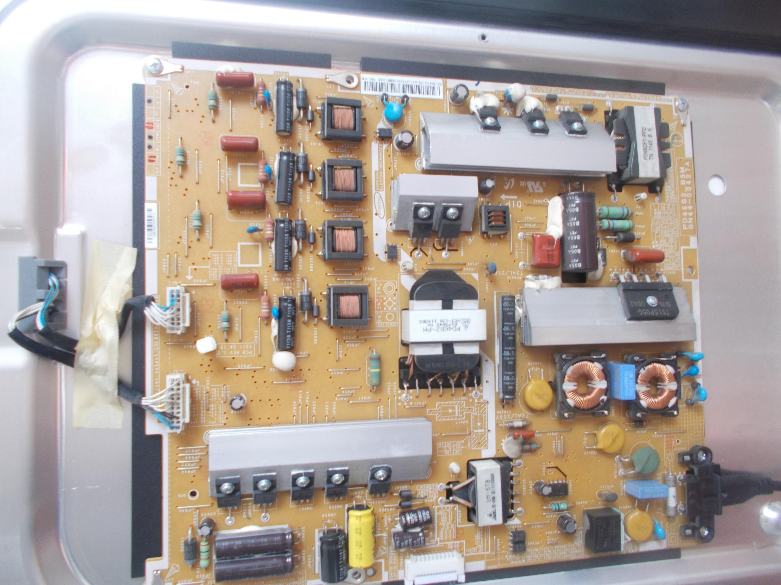

    hello.
    i have samsung ue46es6140 led tv.it is not working.when push power on button screen like this in only 1 sec.(for 1 sec backlight coming and some hor. lines at the top)
    what is the fault.
    i think power supply ok.?? after 1 sec. black screen and backlight is little bit dark.tcon board has 13v
    here is the voltage between power supply and main board.

    here are the pictures.

    Re: samsung ue46es6140
    If you disconnect the main board do the backlights come on.
    • mr2013e
      Elc. Engineer
      • Jul 2013
      • 41
      • TURKEY
      when the cable between main bord and power supply off ,tv on when plug the ac cable backlight works normal.(no button using at this time)
      i think the main board fault.???
      what is this? this is main board's label.my tv ue46es6140. tv is 46 '' but main board label ue40d6500vsxzf (pic2)
      is it not original main board??
      • mr2013e
        Elc. Engineer
        • Jul 2013
        • 41
        • TURKEY
        bad news for me.this tv samsung eu46d6500.exchanged back label.and my fault is panel.
