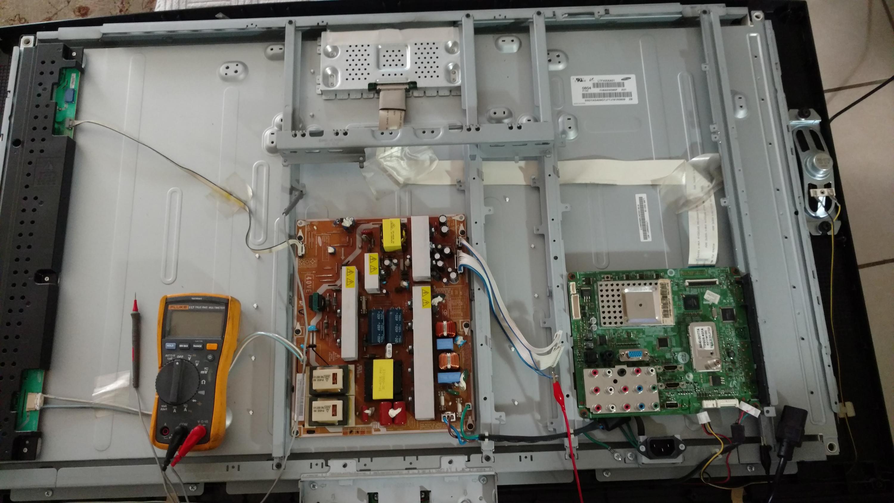

    Customer says that hitting power button like 40x TV will eventually turn on. Opened up and saw expected bad capacitors. Replaced all caps even some on the primary side, same problem.
    Forced PS and inverters on, backlights come up and stay up.

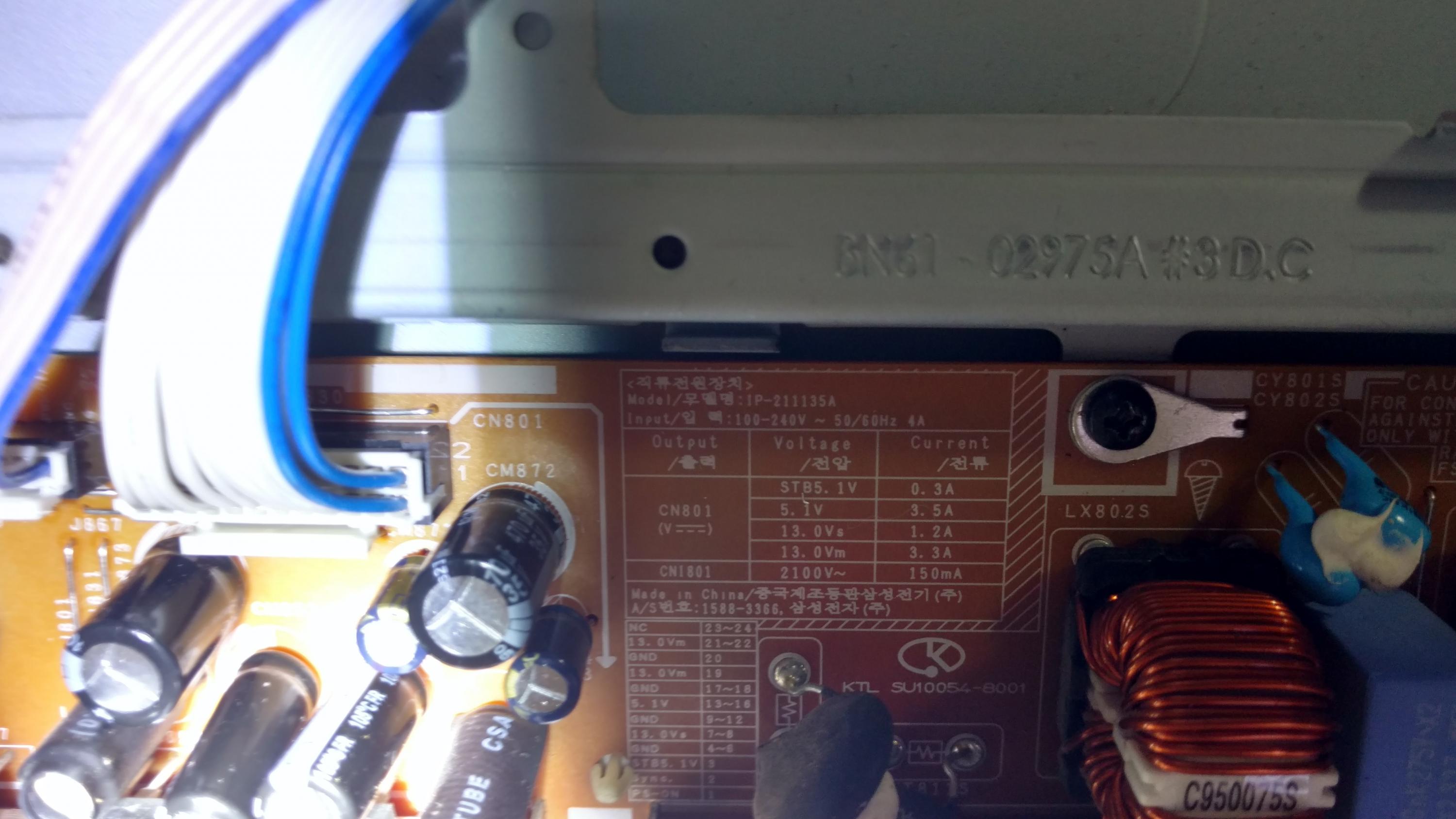

    Have all PS voltages, except the 5.1v 3.5a line is missing, that should be on pins 13-16 on CN801.
    Is this the problem or is this because main board is disconnected?

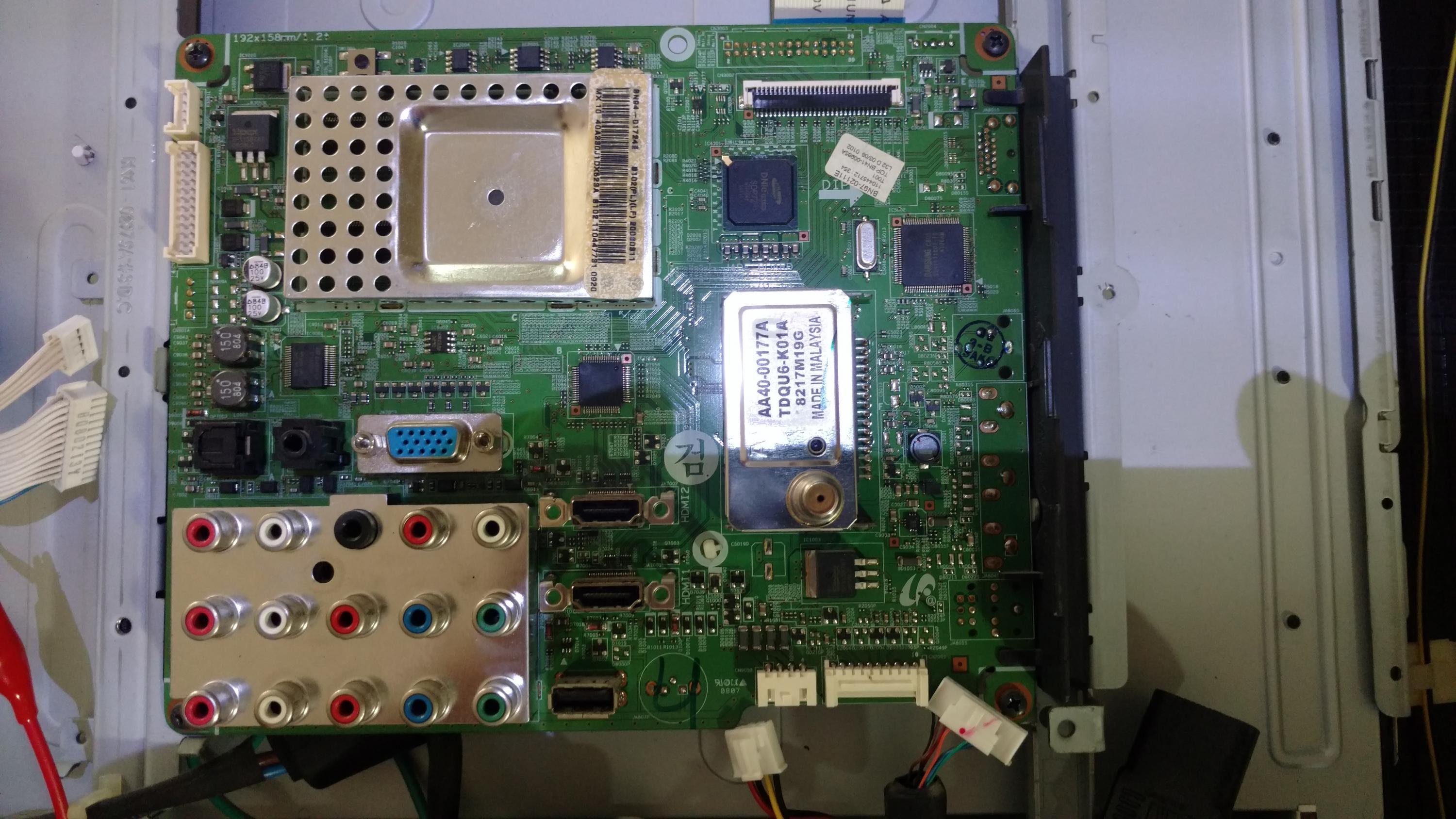

    When first monitoring voltages with main board connected, PS-ON comes up and goes out every few seconds, no backlights.

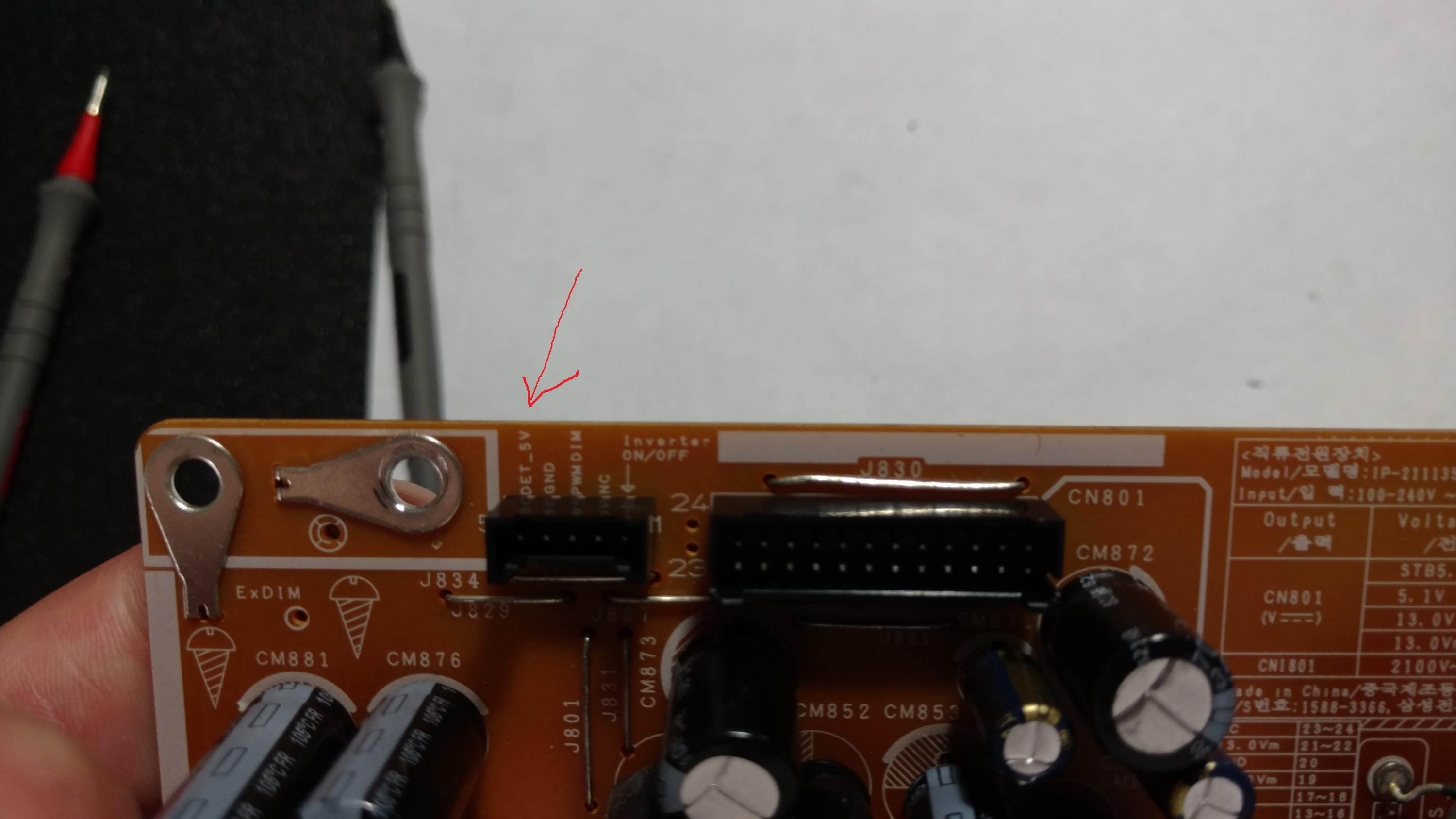

    Also just saw the DET_5V pin on connector CNI805, this pin ohms out directly to the missing 5.1V line.

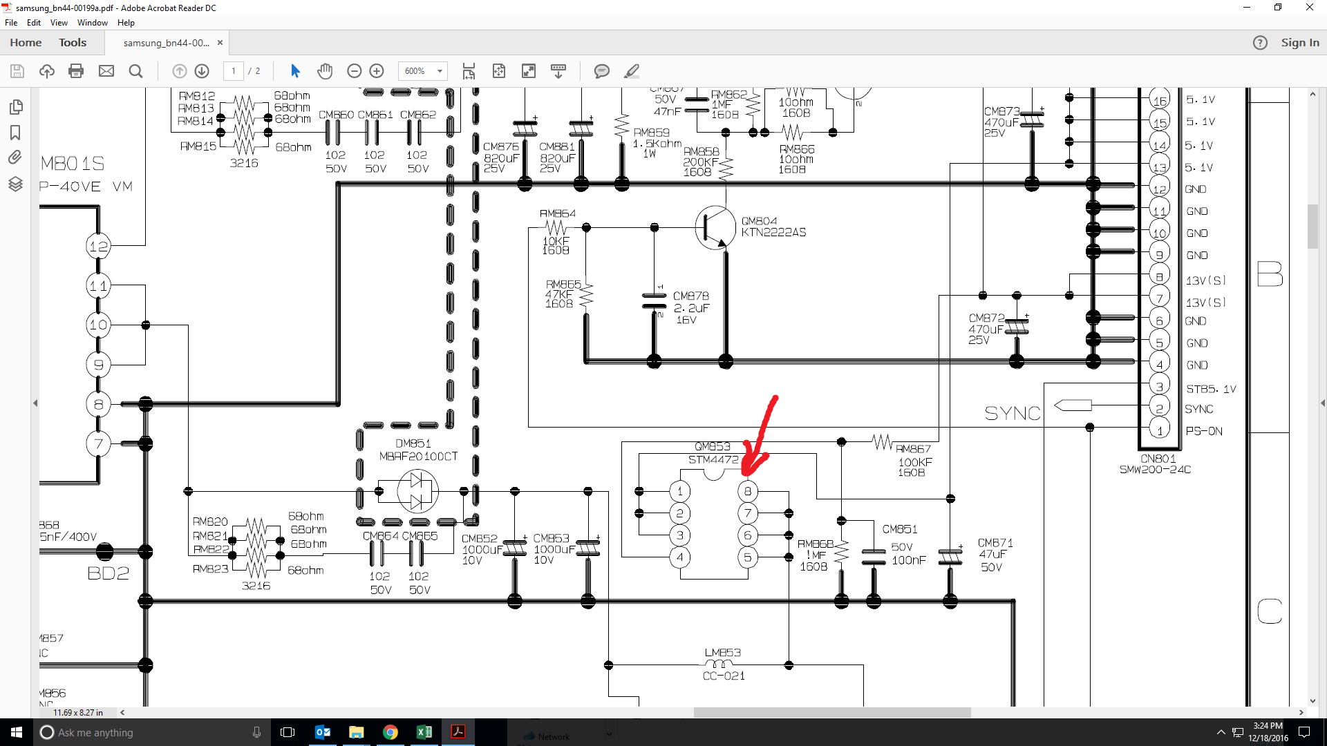

    What is the purpose of QM853 (STM4472) in last photo, one side of IC goes to STDBY 5.1V, other side the other 5.1V line.?

    Got a new PS board and that fixed it, would love to find out why it's missing that 5V intermittently, anyone? I forced the new PS on and that 5V does come on so that is the issue..

        Not that I can find on this one.. I interested in why I get the 5V standby and it looks like it goes thru the 8 pin transistor on the bottom of the board and to other 5V line. I need to give the TV back I was just hoping to find what was wrong first..

          Did you try and freeze that IC ?Weak Opto coupler?
