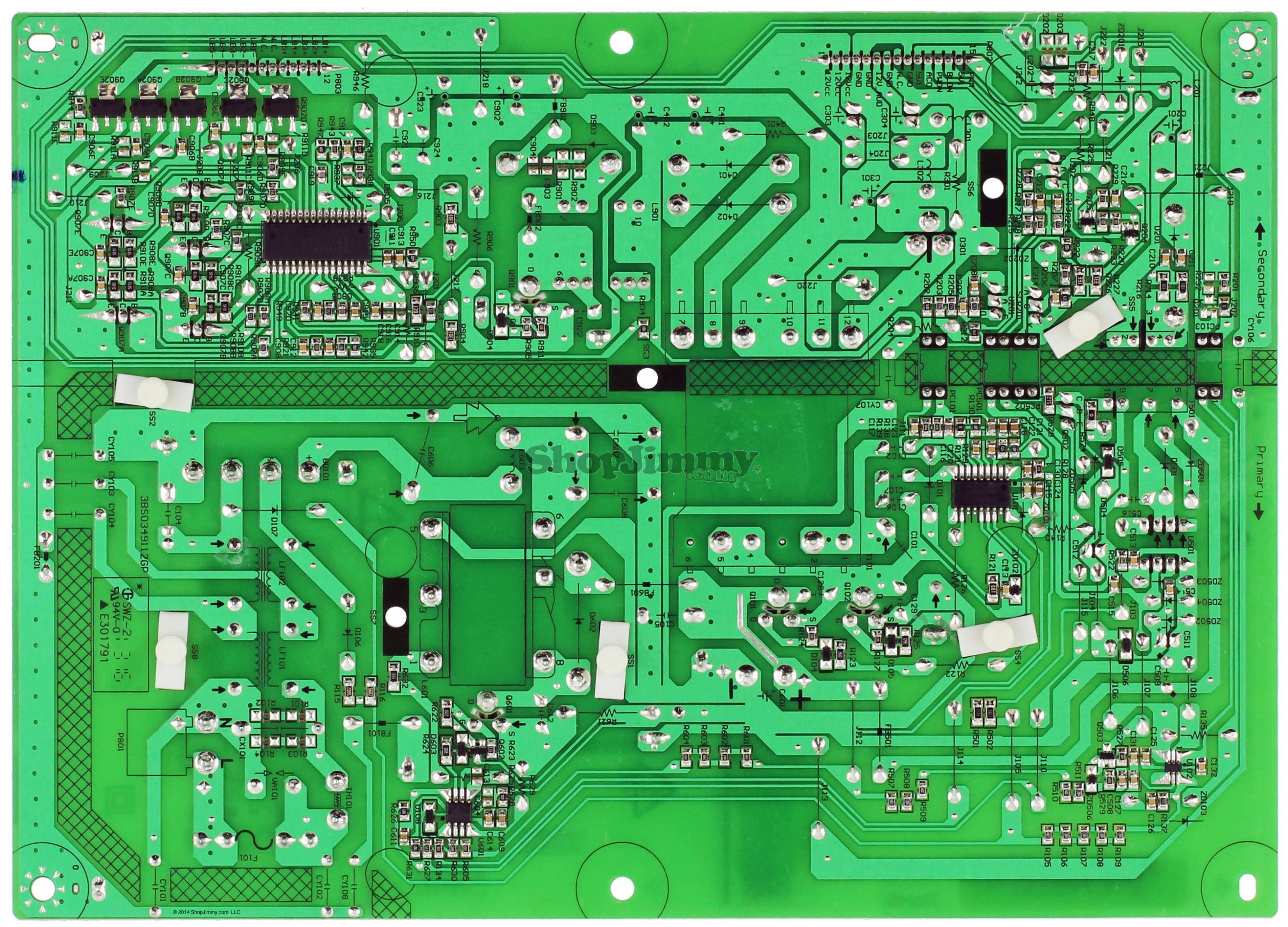

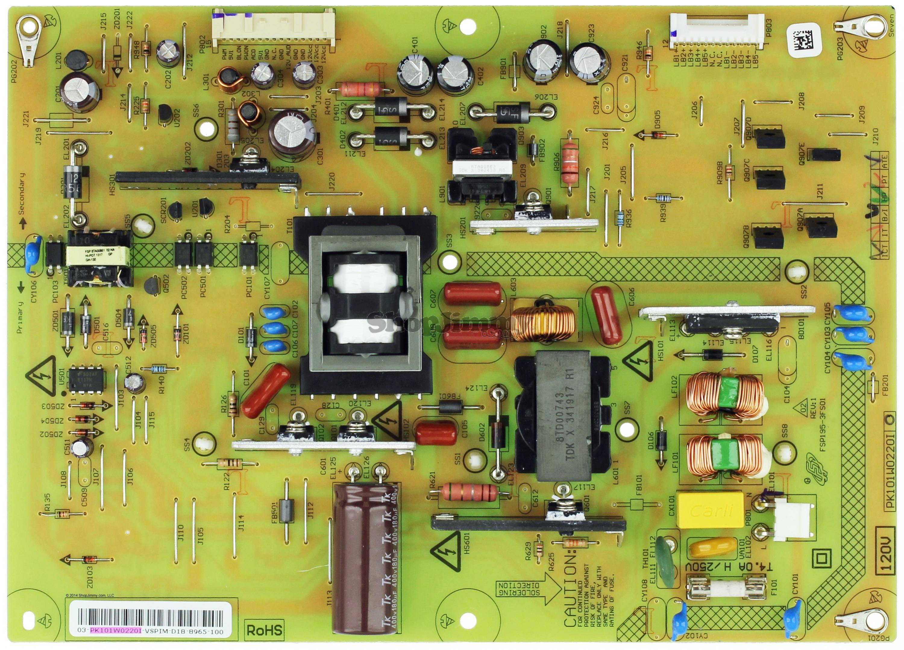

                                        Re: Toshiba 58L4300UC Dim picture
                                        I believe that you have the wrong power supply board and that was probably changed and not the main board.
                                        The 58L4300UC part number for the power supply is PK101W0230I
                                        Edit
                                        Toshiba 58L1350U Power Supply LED Board PK101W0220I
                                        • dick_barton
                                          • Aug 2015
                                          • 6643
                                          • Wales
                                          #40
                                          Looking at shopjimmy it appears as though the PK101W0220I is used for the 58L1350U only and that the PK101W0230I can be used in the 58L1350U and 58L4300U.
                                          If anyone could verify and know the reason why it would be interesting.
