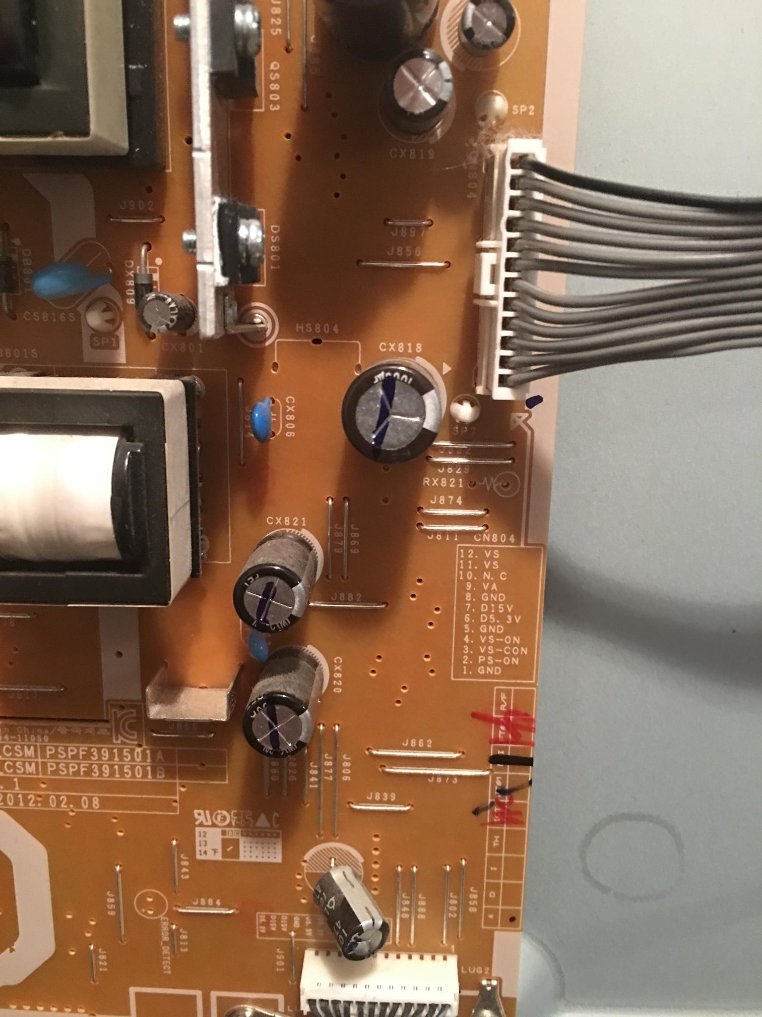

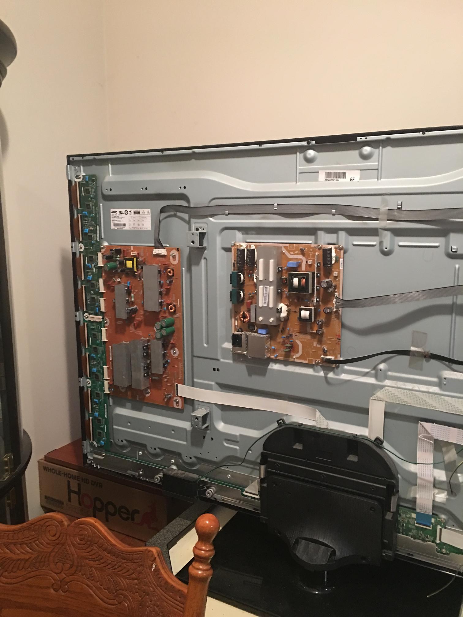

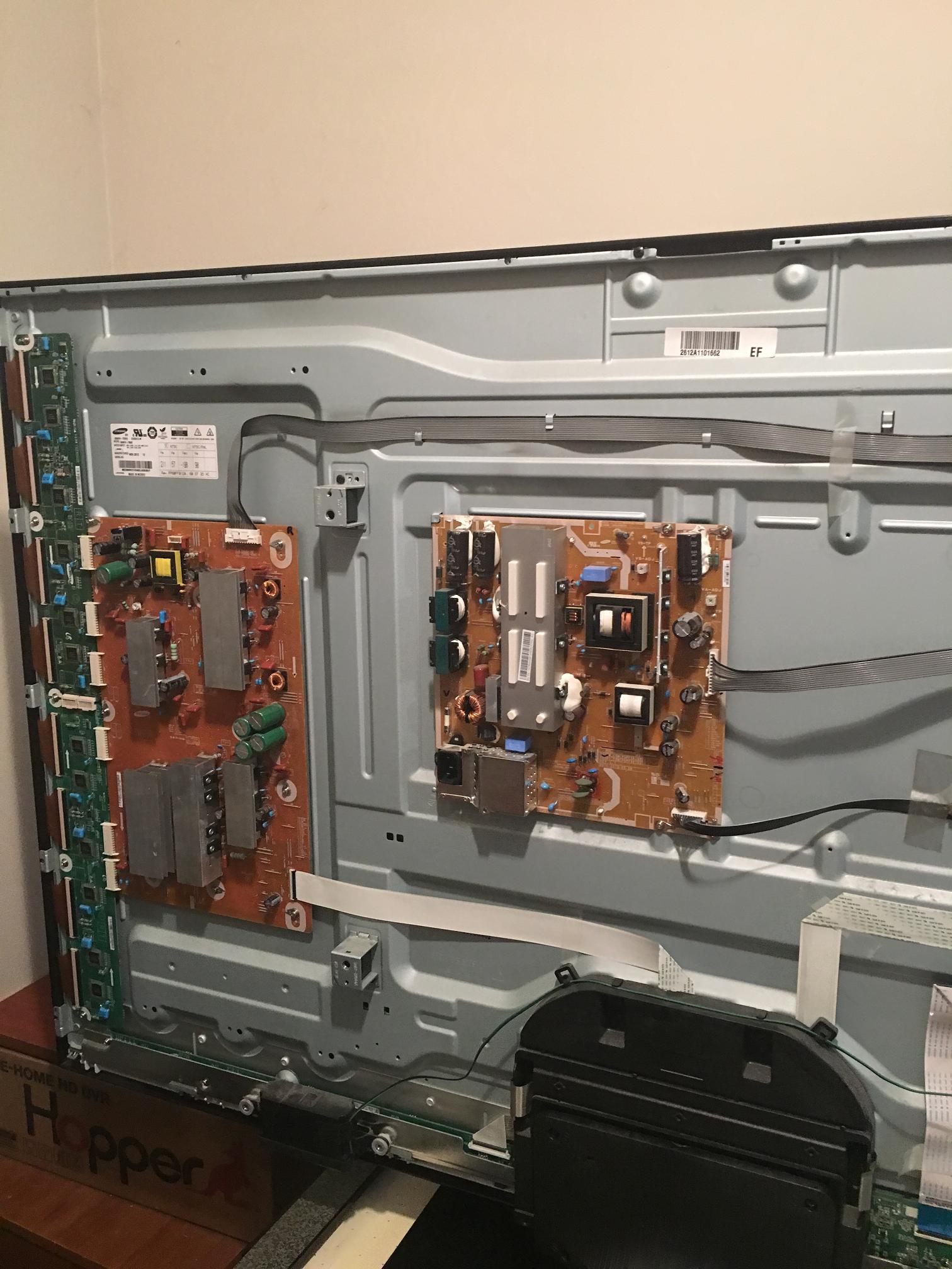

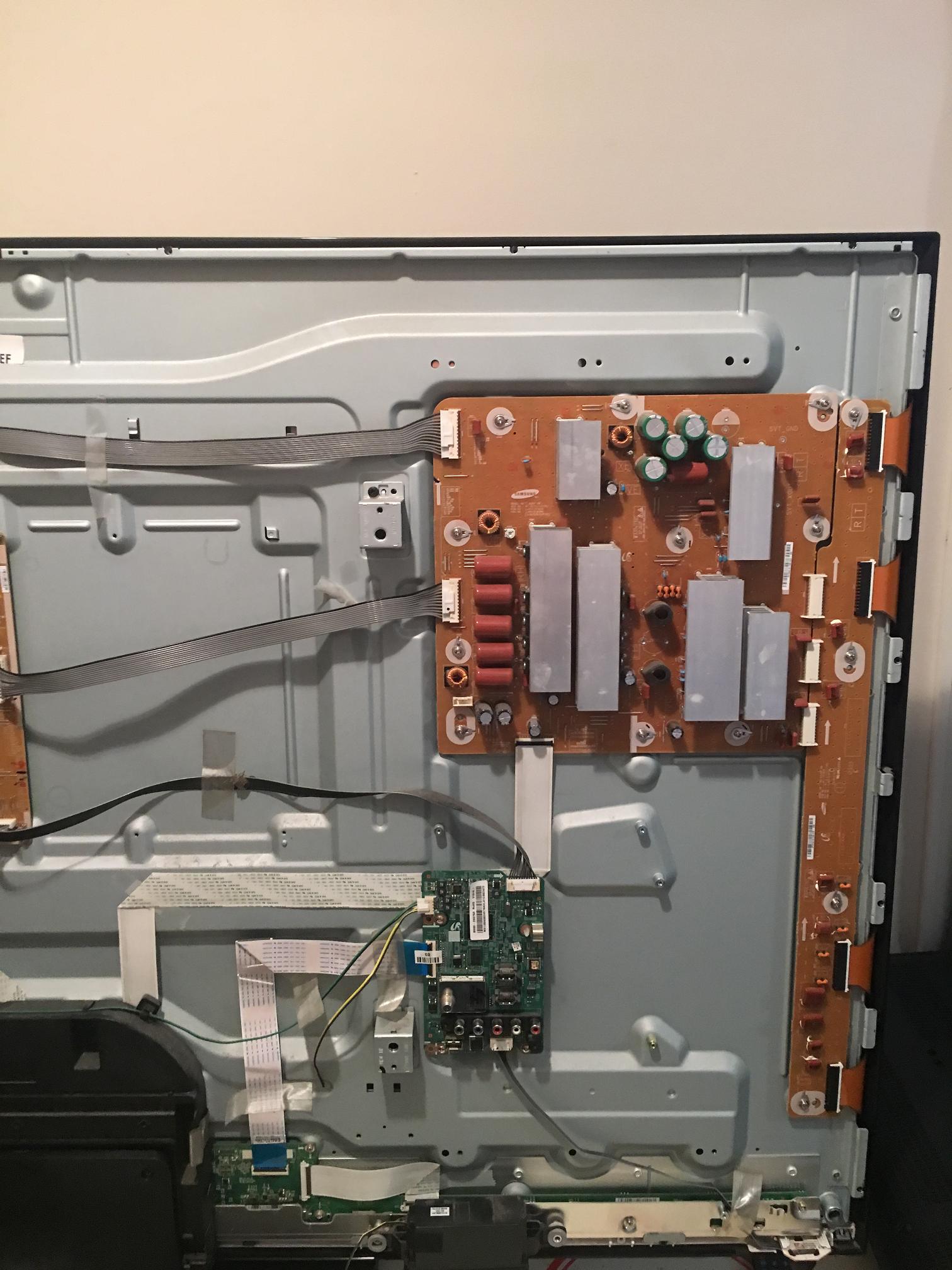

    TV will not power up..
    As soon as i try powering it up the tv will shut down after 2 secs..

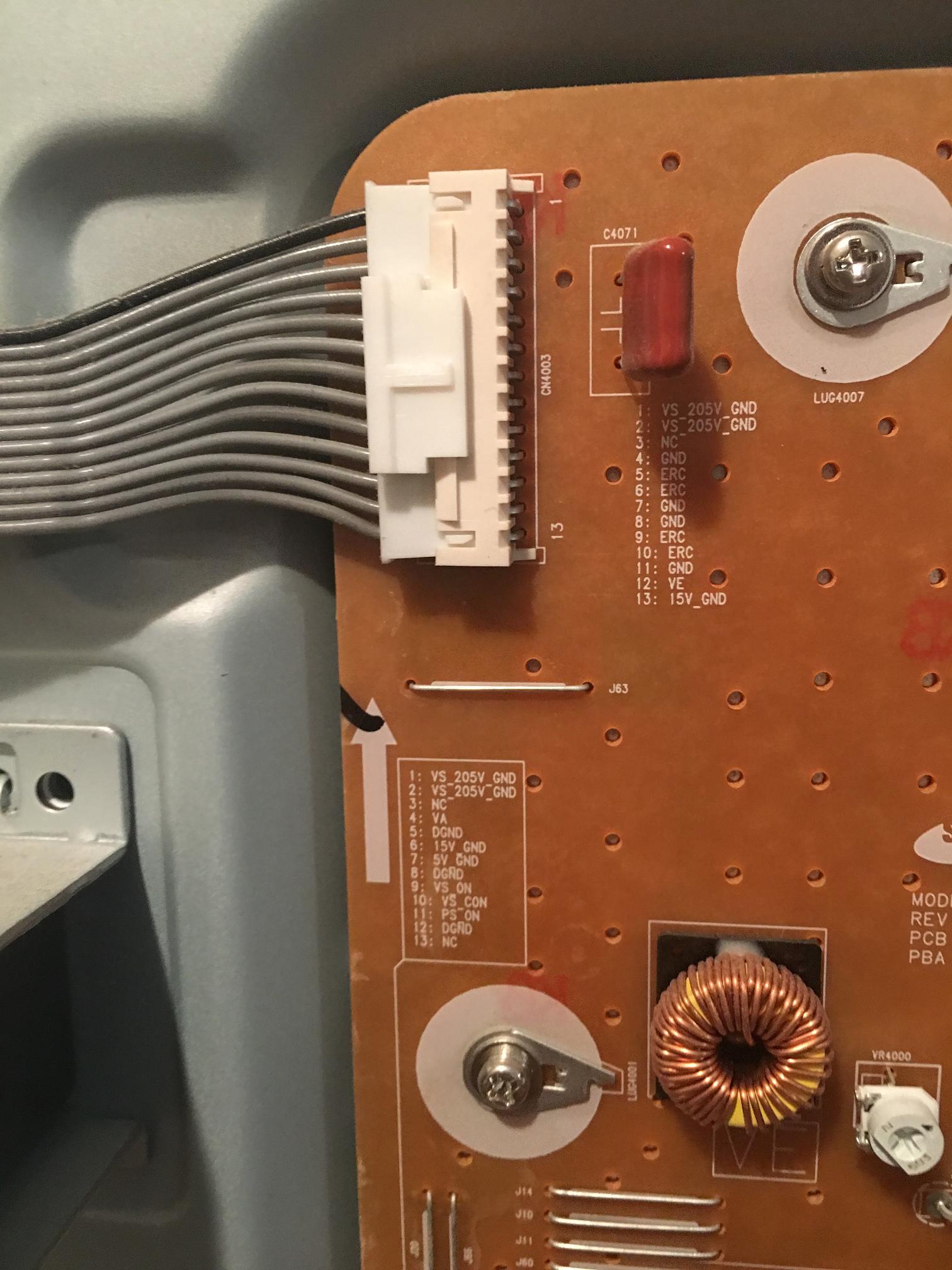

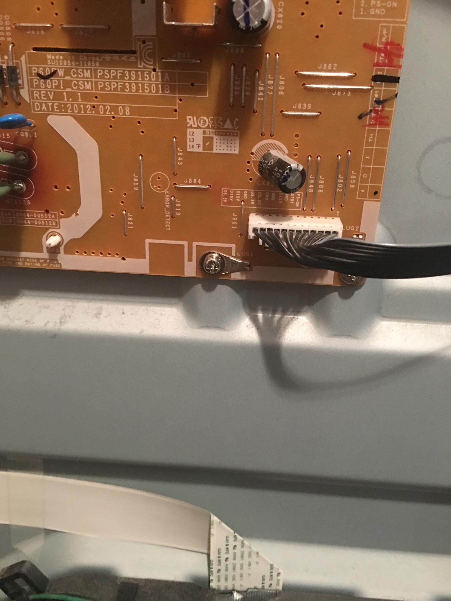

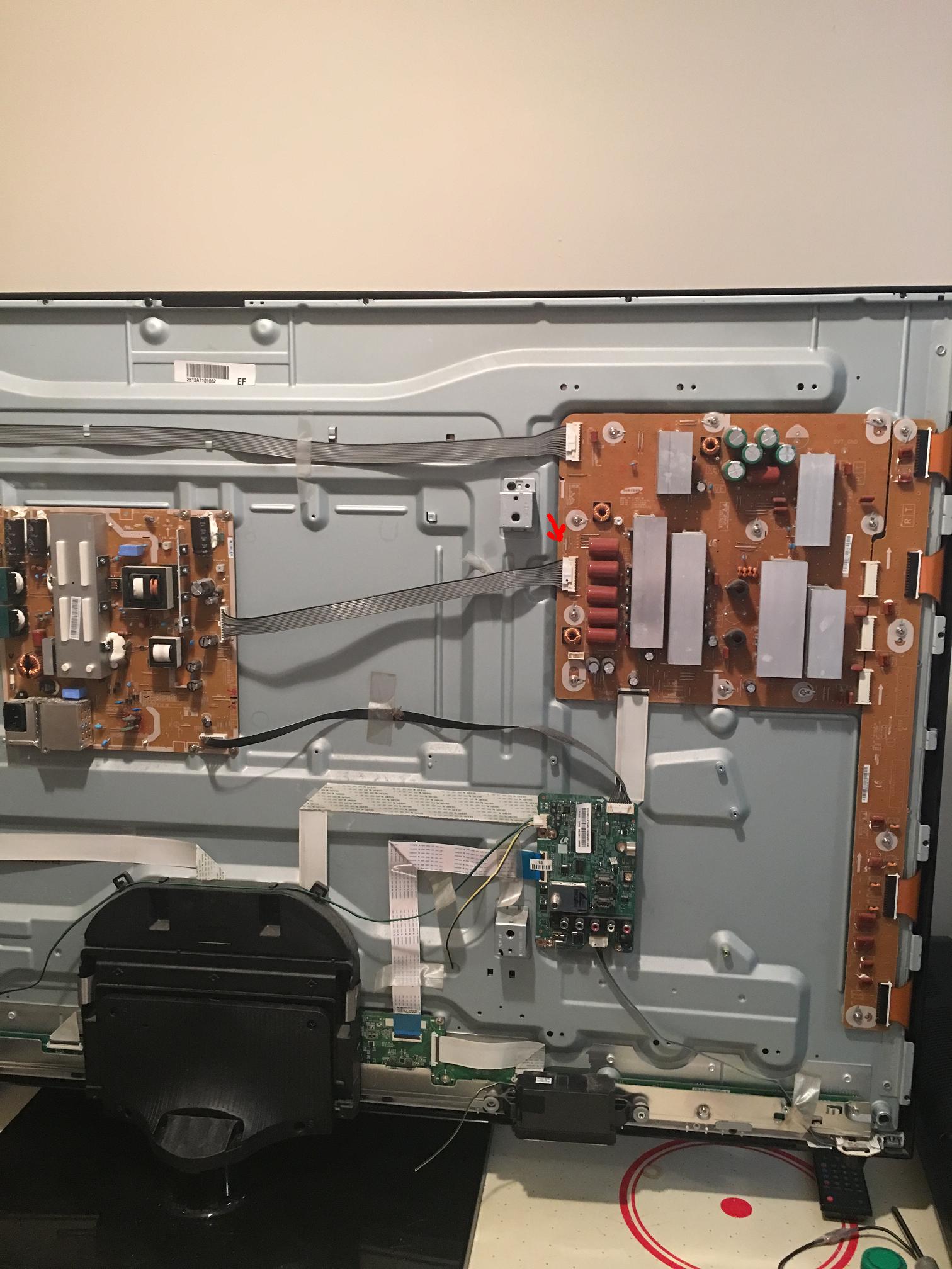

    If i unplug 1 of the boards in it the tv will power up but i do not get the VS and VA voltages from the power supply board..
    Here are some pics of the back of the tv showing the boards. If i unplug this board (red arrow pointing to it in one of the pics) the tv will power up but when i measure the VS and VA voltages on the power supply board they remain at 0 volts..
    I dont have alot of knowledge on tv's Wondering if someone could help troubleshoot this and point me in the right direction

    Connect boards, freeze spray blue or yellow things under transformer at the top sticking up on Ysus does the set work ?
      Re: Samsung PN60E530A3F
      Freezing them makes no difference i also replaced all 3 of them with no change.
        Ahh so you've done some research on this set then good. Right what does Vson signal measure ?
          When i first plug the tv in i get 0.32 volts then within a sec it drops to 0 volts..
            Ok all i have is the main board and power supply board plugged in right now ..
            With only those 2 boards plugged in i can here the startup sound on the tv ..
            With only those 2 boards plugged in i still do not get the VS and VA voltages at the power supply board..
            Should i get the VS and VA voltages with only those 2 boards plugged in coming out of the power supply board anyone know ?
            Im wondering if this is a power supply board problem
