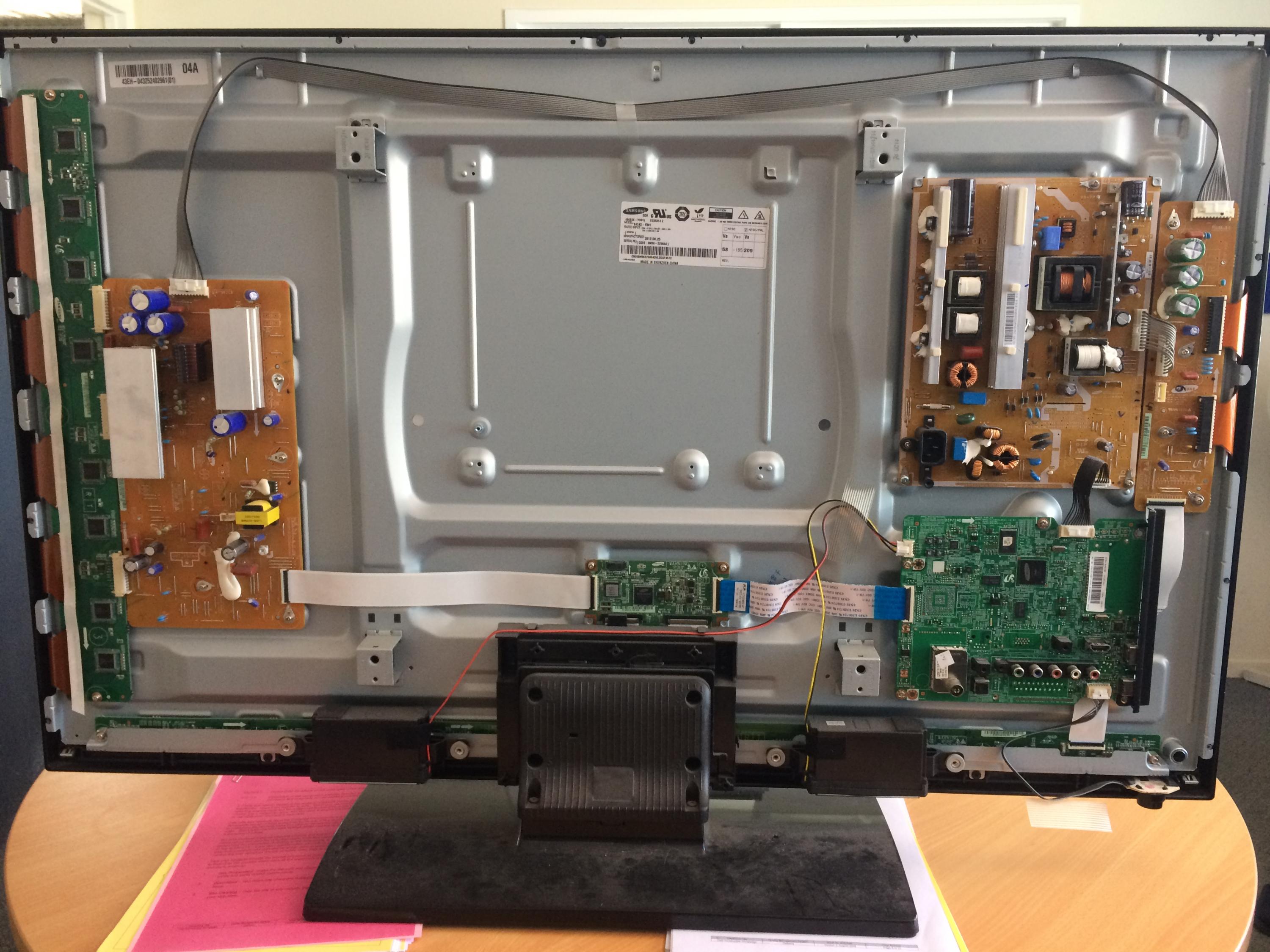

    Was watching tv then poof no picture now it has a red blinking light and no picture....any ideas ???

    Have you made a start checking any of the voltages. Can you post photo's of your circuit boards and their layout. Do you have a meter at hand? Have you search the forum to see if this has been discussed before?

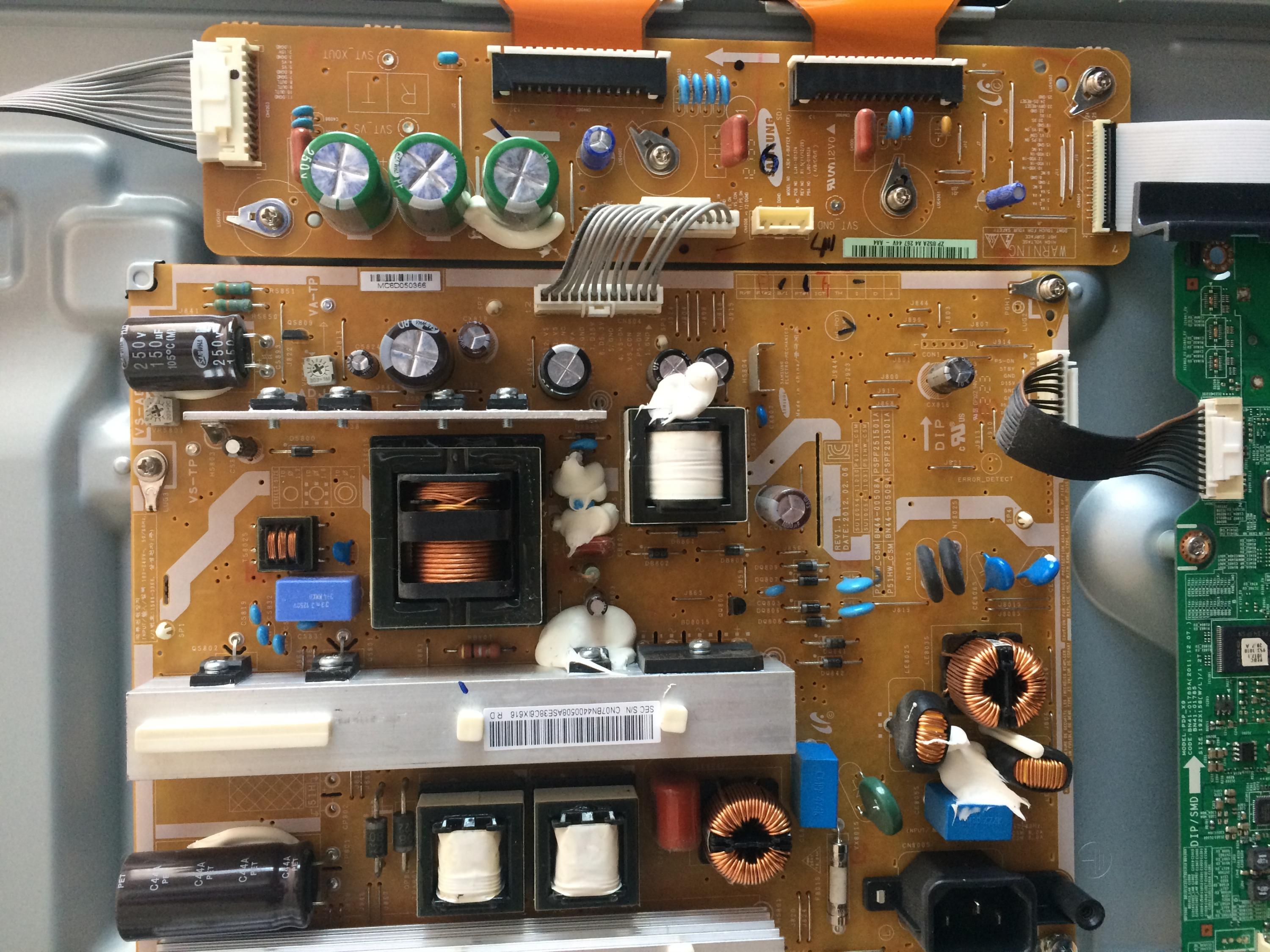

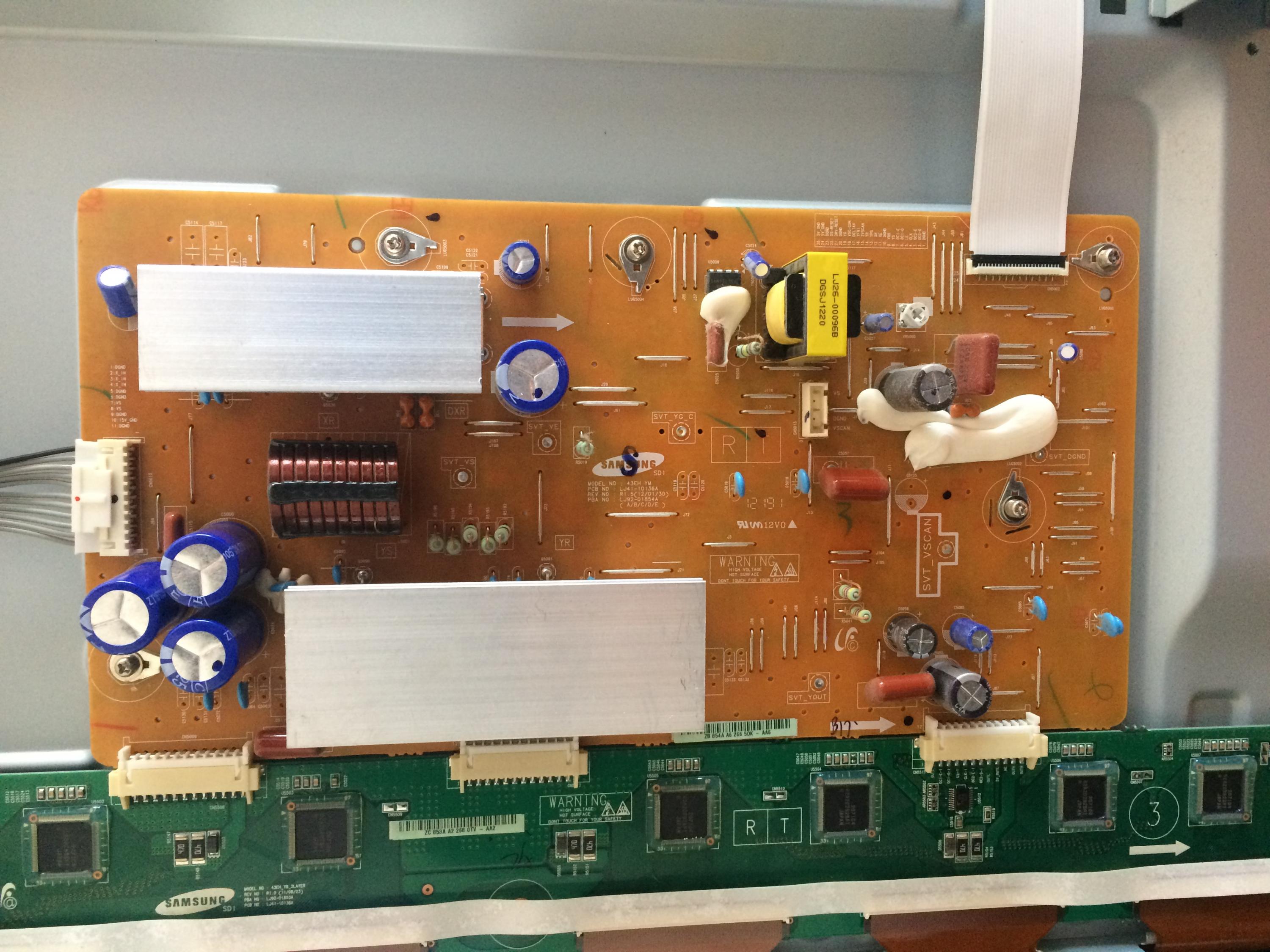

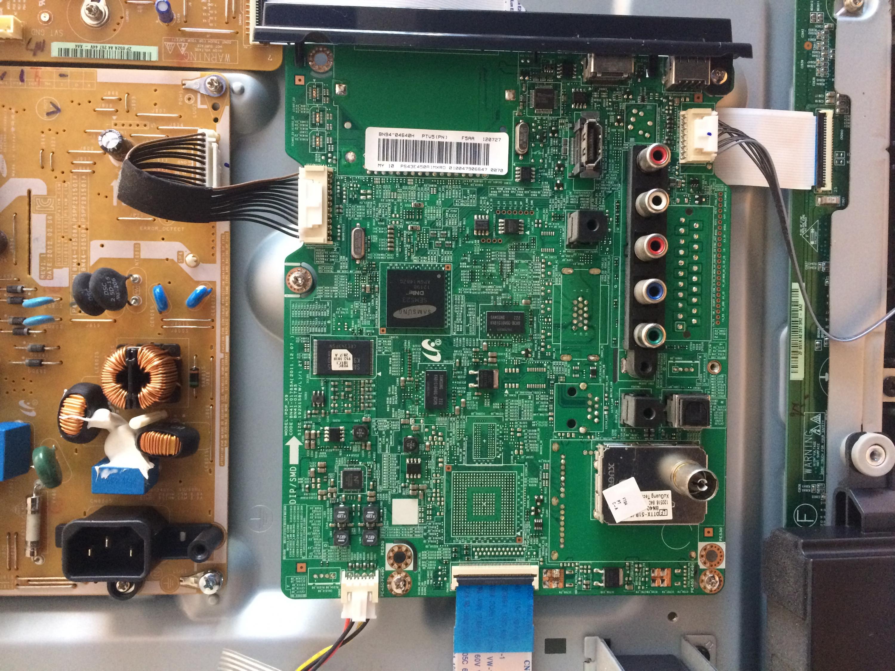

                No havnt checked voltages yet, here are pics of circuit boards, yes have a meter and only had quick search of forums, cheers for your help.

                      So the easy bit is to check the voltages it says on the back panel are up.

                        im getting no readings at all from the Va,Vs and Vsc ? also green led on logic board blinks couple times and stops

                          Voltages will probably only appear at initial start up then fall back to 0
                          You'll need to check them quickly.
