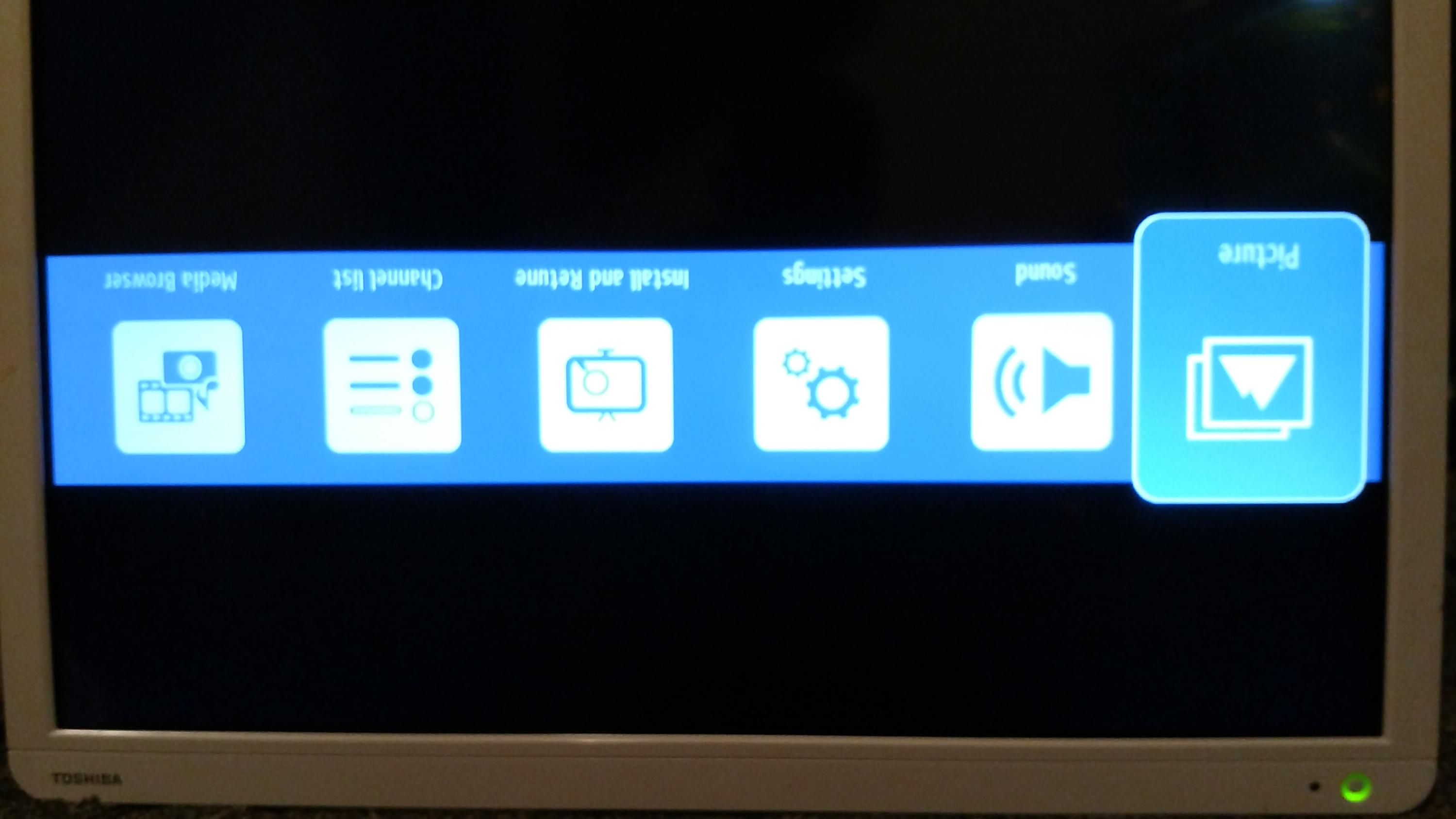

    hi trying to repair a Toshiba 24" 24d1434db TV has the vestel 17mb95s-1 originally had a red/green flashing light bought a replacement board was ok for 3 months now I'm having same problem. found a couple of firmware files on the net got it working again but displays upside down dvd functions don't work can any one help me

                  Copied dump file to eeprom a couple of times but made no difference display still upside down same problems.

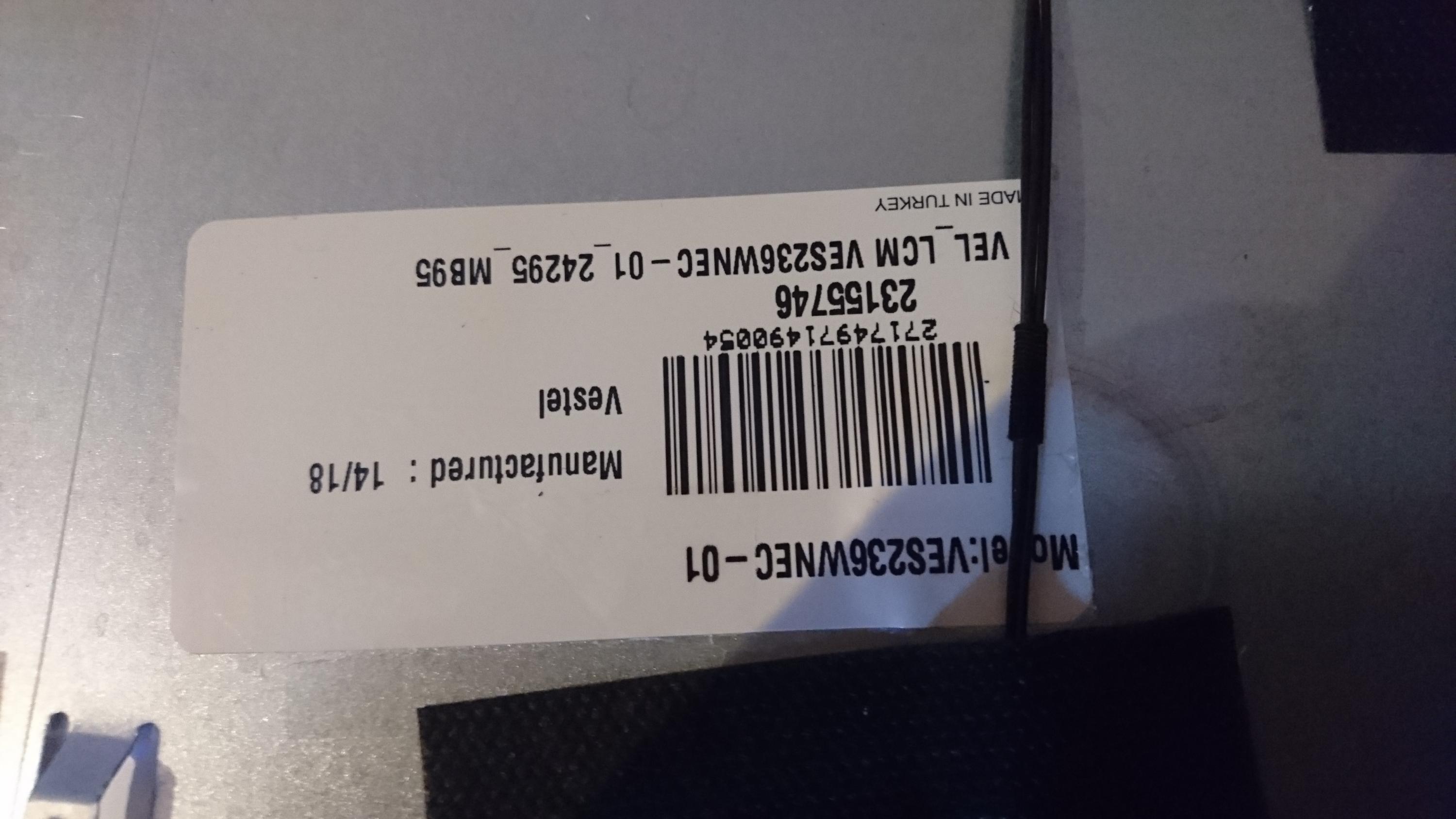

                          For the record here's the panel sticker.

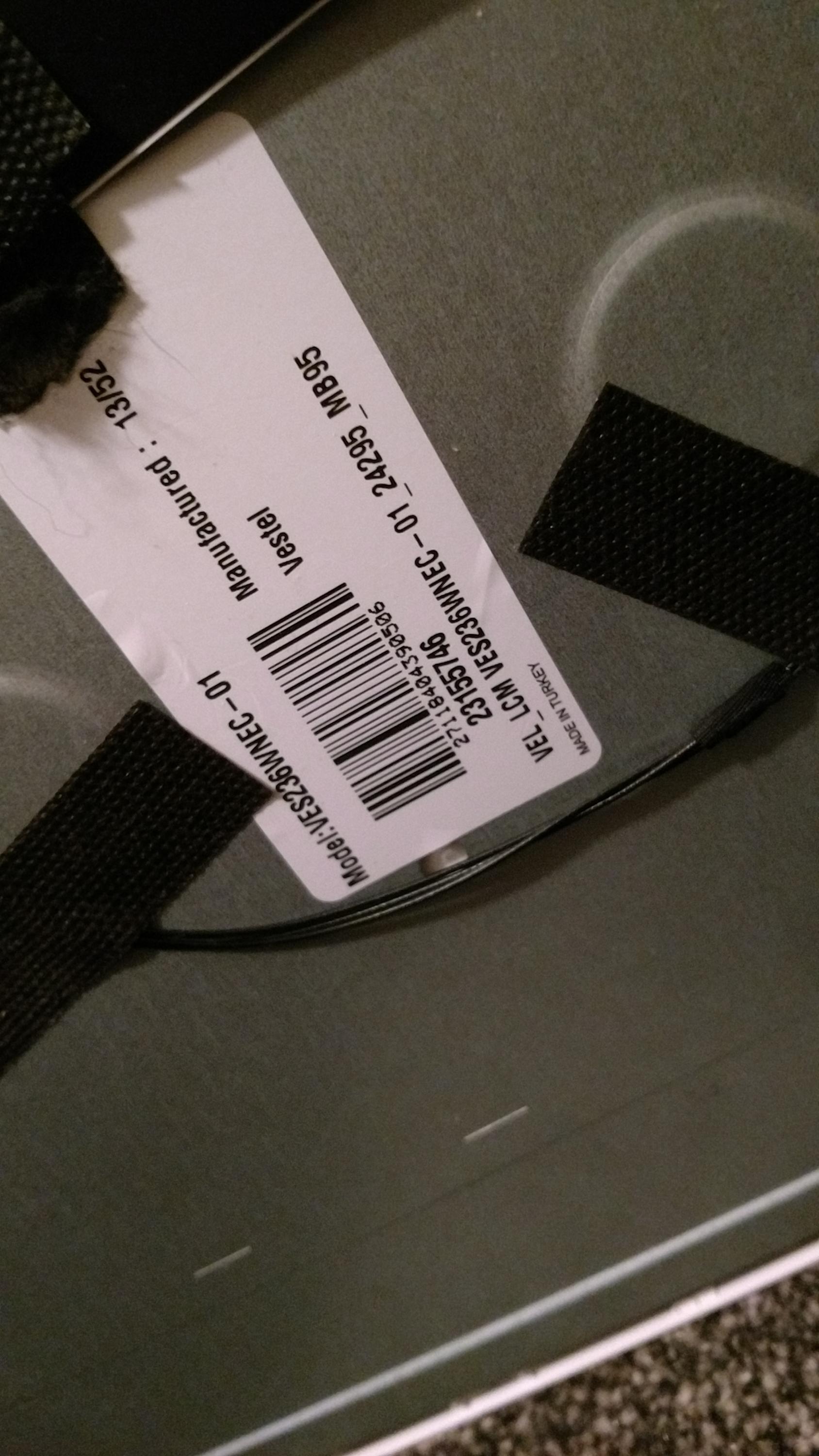

                            Re: toshiba 24d1434db firmware
                            Originally posted by Novac20xelee
                            Tried flipping LCD panel no joy there. Lol yeah I'll just mount it upside down write Toshiba on with a marker pen.
                            Have you got a picture of you panel sticker so we can see what lcd is used
                              Pics of my display
                                OK so that doesn't make any sense.
                                As I previously thought it's the same panel used.

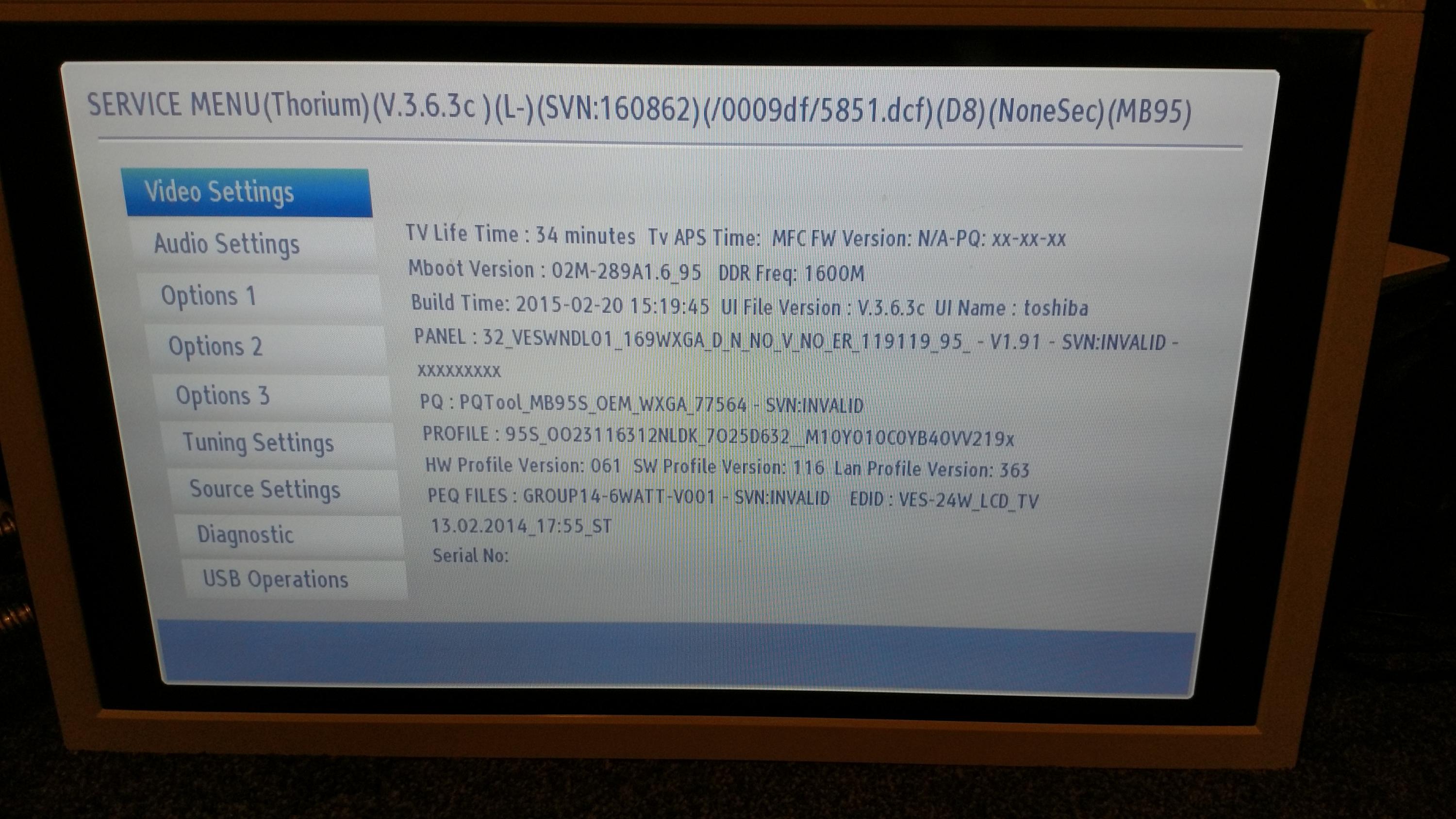

                                  Service menu shows panel as 32" veswndl01
                                    I still have this TV, I use it for my microscope.
                                    I'll check the service menu tomrrow.
