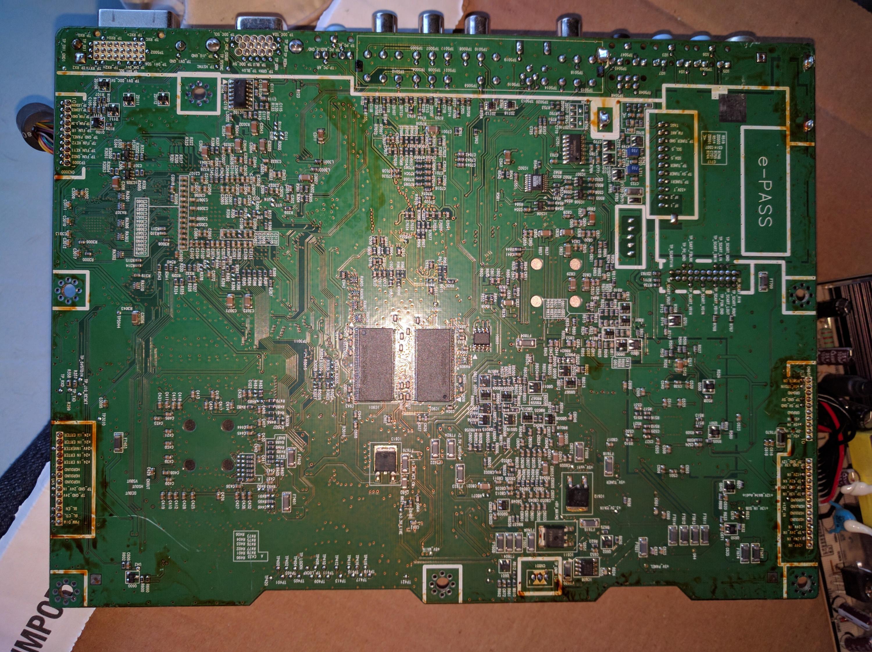

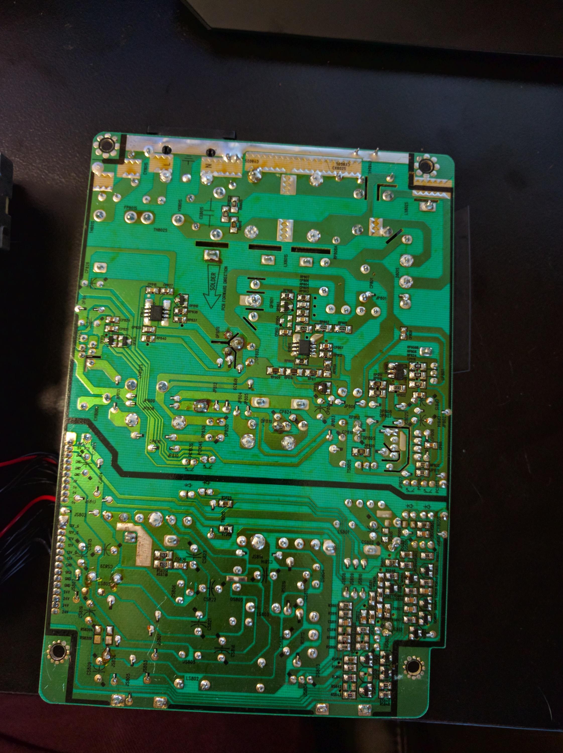

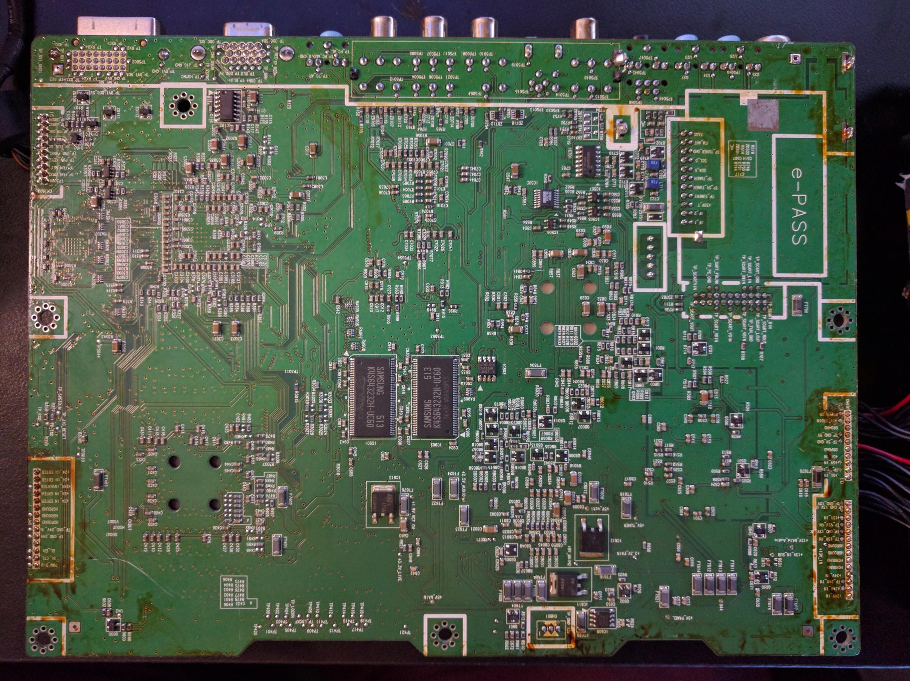

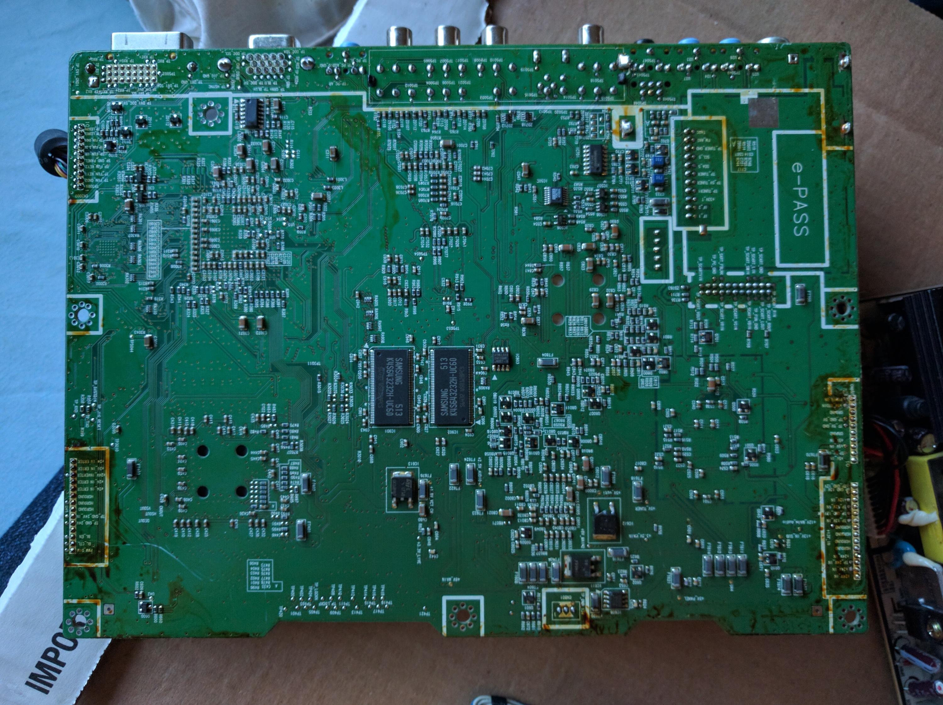

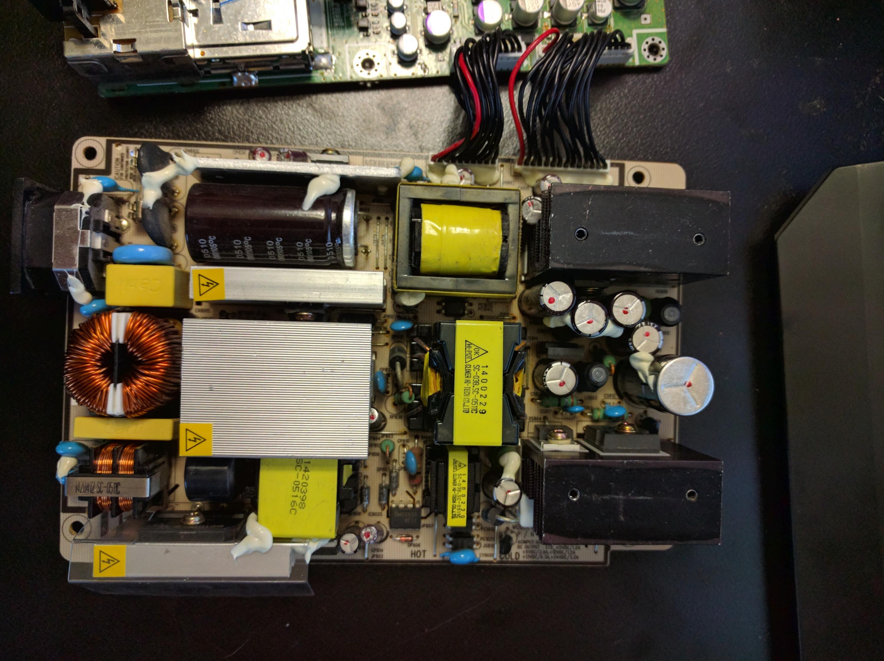

    I have 5v at the main board, but the monitor won't turn on. This is with only the main board and supply connected.
    I tried connecting the power_on pin to 3.3v, which I can then test the other pins coming from the power supply, and they all read within a volt of expected.
    From reading the service manual, I have tested for voltage at C614, FT670 and FT671.
    If I test without the connection to power_on, I only get voltage at FT670 and FT671, which are both 5V.
    If I test with the connection to power_on I get a reading of 12V at C614.
    From my understanding I should only get the 5V readings because the tv is in standby.
    And then the 12V reading is correct when it should be powered on.
    I tried reconnecting the other boards to see if when I have power_on connected if the tv would be on, however I still get nothing on the screen or audio. Throughout all of this neither the green nor the red led have turned on (unless I supplied them directly with power).
    I've inspected the caps on both the power supply and the main board and neither seem to bulge or leak. I don't currently have access to an esr meter to test them otherwise.
    Anybody have any ideas? I've searched around the forums to see if there is anyone with a similar problem, but nothing seems to apply.
    I would like to try to diagnose what is causing the power button or remote to not turn activate the other pins and turn on the tv, however I can't trace the main board very well, and I don't really know where to start.

      So.......you jumped the StdBy pin and the Pwr-on pins and all the voltages came up on the PSU? I hope you did this with the Main Board disconnected......then it would seem that you PSU is good.....If upon initial start-up the set powers and shutdown soon after in 2sec or so then you may have either an Inverter or CCFL failure......

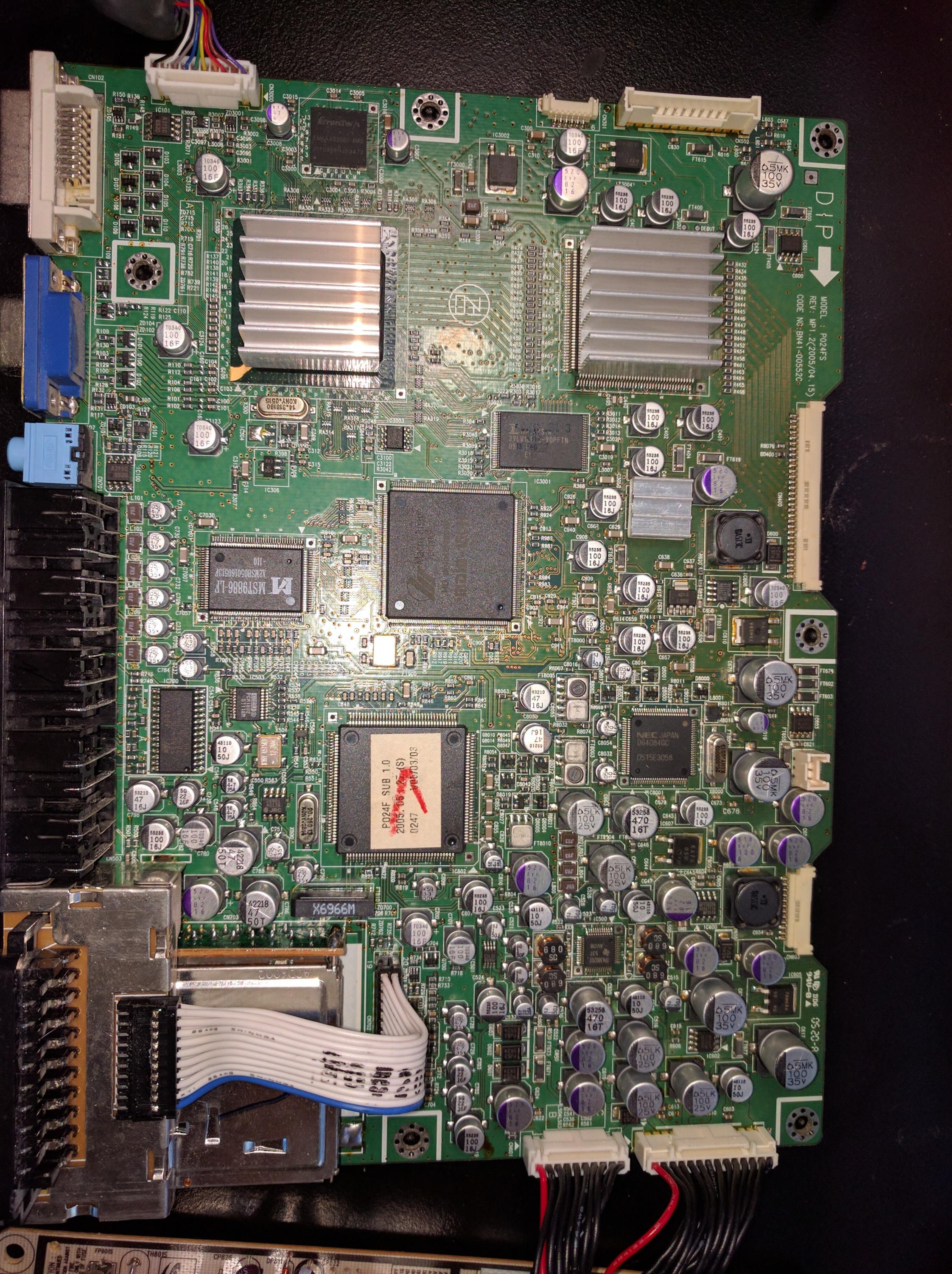

            I figured that the power supply wasn't being activated after I checked that it could give the required voltages. I am having trouble tracing what components I need to test to see what would be preventing the on signal. I've tested the few components that show up near the function board from the service manual and they seem fine.
            I've also taken a look at the function board and it seems fine as well.
              Re: Samsung 242MP 5v standby but not turning on
              The command Voltage is static Voltage, <1VDC = OFF, >2VDC typ. = ON.
              • topgamer7
                • Jul 2016
                • 12
                You are correct, there is an incredibly small voltage of 0.02 or so on ps_on
                I read some of the information about the larger chips in the service manual. And found the connection from the function keys to the gm1601h-CF board. I found that if I probe that at the resistor listed for that circuit near the chip and press the power button I can see a drop from 3.3v to 2.5v.
                This chip also has a connection to ps_on. If I probe that I get that same ~0.01v. However if I press the button I don't get a change. This would mean I need a new chip? Which probably means I would need an entirely new main board?
