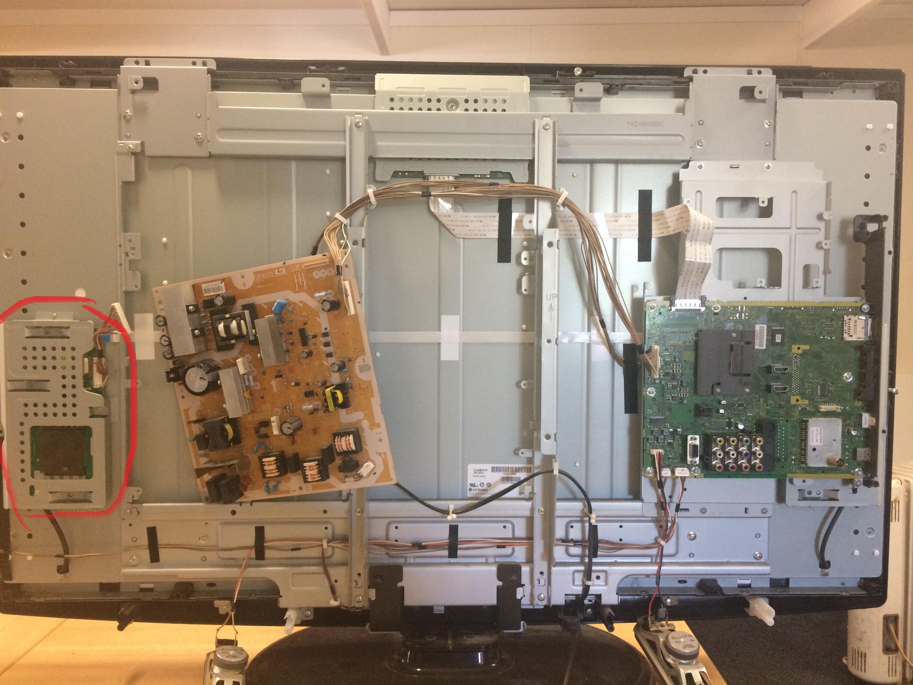

    hey guys have a panasonic 42 inch viera TH-L42U20Z with 7 red blinking lights of doom, can anyone help me with this ?

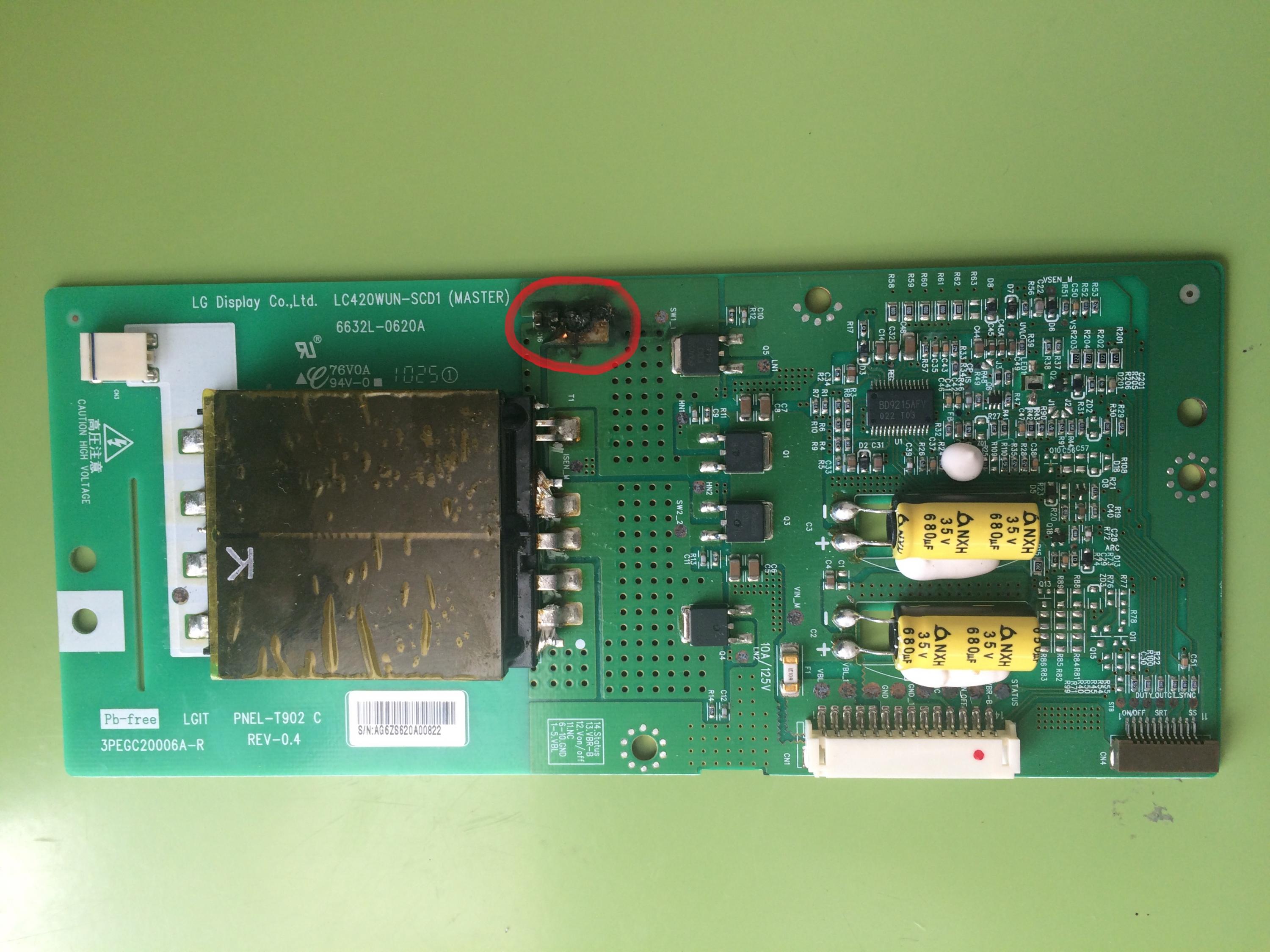

            This is the board i replaced as last guy tried to fix it an fried it, it goes on far left of tv which is circled red

              As in my post above, your set is an LCD model,and that is the back light inverter board,I would start by checking the fuse on the board (just above and to the left of the white connector) Flocko

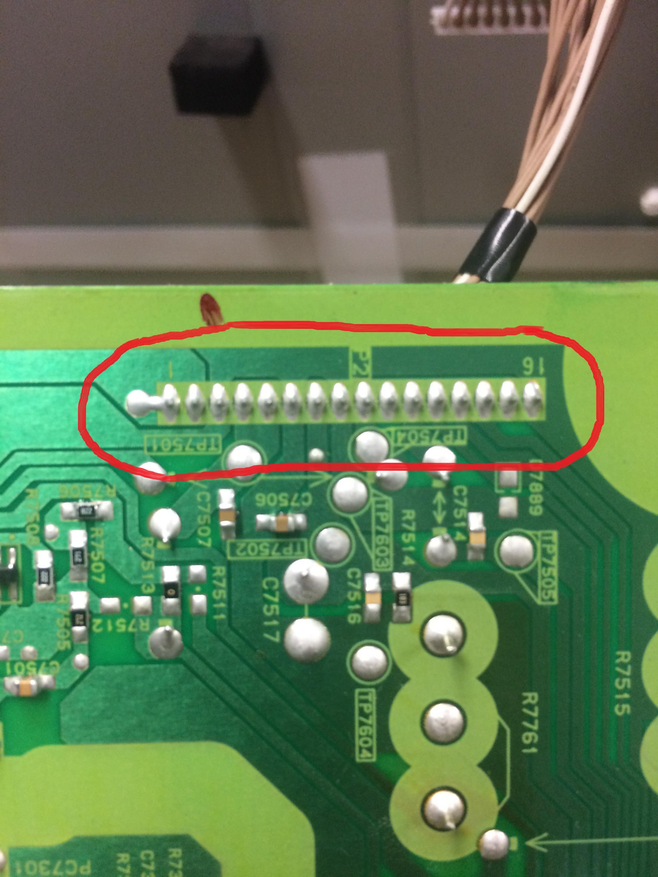

                      cheers man, not really sure how to self test ? which connecter do you mean ? sorry bit of a noob

                        The connector that goes to the Main Bd....the one with PS-ON...StdBy....and etc

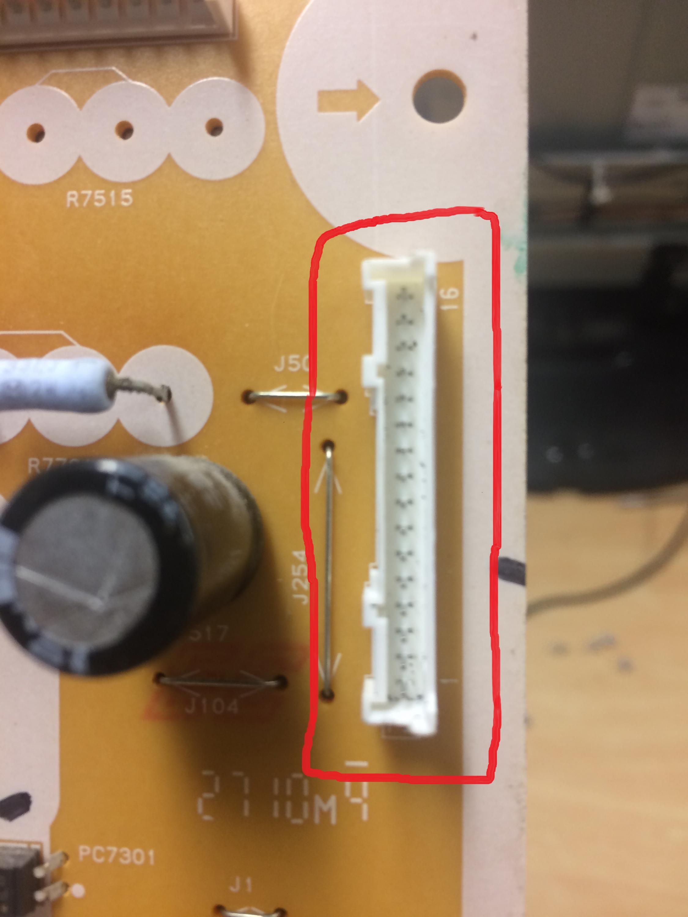

                          This one Andrew ?

                            Please be aware what you have highlighted is 240V mains power which can kill.
                            Ali has referred you to the main AV board which will only have non lethal low DC voltages present.
                            This is a 2010 series model and although I can't find a manual you may be able to piece some info from other regions models.
                            7 blink could be a main board issue, sub 3.3v if this training guide is close.
                            I would use U22 or U25 fault finding trees.
                            may be worth looking at the chinese model, it has 7 blinks in its list of errors.

                                ive highlighted the connector is there any writing next too these pins on this connector some times its on the underside of the board if not your going to have to use the schematic etc so you know what the voltages should be on each pin etc
                                • dvsguy
                                  • Oct 2016
                                  • 17
                                  • new zealand
                                  Re: panasonic 42 inch viera TH-L42U20Z-no picture
                                  I have taken pics of both side of board you are talking about

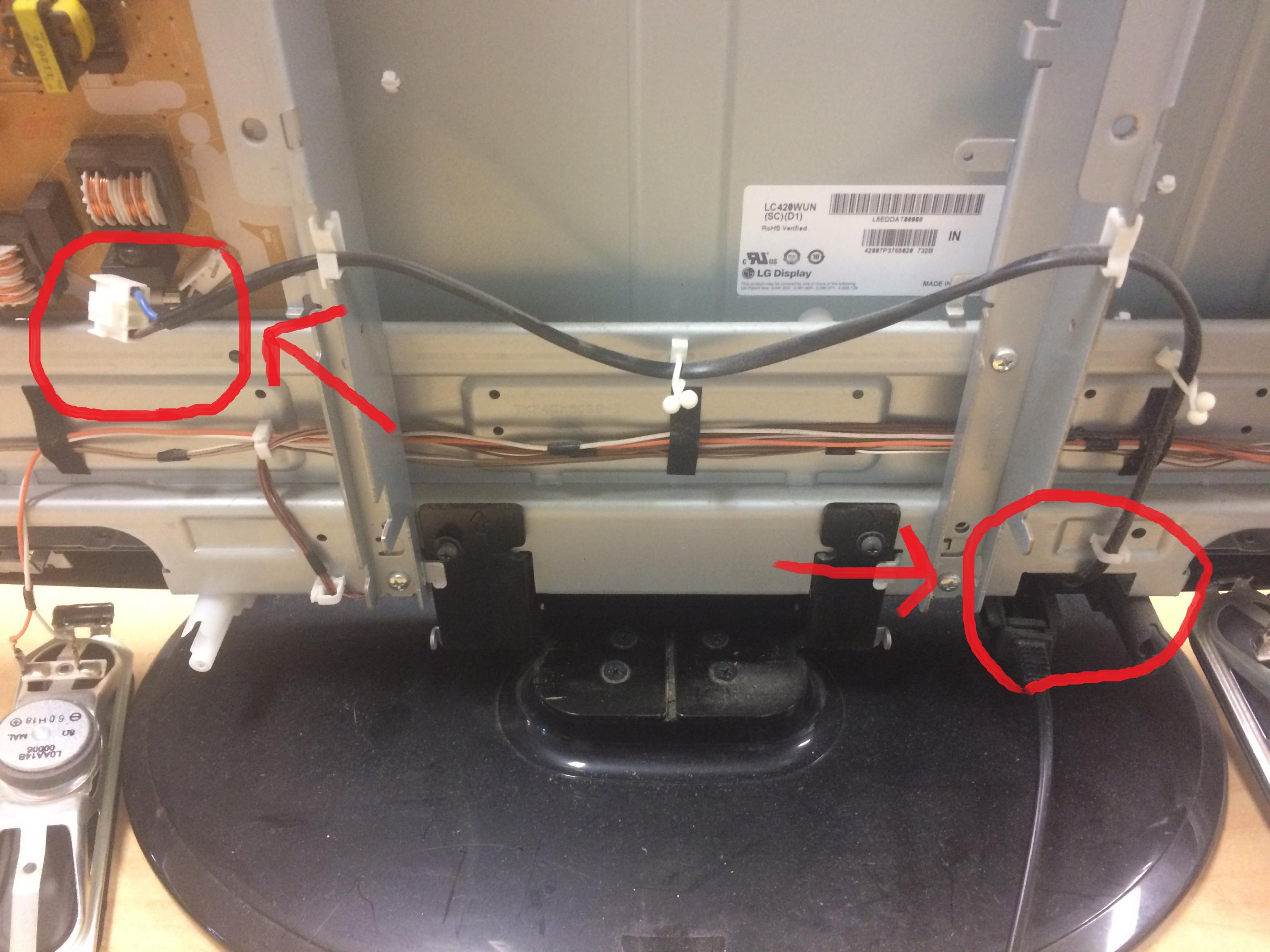

                                    So you are talking about the main AV board ? is this the one in the pic below ? this is the faulty one i replaced, which connector do you want pic of ?

                                      post 16 right hand board is the main av board the board in the above pictutre is the invertor board

                                        So left this tv on backburner but any ideas, what to test, isolate ???? did you see pics of pins you were after ? any help greatly appreciated.
