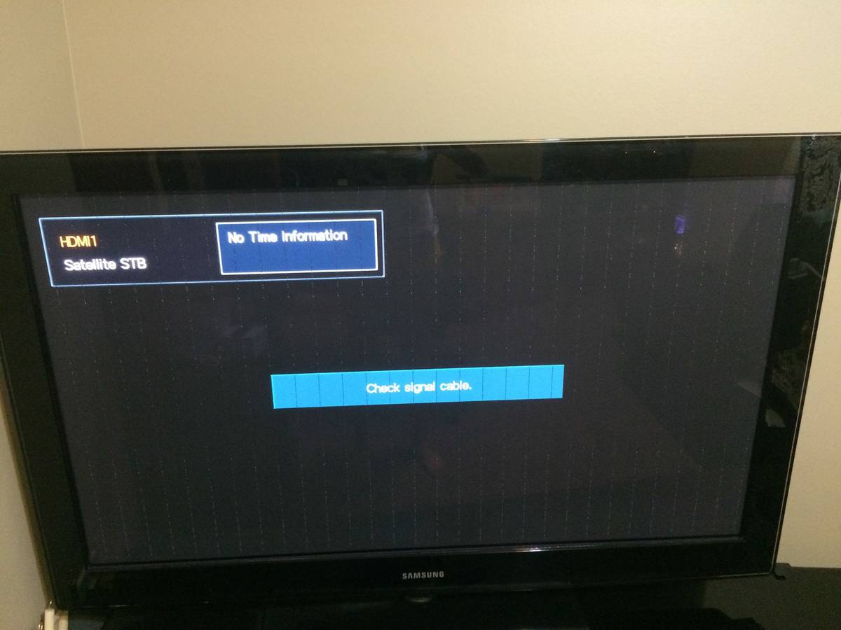

    I have the opportunity to buy this. Do you guys think it's a panel fault?

    Looks like a main board or logic board to me. Uniform spacing on the lines and it's on the whole screen. Main board is my first guess.

      Re: Samsung PN50B550 with lines
      I'm sure I've seen this described as a Logic Board fault too.
        Ok so it can be fixed? Good.
          Have you got access to it to run the test patterns.
            No. I didn't realize it was 1 and 1/2 hours away and he wants $75. I'm passing.
            Sorry to have wasted your time guys.
