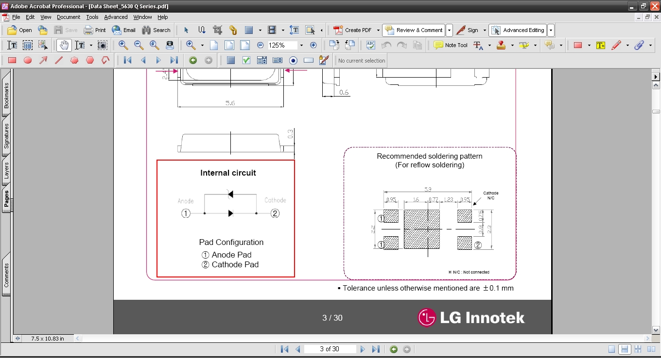

    Does the LED show about 0.7V IN DIODE MODE test when it is tested in Reverse bias.
    Are the LED rated at 3V or 6V (Dual-LED in one body).
    You must be careful when testing the LED without current limiter if you connect the power source to the LED in the reverse bias, that built-in protection diode will heavily conduct and get damaged. The protection diode is connected in anti-parallel with the LED.
    I will never test the LED without using the power supply with current limiter function otherwise you can easily damage the good LED.
      That did it, they were 6V! I didn't know about those.
