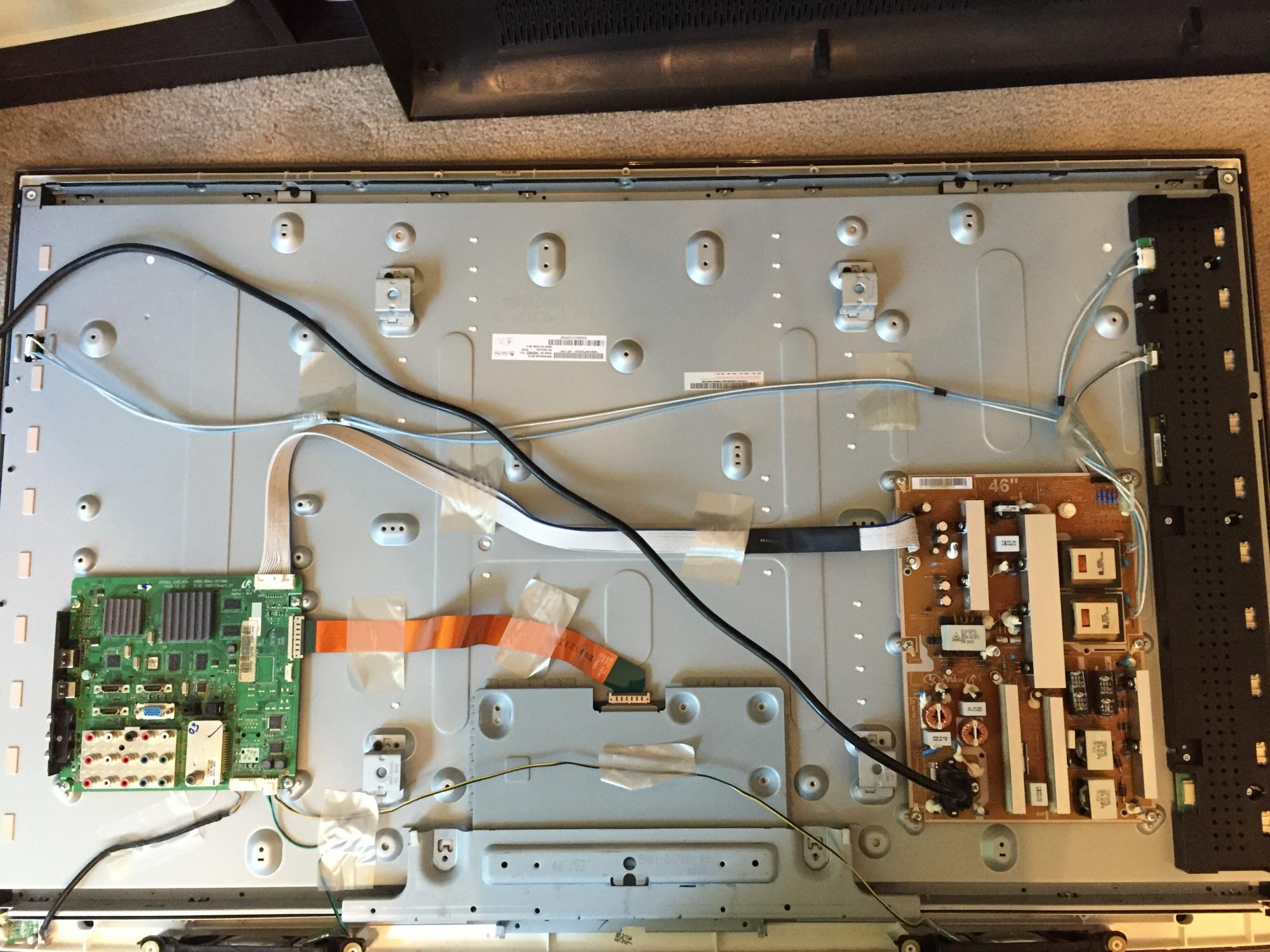

    Re: Samsung LN46B610
    Pictures, pictures, pictures?

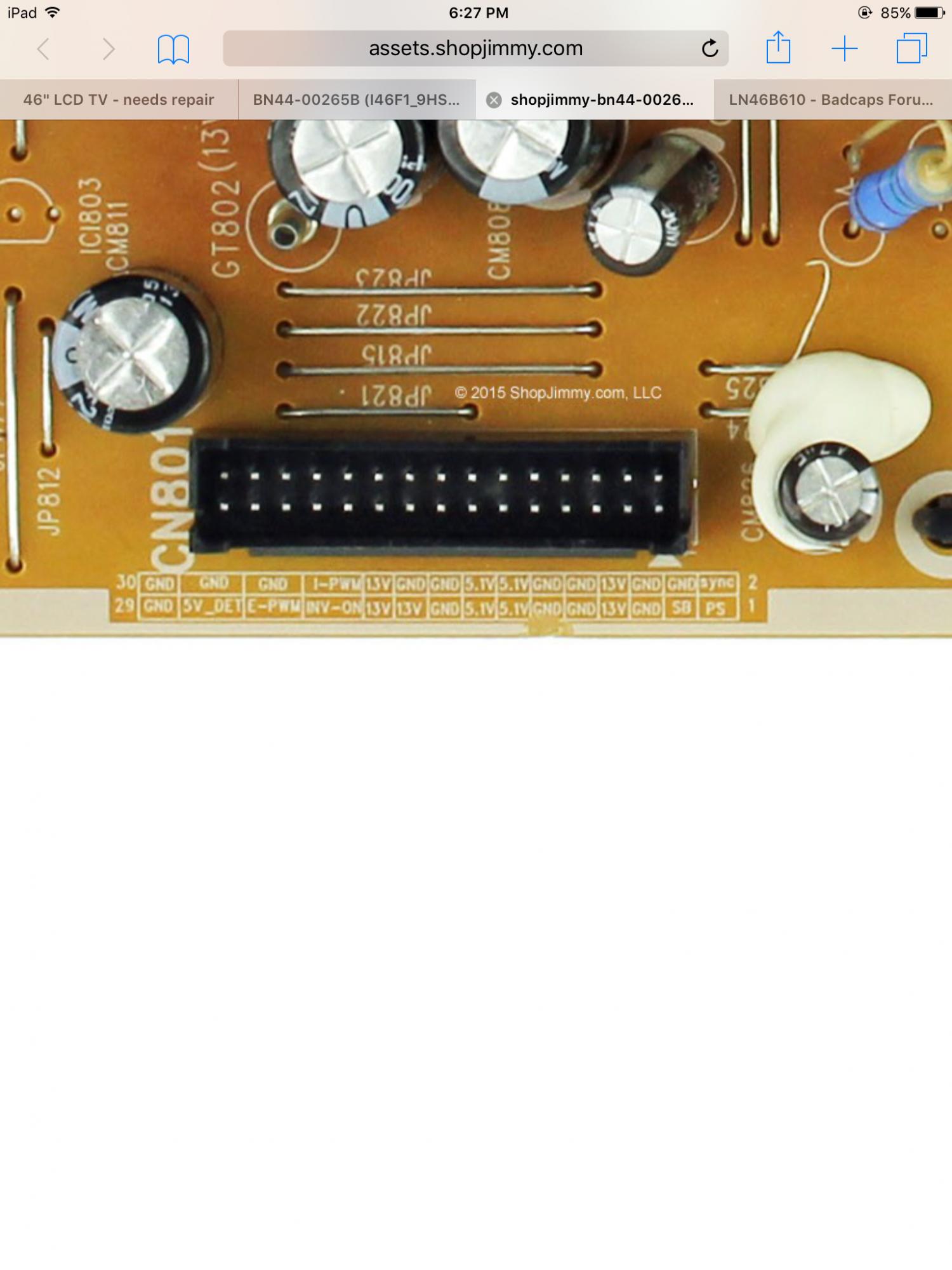

    What DCV have you checked on the power supply connector that goes to the main board?

      Sorry, I uploaded the wrong picture.
      I get 5v where it asks for it and 13v where it asks for it.

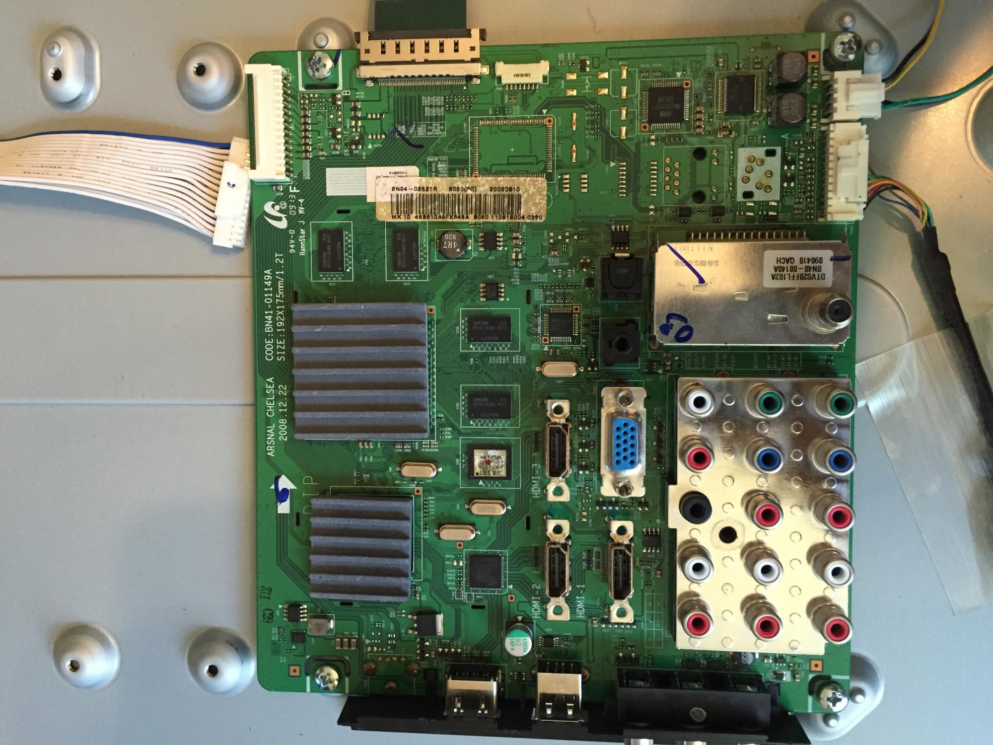

        Mainboard picture.
